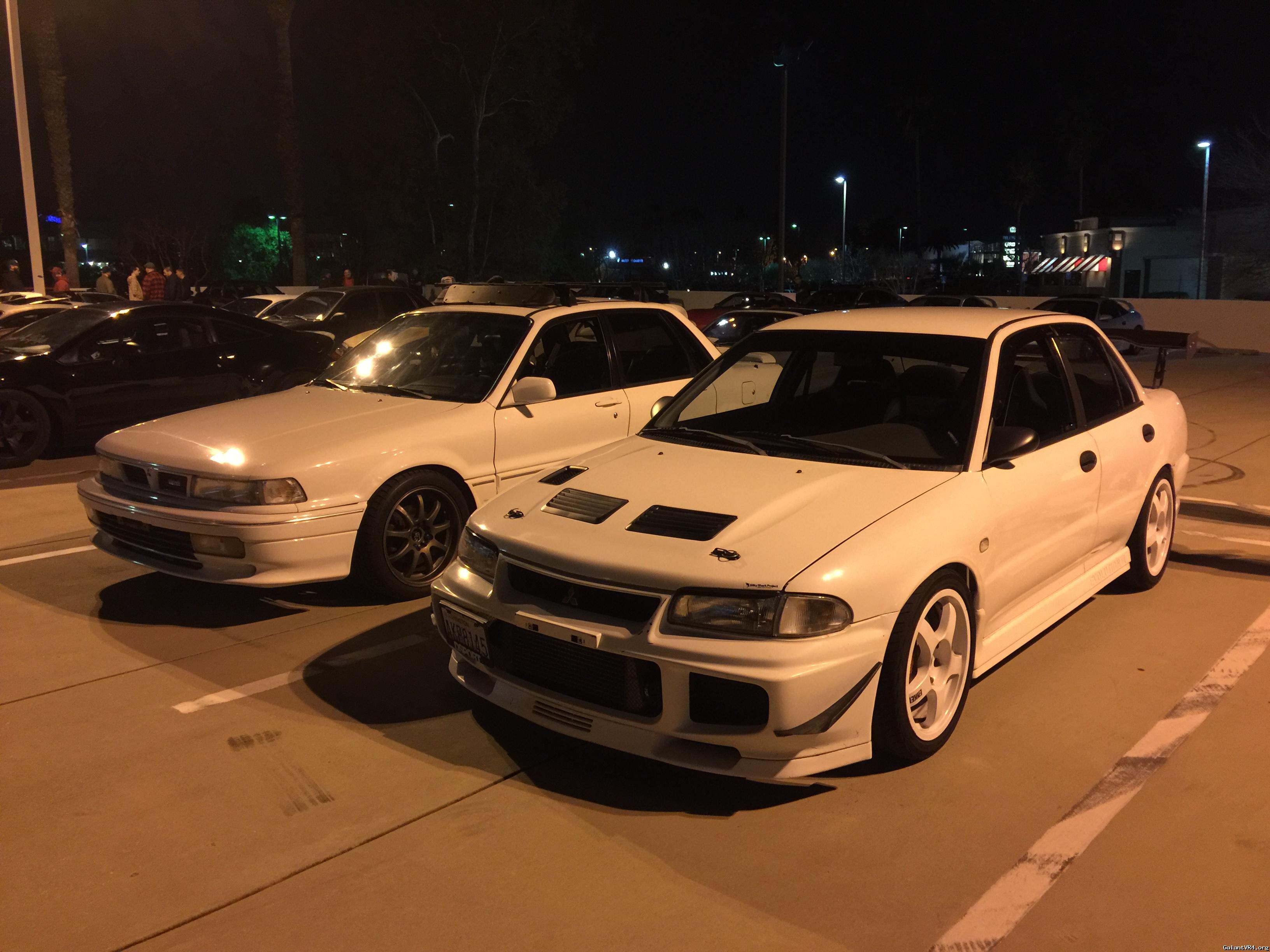

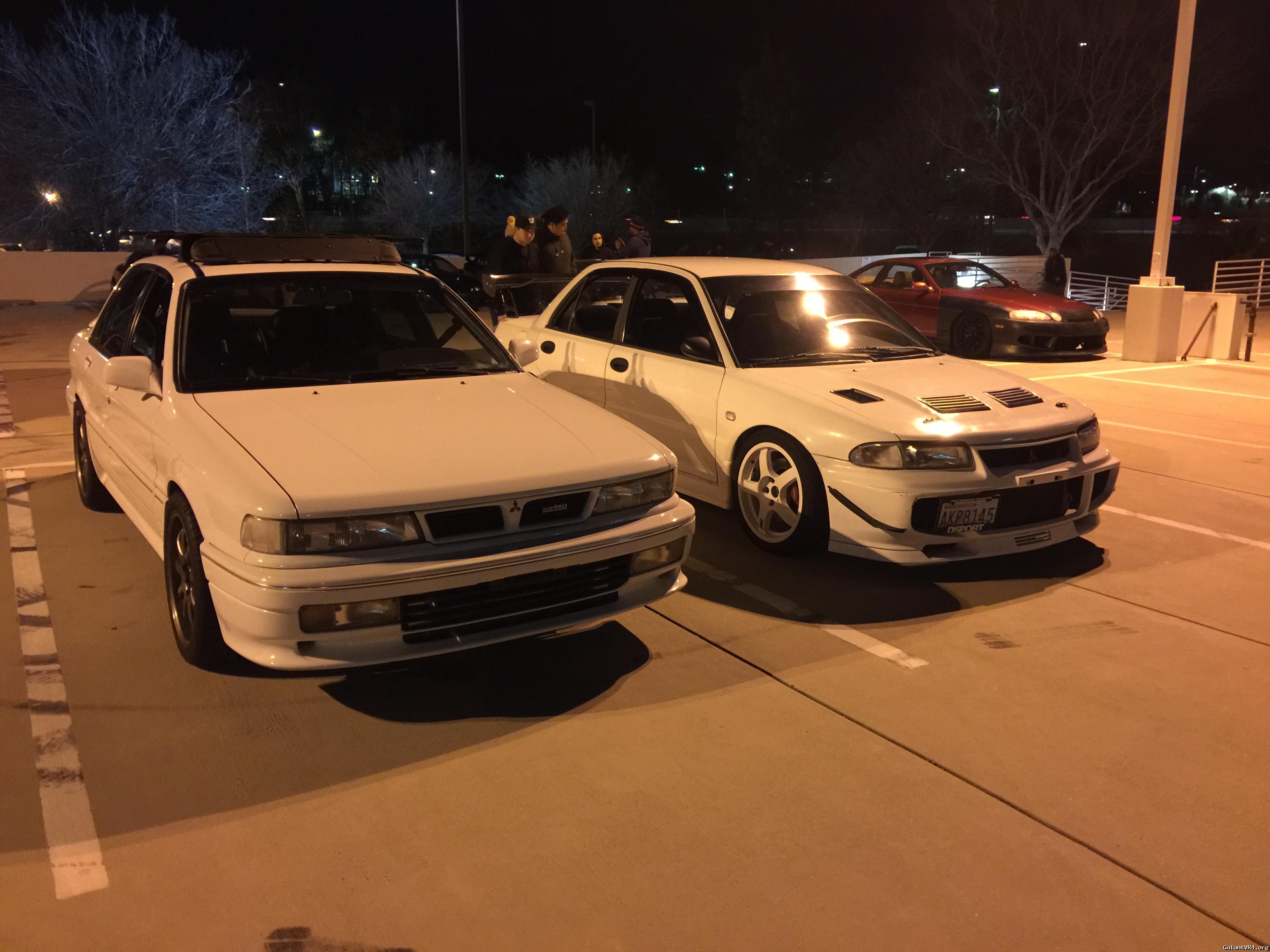

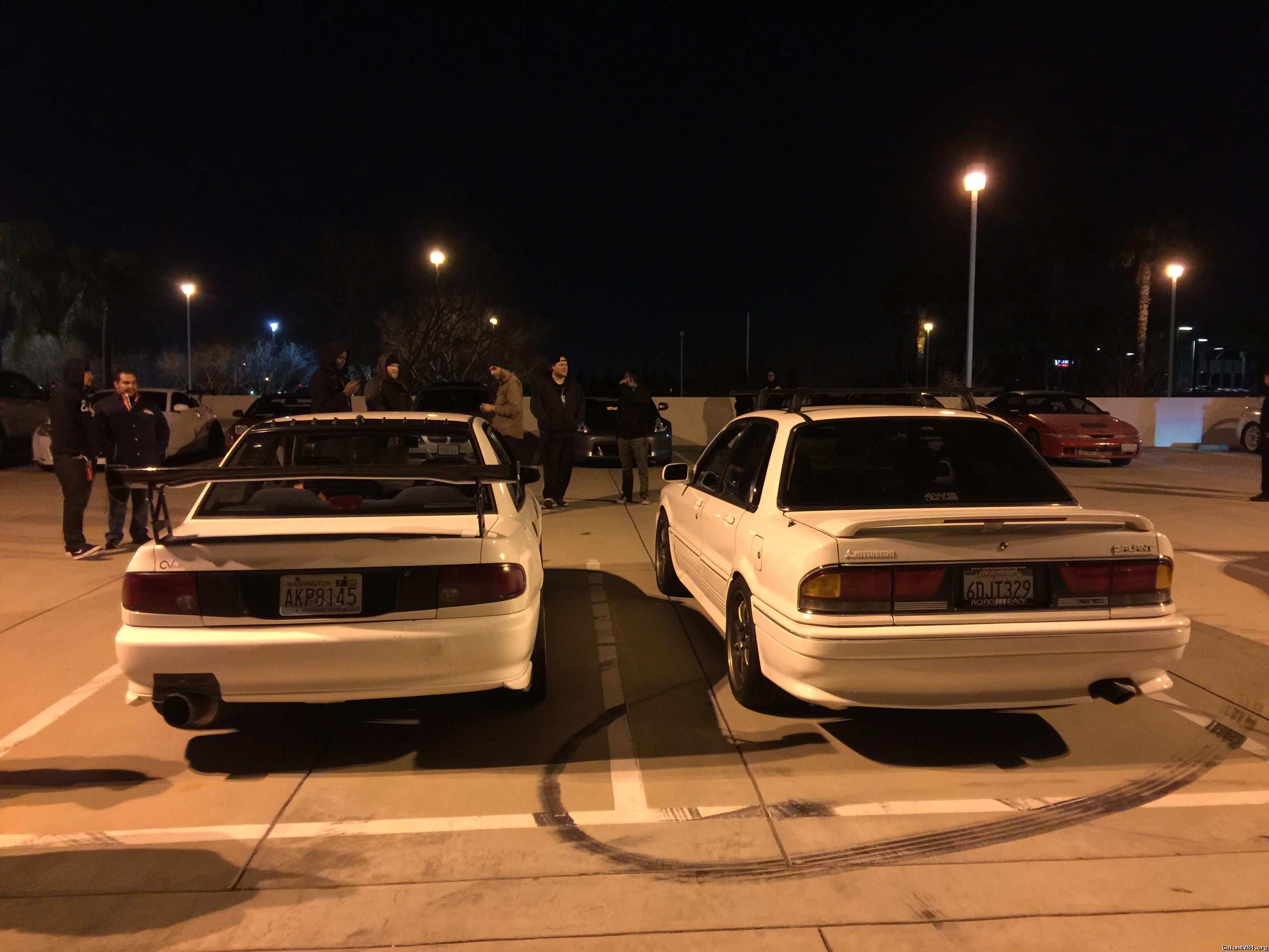

Went to a local Mitsu meet a couple months ago and took a few shots with a locals Evo III replica. It is a full Evo III conversion.
