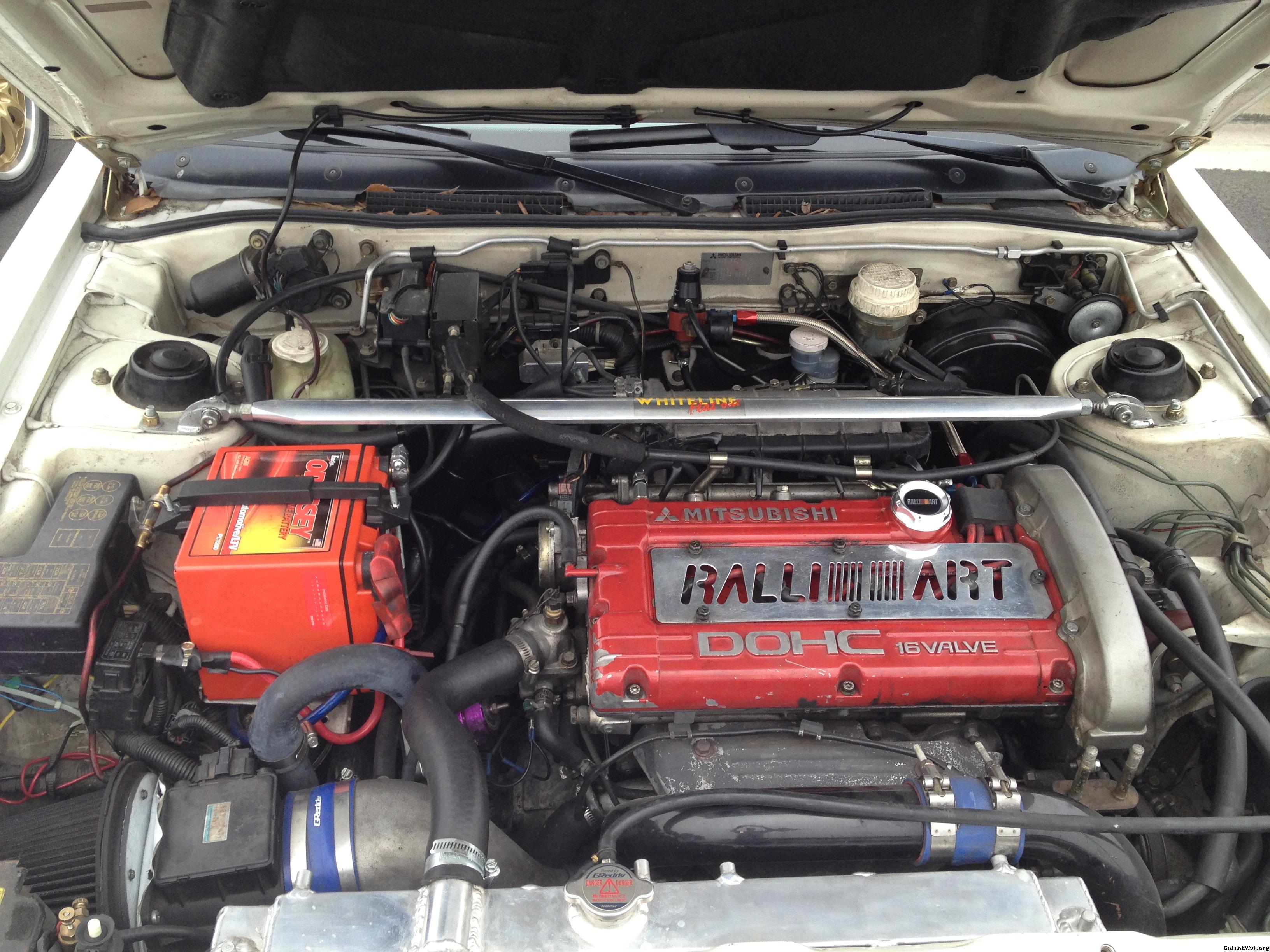

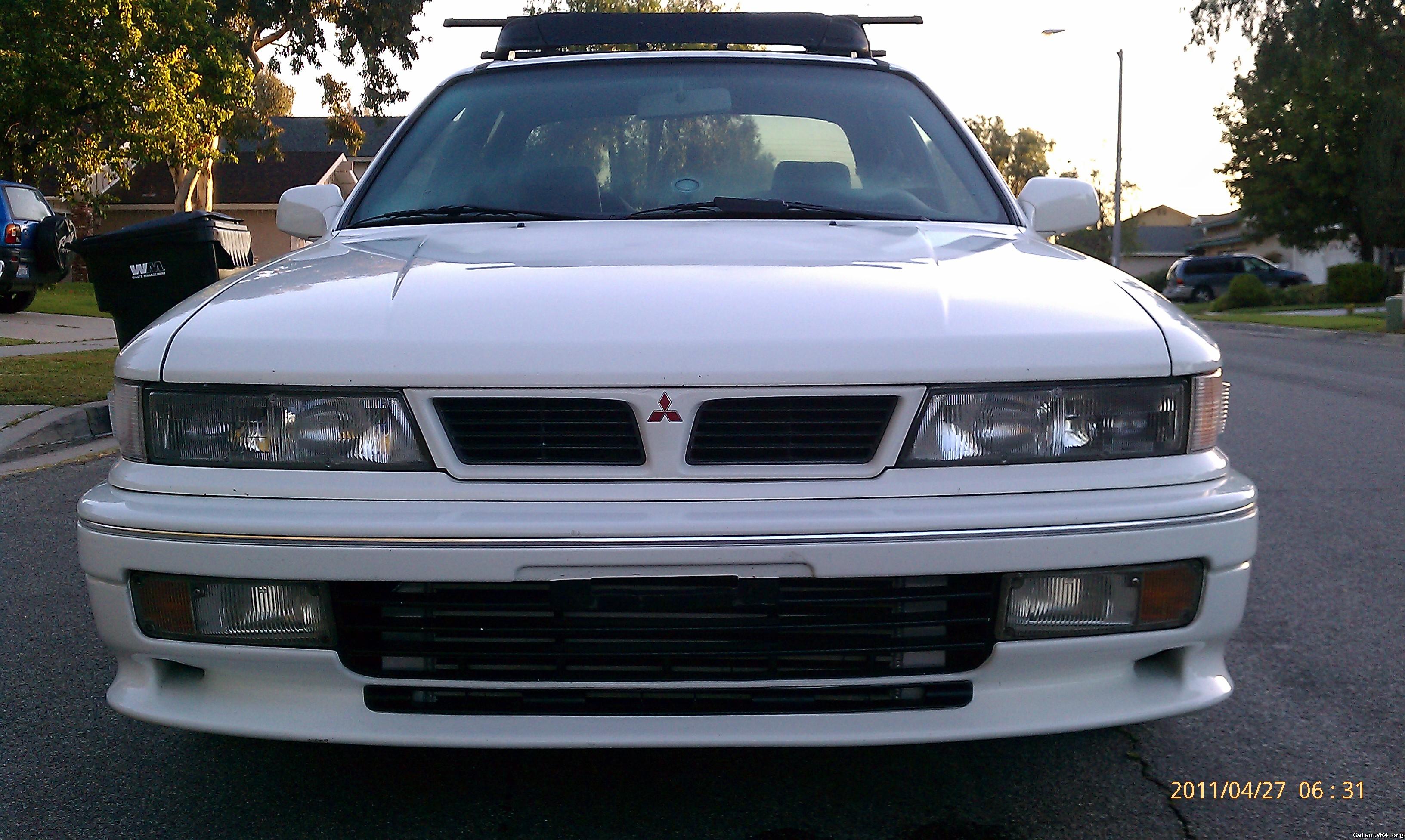

Dirty Engine Bay pic:
I recently added a Quaife Front LSD when I had the transmission rebuilt by Jacks again. 2nd gear and the center spider went out for some unknown reason.
I got the car back from RRE a couple of months ago. Since between work and school, I have not had much of a chance to do to much to it. I did decide to stop daily driving it on my 80 mile commute as I don't want to risk having it hit.

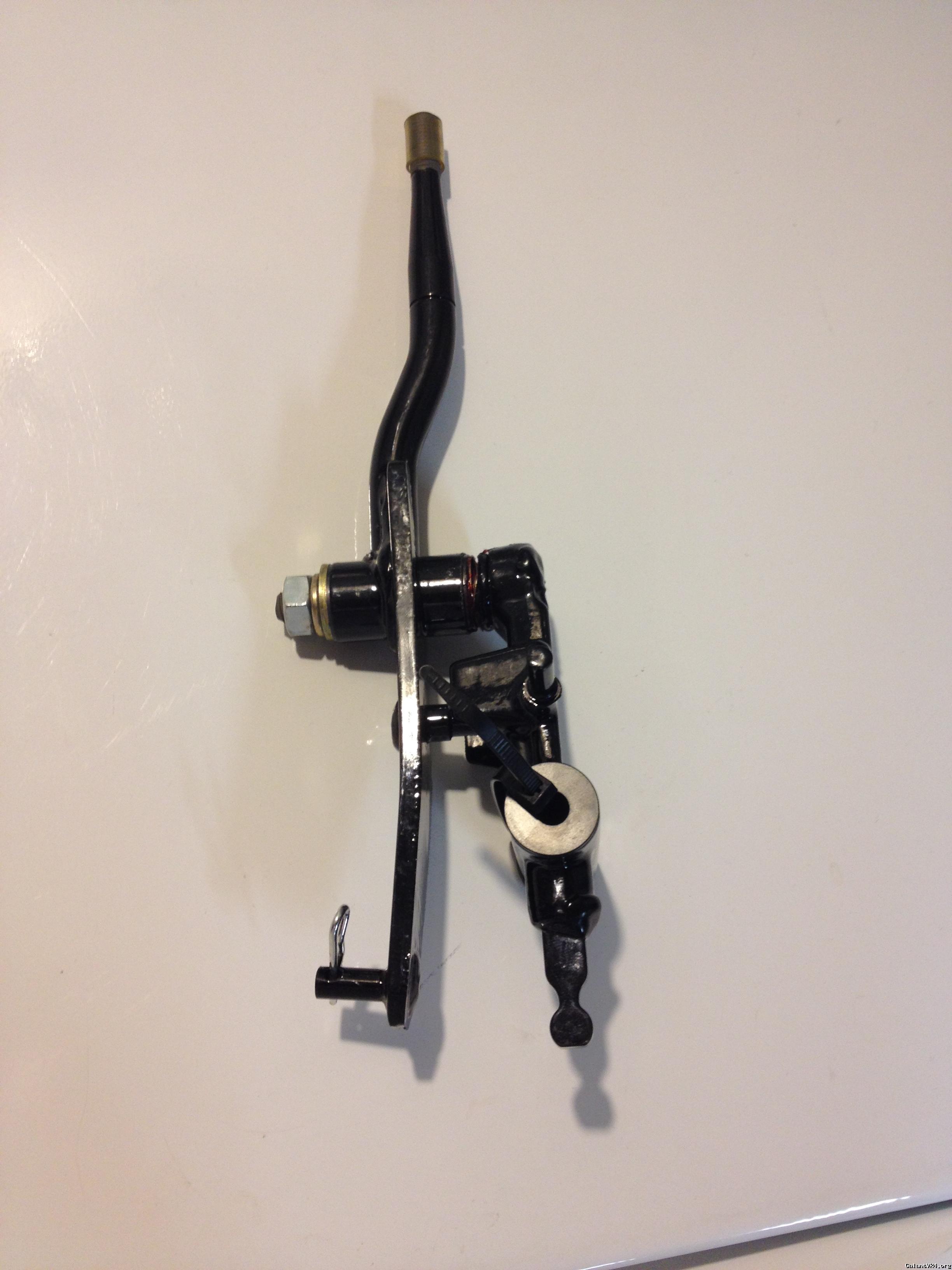

I finally got around to installing the JNZ Short Shifter a few weeks ago whith my Greddy shiftknob. I had a 1g shifter in there before.

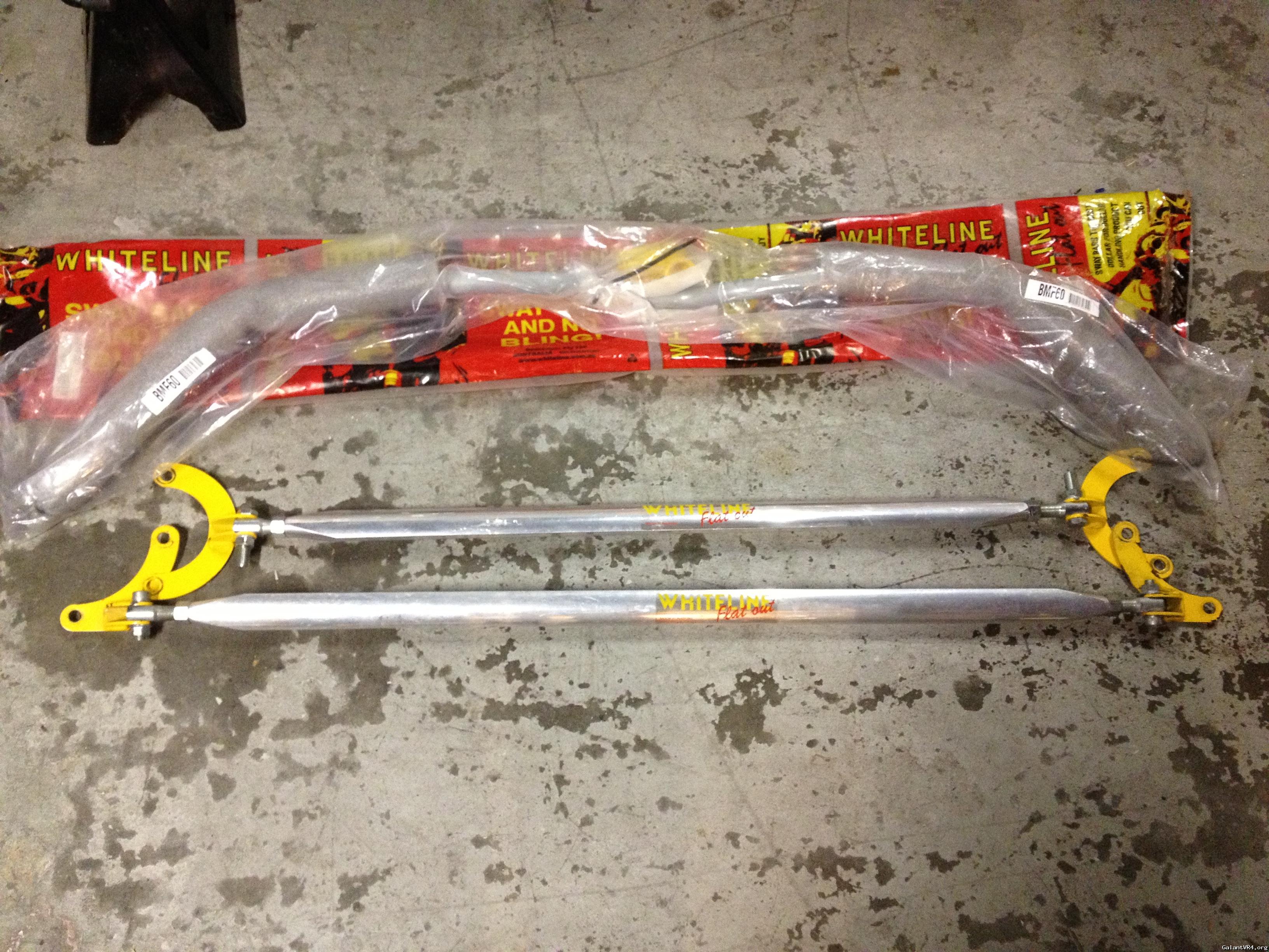

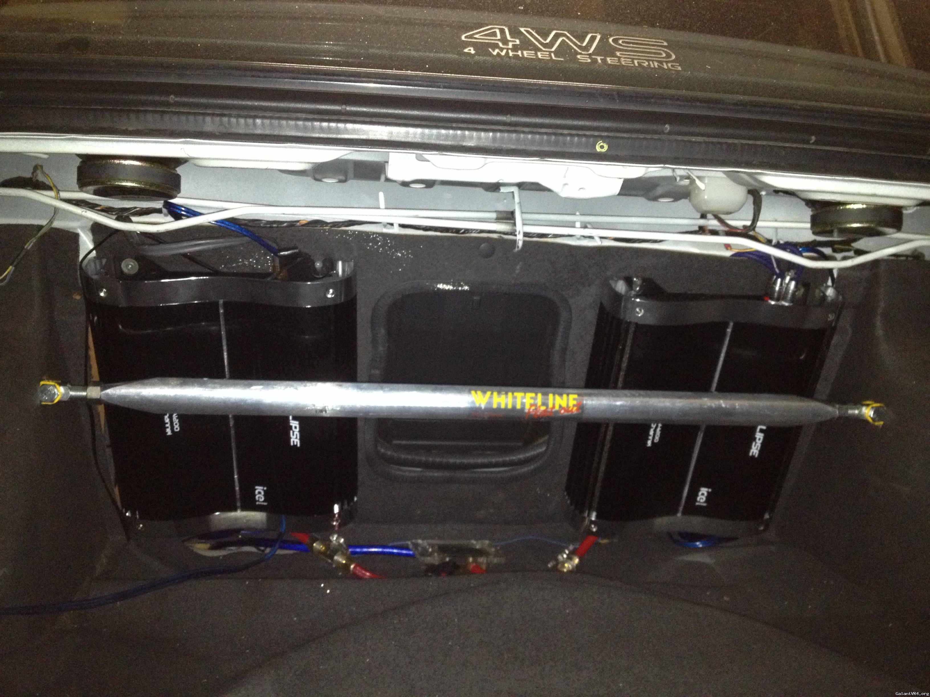

I finally installed my Whiteline Rear strut bar to complement my front Whiteline Strut Bar and WL Rear Sway Bar. I had RRE install the Whiteline front sway bar along with a rebuild rack and pinion with new tierods due to leakage while putting the transmission back in.
3,473
Car looks good, man. Looks like a serious sound system. Watcha got back there?
10,992
Nice. Well put together car.

Quoting GSTwithPSI:
Eclipse 7100 Headunit, Eclipse ZA1200 AMP, Eclipse 4200 Amp, Alpine Type X Sub in custom made GVR-4 sub-box. Eclipse 6 1/2 speakers, Eclipse 4" Speakers. Now that I have retied its DD duties I may pull out the sub and amps.

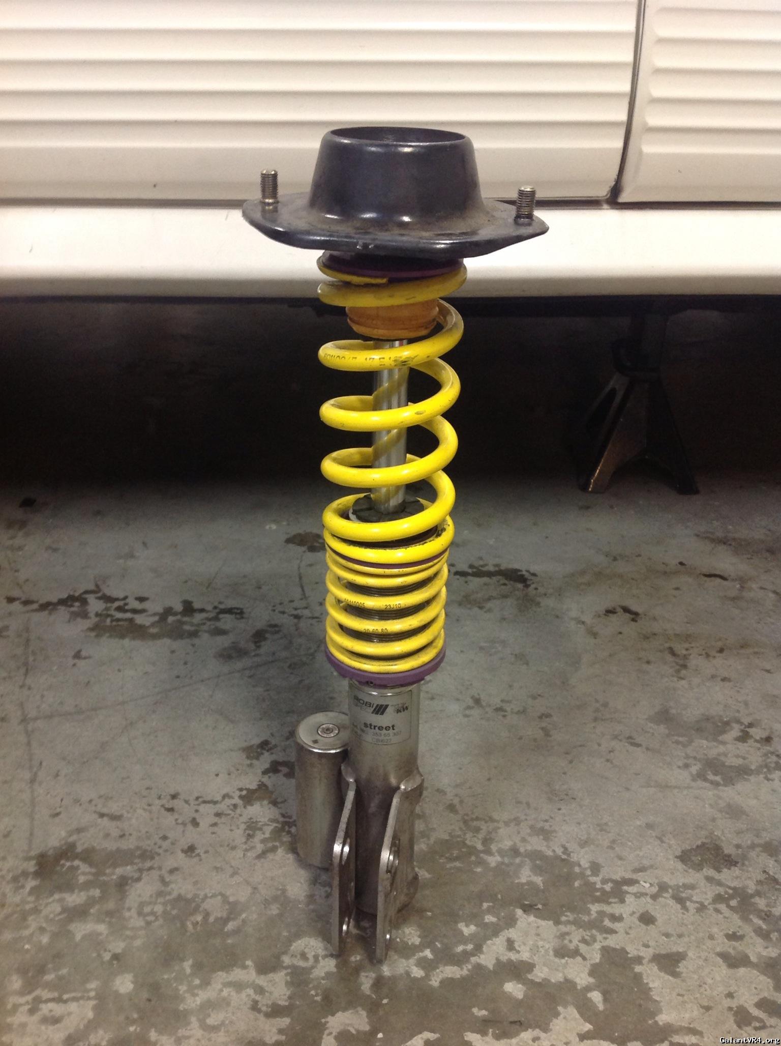

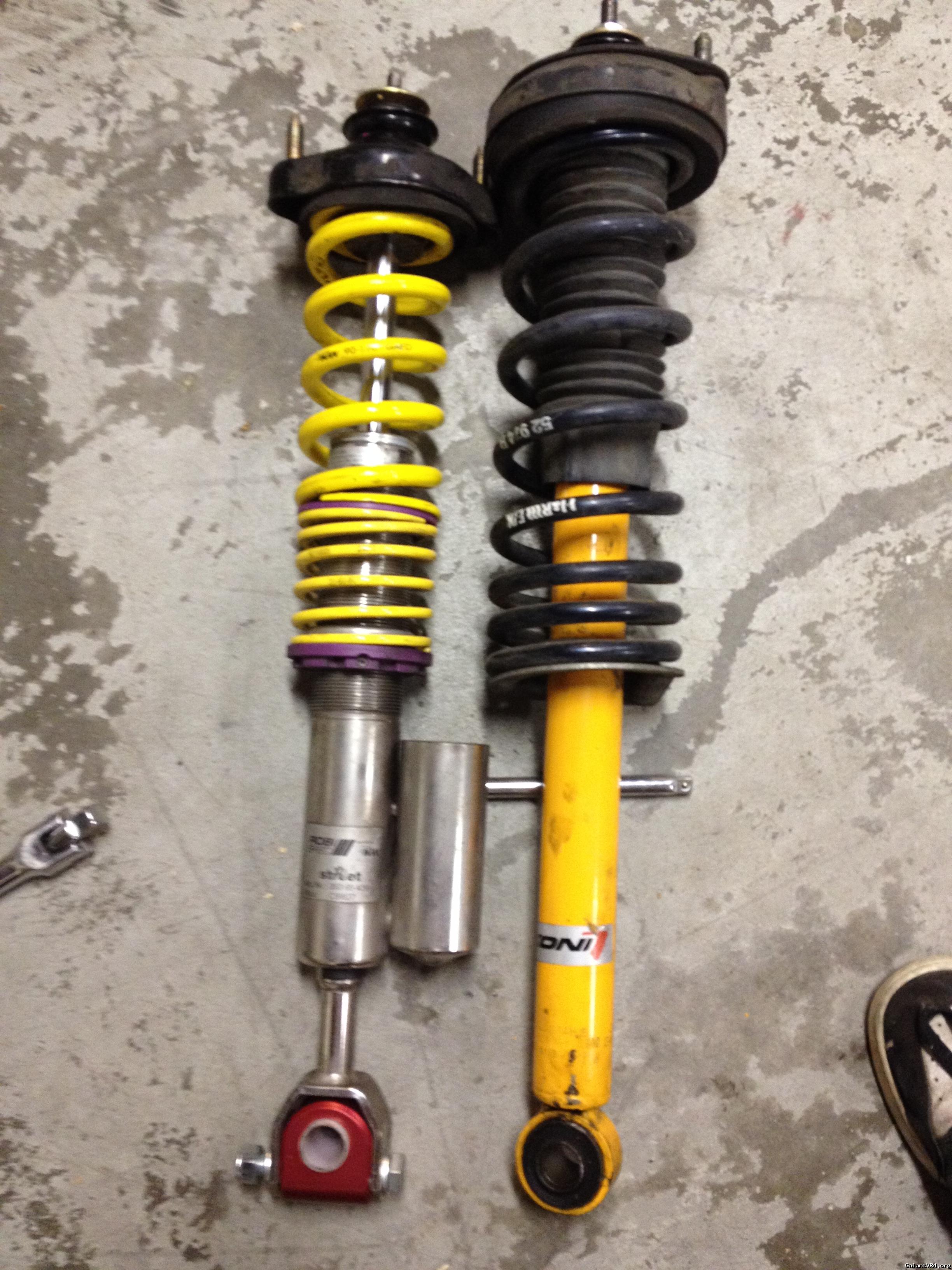

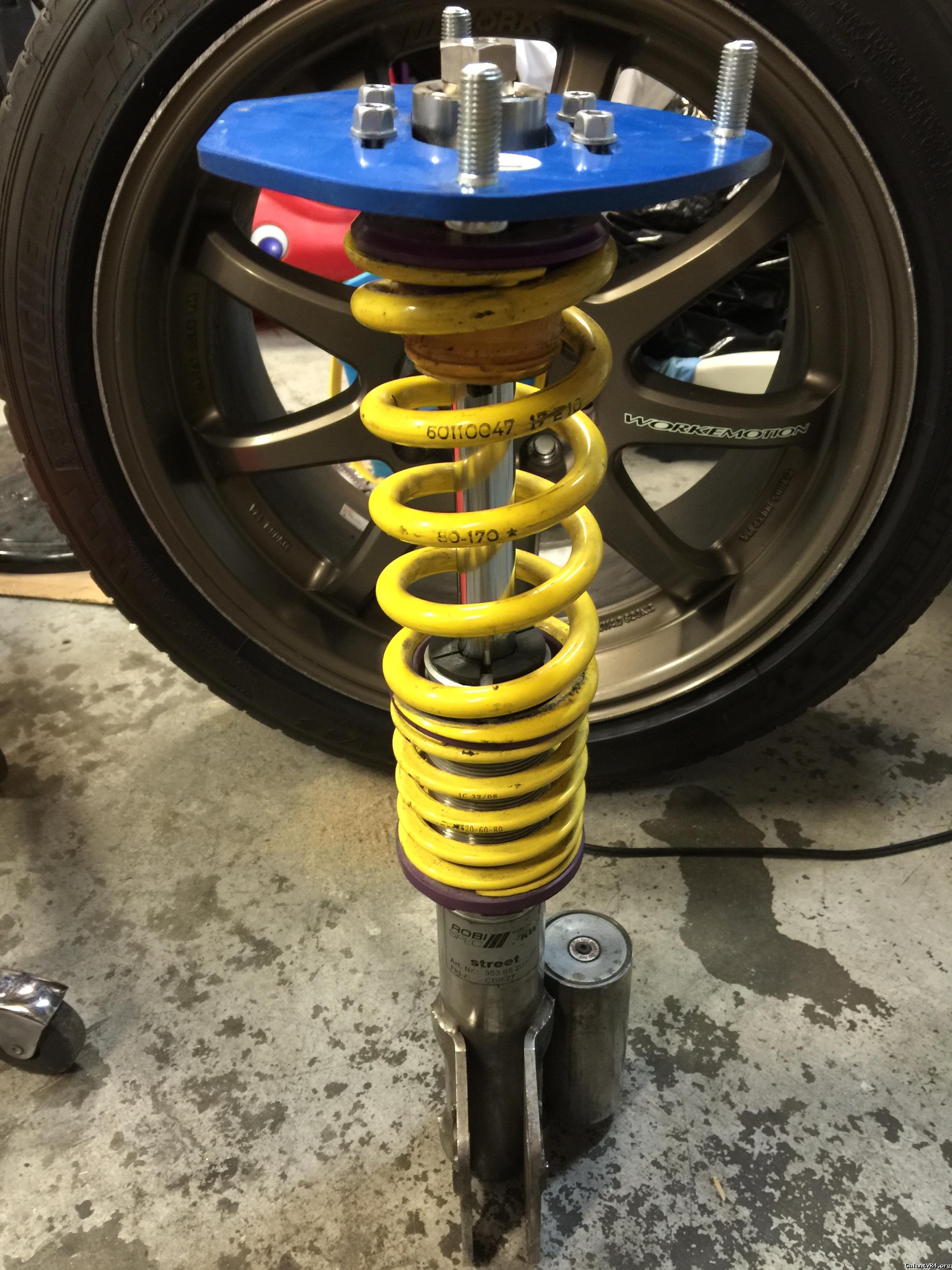

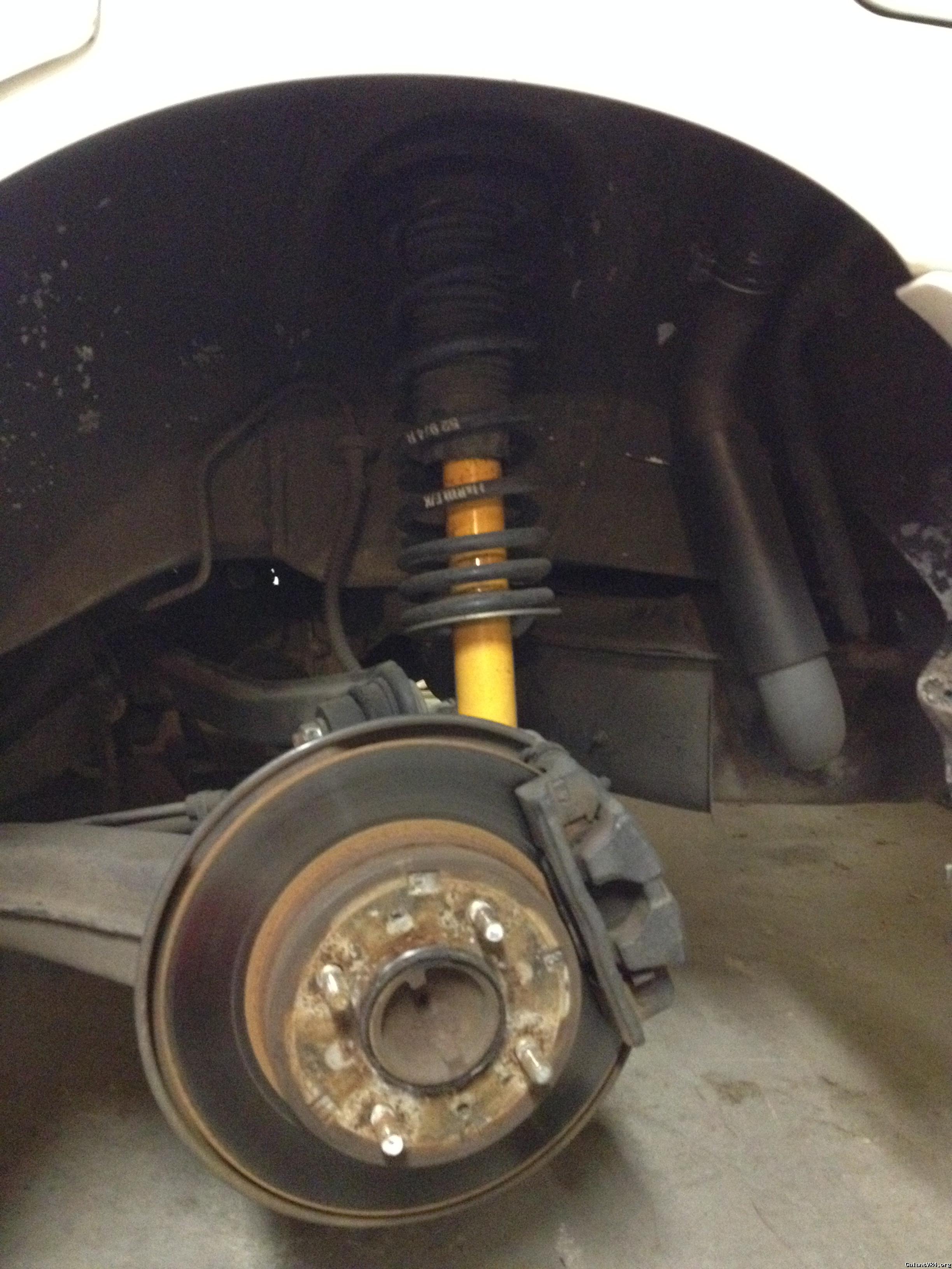

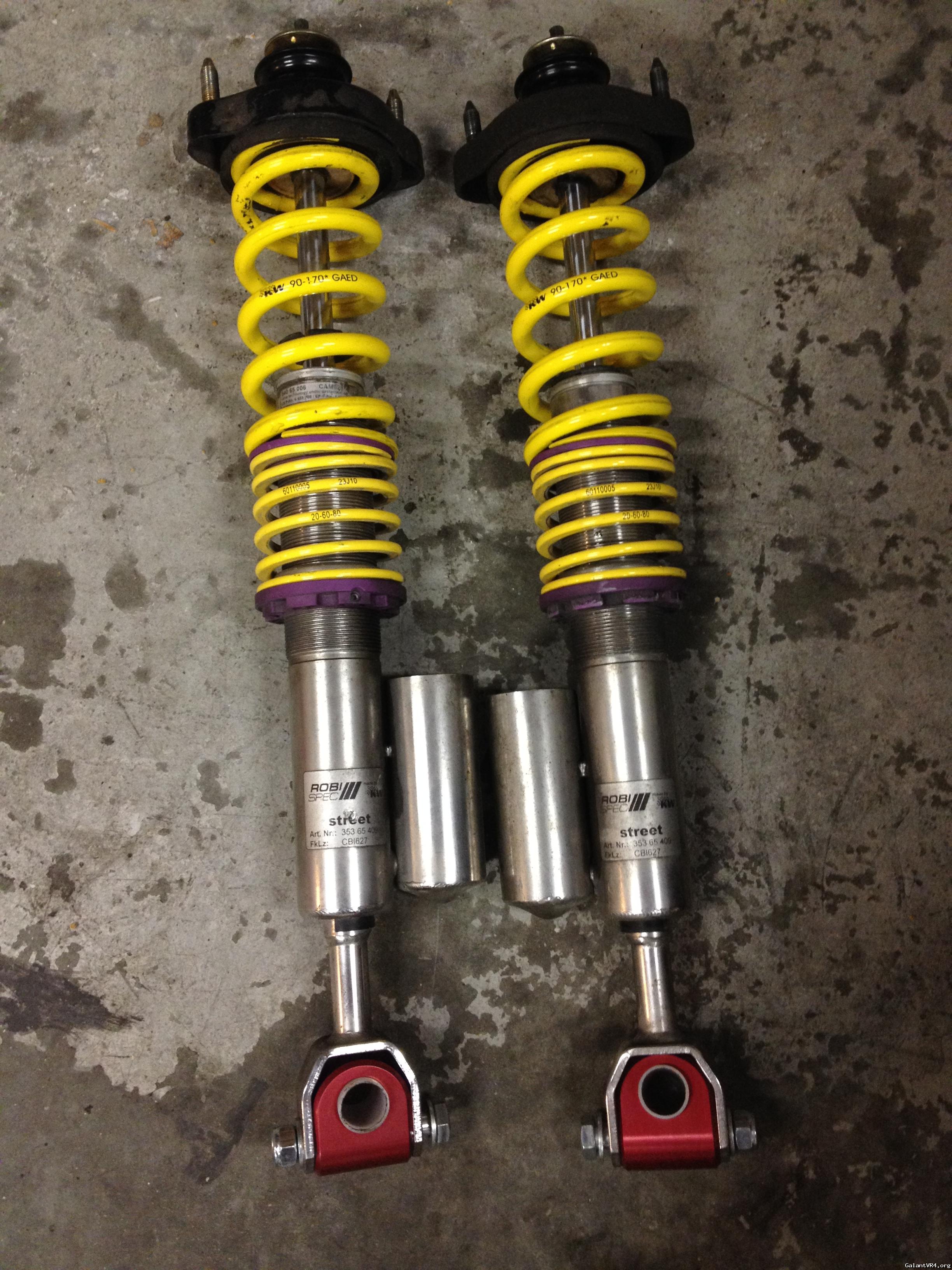

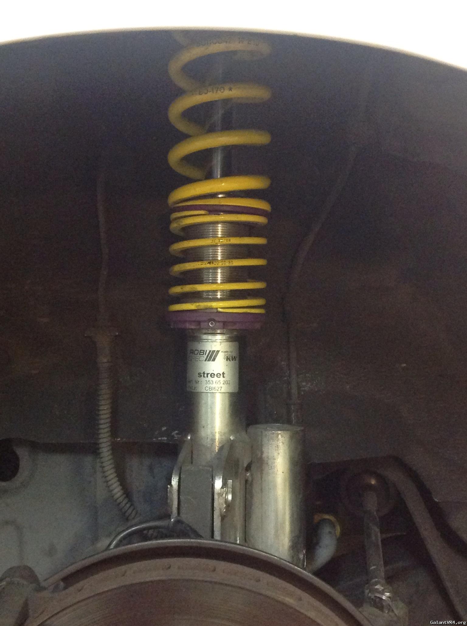

Last week I started to pull out my Koni's and H&R springs. I started with the rear.
To put these in:
They are KW V3 Robispecs with OEM Evo tophats. I used the Supercar Engineering rear adapters. They fit perfectly. Well worth the price. I did not purchase the front as it seems very steep for 4 bolts and some washers.
Here they are installed in the rear.
I will hopefully try to install the KW's in the front this or next weekend.

Quality parts and execution /ubbthreads/images/graemlins/applause.gif. How do you like the Koni's with the H&R's? I am still researching other spring options before I get GC's. Those K-dubs though. Also, where did you get that GReddy air intake pipe? Never seen that before. Also, what wheels are those?
KiNgMaRtY
Apr 8, 2008
855
Corona, CA
^ Thank you. The Koni/H&R spring combo is by far my favorite DD setup. Koni/H&R Springs > Bilstein/Swift Springs.
Tee Koni's are just just that good and smooth. When adjusted they will transform as needed.
I manged to find the Greddy intake pipe from a Greddy Turbo kit that was being parted out from a 2g. The pipe was never sold individually from Greddy, only when someone purchased their complete turbo kit.
I am really looking forward to getting the KW install finished and see how they feel on the GVR-4.
Wheels are ADR's.

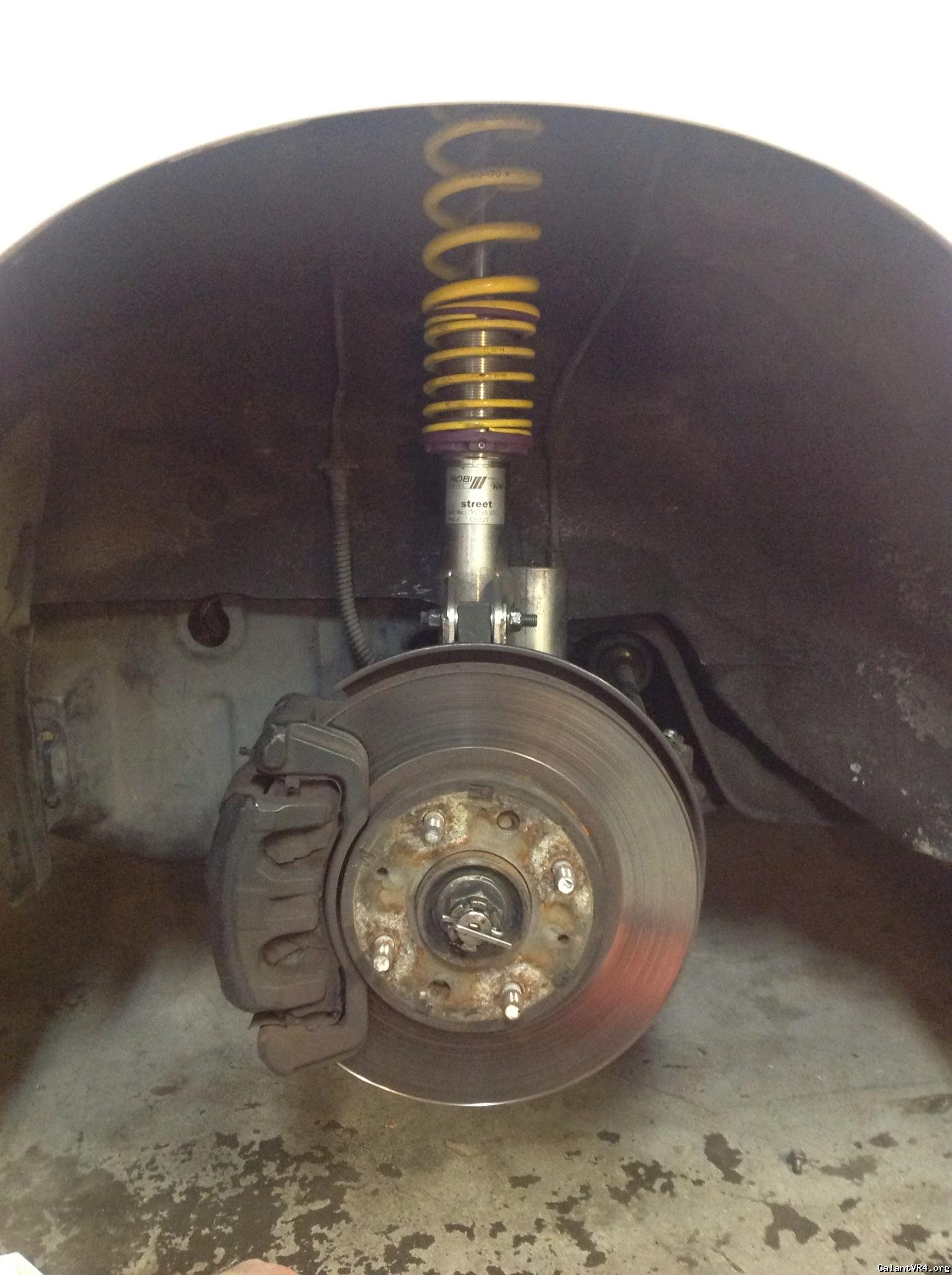

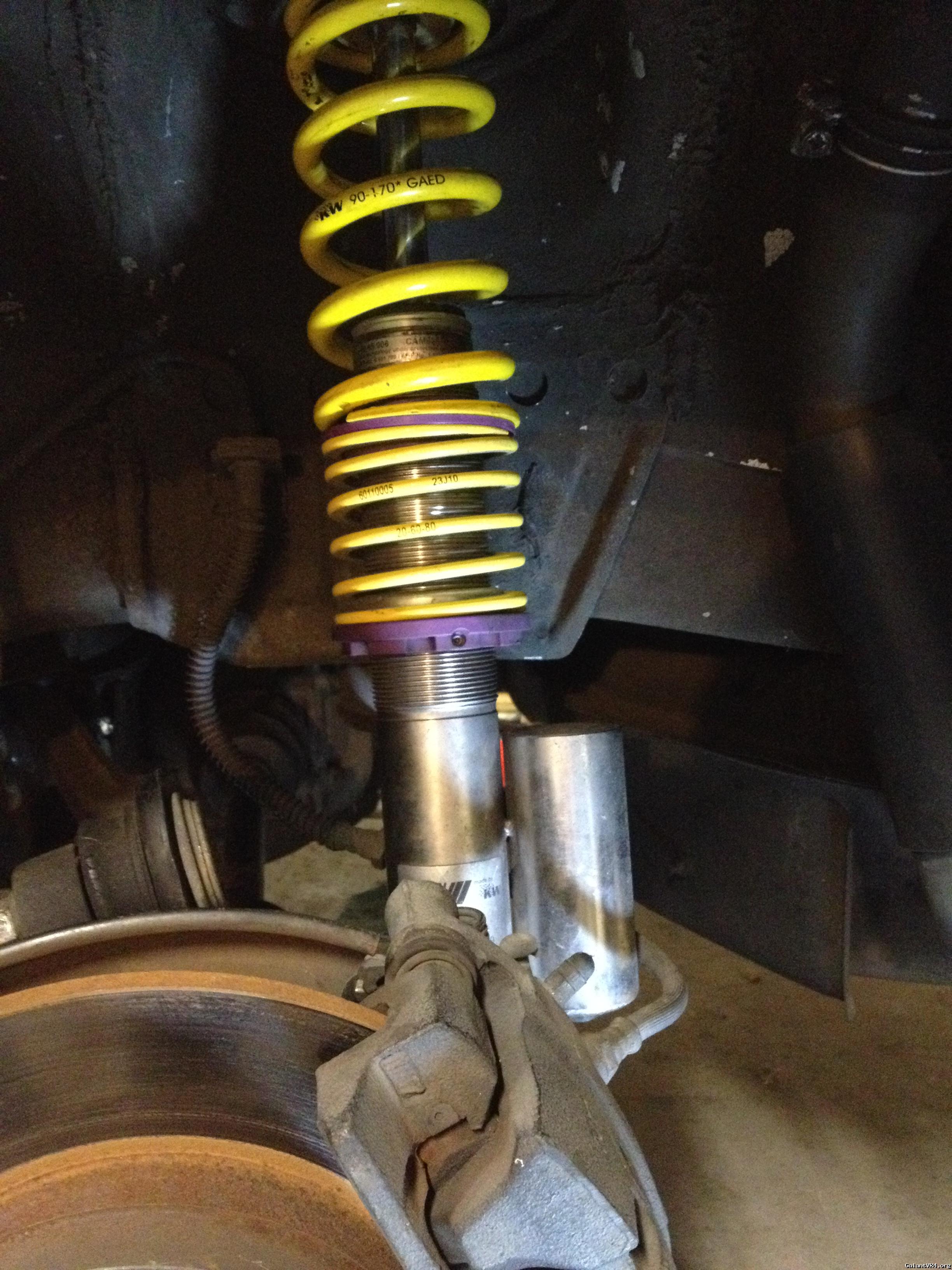

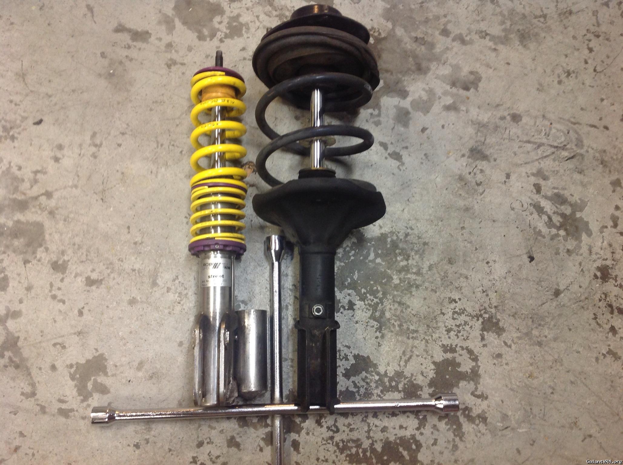

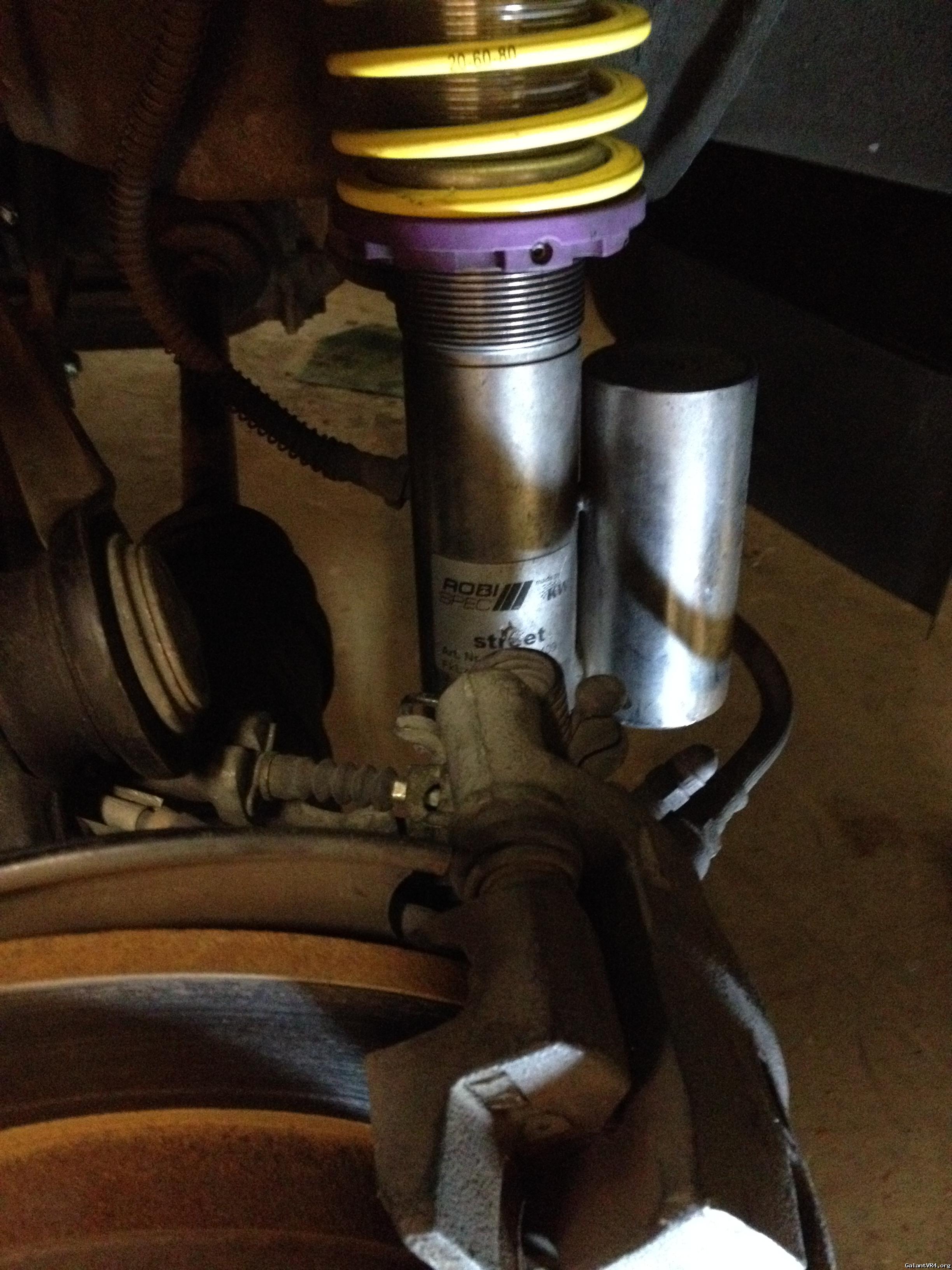

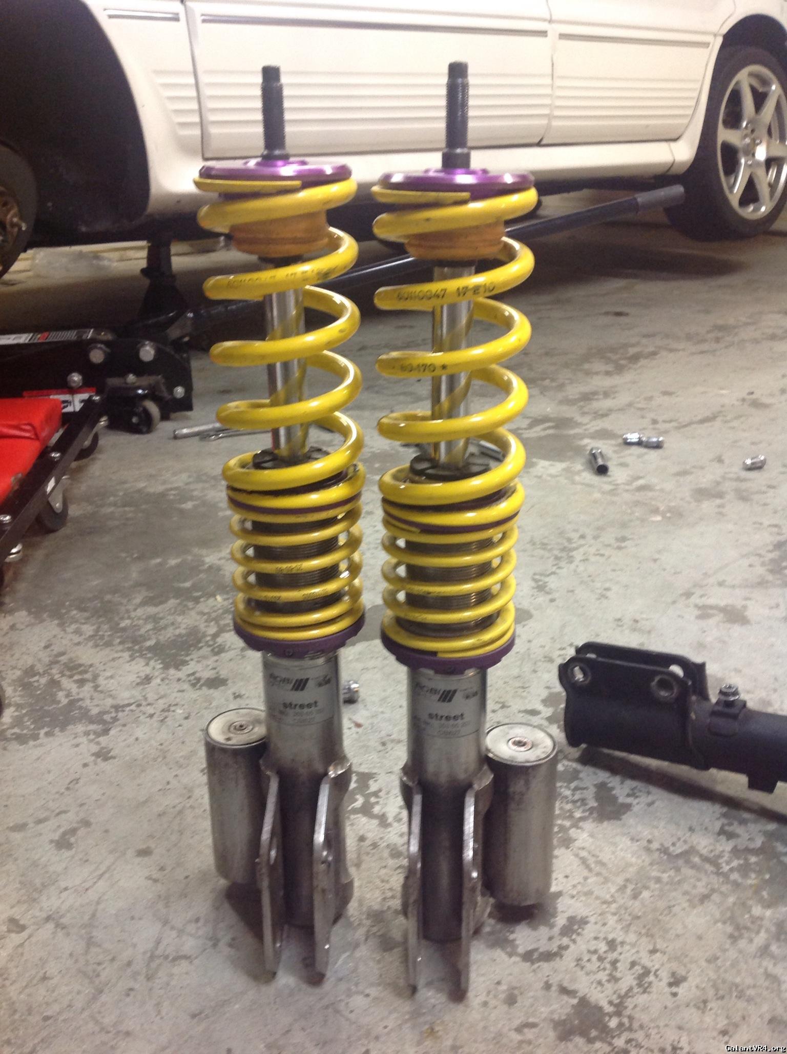

I got the front KW's installed over the weekend.
KW next to my Koni insert setup with H&R springs:
KW's with GVR-4 Top hats
Installed:
The front required "spacers" in between the hub and the Evo style struts as the ears are spaced out 5mm wider
Here it is all bolted up.

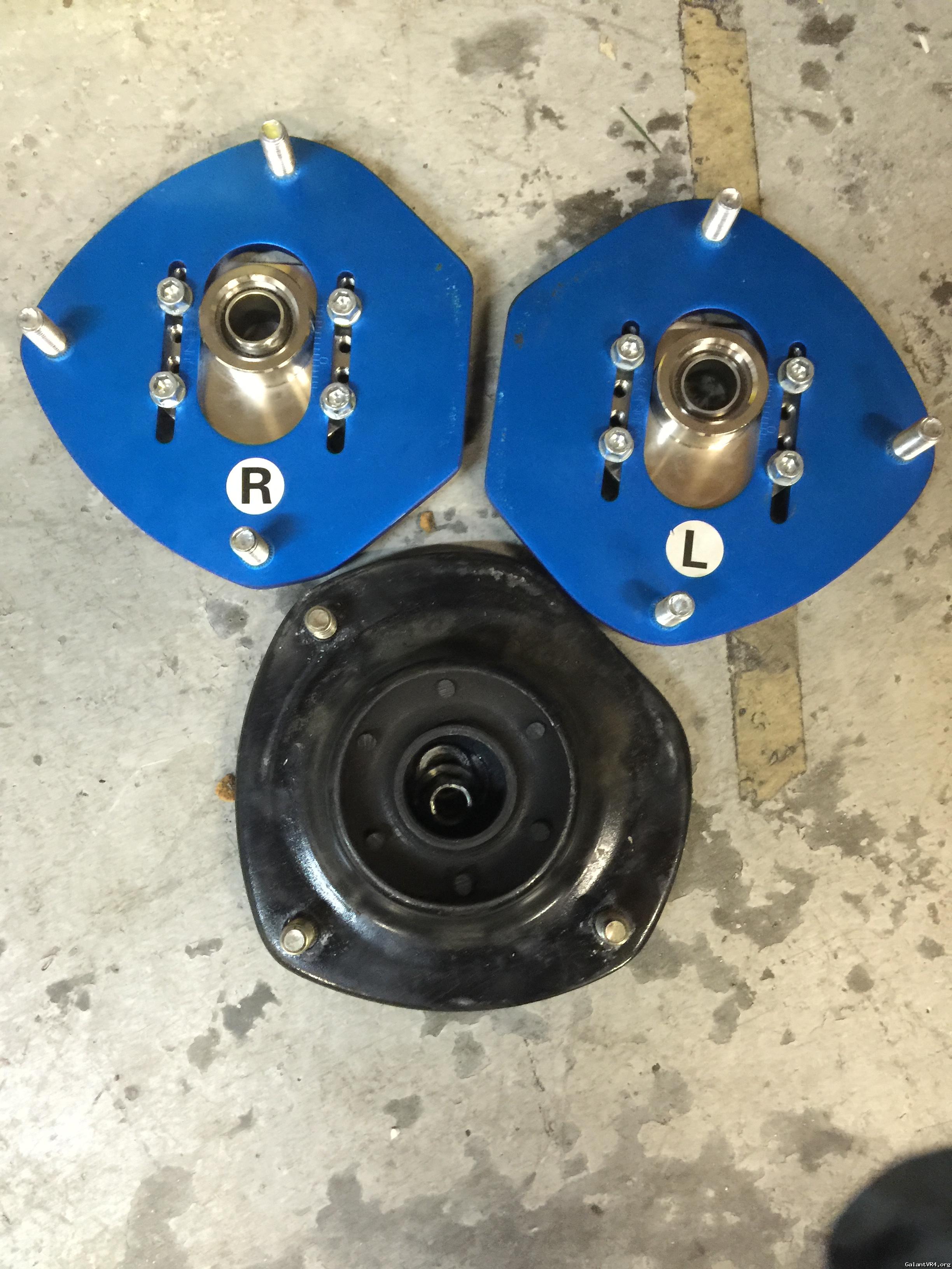

I replaced the OEM strut mounts with Cusco pillowball mount camber plates so I have some additional adjustment room for camber.

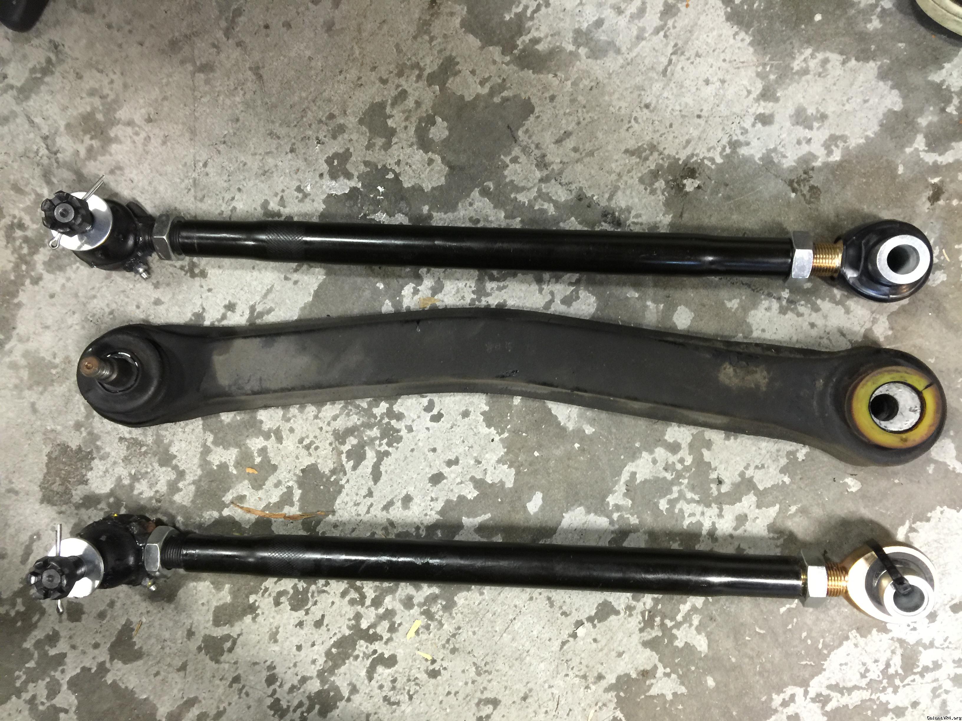

I also replaced my rear camber arms that had Whiteline busings for 3SX arms. I purchased them with the boots and the hardware. When installing them, you are much better off using the OEM eccentric bolts for additional adjustment.

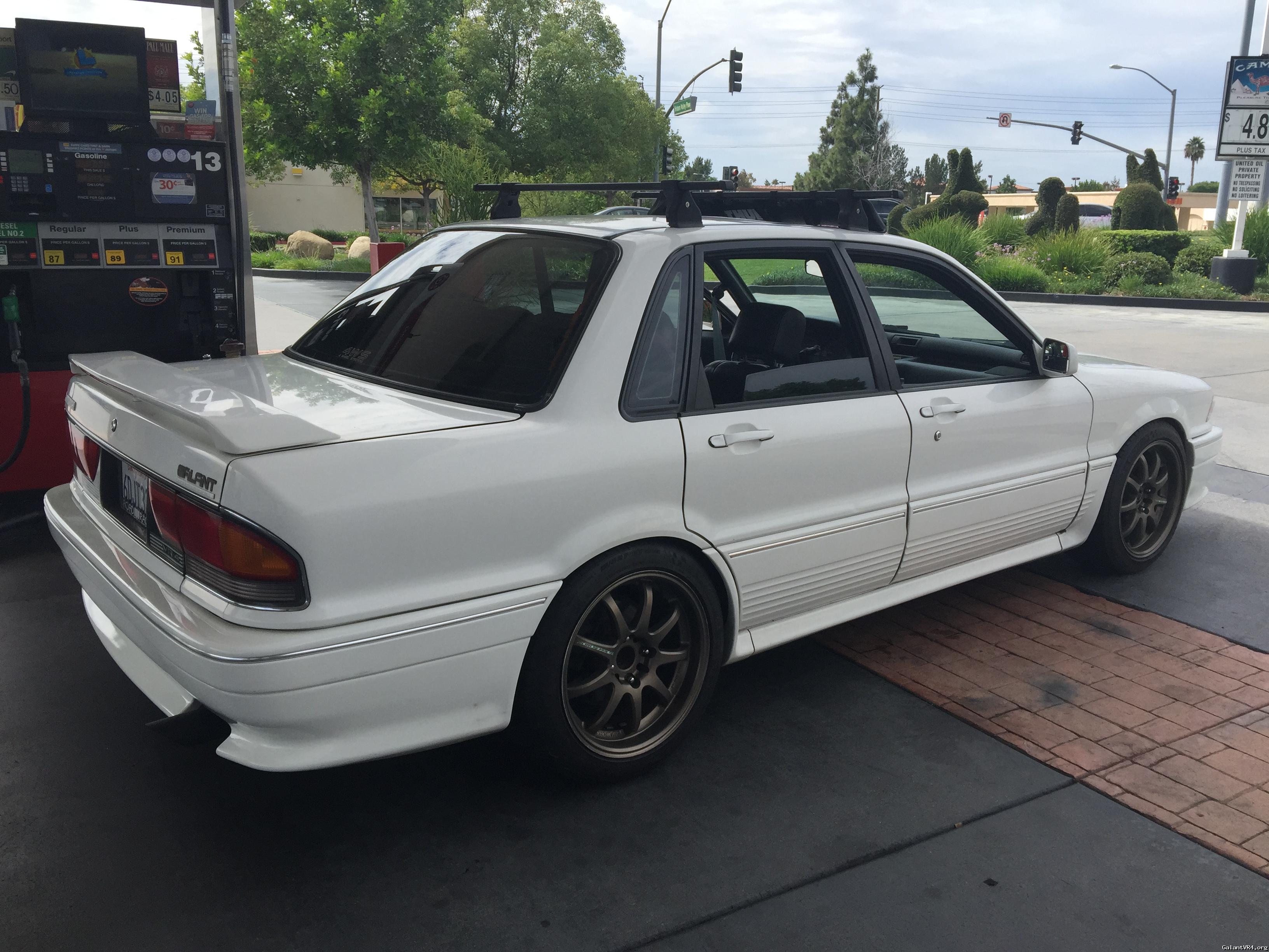

I was also able to score a set of 17x8.5 +42 Work Emotion XD9 Wheels. They came with Michelin A/S tires in a 235/45/17. I will be replacing them soon with some stickier tires in a 245/40/17.

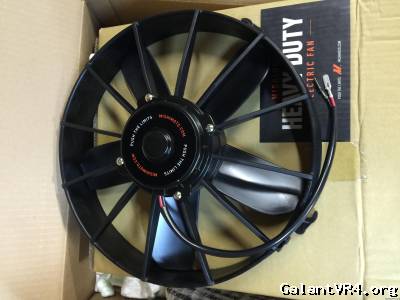

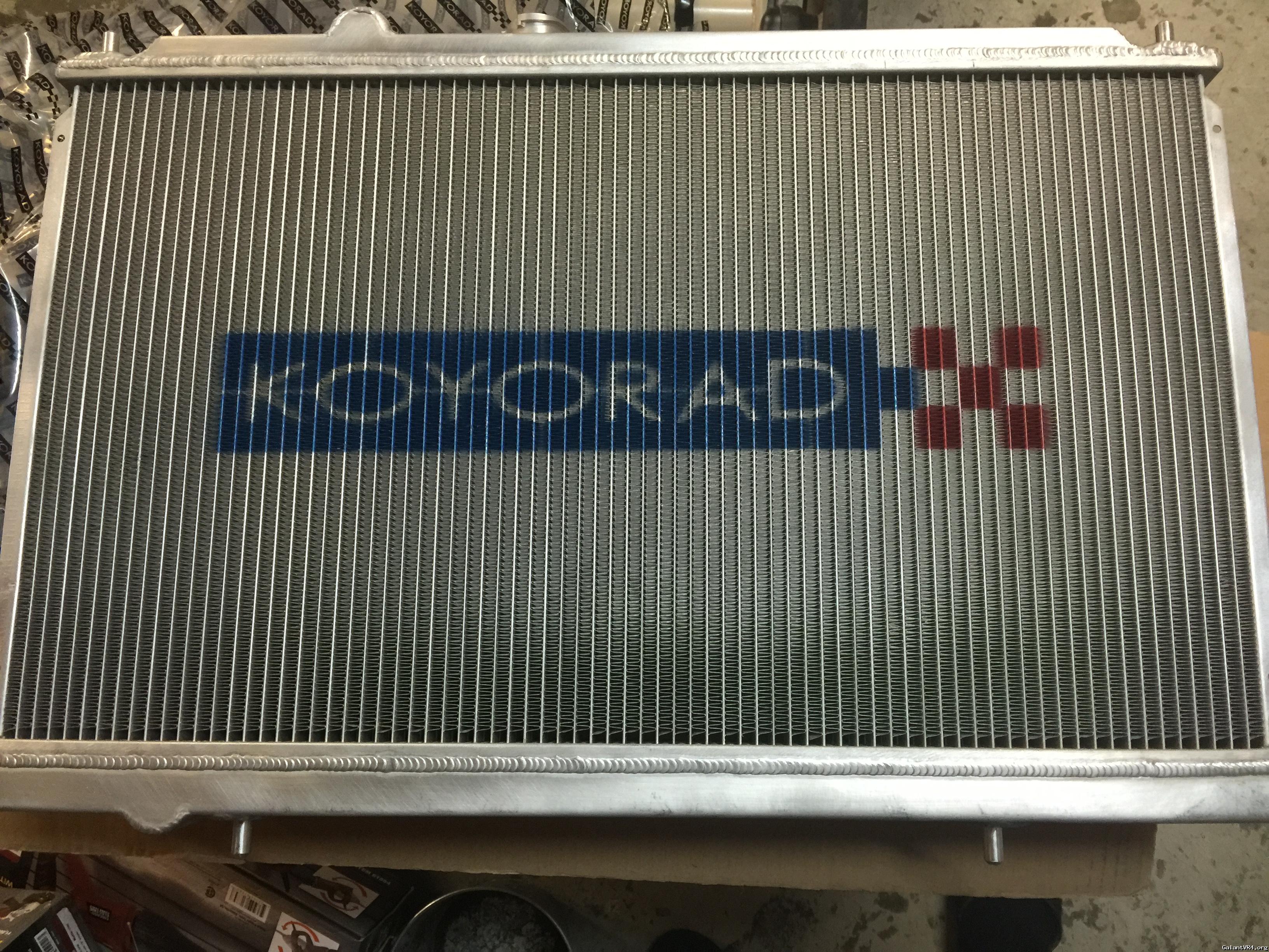

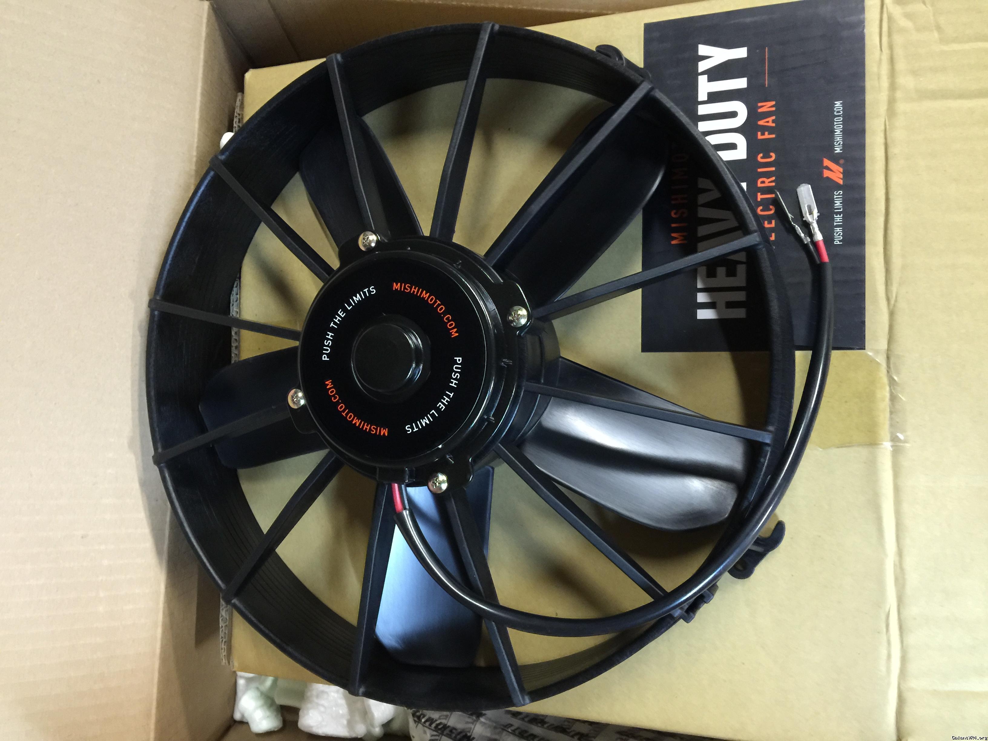

I swapped out the Tuners Nation Radiator in favor of the new Koyo Evo 3 Radiator that replaces the R series. I swapped out the shrouded Flex A Lite fan for the New Mishimoto Raceline series shrouded fan.
