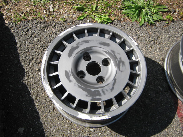

More finish sanding, some filler primer over the putty.
Untitled by Drew84(PASCARPHOTO), on Flickr
Feathered down the filler primer
