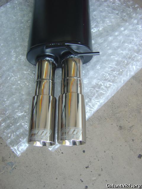

I got the exhaust Tuesday from CM Performance. I'm a little bummed that the dual outlet system is a Y pipe not dual tips. But as far as fitment goes its really nice. Since I'm not a fan of polished exhausts I painted with heat paint yesterday in the morning while the turkey was cooking.
IMG_0942 by Drew84(PASCARPHOTO), on Flickr

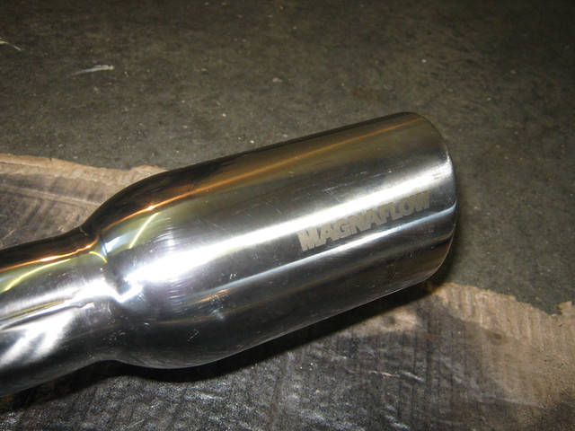

Not a fan of this either, I will sand and polish this off.
IMG_0943 by Drew84(PASCARPHOTO), on Flickr
IMG_0944 by Drew84(PASCARPHOTO), on Flickr
IMG_0945 by Drew84(PASCARPHOTO), on Flickr
All painted up
IMG_0946 by Drew84(PASCARPHOTO), on Flickr
Much better looking
IMG_0948 by Drew84(PASCARPHOTO), on Flickr

Is that the 2.5" system? You have to get the 3" inch system to get the dual tips. Mine is 3". I like how you painted the muffler black. I did the samething. Clean look.
Drew84
Nov 16, 2010
240
Peabody, Ma
Yeah that's the 2.5, I'm not worried, the black paint made it look a lot nicer. I like you car a lot by the way.
