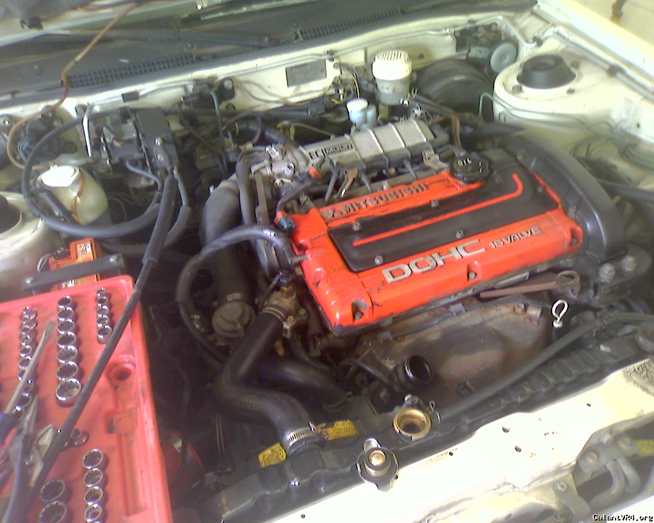

Well i picked up #761 from The Kid a few months back. I haven't had any time to work on it because i've been working on my crx and busy doing wedding planning crap. I finally had a free day yesterday since our softball game was cancelled. So, i started to rip it apart.
Here is 761's FS thread:
TK(thanks again for the car), the PO, said the HG was bad and it definitely was. I did a compression test and it came out 150-140-0-0 and yet it still ran. Here are some pics from the day taken on my treo so they're not the best quality. Hopefully i can get it up and running soon. All i need is a balance shaft belt. I already have a low mileage head to throw on with a new OEM HG.

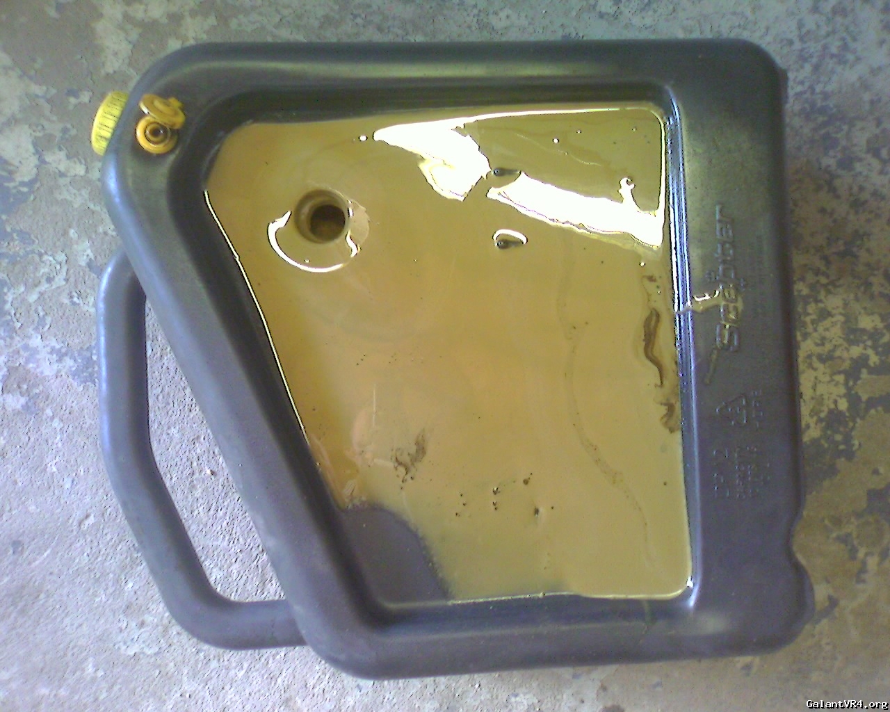

The oil didnt look all too good. /ubbthreads/images/graemlins/uhh.gif

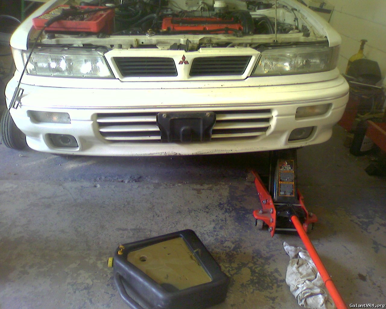

here's a pic of 761 jacked up:
With the head on:

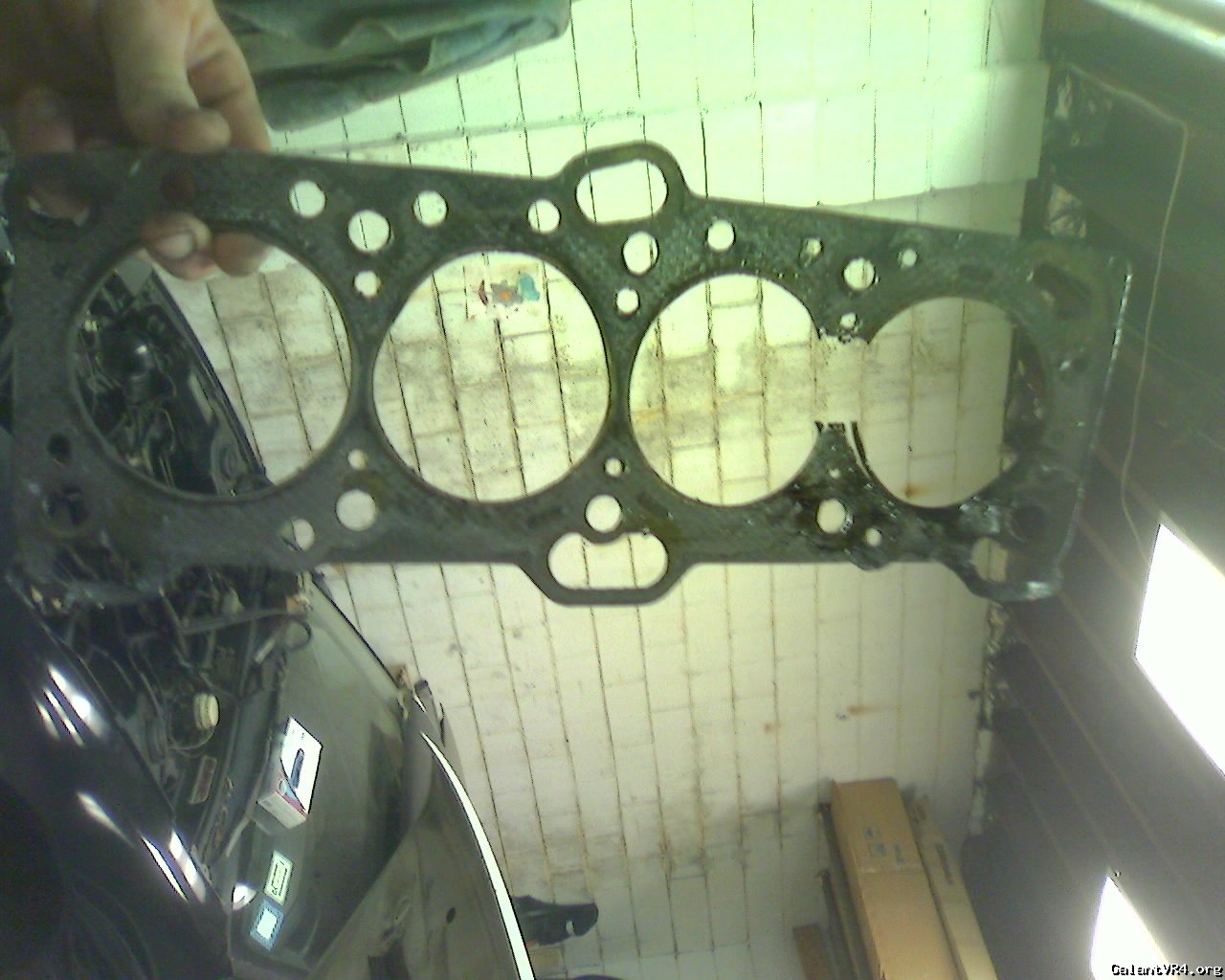

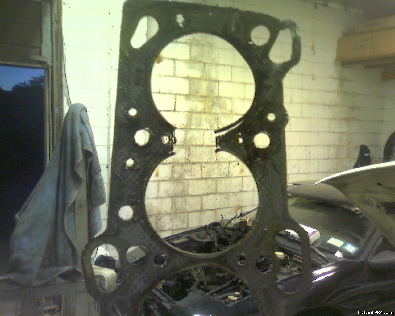

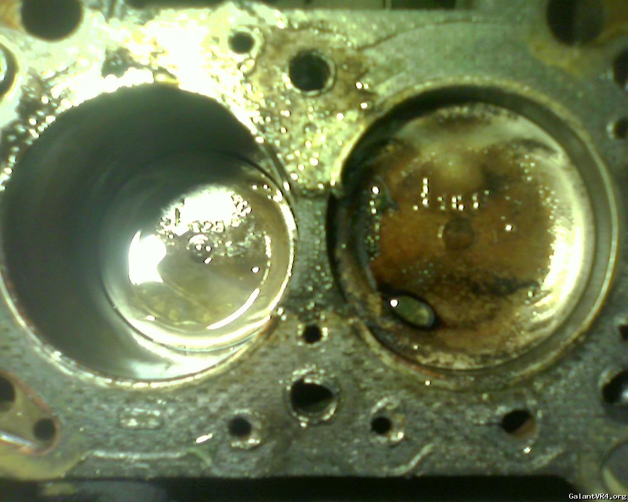

and off...with a bit of the HG missing:
/ubbthreads/images/graemlins/uhh.gif /ubbthreads/images/graemlins/uhh.gif

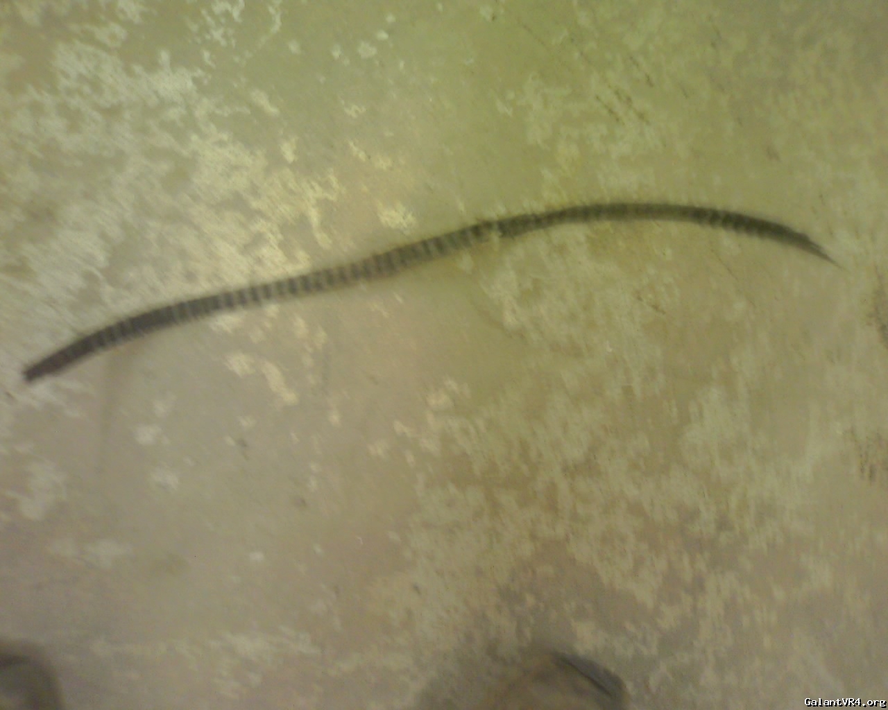

When i pulled off the timing cover i was noticing little pieces of timing belt. Yet the timing belt looked fine. Yup, the balance shaft belt didn't look so good...
Random driving around pic:
Grats on the VR-4! Looks like someone got hungry and ate a chunk of that HG. /ubbthreads/images/graemlins/rofl.gif

From what i can tell it went because the belt was old. The balance shafts were still looking good and not seized. I didn't check through the paperwork the PO gave me with the car, but he said it was replaced recently. The car sat for a while before i picked it up so I think time did its work on the belts. I checked what was left of the BS belt and it was brittle and there were cracks on all the nubs of the belt. The next thing i checked was the TB and it was looking bad too. It was getting dry rotted along the teeth as well. So, i'll just replace it for piece of mind. I am heading out the shop tonight so if i bring my good camera i'll take some more pics of it.

I just checked through the paperwork the PO gave me with the car and the timing belt and balance shaft belt were replaced on 1.6.06 by Andre at Pina. So, they're only about 2 and a half years old. Yes, they were both OEM belts too. The car looked like it sat for a year before i picked it up. I believe the belt failed because it sat and started to dry rot.

That my friend is the result of a REALLY bad headgasket failure. It's basically the coolant and oil mixing. It creates that milky substance.
When checking out a car that you're going to buy you should pull off the oil cap. Look under it. If you see that milky looking substance on it that very well could be a blown HG.
