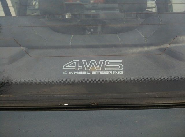

so a lame ass update. but i feel good about what was done, and that's what counts. couple little things bothering me that i can check off the list...still a couple more.
4WS sticker... i dont have 4WS sh*t anymore...

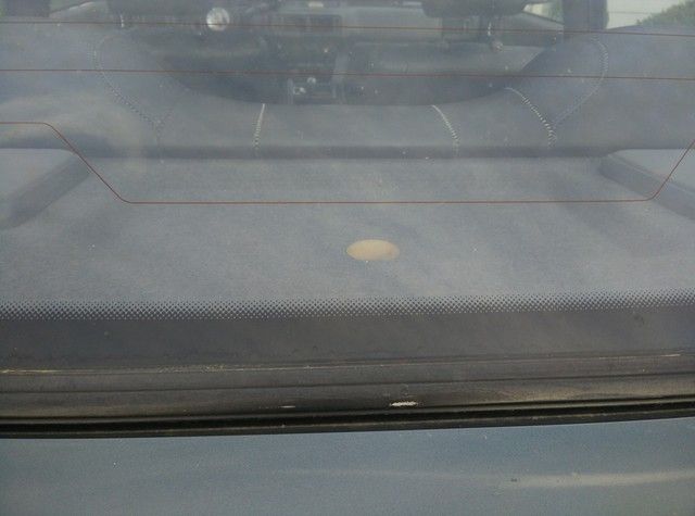

GONE!!!
those caps on the back deck are bothering me too... need to replace/paint/something

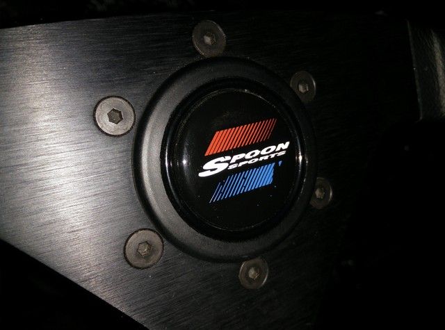

Spoon Sports/MOMO steering wheel :p mounted on a short hub with quick release. i bought this shortly after i got my Integra because i was pissed i left my last one in the CRX, oh and it was a screaming deal. so i put it in the integra. im currently parting that car down so i put it in beater Civic, but why? i like my Galant more, love the steering wheel, and why not? im sure some Honda guys are gonna hate, but i dont care, they annoy me anyway.

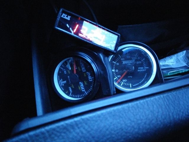

i also fixed my wideband ground. and also put in that new phone mount im sure you can see. wanted my phone in a legit spot to quickly change music...

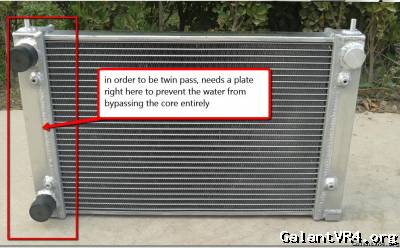

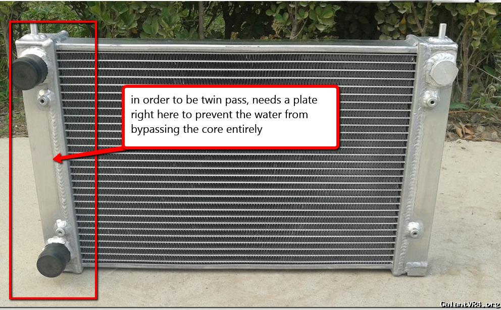

sh*t. so radiator sprung a leak...again. probably could just fix it again. but it is looking pretty sorry. needs to be replaced before i get left stranded.
spent last couple hours looking for radiators. really just looks like the VW style one is gonna be what im looking for.

I think you're going to want an afco... that radiator at least appears to not be twin pass (in fact, it appears to be set up in a way that it's basically useless)...

EHmotorsports
Sep 25, 2012
1,283
Beaverton
Andrew I bought one for colins car and thought the same thing. I cut into it and it looks like they have one inside. I still added the piece since i cut into it but i don't think an additional divider will be needed.

not sure what i want to do on the radiator. rather spend the money on other stuff. but this is an area i would like to spend money on if it is gonna be helpful. i do like the ebay one, as it has a fan switch spot (i dont care if its for a VW, they are easy to get and rewire) and the AFCO does not. but the AFCO has what looks to be a more useable mount.
my math shows that the off brand has less core area than the radiator in my car. the AFCO as more... but does it actually hold more coolant? does it get rid of the heat better? /ubbthreads/images/graemlins/dunno.gif /ubbthreads/images/graemlins/dunno.gif my thoughts are that this is a dual pass. will have a better shrouded fan (passat?) to keep turbo heat off the core along with being tucked more up in grill away from turbo. my Galant has no issue dropping temps to the thermostat/176* when its below about 80* outside when rolling. its only issue ever has been sitting. and current setup will stay 200-205 no problem.
i will probably go to the junkyard and get a switch w/plug, and a Passat/whatever dual fan. i remember running one in my GTI way back and it worked well.

to be honest I have seen them work as well or slightly better than factory. On my car, it doesn't like sitting in traffic & idling. I think the fan I have combined with not having proper ducting is kind of screwing me a bit (big oil cooler + Spearco 2-216 in front). I'm going to revisit that and see if I can make it work a bit better. The other thing is that while my manifold & hotside are ceramic coated there is a ton of heat radiated & thermal mass there. Getting blankets is at the top of my to-do list right now as a result. Rolling my car has no problem staying 180-190 even doing repeated pulls, however sitting it'll climb from 180-200+ pretty quickly. when I'm sitting I force the fan on full time and run the heater to ensure that it doesn't get too warm. /ubbthreads/images/graemlins/frown.gif
Evan,
if there's a piece that prevents the coolant from bypassing the core, and forces it to go out & back, I think it's probably fine. On the afco, you can see it welded from the outside. I haven't put a fanswitch in mine, but when I do i will probably put it closer to the top of the radiator so it comes on a bit earlier.

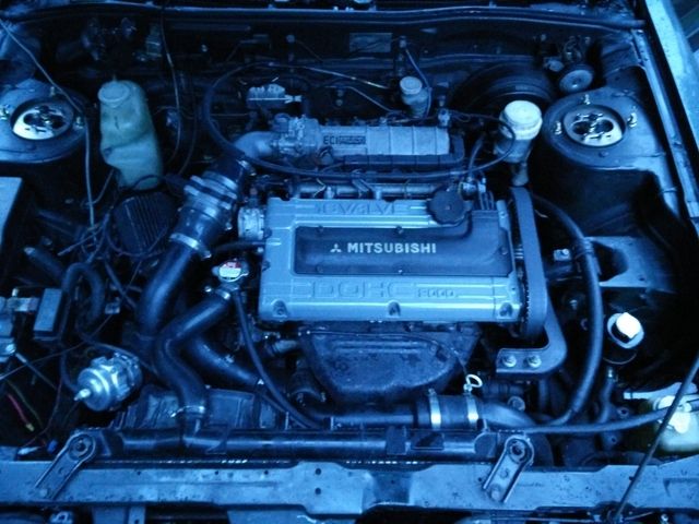

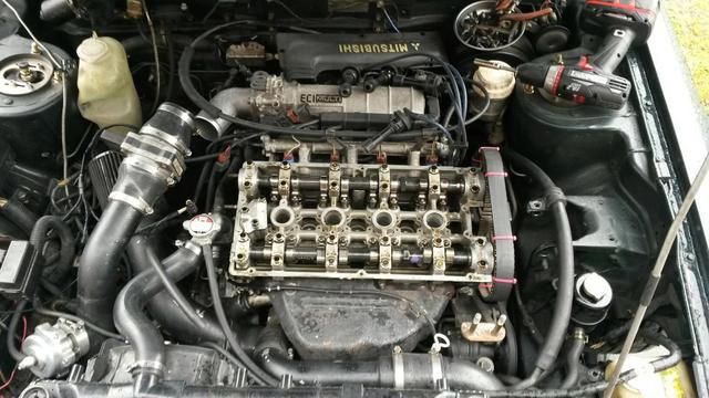

i bought need cams for her. ForcedPerformace FP4 cams. to replace the FP2's
oh also swapped out my problematic ass lifters.
got the new valve cover on... not sure i like 100% the color and how it came out. might redo it again later. or may be lazy and leave it.
ok. so not like same as the old cams, but bigger and better for my setup... /ubbthreads/images/graemlins/uhh.gif
old cams liked to pull little over 20"... these seem happy at 15"
maybe ill take a video to get the sound of the lope. /ubbthreads/images/graemlins/grin.gif
so far its a million times better. seems way more driveable, no more knock nanny shutting down my fun.... BUT. seems super apparent with 2 people in the car that the 2600 just doesnt have the clamp it use to. its gonna need replaced. it doesnt seem to be smoking out, but it just isnt going. also on the same note, top end is in need of an intake manifold replacement.

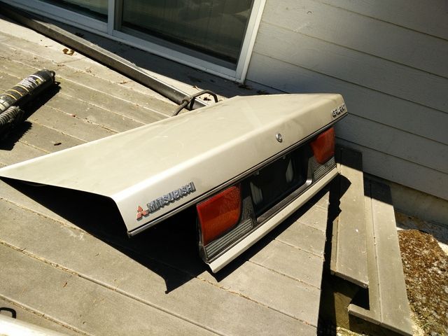

oh yeah, so i bought this MONTHS ago
wingless trunk lid...im sure this will sit around forever. also have a 92 grill to match it (gold, no pic i guess). so once i get a carbon fiber or JDM vented hood, i might paint them all and put them on.

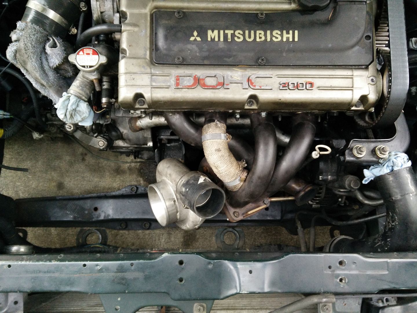

work in progress!
out with the old. will be for sale btw. need to clean her up.
EVO3 manifold
FP Red, old school, ported
TiAL 38mm
some cool housing i forgot the name of
etc.

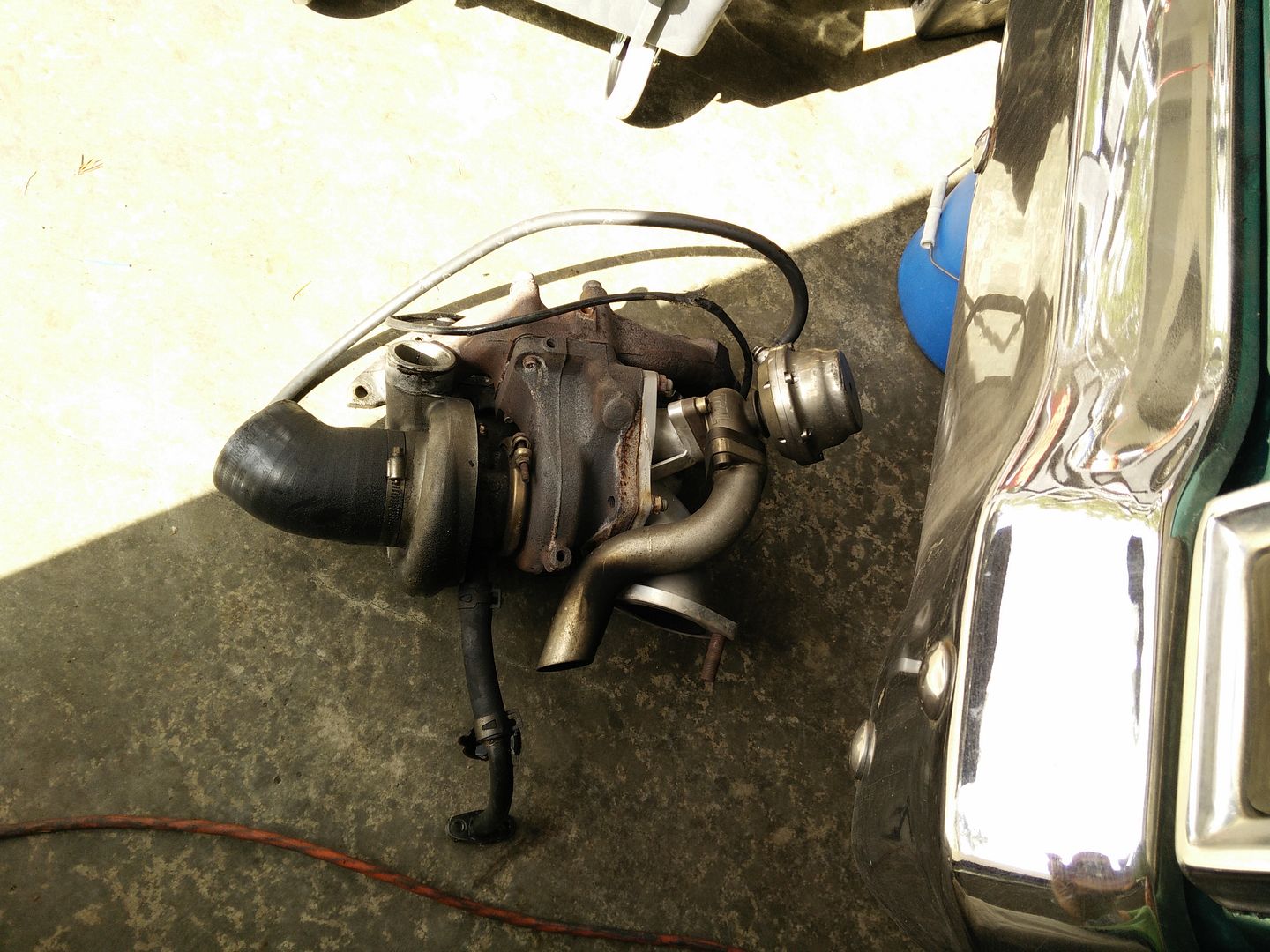

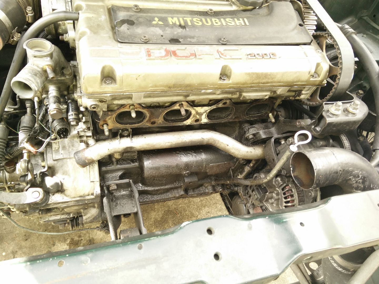

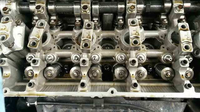

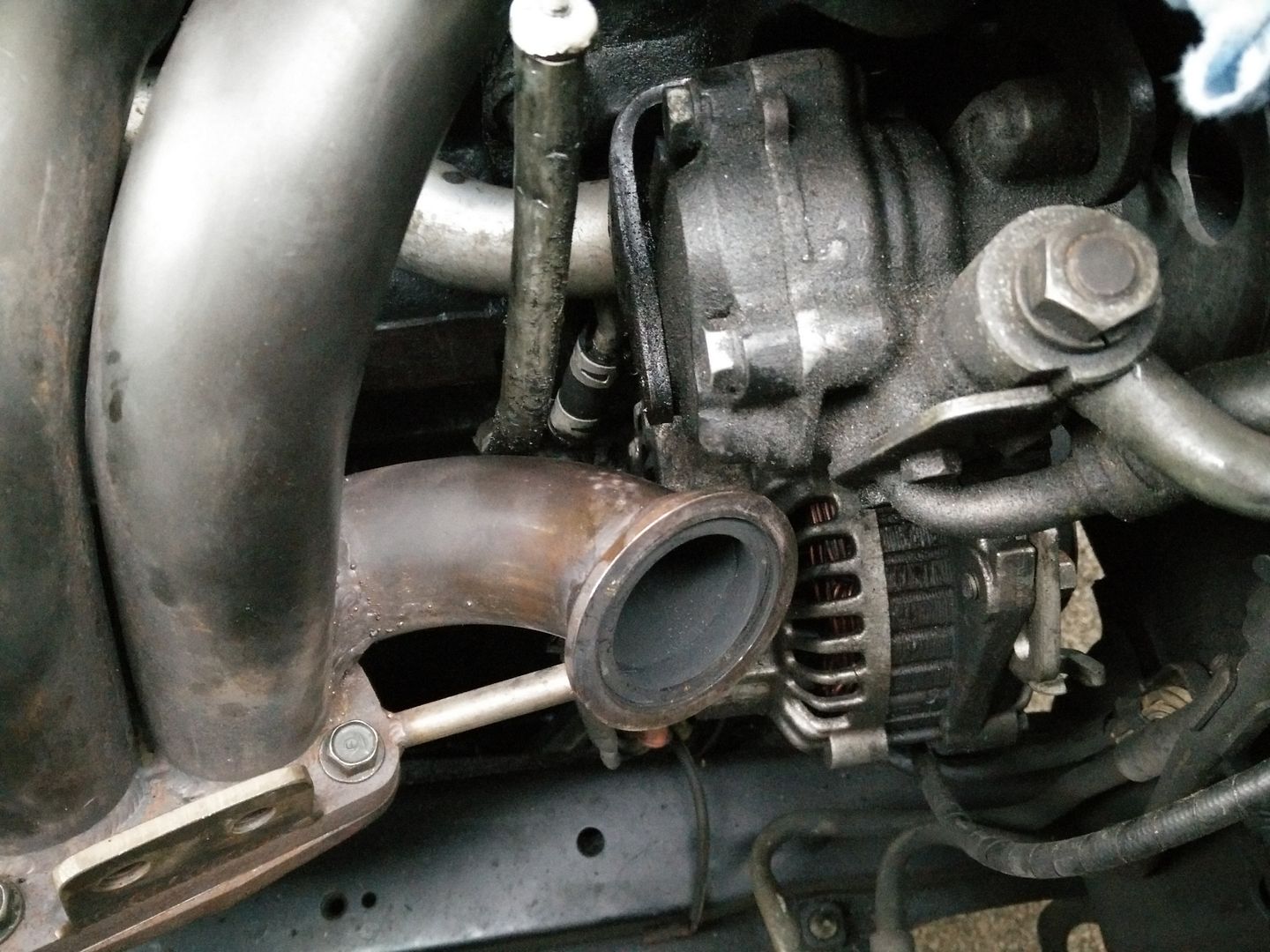

love this trick... 2 broken studs. about 3 pulled studs. fun times.

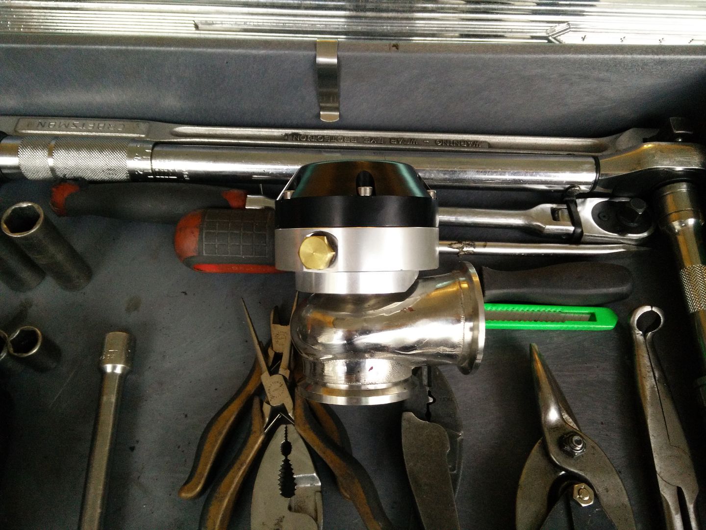

yeah, i did buy a wastegate off ebay. i honestly just am not going to spend 400+ on a Tial MVS whatever. ran lots of Tial's, and i like them, ran cheap china ones and have worked...moving on.
i have test fit pictures with old radiator, but its depressing. so..

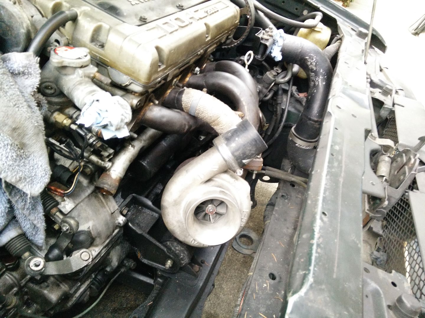

i have about 2" from radiator support to the turbo. think i will have enough room once radiator is tucked and fans are on...i hope... wastegate tube is still touching dipstick tube, needs a little more massaging, and the wastegate VBand clamp was touching the PS pump on test fits. so plan was to just hit the clamp with grinder real quick. but i think i will try a shorter belt on the pump first.
thats about it for now. i took a good long stare at her, getting plans. oh and i re-studded the head so the turbo manifold has something to bolt to... waiting on radiator (UPS, so hope to have it before end of year) and fans. need to make oil drain which might be a bitch as it points at the motor mount, and see how close the down pipe that came with it fits. im sure a 4G63 swapped Hyundai and a Galant use the same downpipe right? LOL.

my dipstick needed "adjusting" as well to fit everything, but it's relatively flexible if you go slow /ubbthreads/images/graemlins/laugh.gif

seems easier to bend than the Honda ones. trick is it needs more bend in the middle.
