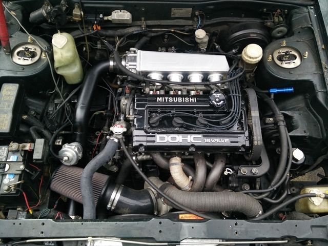

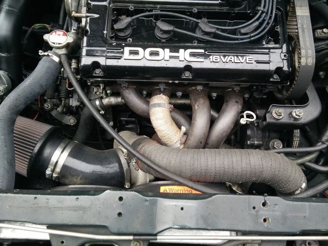

PICS! because really, did you read my ramblings? lol.
rebuilt pipe
nasty T4/T67

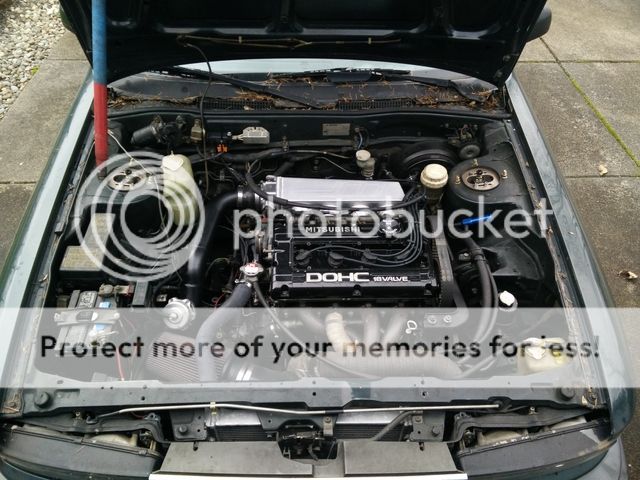

and yes, PINE NEEDLES!... /ubbthreads/images/graemlins/bawling.gif

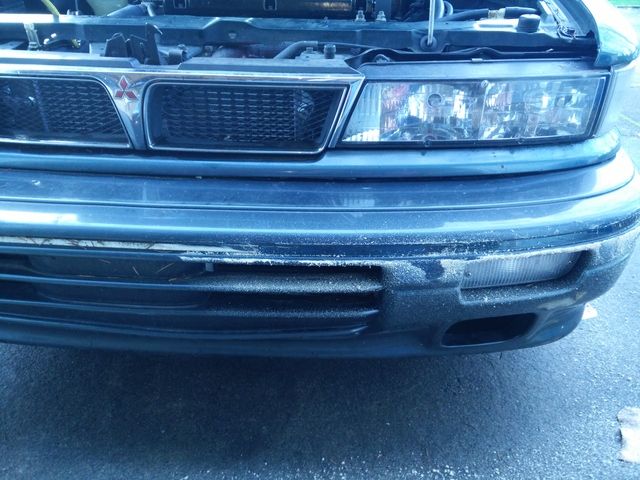

/ubbthreads/images/graemlins/ooo.gif /ubbthreads/images/graemlins/grin.gif making a mess. ripped out the chrome strip. left most all the foam. then take eraser (Astro wheel to be specific) in the drill and have fun. i got most the front bumper done i think. but it was getting dark/cold, have to verify in the light.
also have some new black moldings around here somewhere, ill try to get a pic/partnumber for anyone else. i have only been waiting to do this for like 5years? now.

I want to see it when the chrome strip is gone... it's been something i've wanted to do basically since I bought the car... hate chrome so much...

well, no i'd like to go black i think. I'm not sure anyone has done that with a KG car though?
I think with no molding will look funny
edit: I am dumb, looks like the car with volvo wheels is actually KG... 1000% better than chrome IMO.
