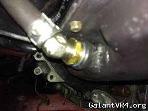

I tried a bunch of times to seal mine with no luck. There are special crush washers for the bolts that people say you need. Other people say double up the gasket. I've heard people say cut the little tab off the outside of the gasket. Every turbo 4G I ever owned had a leak here. I welded a 3/4" NPT fitting on mine after the 3rd try to stop the leak. Its working well like this:
