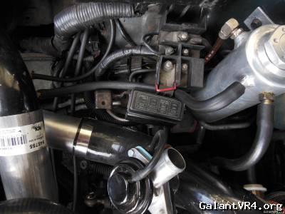

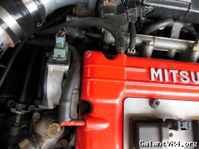

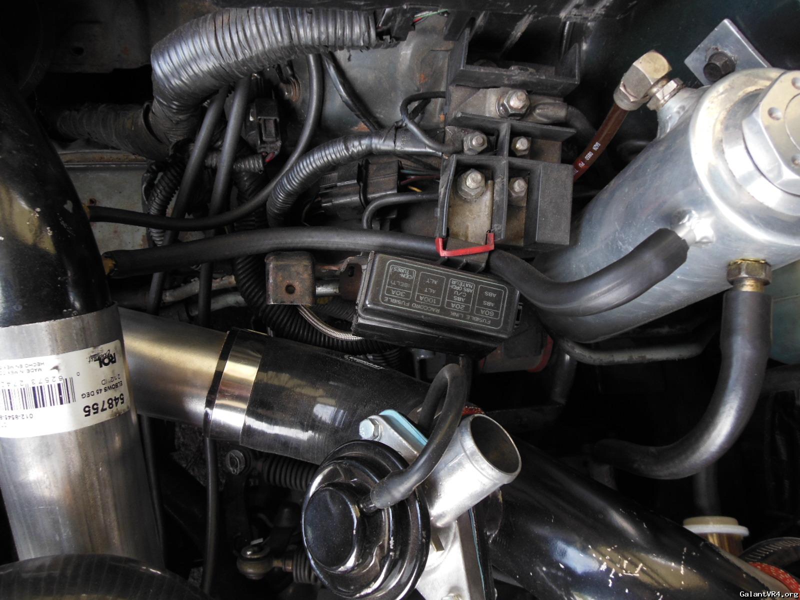

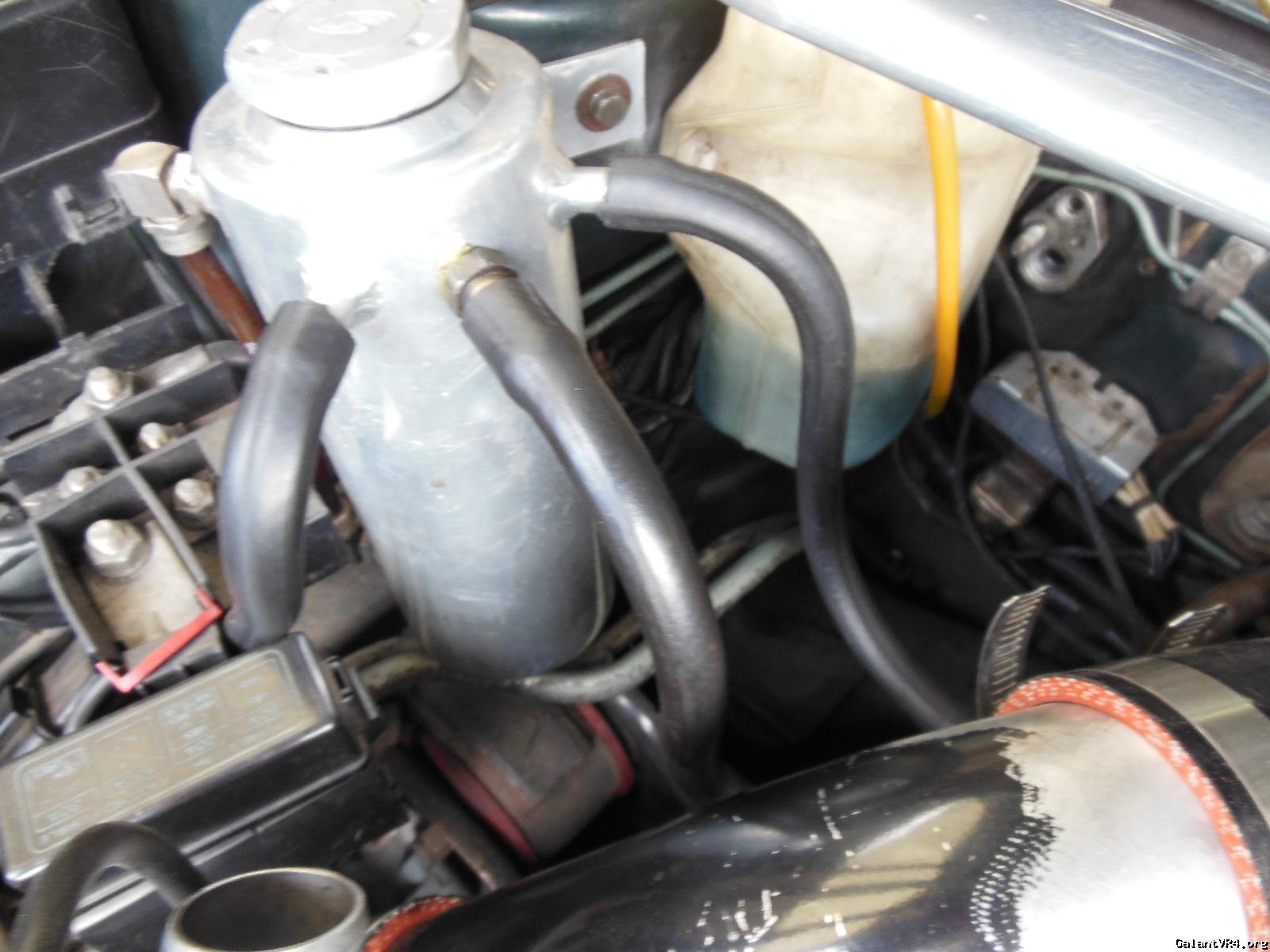

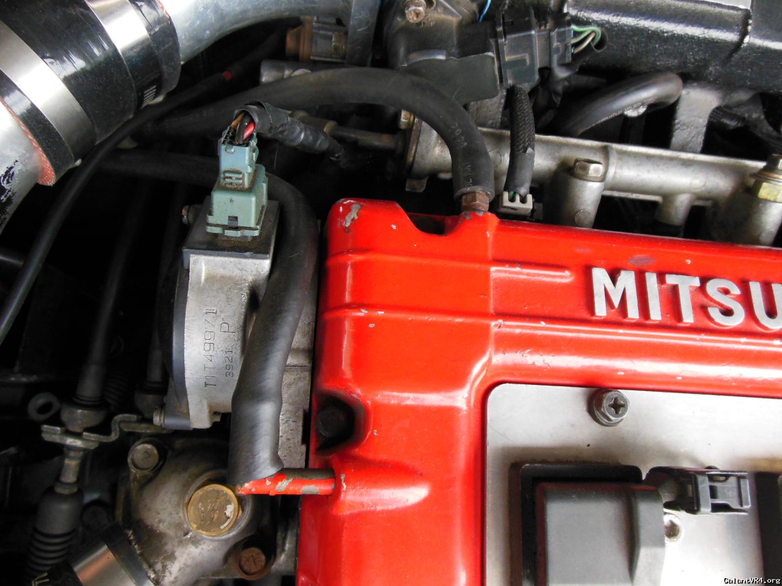

Damn, you are a true gent. Thanks for that. Bringing it back to the org. What do you run transparent? It seems a catch can will help with a lot of my pet peeves. Atleast hypothetically
