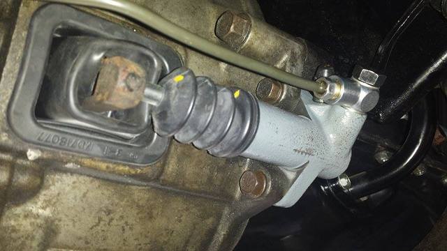

Bracket back and line fitted.
And installed the new oil cap.
Tomorrow I will make the new clutch metal line. Should be cool. Got my own little line bending tool.

Looks great man, you should have just got the one piece ss line from master to slave from jnz. Theirs has a coating on it so it doesn't saw through everything.

I knew about it. Just didn't want it. I like the factory look.

Got the new line made. Turned out great for making my first new line.
The bending tool. Great tool to have.
