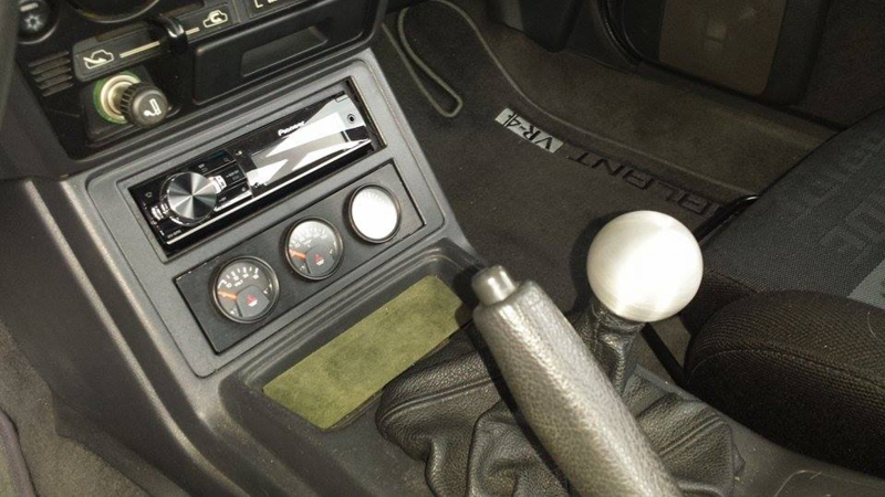

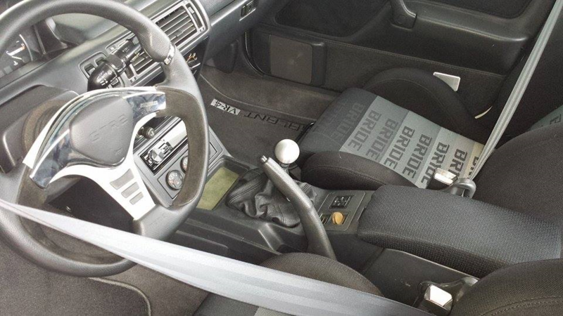

Looking good man. That steering wheel is kind of freaky though.
ApexHunter
Apr 25, 2007
2,011
Marysville, WA
Quoting G:
/ubbthreads/images/graemlins/rofl.gif Well said. Yeah man love the interior but wow that steering wheel...pretty intense for the ol gvr4. /ubbthreads/images/graemlins/wink.gif

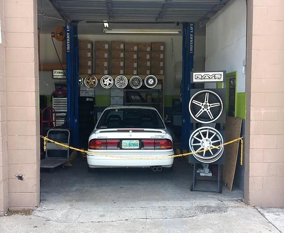

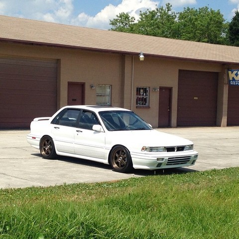

Brake project got put on hold. As my wheels don't clear the new brake caliper. Looks like I will need to order new wheels. So been looking for them.
I feel your pain, Charles. The 3KGT calipers stick out a TON. I went through the same wheel dilemma when I installed mine. Spacers, get new wheels, get a different brake setup...FML.
I'd start tackling the problem by figuring out how far you are off. Would a 5mm or 10mm spacer get you to where you need to be? If you're dead set on getting new wheels, keep in mind, spoke design will play more of a part than offset will. Just to give you an idea; The BBS LMs I had were +39, and the Work wheels I currently have are +30. I needed a 10mm spacer up front in both cases. With the wheels I currently have, the 10mm spacer up front probably only gives me 2-3mm of clearance between the spoke and caliper. The TE37 spoke design looks pretty good form a clearance standpoint. I know the RPF1s provide good clearance, and the Evo 8 Enkeis clear the 3KGT brakes straight up. Hopefully that helps you when shopping.
Before you buy new wheels, I'd just see how far you are off. Take a set of washers, and stack them up on all 4 studs until your wheel clears the caliper. Then, take a mic and measure the washer stack. That's an easy way to see what thickness of spacer you'll need. I found the washers that come off the head bolts work great, but any washer will work. You'll just need a sh*t ton of them. You can even snug up the lugs and set the car on the ground, to give you an idea of what kind of fender poke you'll have. In your case, I think that's going to be the dealbreaker. Judging by how your car currently sits on the TE37s, 10mm will have you poking out too much.
