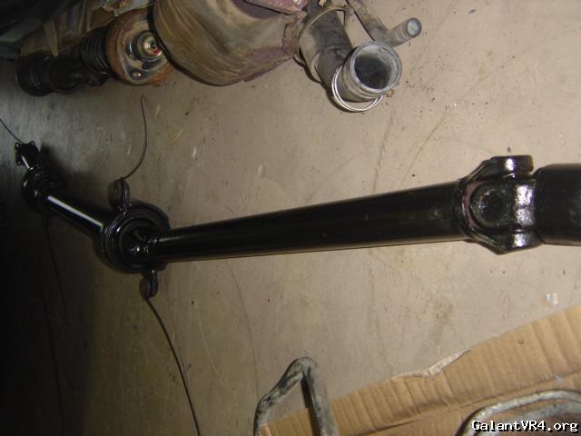

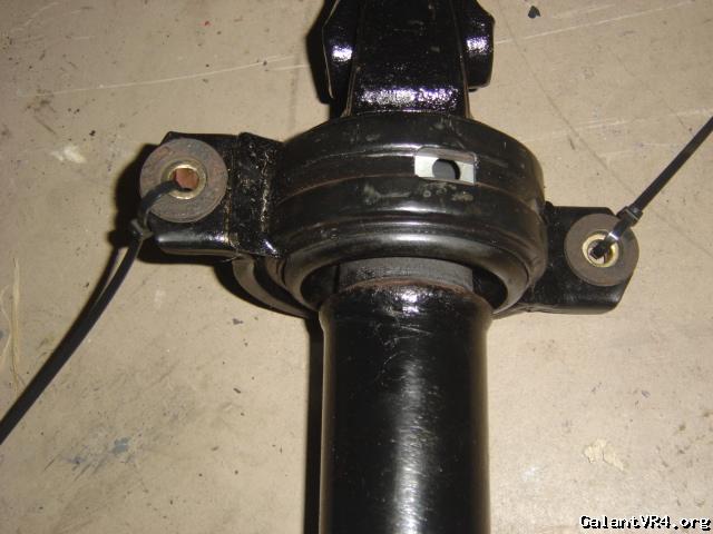

Just picked up the drive shaft and it looks great. Can't wait to get it all but back together. Just waiting on rear steering rack, swaybars, Coilovers, Gas tank and sending unit. Oh I have to still paint the rear crossmember.

You are doing what I want to do but don't have time or funds to do. Great work so far and looking forward for updates. How much did it cost to rebuild the driveshaft?

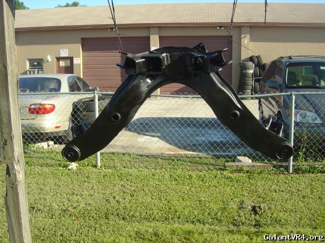

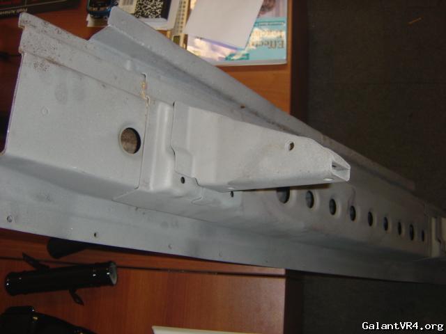

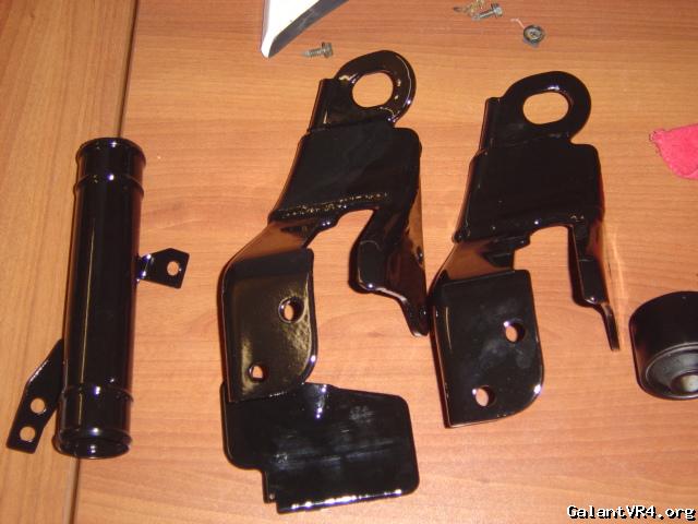

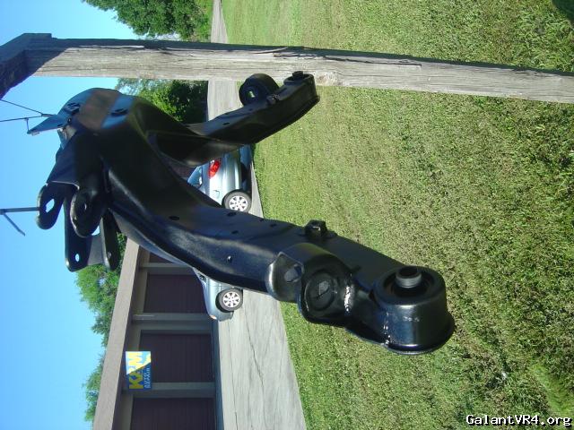

Cost about $400.00 for the full rebuild of the driveshaft. Had it plasted and painted. I finished welding the rear bumper support today. Dropped off to get sand plasted. Then I will repaint and install the rear bumber back. Repainted the cross member today. Turned out great

Bob you've not been around but I did the design work and John aka Boostx did the leg work and in the end we came up with new bushings for the subframe as well as the mustache brace. PM John and see if he has any or yell at Garfield and see if he has any in stock. John may still be away but see if one of the two can get you a set before everything goes in.

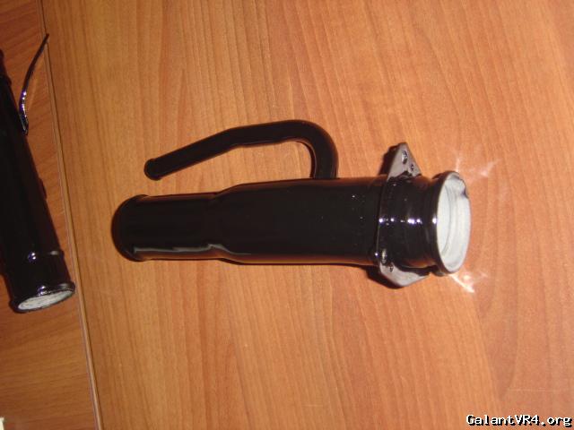

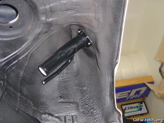

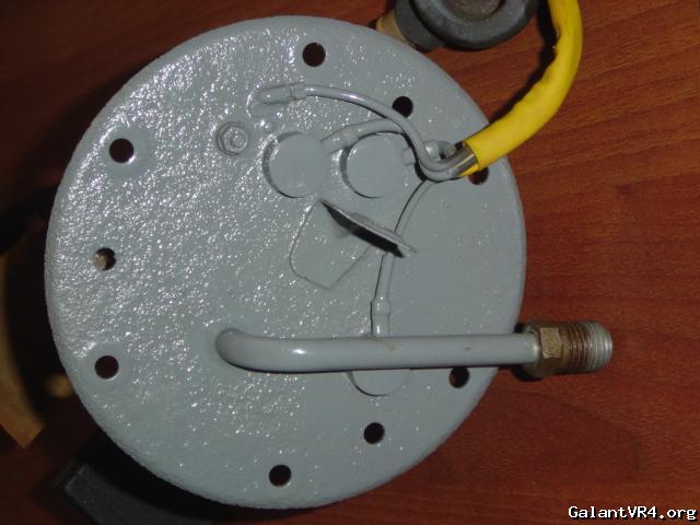

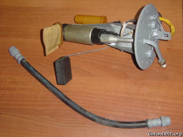

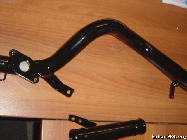

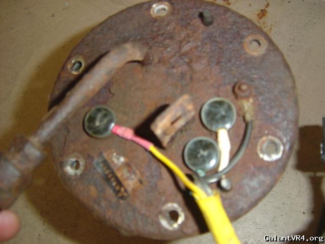

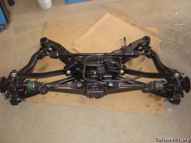

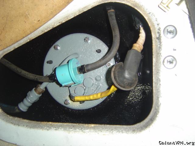

I got the fuel pump back. Man I am impressed with there work. They welded a new neck and cleaned it up.
Before:
After:

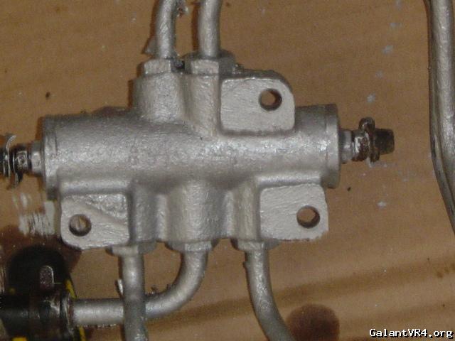

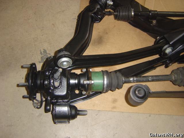

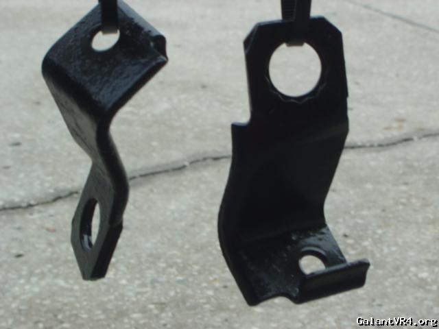

Got more parts back from the sand plaster. They turned out great.

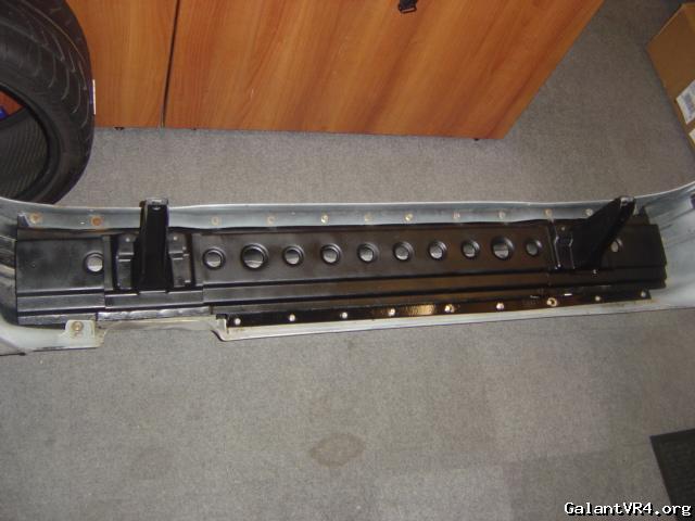

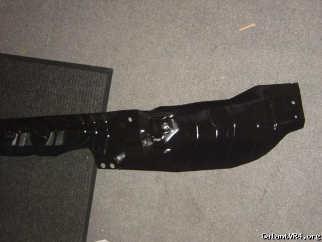

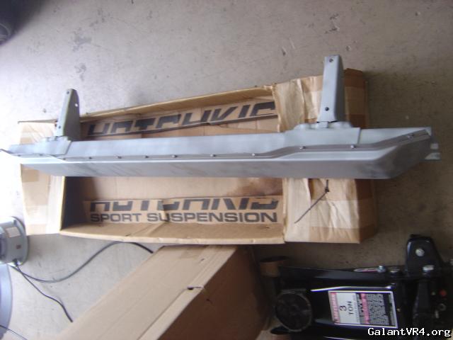

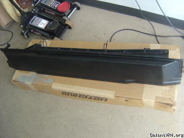

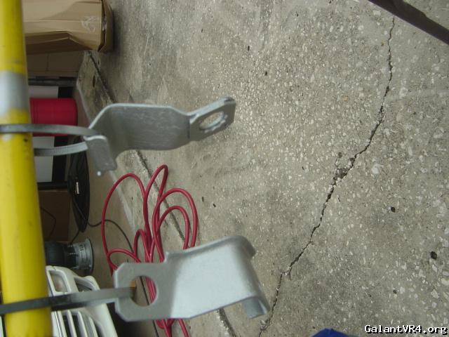

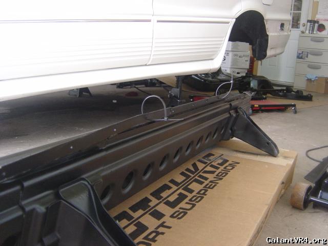

Got the rear bumper surpport back from the sand plaster also. Going to need to weld somemore. He but a hole in it.

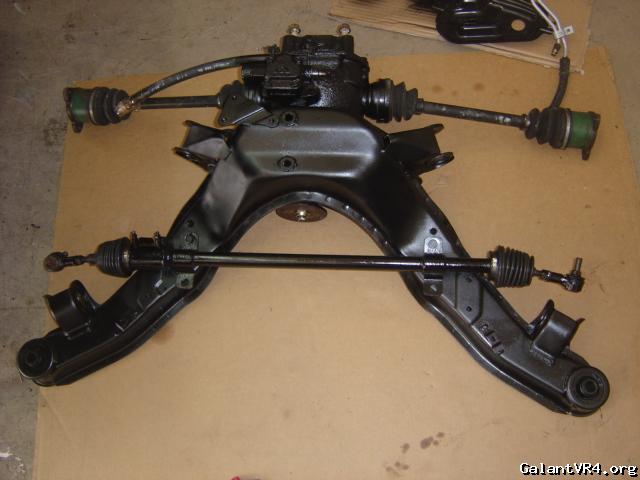

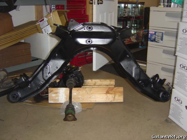

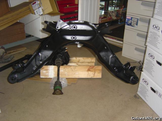

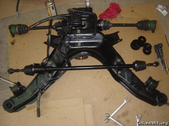

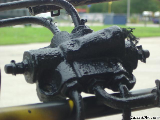

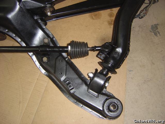

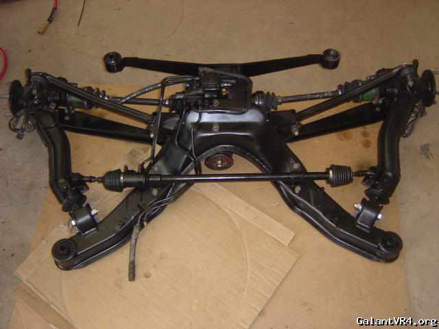

Started to put the rear diff and steering rack back. Got it rebuilt also.

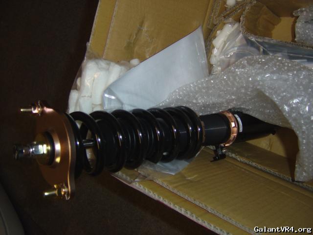

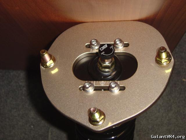

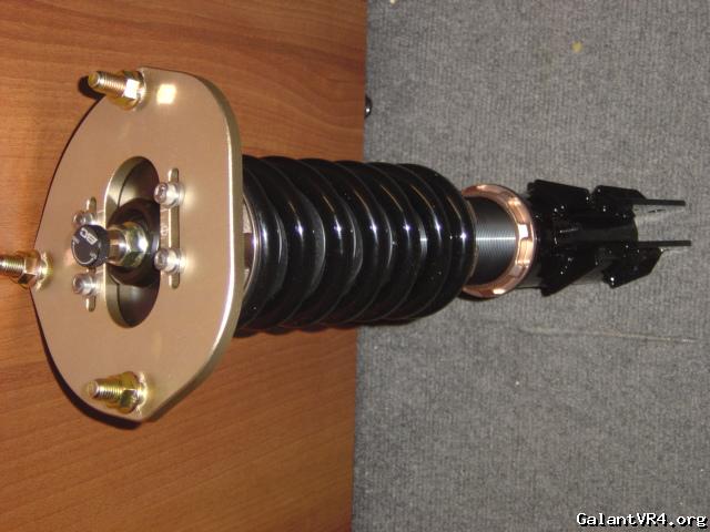

And my BC coilovers should up. They look sweet!!!! If you are intersted in the coilover hit me up I can get you a great price!!!
I will do a review on them when I finish installing everything.

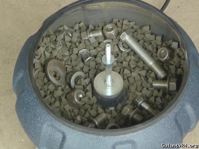

Picture of all my bolts getting cleaned up. Almost done.

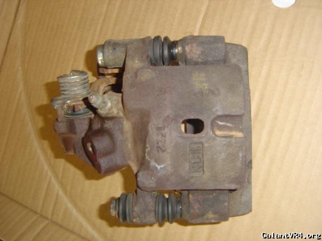

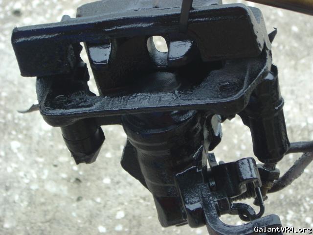

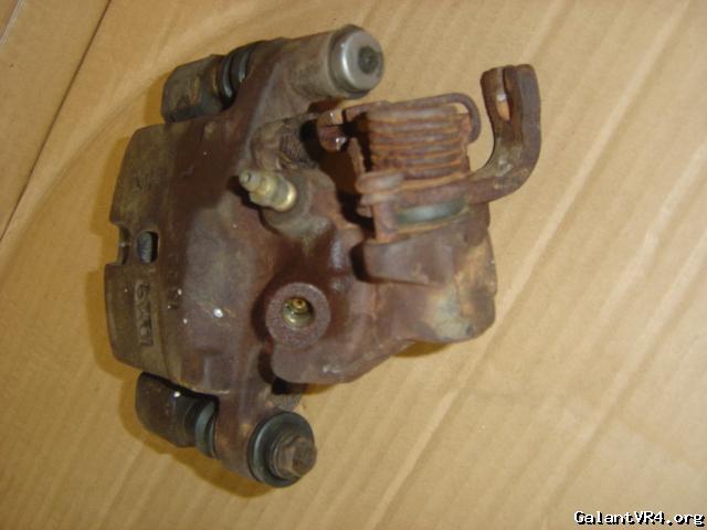

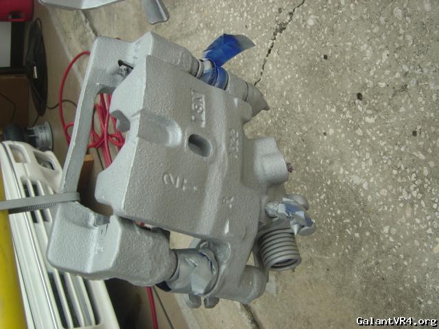

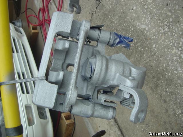

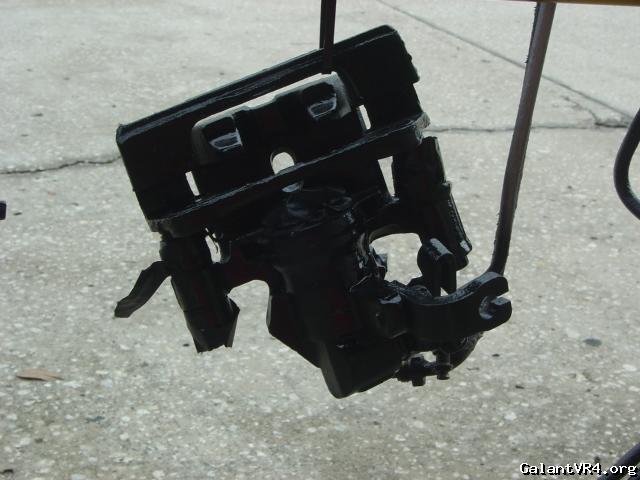

Painted the rear brake calipers. These where replaced 1 year ago by the last owner. Just had some rust on them. So I treaded them today. Going to paint them tomorrow.

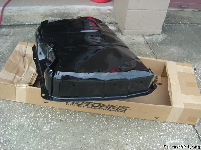

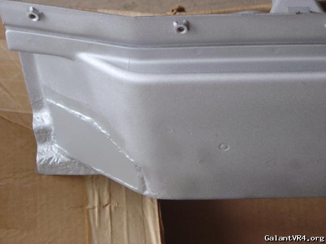

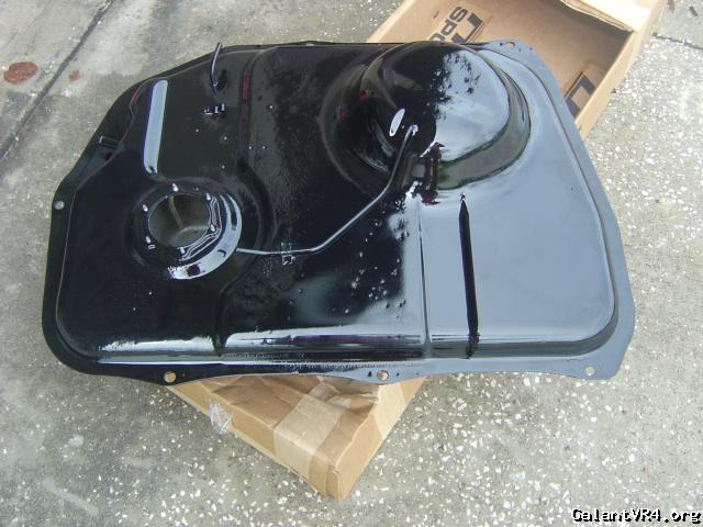

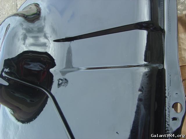

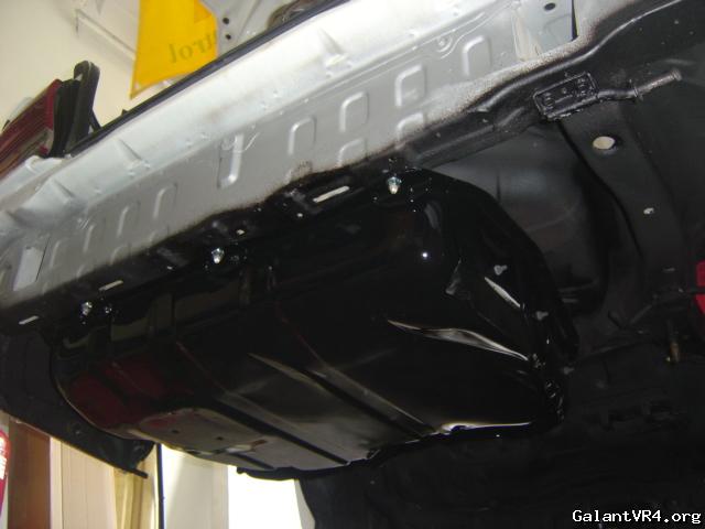

Got the gas tank back.

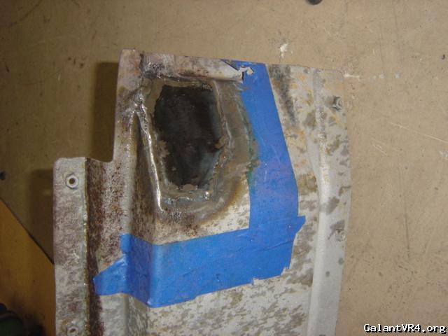

Fixed the whole in the bumper support.
Then sealed it. Just got to paint it.
Finished painting the calipers.

Painted the bumper support yesterday. Going to but the gas tank and bumper back on today.

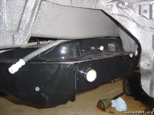

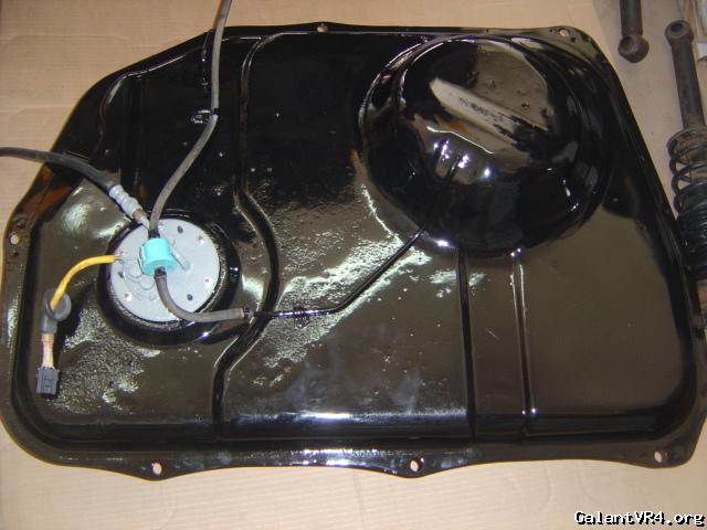

Gas tank back in.

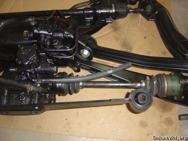

Bolted down the rear steering rack and started to but everything back together. Wish the whitleline swaysbars would come in /ubbthreads/images/graemlins/frown.gif

The outside of the tank looks nice, what about the inside?

I have BC Coilovers as well. I love mine. Terrible instructions though. I got the one with the inverted tube. I have made no adjustments besides ride height. The car handles really nice. Little stiff for daily, but my car is not daily anymore.

Quoting G:
The inside of the tank was very clean. Didn't do anything to it.

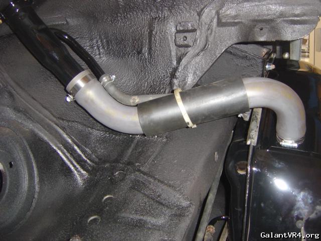

Update: Haven't had much time to work on her. Installed the new fuel hose and put the rear suspension back together. I also but back the rear bumper with all new bolts. Two bolts broke when I took it off. So took a little time redrilling those.
