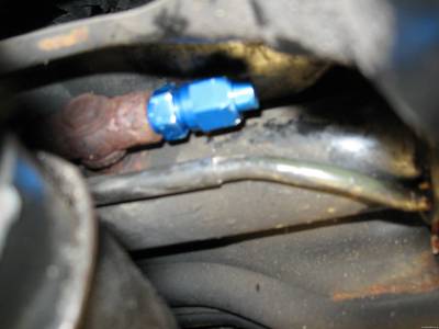

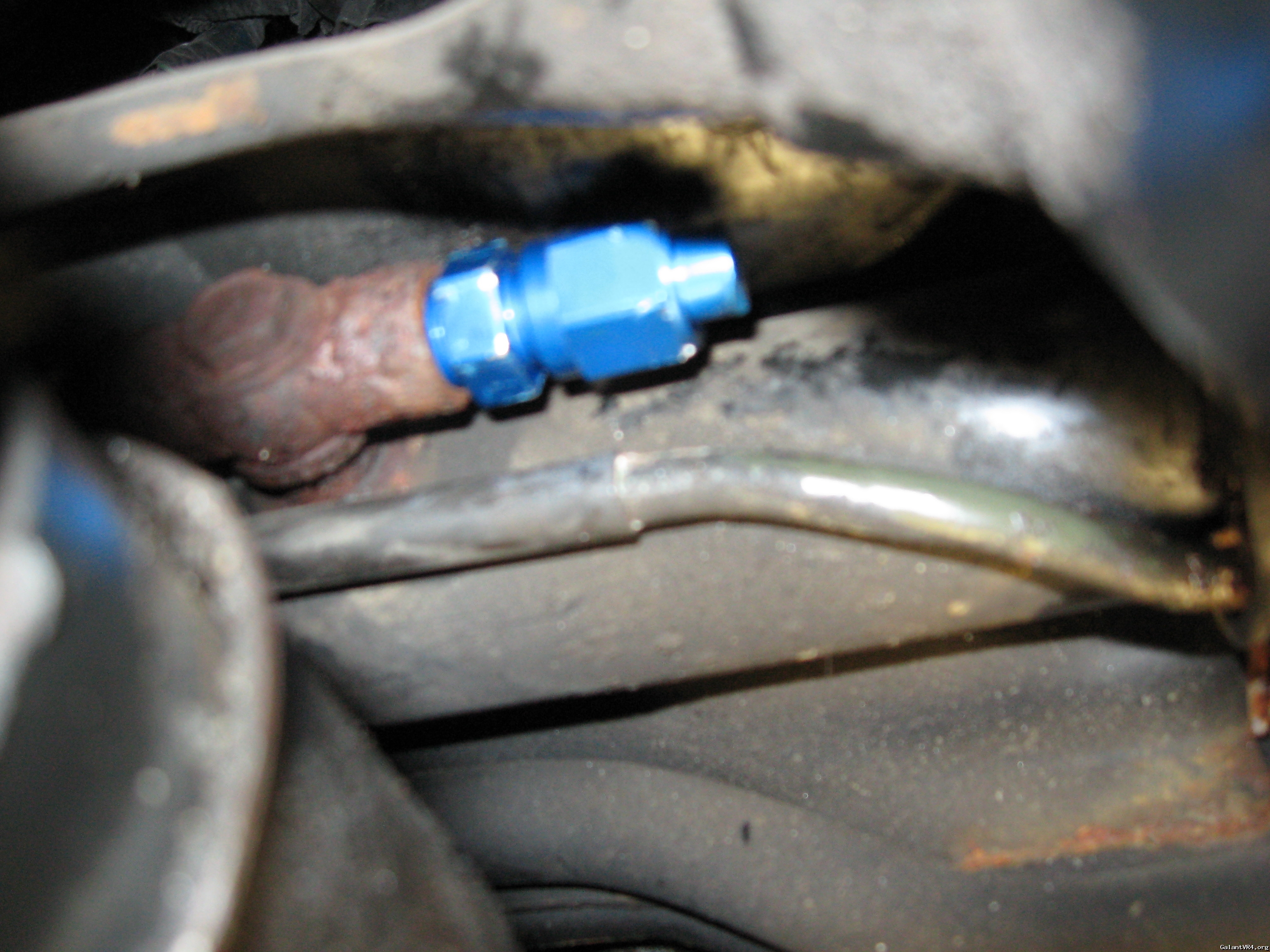

from the first picture above, i believe the lines that needs to be capped is the second one from the top and the bottom line (close to the sway bar)

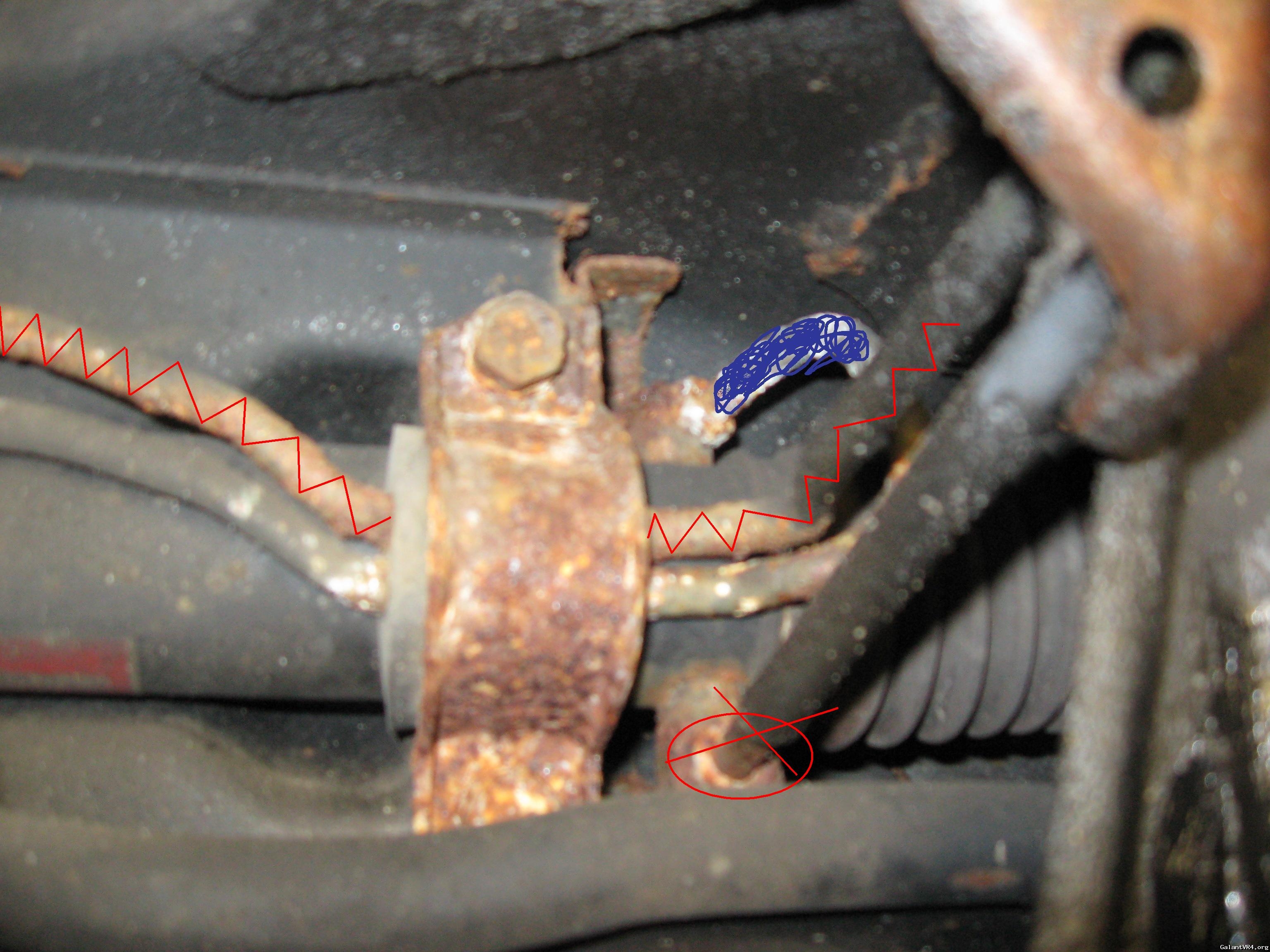

I couldn't lift my subframe to see which ones I have block off... it's been several years since I've done this, but I'm pretty sure you need to cap the line in the first picture that's coming straight out. I cut this one as close as I could, then threw a deep well socket on there to take off the threaded part. Then off to the left of the bracket, you should see one of the 2 lines going left to right that goes into a T. Unscrew that line from the T and cap that one off. Both with the oil pan bolts.

I'm almost positive these are the 2 lines. I remember having an issue getting a socket around the threaded portion because I was hitting the sway bar. You can avoid this interference, I just don't remember if it was easier when I rolled up onto ramps or just put the car up on jackstands. It's still not the easiest thing in the world to do, but it's do-able.

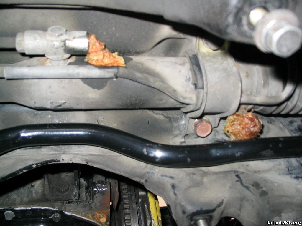

Above post is correct. Here is a pic of what I removed. I stuck some paper towels in the ends to keep them from dripping all over my garage floor, but it shows you the correct lines to block off.

So I went ahead and just did this again today on the black car sitting in the garage. I guess, if you REALLY wanted to try it, you could follow those 2 lines back just past the bracket to where they connect with the really long lines going toward the back of the car and cap them off there with those fittings those other people were telling you to buy. Personally, I couldn't even get the lines to disconnect there. Good luck.

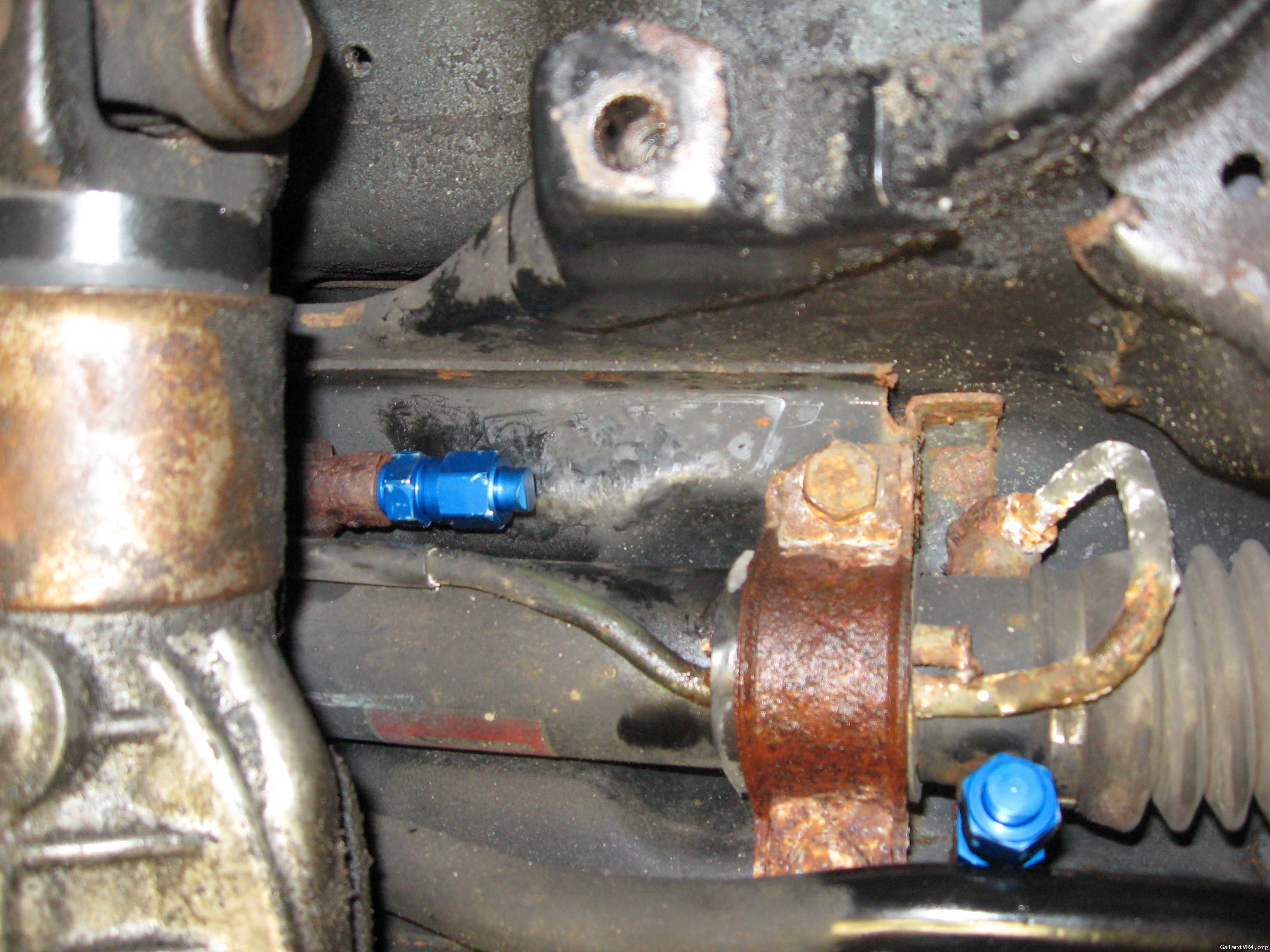

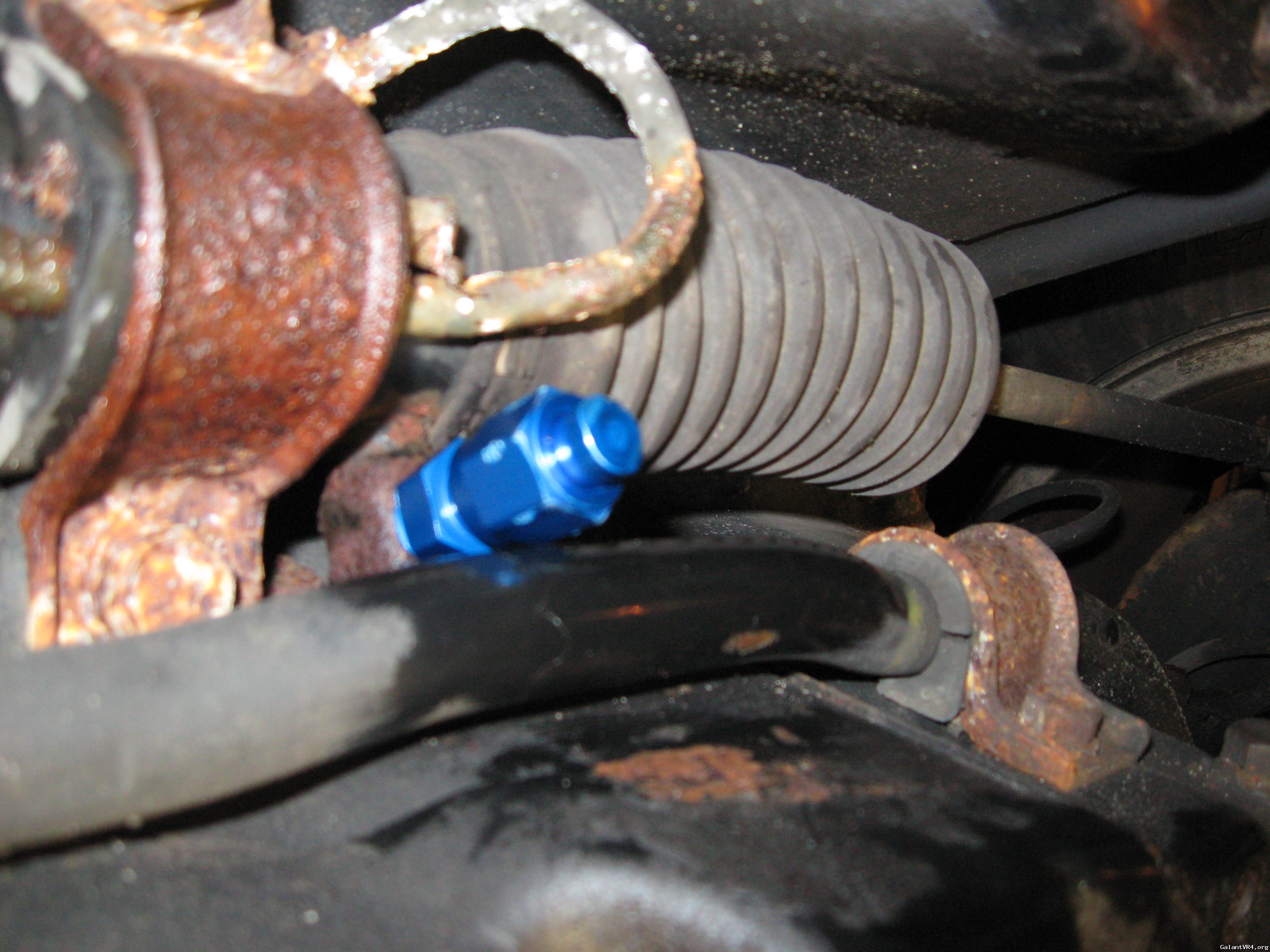

Alright so I finally got the other cap on. What a workout that was. The flare wrench didn't work out as it ended up starting to strip the nut. I ended up driving a flathead screwdriver through the line right at the base and then putting the deep 14mm on it again. Worked like a charm. Putting the Earl's cap on proved to be a little more difficult. I finally ended up getting in there nice, but it isn't sitting flush against anything. Is this ok or do I have a problem? You can see what im talking about in the pics below. It was the same way with the other one although I didn't notice it until tonight. Are these the only two places I need to cap/terminate? I assume the hoses that go to the back I can now rip out right? I thought I read somewhere that there was three places to terminate? No tips on cleaning up the underside of this car? Thanks for any inputs guys!

The only other place to terminate was at the return lines on the PS reservoir, which it appears you have already done. Add PS fluid, start up, turn steering wheel to full lock in both directions, refill until it stops making weird noises and the bubbles go away.
11,992
I think the reason I never used those Earl's fittings was because back then, nobody else had used them at the time and I was worried the one would interfere with the swaybar. Looks like it's close, but it fits. /ubbthreads/images/graemlins/applause.gif
Cool. Will do that tonight I think. My only concern with the Earls is that they aren't sitting flush against the car. There is a very small gap between where the Earls screws in and the car itself. I'm hoping that the O ring sealed ok though. If not I am going to have a mess when I start her up hehehe
