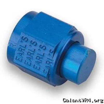

you need two of these for the the front ps rack. part# 592906ERL and two part# 991947 I believe it is 5/8 18 to -6an

I don't remember those Earl's fittings being available back when I did my 4WS removal, but if they work, use them.
Cool. Will look into it. Thank you very much for your information. I'll get to the bottom of this eventually! LOL
Just ordered two of each. Should be here in a few days. Not sure if I got a deal, but I got em from Summitracing for $23 shipped. Might be calling you Chris hehehe
I hope I gave you the right part # for the AN fitting that goes into the power steering rack. I couldnt remember if it was 5/8 18 or 11/16-18 on the power steering rack.
part#991947
part#991950
I know the caps are correct part # I gave you. maybe someone could chime in and help a brotha out.
I think its M14x1.5 to -6 an fitting you need. I believe I got the part number from tommyp
heh that's what I ordered so I hope your right too lol

Think 991947 was the wrong ones. A few other posts on here have referenced 991954. Says M14 1.5. This the right one?
[quote name=chris
Get the 2nd one then bro i know its one of them so if the 1st one didnt work just return it and grab the 2nd one.

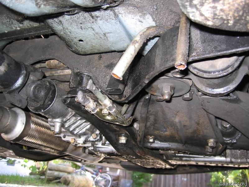

If you look under the front by the subframe on the pass side you will see two specific lines ( here on the left ) that run to the back of the car from the front rack. You can cut the lines there and have someone weld them closed. Thats what I did. Remove your power steering belt so you don't kill the pump and drive the car over to a welder and have them weld those lines shut. Then put the belt back on and top off the system with fluid. Check this thread. Here.

Thanks Mike. All very good information. I guess I am capping the lines at the rack now so im assuming that would remove the need to do the cut and weld on the lines in that picture. The evo 3 seems like a perfect fit for what I want so I will probably head onto that once I get the power steering problems resolved. Thanks for the tip on adding the + in front of searches. That certainly helped me find some more writeups.

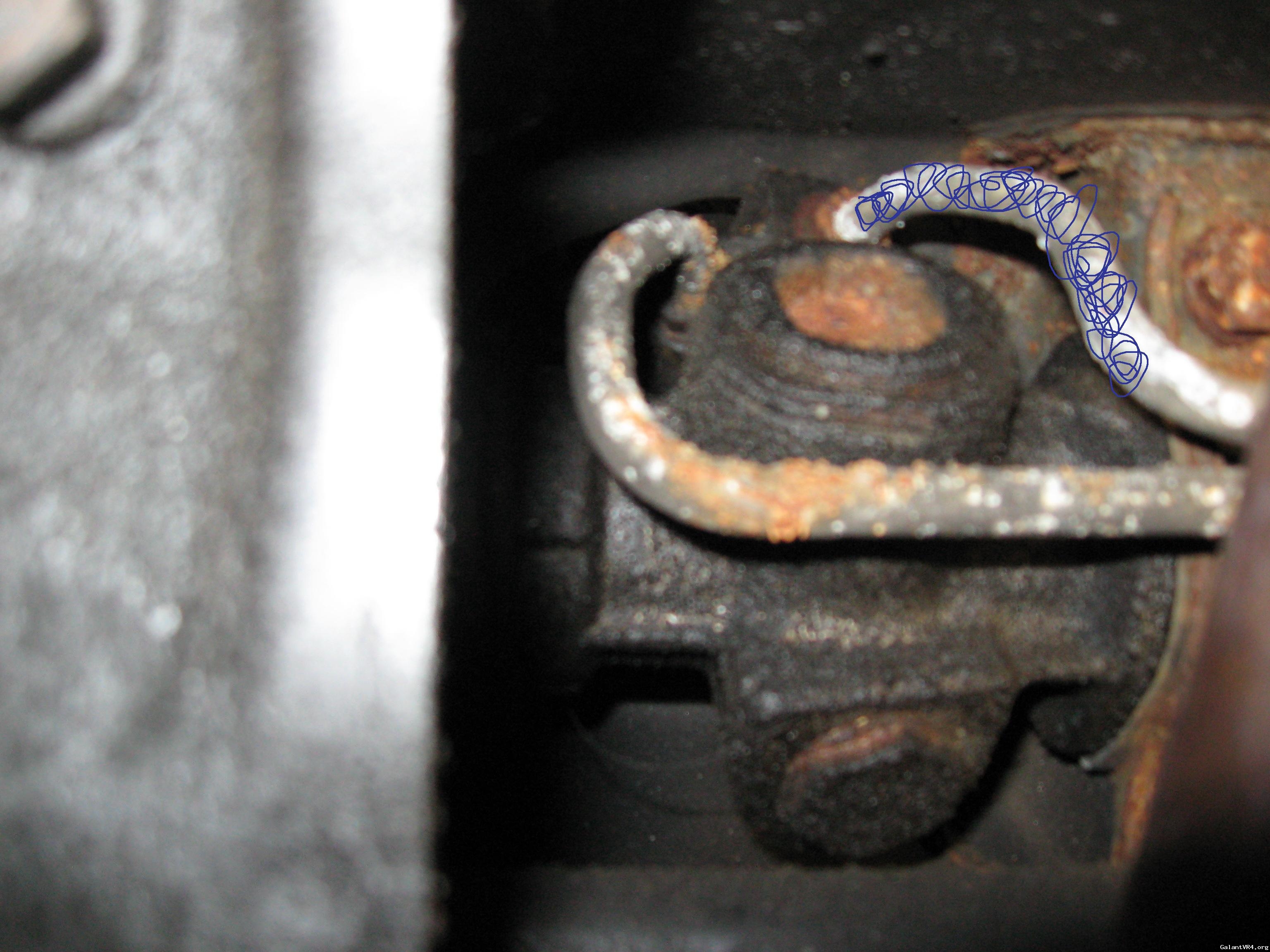

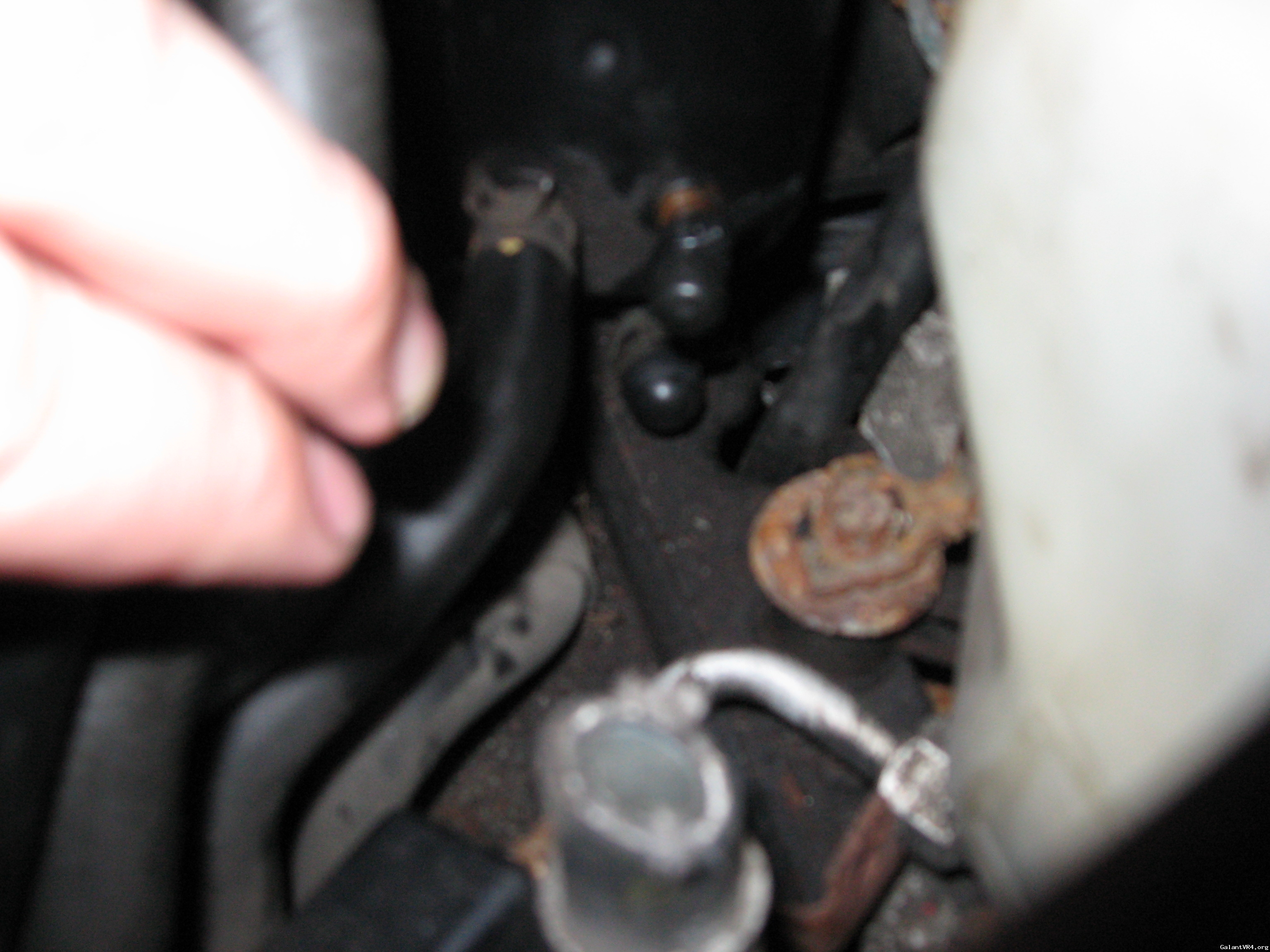

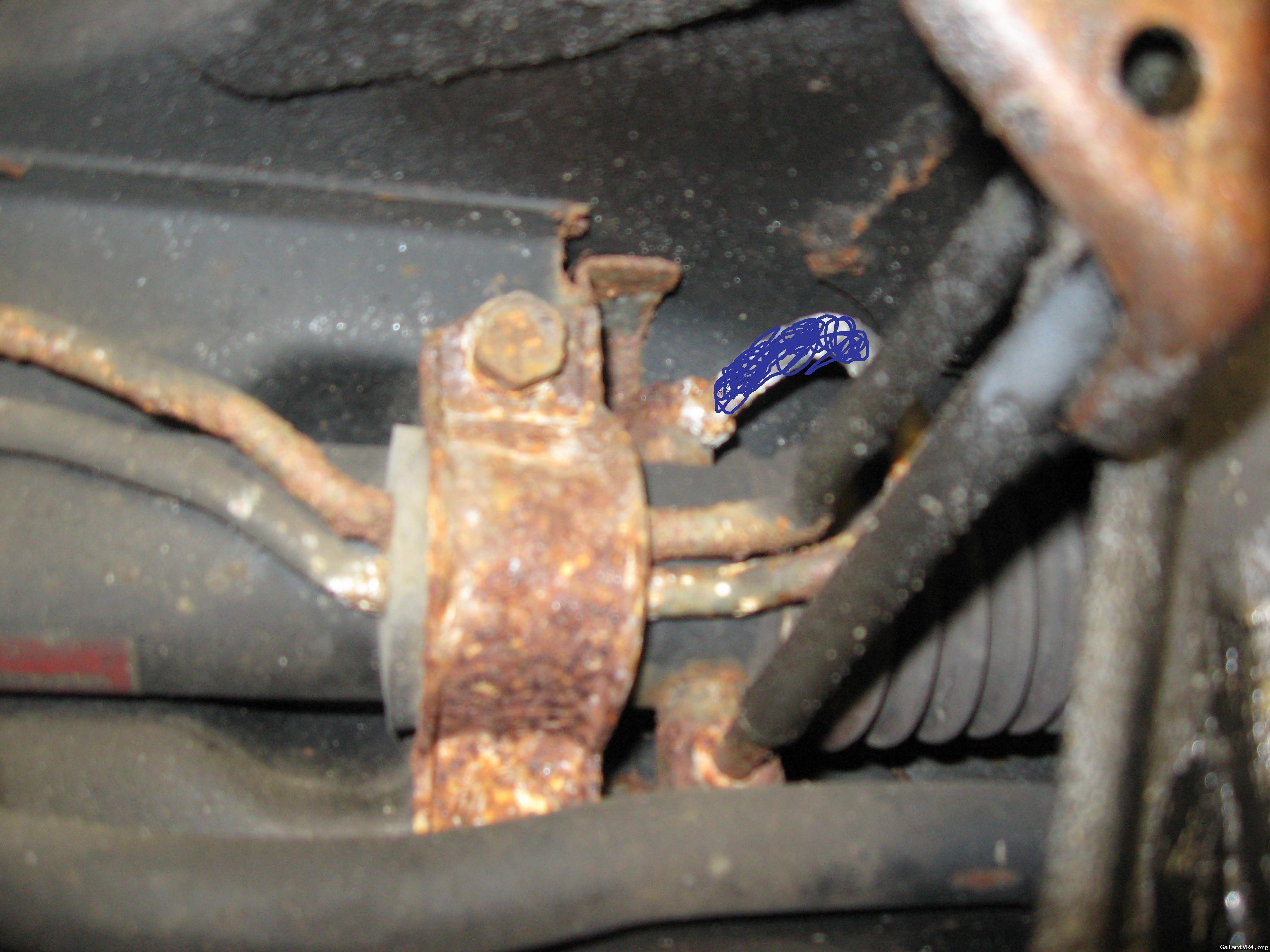

Ok gents. Finally got a little more time to scamper around under the VR4 again. I pulled off some metal support (three bolts in the front and two in the back) and got a closer look at the lines that I believe need to be capped. I took some pictures as I want to make sure that the ones that need to be capped are right before I start pulling it all apart. I labeled the lines in blue that I think are to be capped. Also any suggestions on taking those lines off? I don't think I have a tool that will be able to get in there that well. I also took a pic of the current state of the power steering reservoir. Any inputs on that being right or wrong would be great.
Thanks again!
