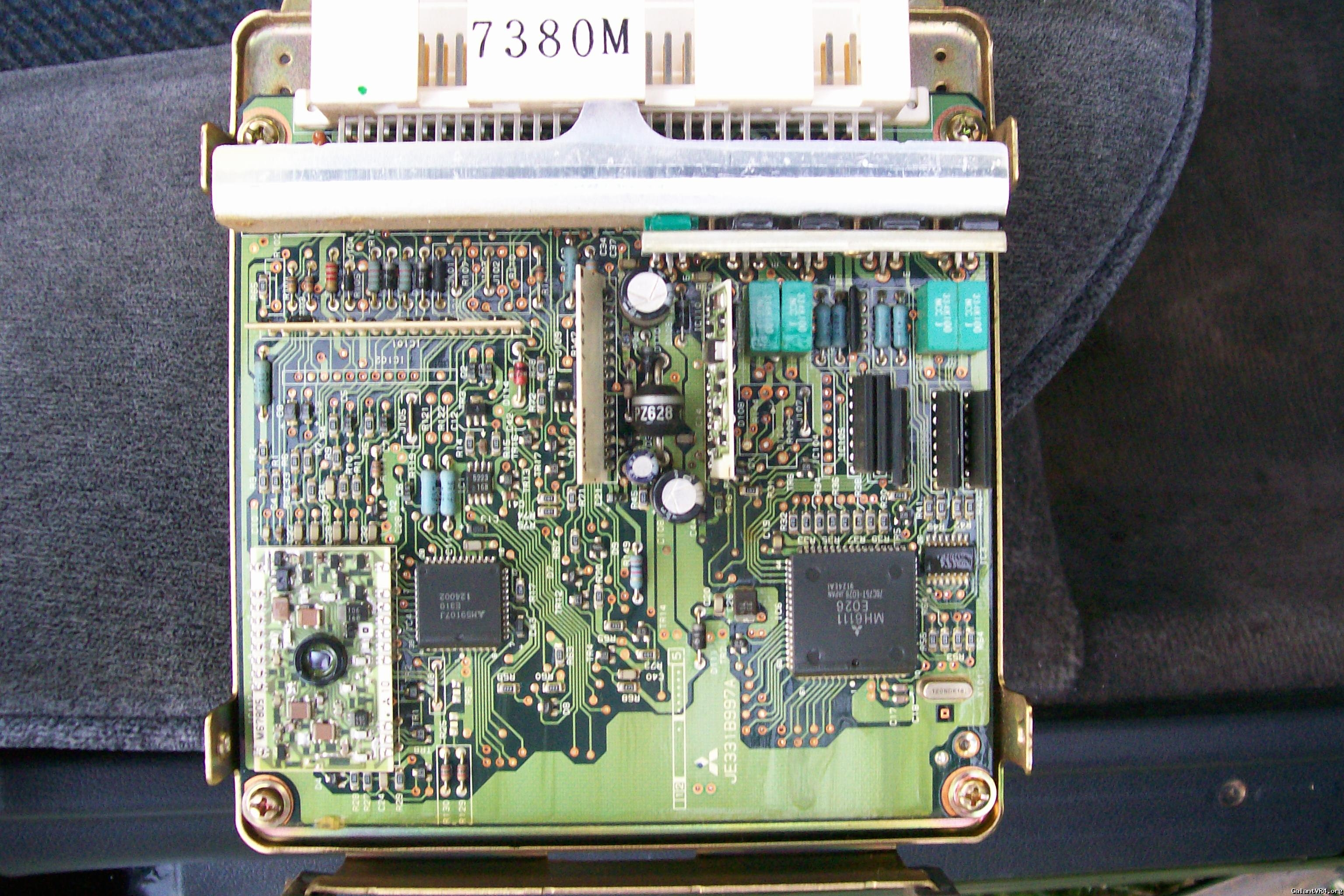

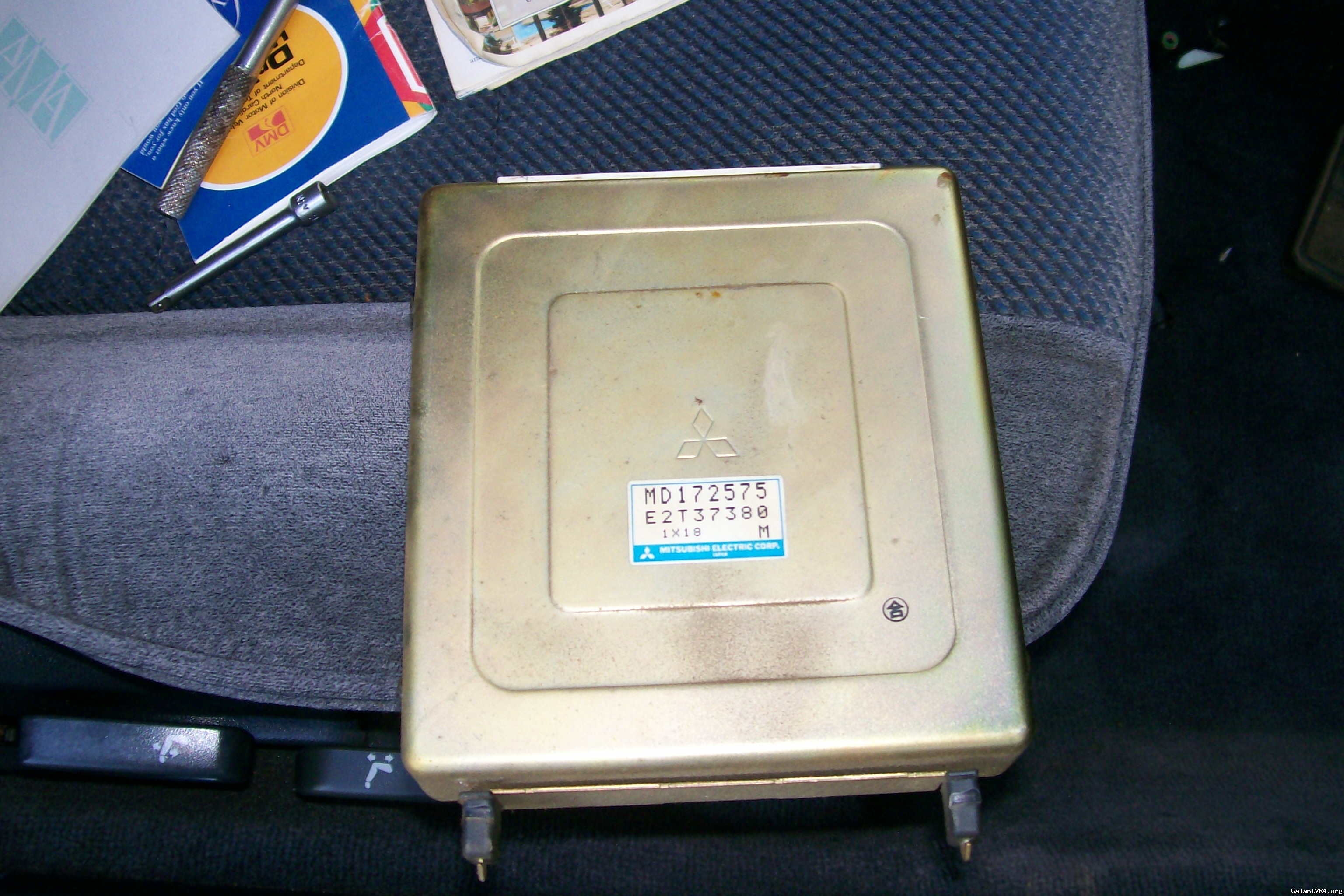

According to that page, the N/T EPROM ECU has a "7380E" code on it, and a E442 chip.
Mine (MD172575, below) has the code "7380M" on it, and does not include a chip, but does include the knock board. Having a knock board doesn't imply that it's an EPROM ECU, at least for this series of ECUs. So, definitely unusable for turbo apps /ubbthreads/images/graemlins/banghead.gif
Terry Posten has it^^ currently, replacing the original caps.

I didn't mean to imply that knock board = EPROM, I do know better than that. But if it had a knock board and an EPROM it would be a great find.
I actually have an "E" version of that board here, but its rather badly damaged. Some are and some aren't.
