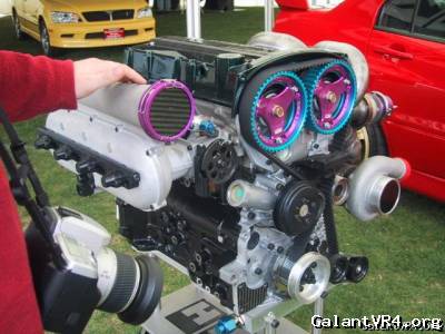

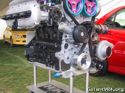

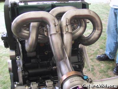

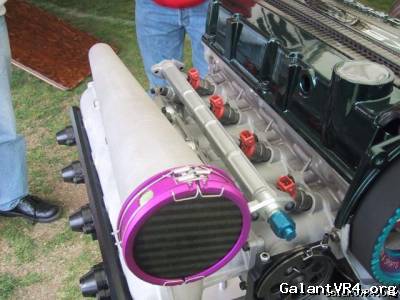

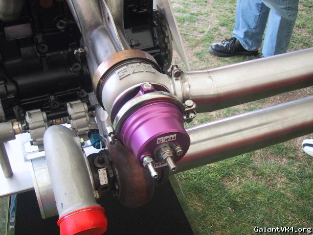

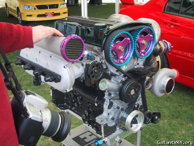

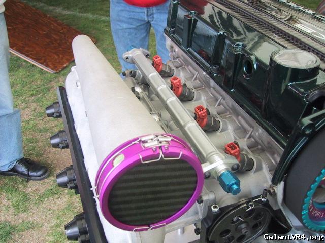

ITB's can be built using ITB's from other cars and bikes. Just have to build a surge tank/ plenum and build a runner section using flanges for your ITB's and your head with runners in between. I did one for a friend about 6 years ago using RB26 ITB's runners bad from tubing and laser cut flanges for a 7m supra motor
These pictures were loaded on the site years ago and have been on the harddrive ever since. Would love to have some of these parts. /ubbthreads/images/graemlins/devil.gif
Enjoy
