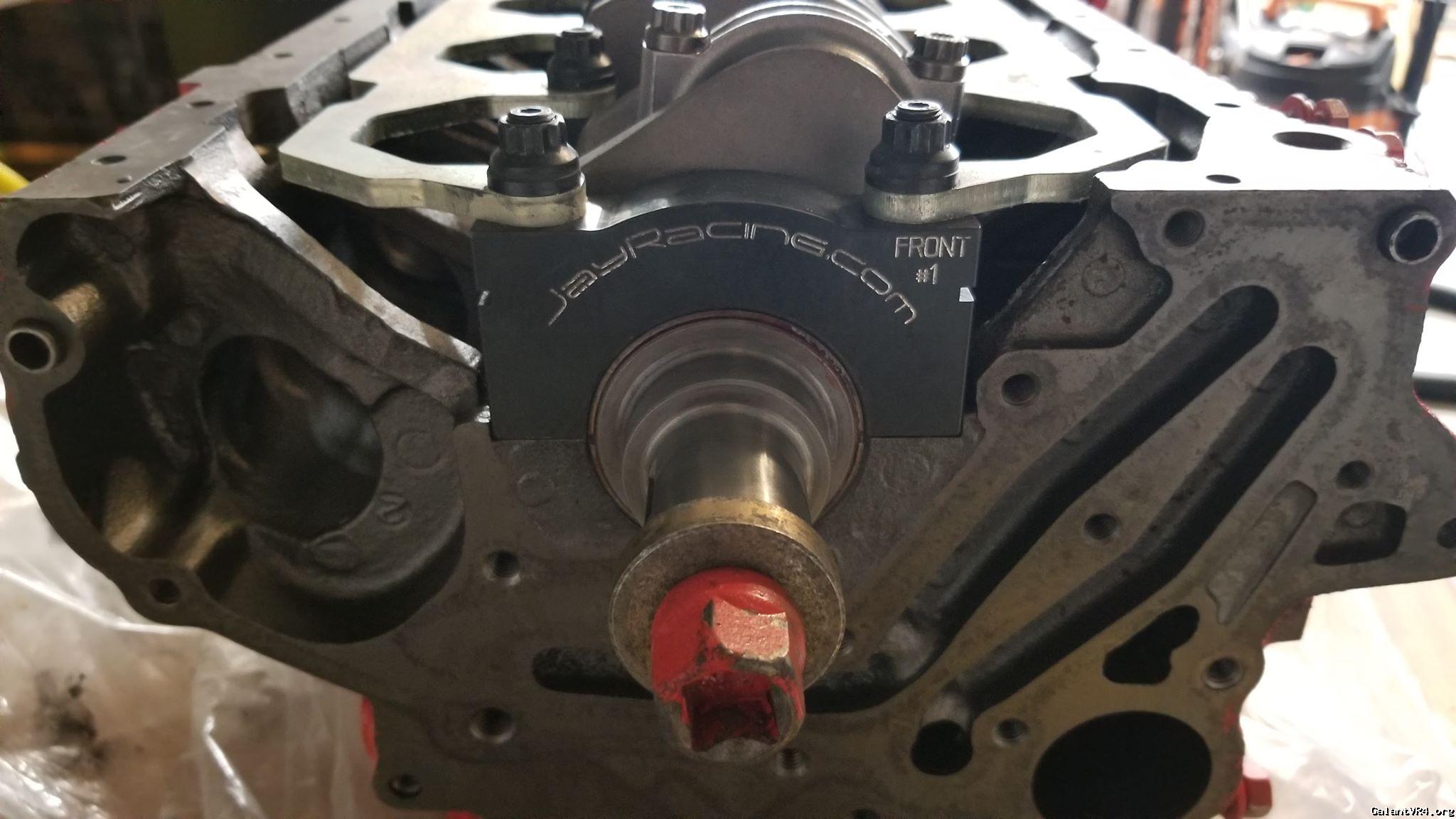

Jay Racing Billet mains, ARP studs, Kiggly Girdle...

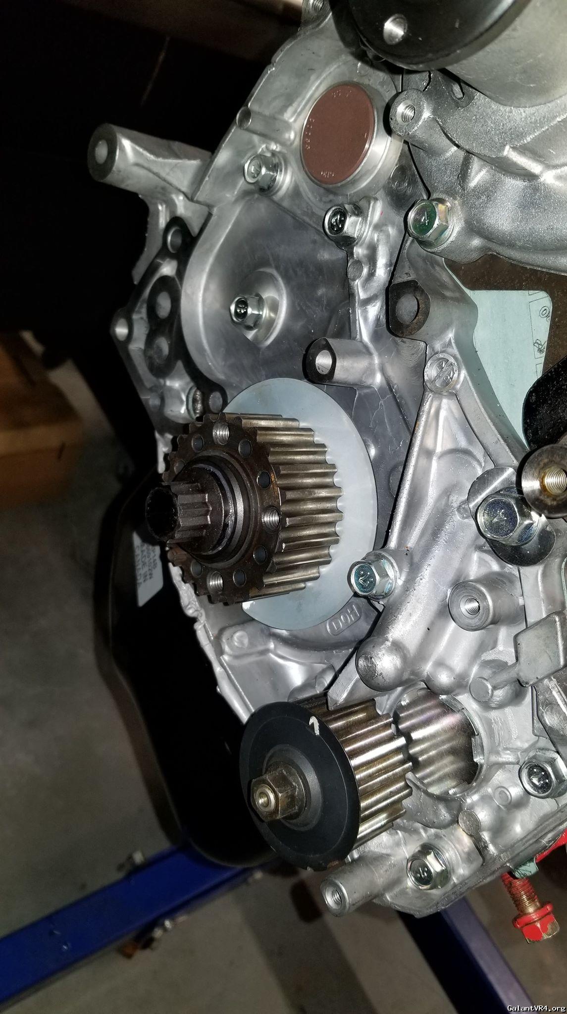

Front case is on. Unseen is the GSC race shaft. I know the stub is fine, but I've been wasting enough money that what's a little more?

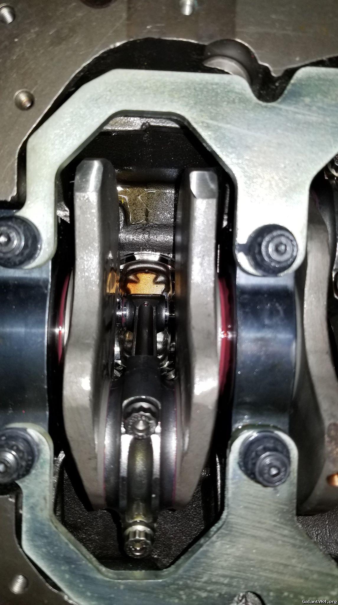

K1 Steel rods, billet mains, ARP everything, blah blah

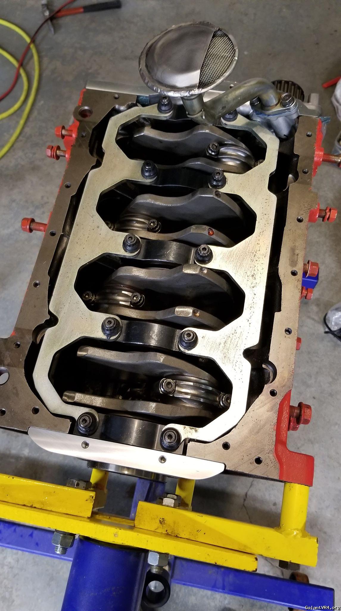

modded pickup tube (reduce chances of cavitation due to uncovering the front of the pickup nuking the oil pump)

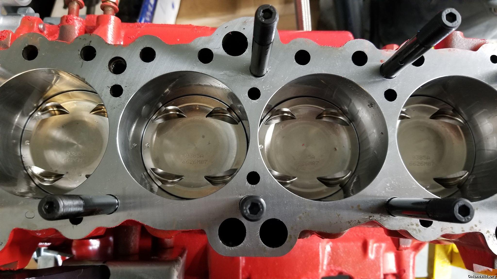

Some deep, deep valve cuts... something something 10.5:1 Wiseco 1400HD

I actually started working on the car again a bit last weekend but found that I need some extra tools (and a lot more patience) to measure all the valve clearances, and whatnot to get things degreed correctly. I will say my cam gear indicators look wonky, but at TDC the dowel pins are up, so it's a good starting point, and as long as I document the numbers I don't think it should matter. Anyone else who's gone down this road is free to correct me.
FWIW I'm running the 2.4L DOHC belt, 4G63 adjustable gears (Fidanza), FP3s, 2.4L (4G64 6 bolt), 2g head, and dual eccentric pulleys with the OEM tensioner.
