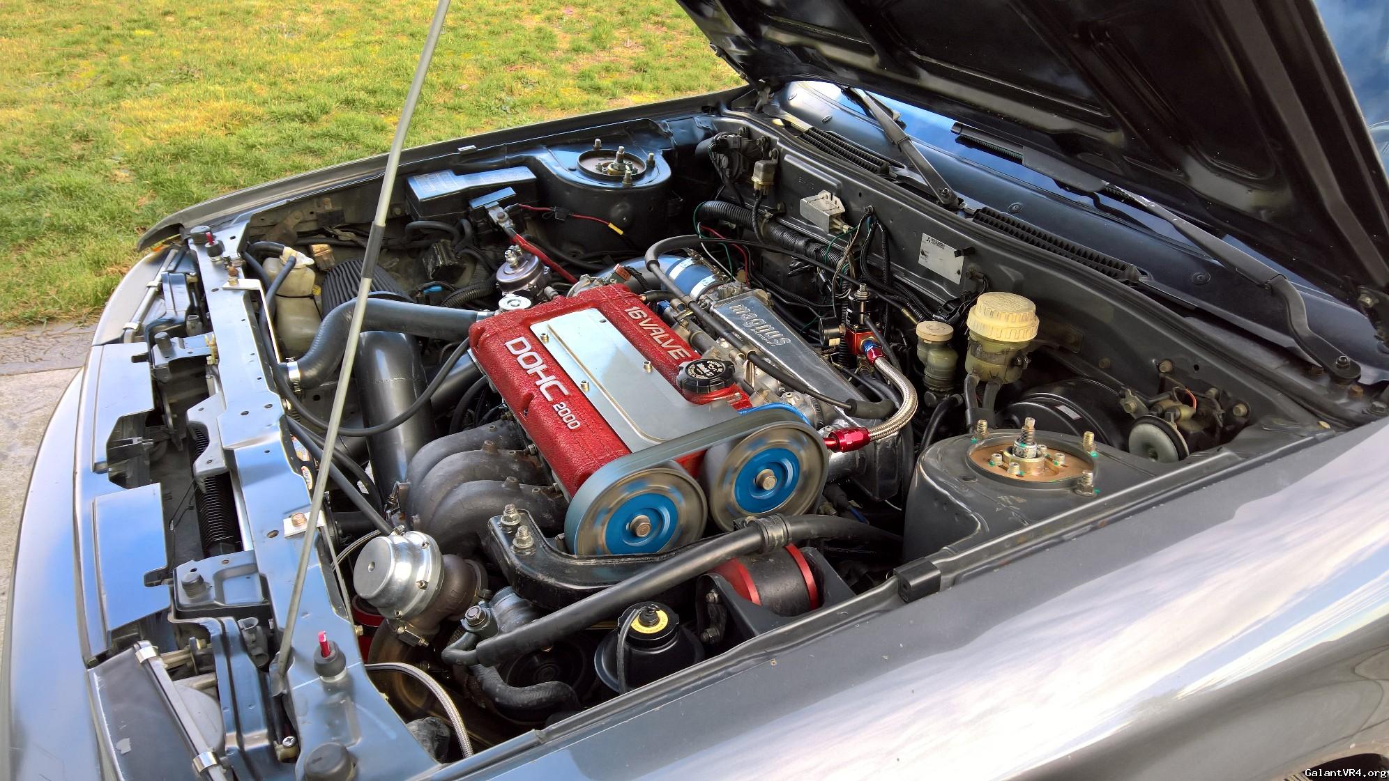

I need to get some good pics of the car, including underhood. Right now there's some hacky sh*t since I did a 3AM rewire of the secondary fuel pump before the event and it's not as tidy as I'd like /ubbthreads/images/graemlins/frown.gif

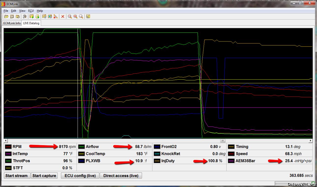

I may need some more fuel, and while I think the airflow numbers are optimistic, I can't wait to get on a dyno. If those are even close, it's ridiculous for 92 octane chevron. I will say the car has some slight traction issues in 1st & 2nd which makes me /ubbthreads/images/graemlins/devil.gif

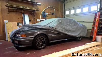

So I haven't driven the car in over six months due to being busy, but i was watching the video I made and I've definitely got some jonesing to get it out from under the cover.
If you haven't seen the video before (don't remember if I posted it in some other thread, but it's not in this one):
#461/1000 bit of 2nd & 3rd gear
mostly looks like this these days though....

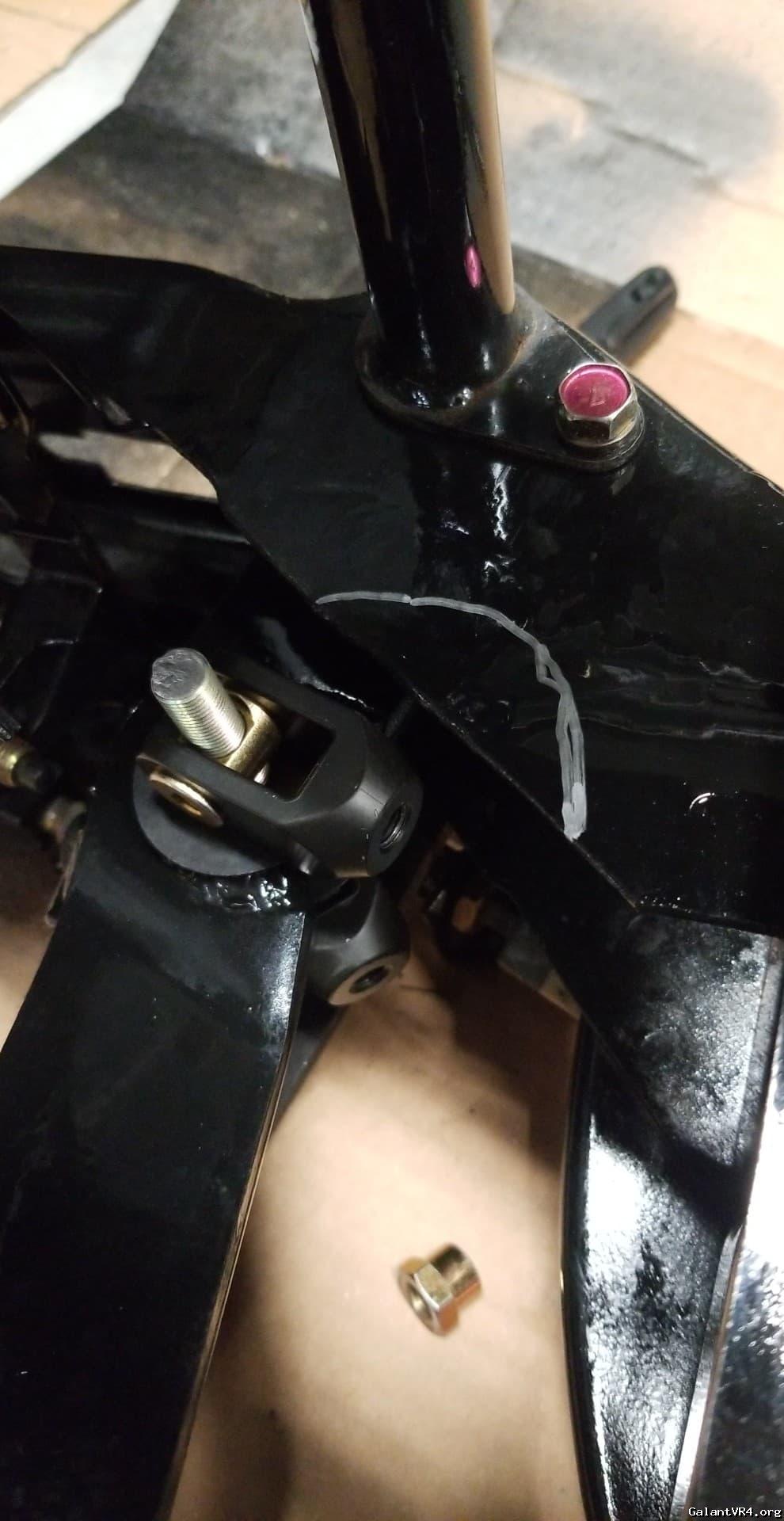

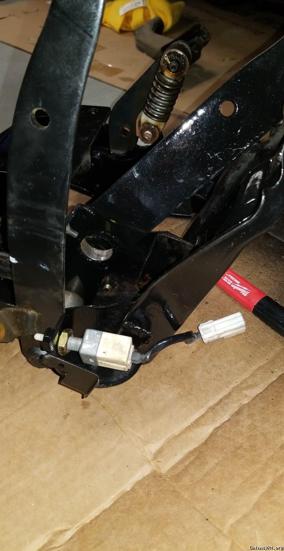

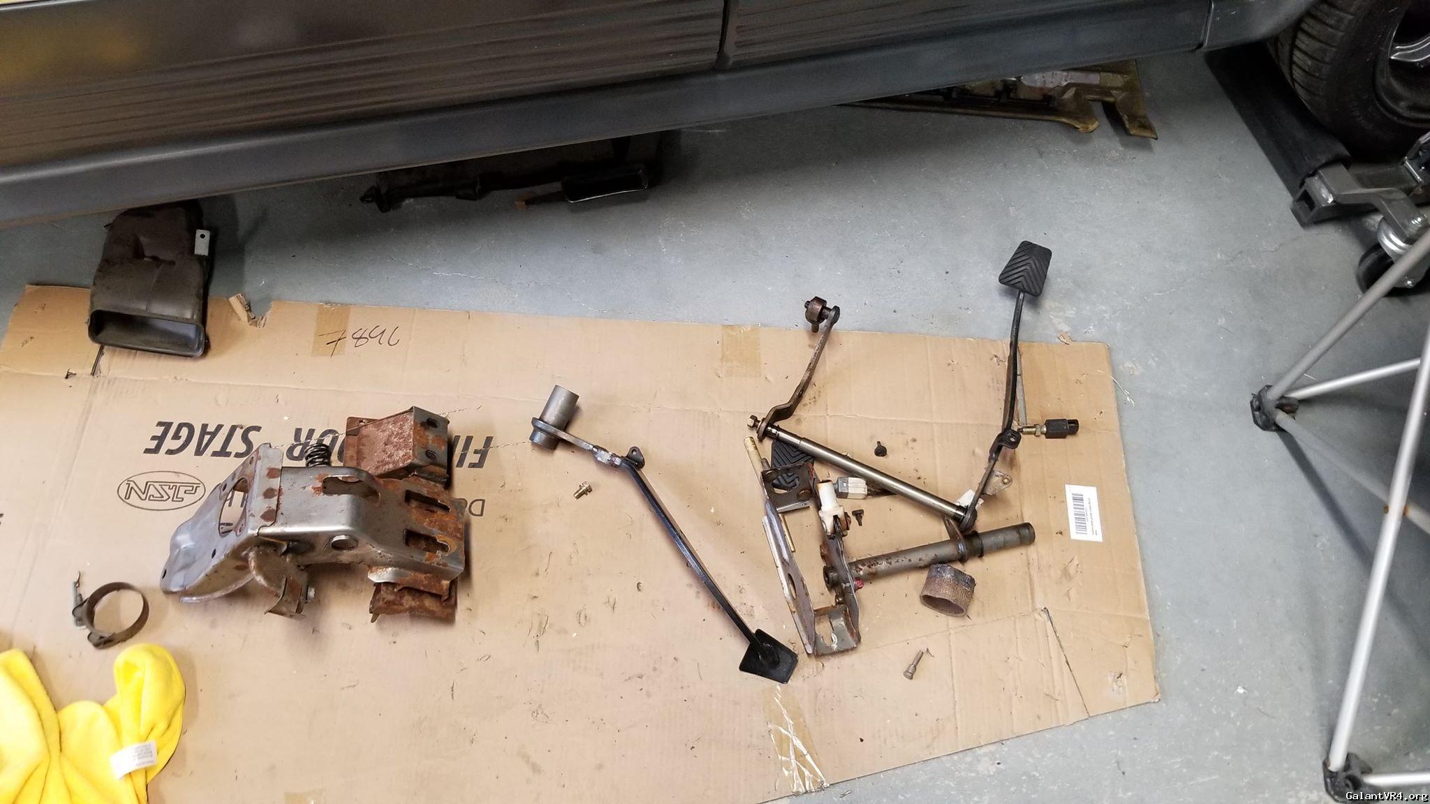

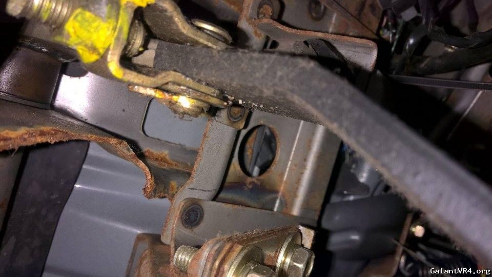

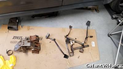

Stock brake clevis prior to pedal assembly removal

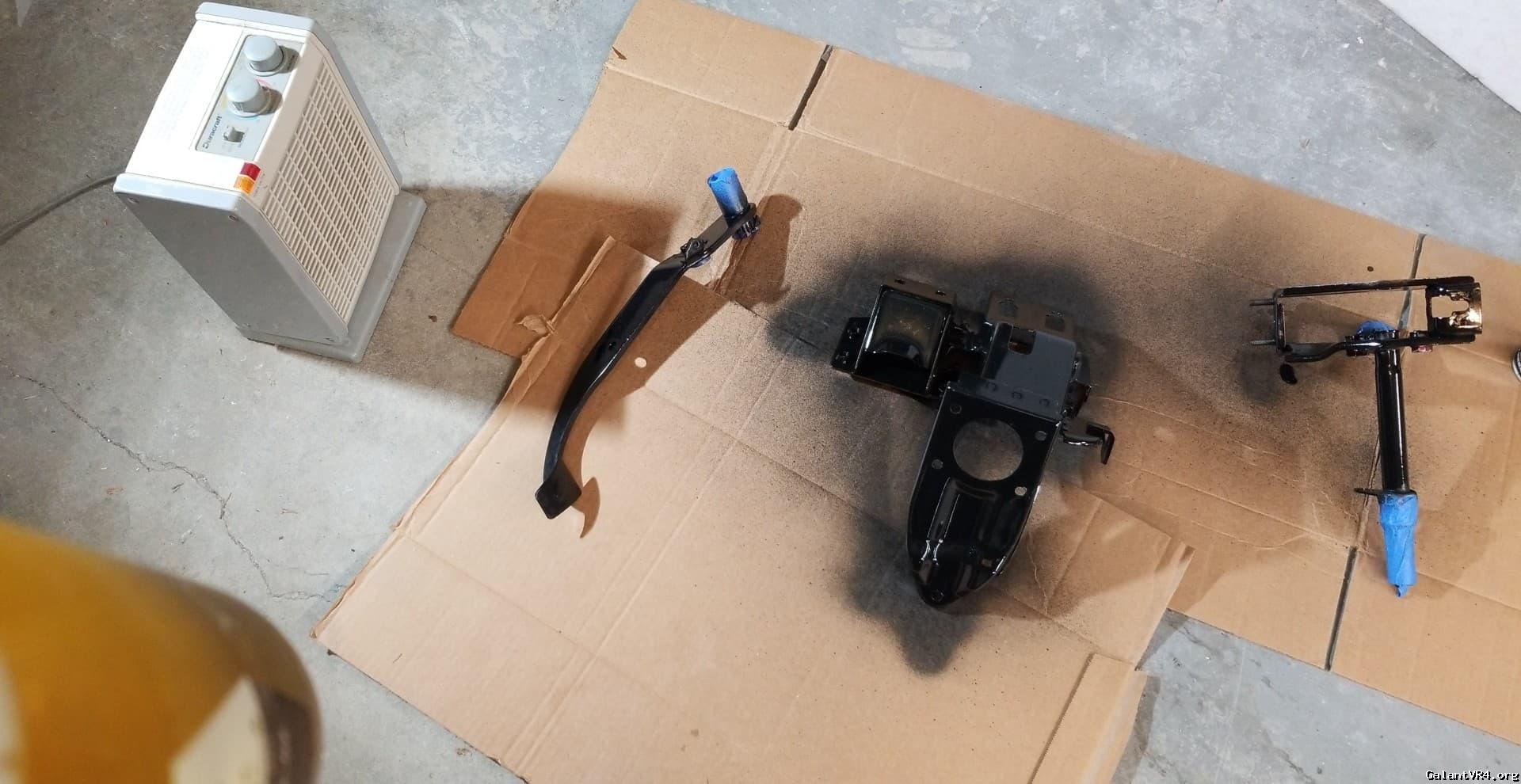

For a car that doesn't even have surface rust on the underside and suspension can be removed without PB blaster... the pedal box is nasty. Definitely going to sand, neutralize & paint before reinstall

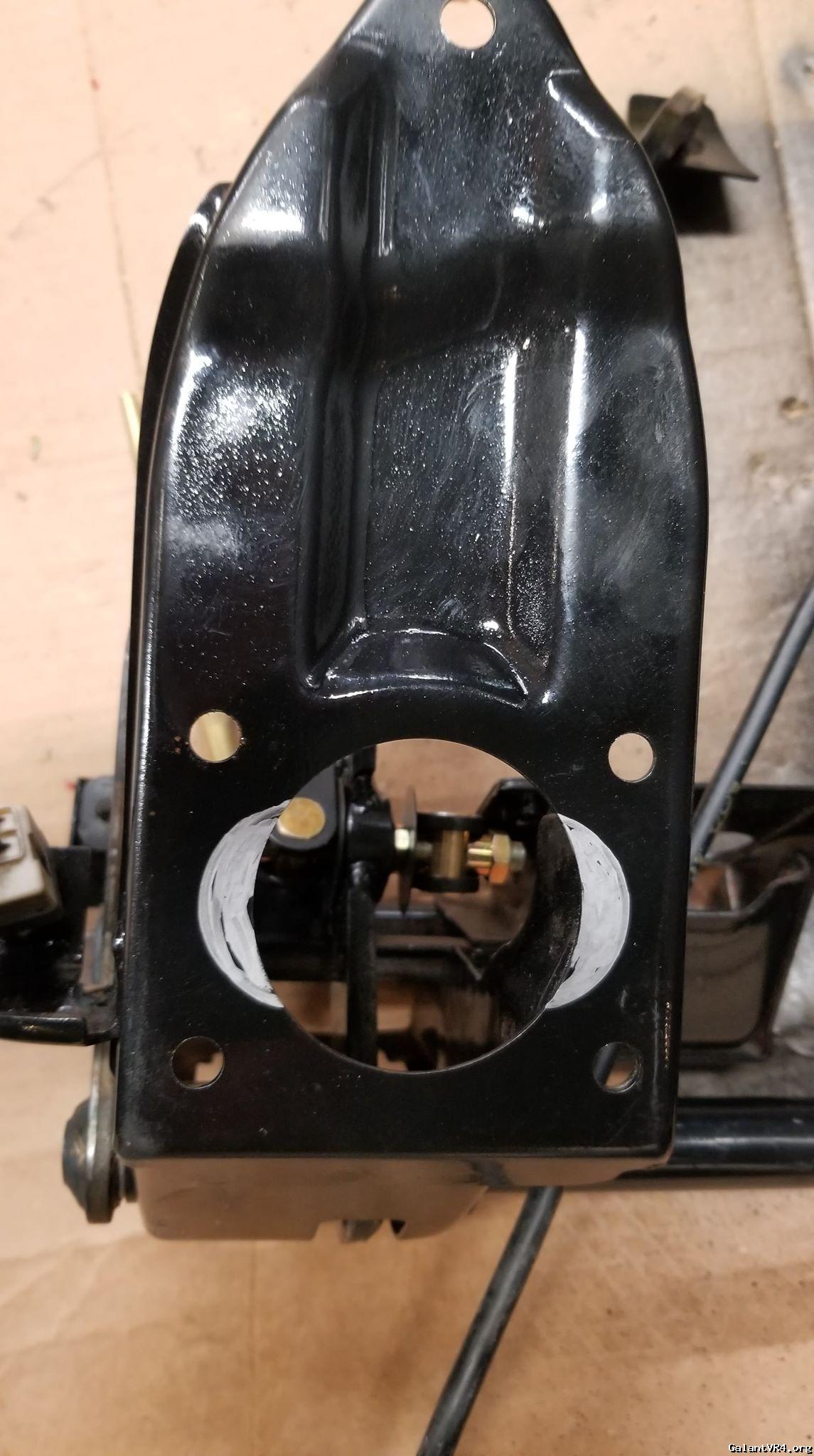

Modifying pedal ratio, and eliminating clevis adapter (balance bar installs directly into pedal)
Painting pieces, looking far better already

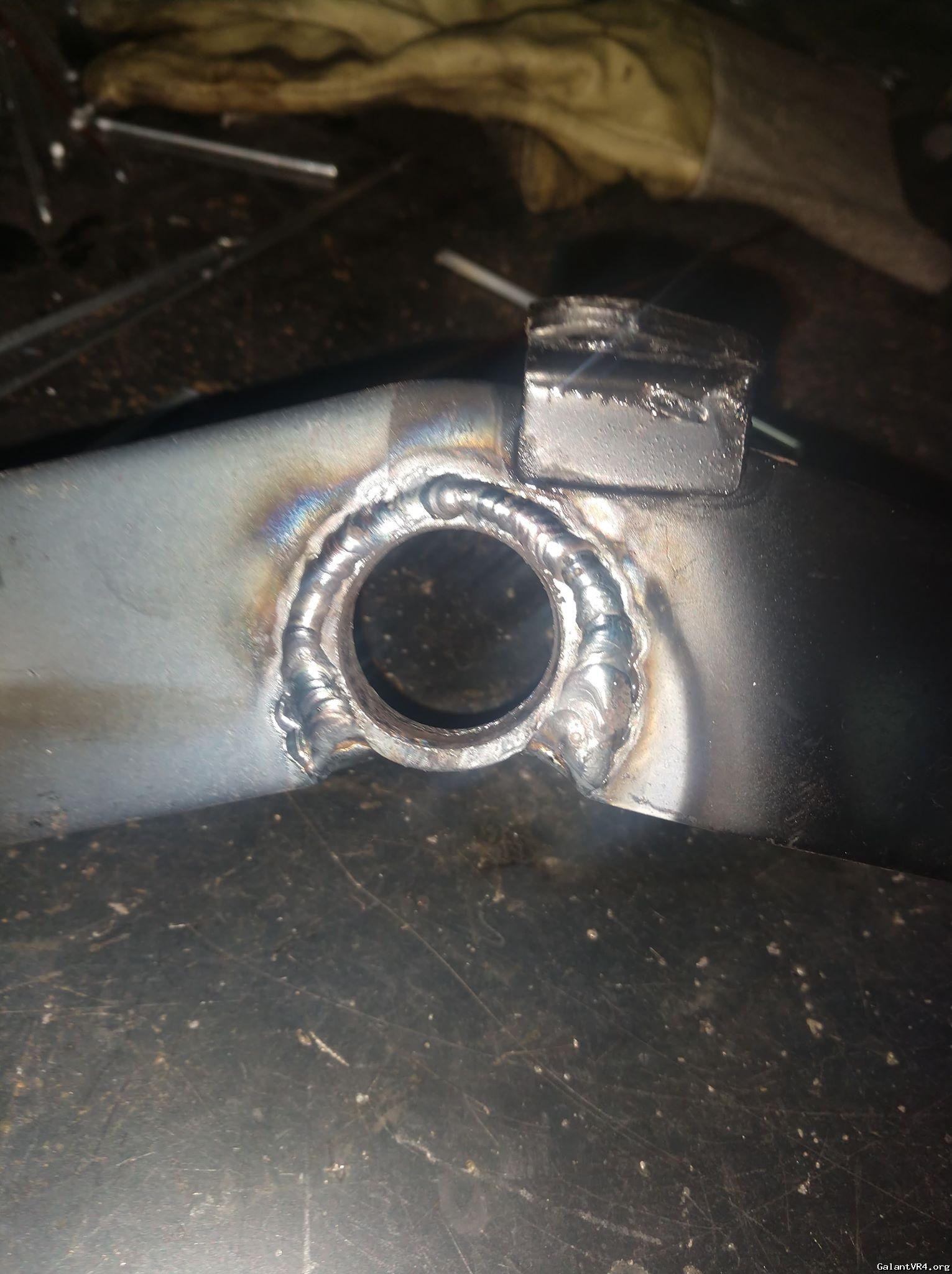

test fit round 1 of 10,298,235,092,835

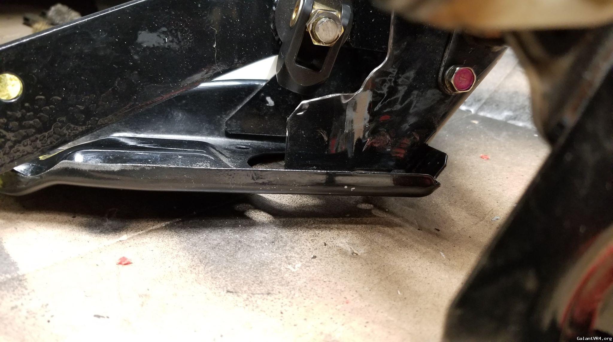

Rear master cylinder clevis hits the pedal box... time to do some cutting
not pretty, but it's under the dash, not sharp, and everything clears

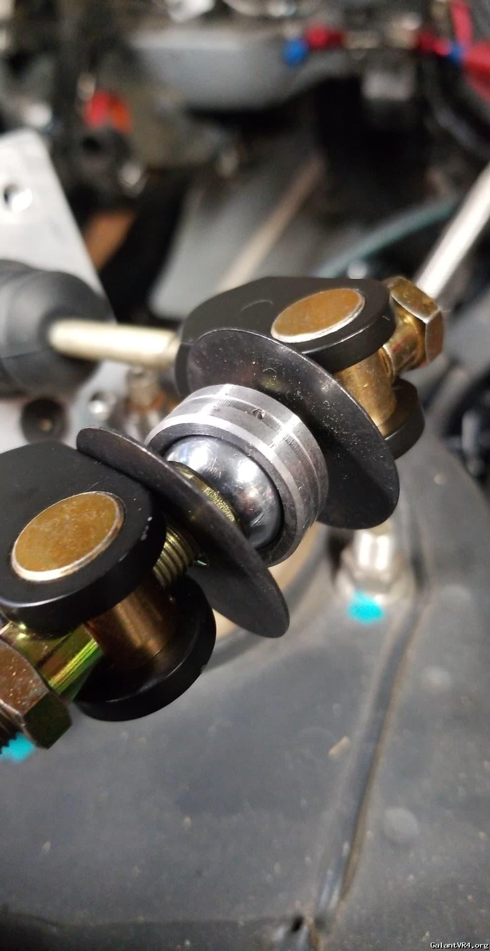

close up of the balance bar pivot with the master cylinders attached

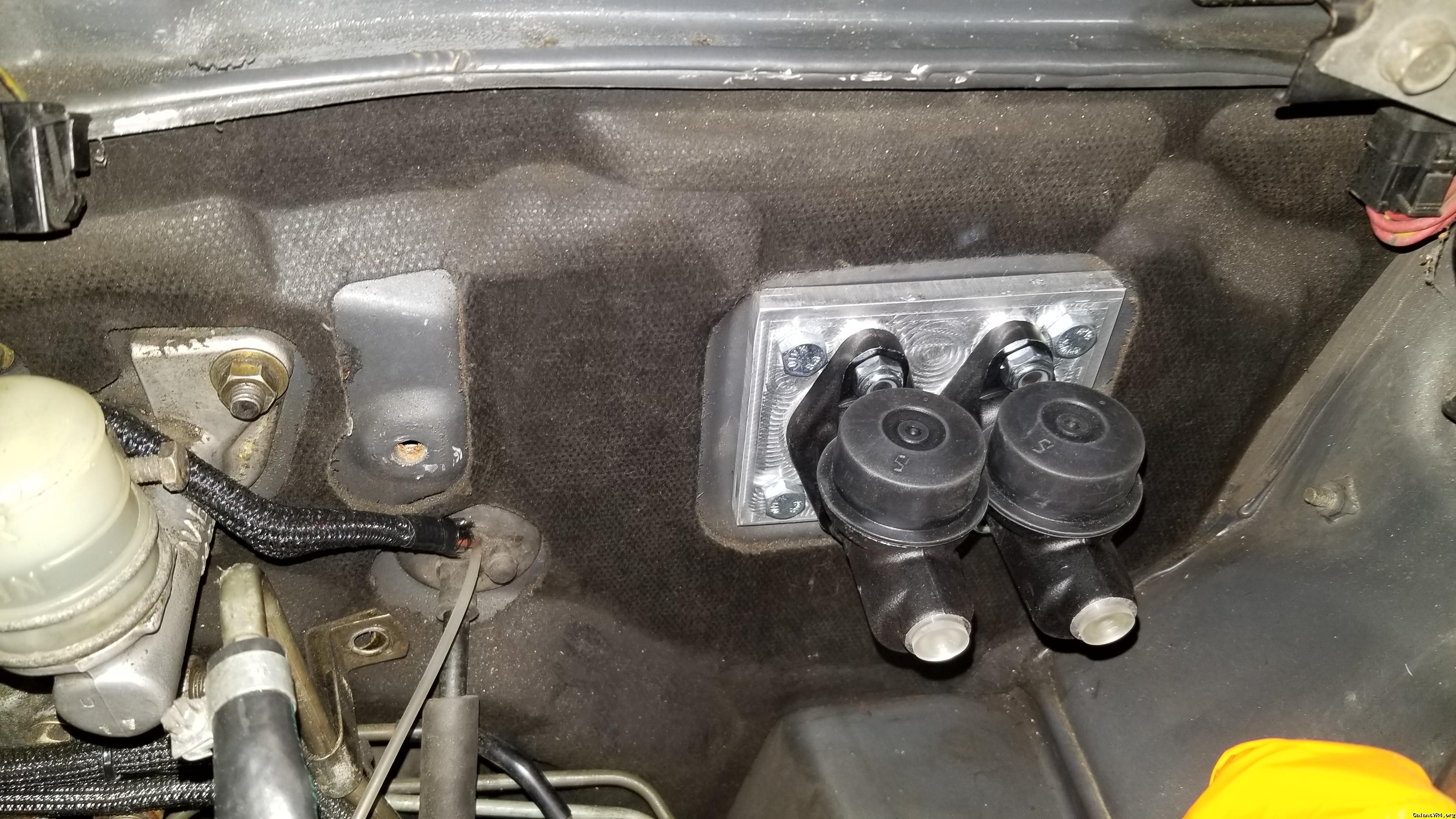

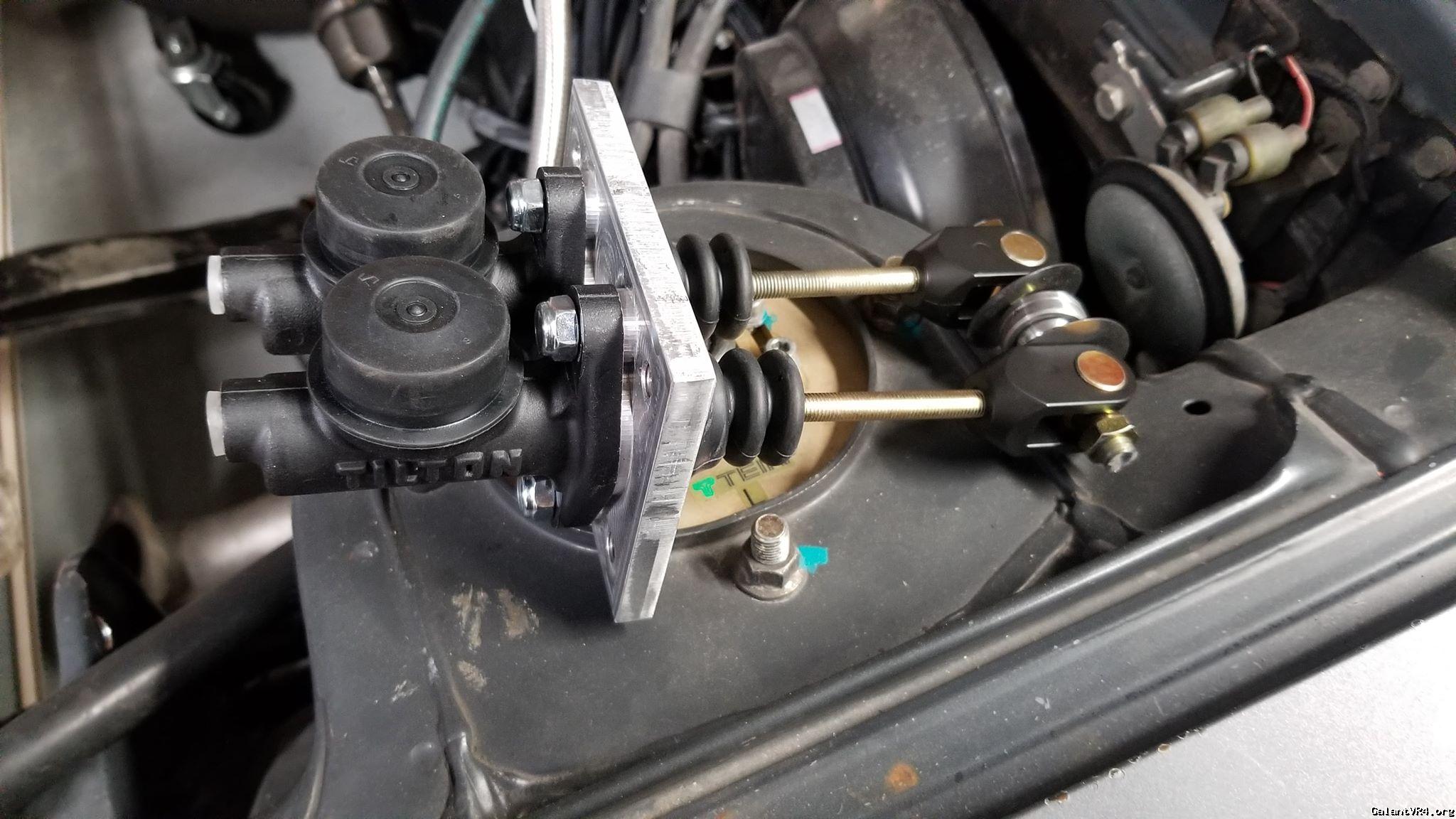

custom CNC mounting plate, Tilton master cylinders & Wilwood balance bar. Nasty old power booster in the background. Cylinders are 3/4 Front & 5/8 Rear

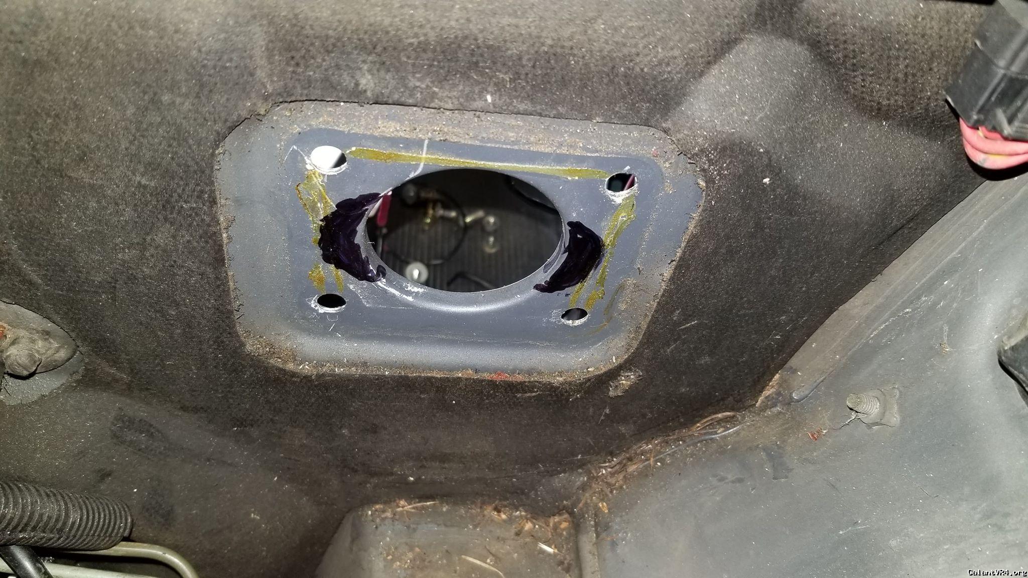

more cutting! the plate matches the bolts perfectly, but the Tiltons need more room to get through the firewall
Of course, the pedal assembly would feel left out, so it wants to be disassembled and have more cut off there too /ubbthreads/images/graemlins/laugh.gif

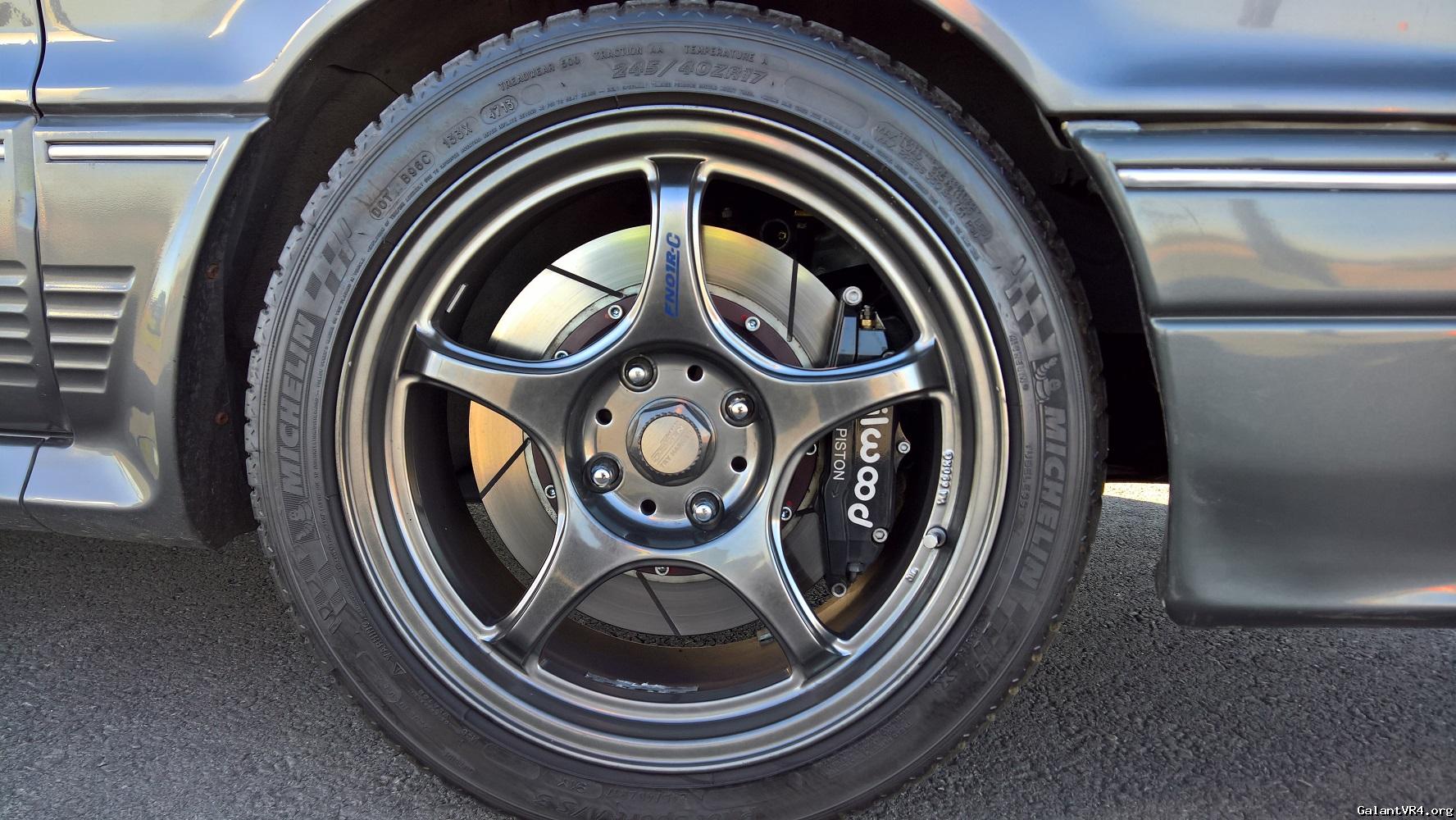

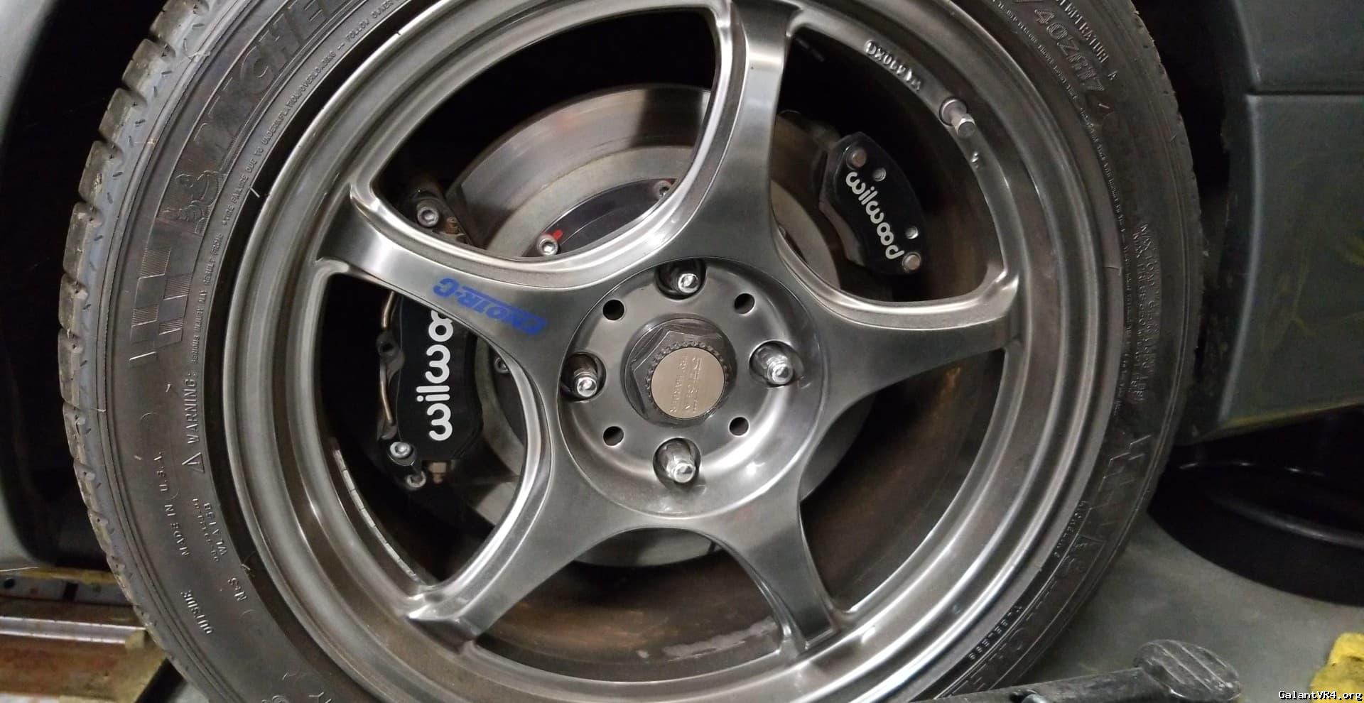

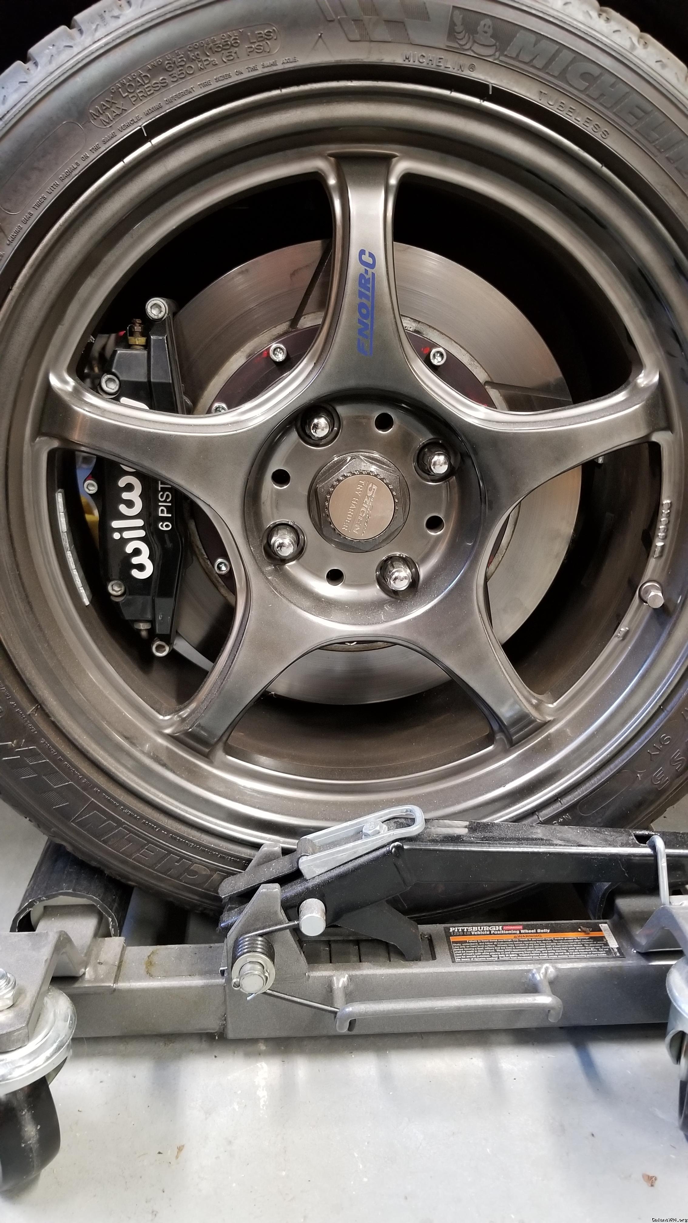

Brief glamour shots of the wheels & such... Front brakes are a TCE performance kit, 13" Dynapro 6 calipers
Dyna Pro 4 rear calipers, and a second parking brake caliper that uses the OEM cable pull
Master cylinder plate & masters mounted

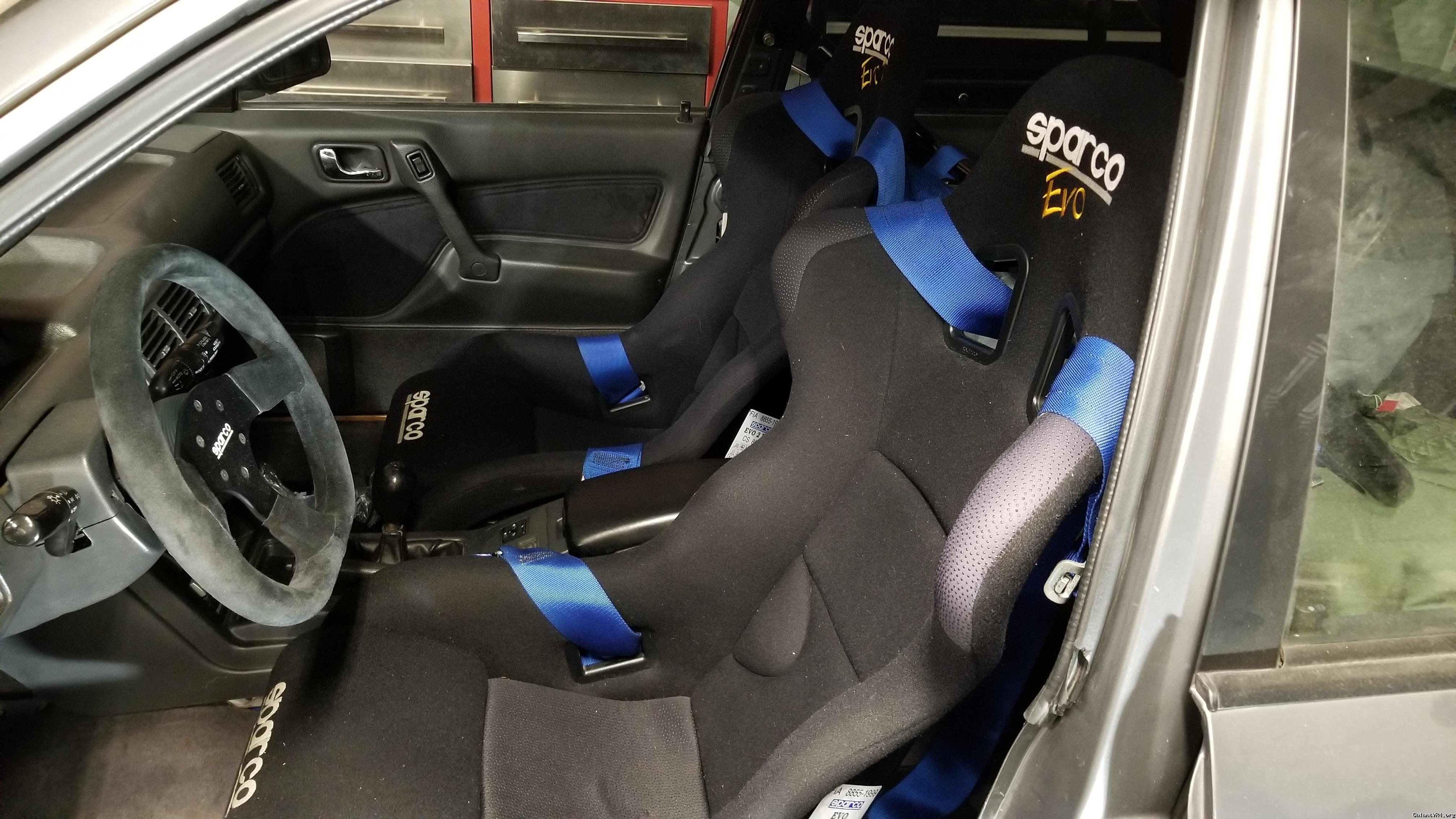

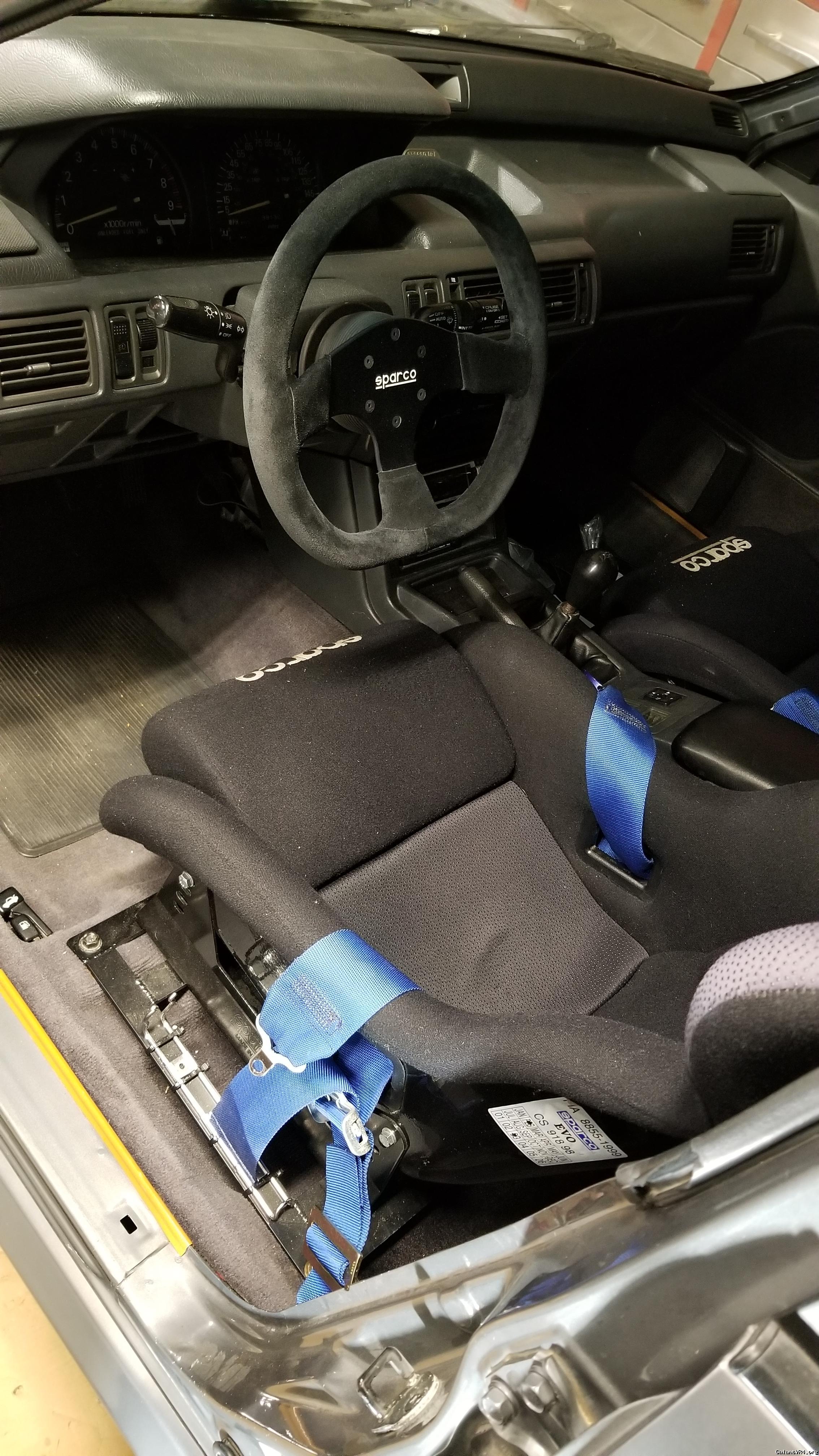

Dash back together, seat installed
Looking more like a real car all the time

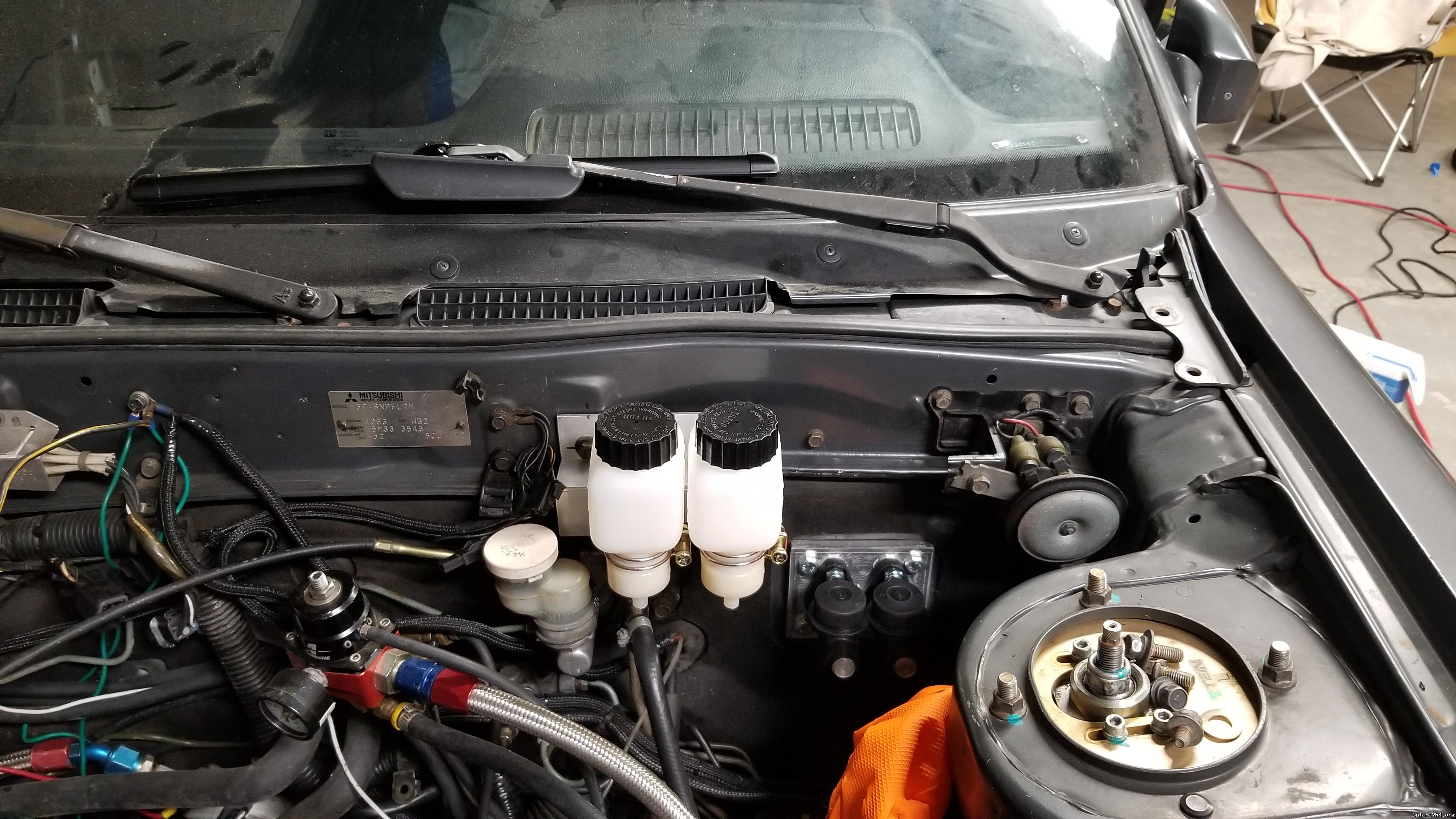

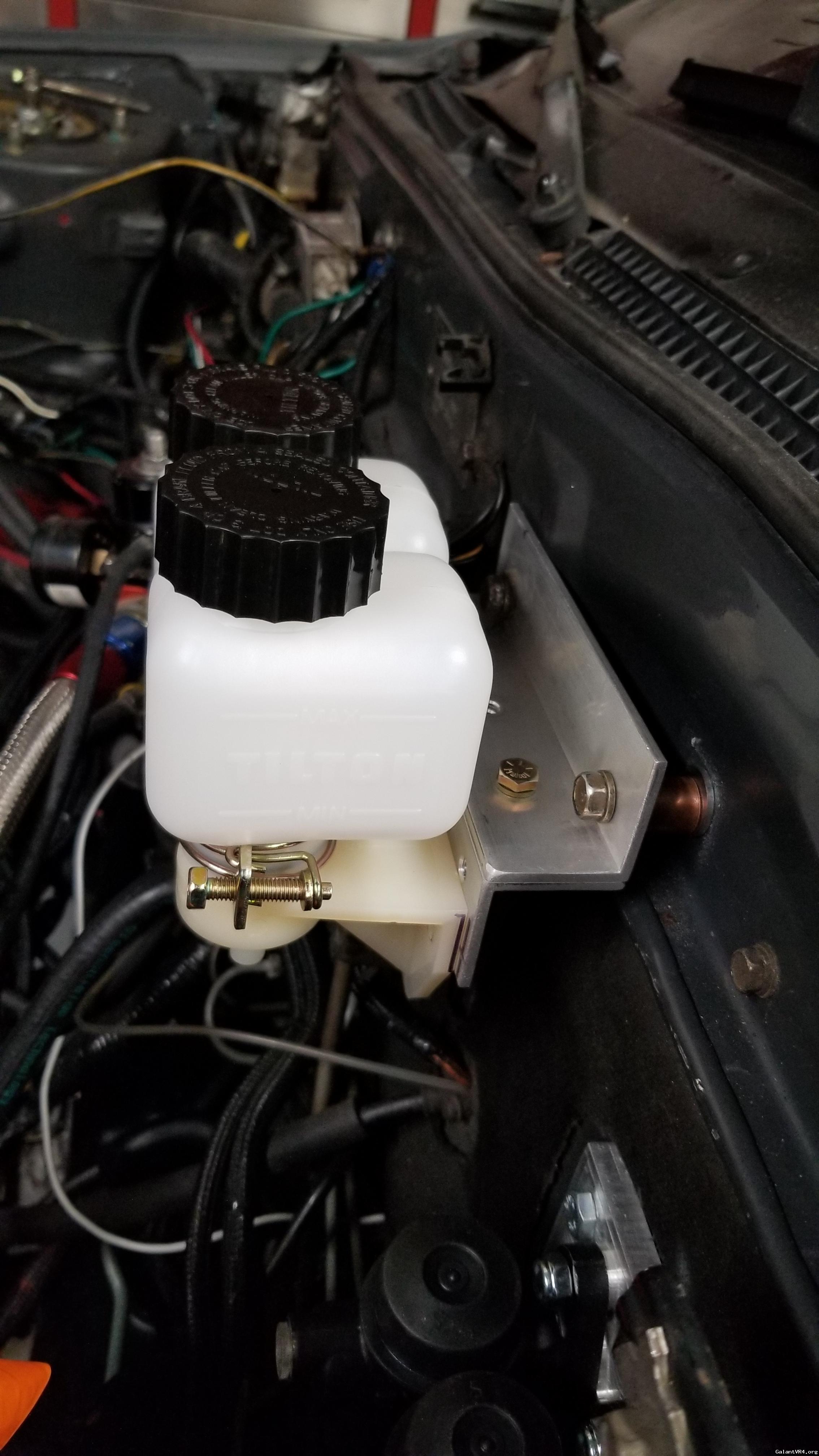

Built a bracket out of aluminum- when your fab tools are some cutting implements and a drill press, you do the best you can
Better view of how the reservoir mount sits

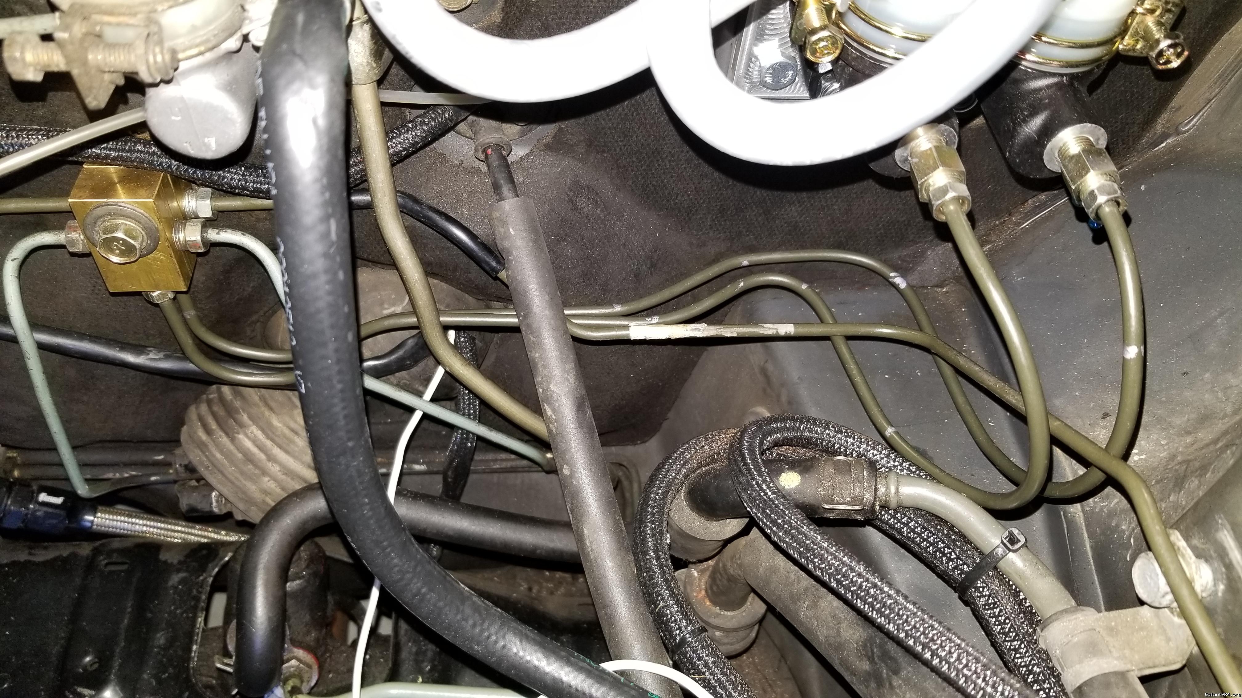

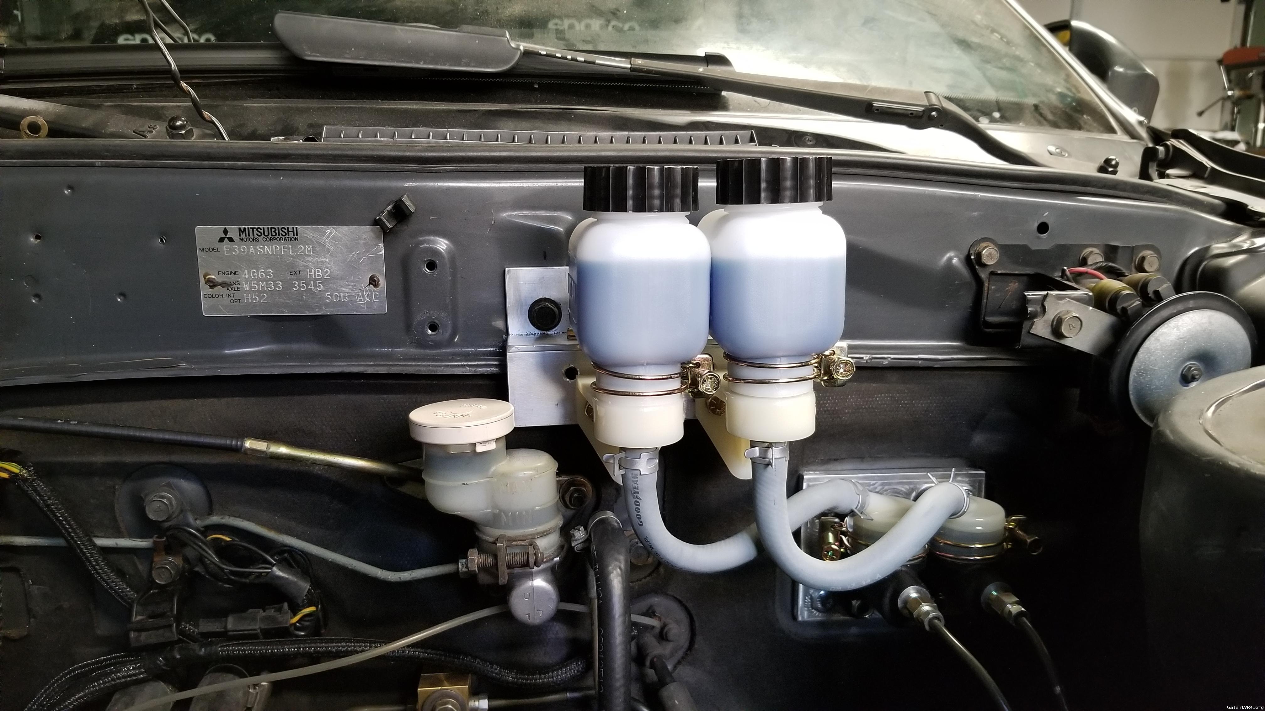

hand bent hard lines- they're 10mm at the blocks to match the car, and SAE at the master end due to the fittings I had being AN -> SAE... ah well, it's not stupid if it works
Everything mounted, and sweet illegal ATE Super Blue fluid in the system (USA DOT bans non-amber brake fluid for street use, derp)
