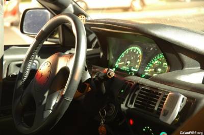

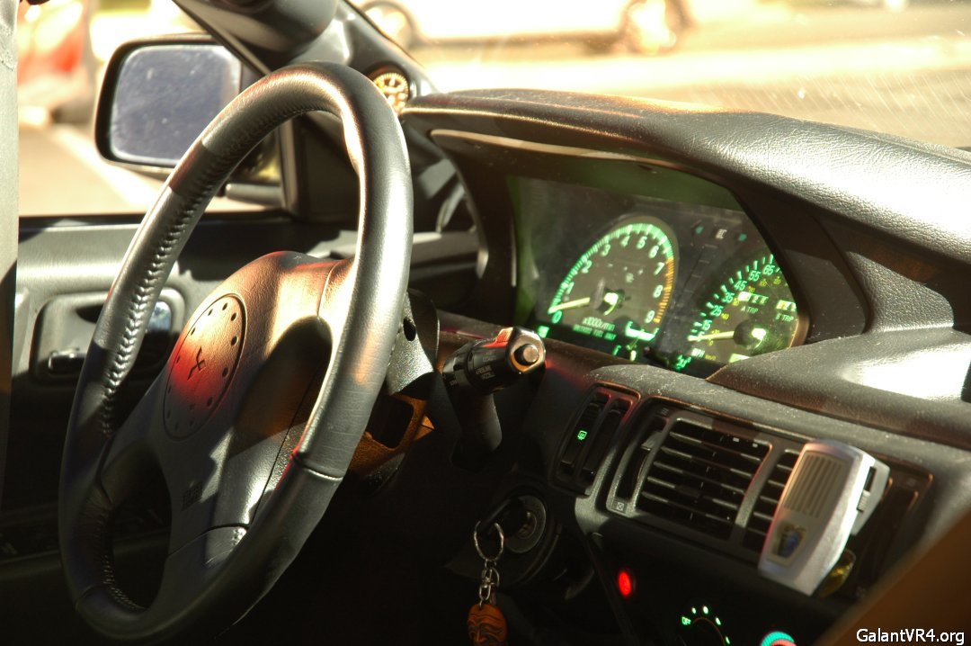

3G steering wheel installed.
gvr4ever
Aug 6, 2002
6,260
central Indiana
I have been PMed more then once asking for a pic. I have misplaced a number of interior pics, but I did find this one.
I'll add more to my profile the next time I clean up my car.
How's the size compared to oem & dsm? Is it a true bolt-on? Does it have air bag?
gvr4ever
Aug 6, 2002
6,260
central Indiana
I think it is about the same size as the original. It's thicker and has a better feel to it. It is a direct bolt in, but the air bag was disabled. The horn is not currently hooked up because the setup is different. I just rev at people or get out of the way.

Wow, that looks really nice! To disable the airbag did you set it off or just not hook up any electrical?

You just leave it disconnected (not that there is any place to connect it on our cars). That wheels looks REALLY good, I've gotta keep an eye on for one on ebay.

Is it just me, or does your dash have a nice glow to it?
It's just the camera settings. No flash was used, so the shutter had to stay open longer. I havn't done anything to the dash. I've tried, but the color replacement bulbs I tried didn't fit right.
10,992
I was the originator of this install (not trying to take away from William, just my part of the story). I removed the inflator portion of the airbag unit so it cannot deploy, keeping the bag in there to keep the proper feel.
The splines are a direct fit. Weight is heavy, so feeling is nice. I love the grip. Driving 115 now with the stock wheels despite it's leather makes me miss the wheel on 855.
I actually modified my setup with a horn ring provided to me by Ward (467) from some other car (early galant?, don't recall) and had the horn working. It stopped for some reason and I have not fixed it yet. Maybe a wiring issue.
I think I posted a pic once, but can't remember for sure, and can't find it now.
