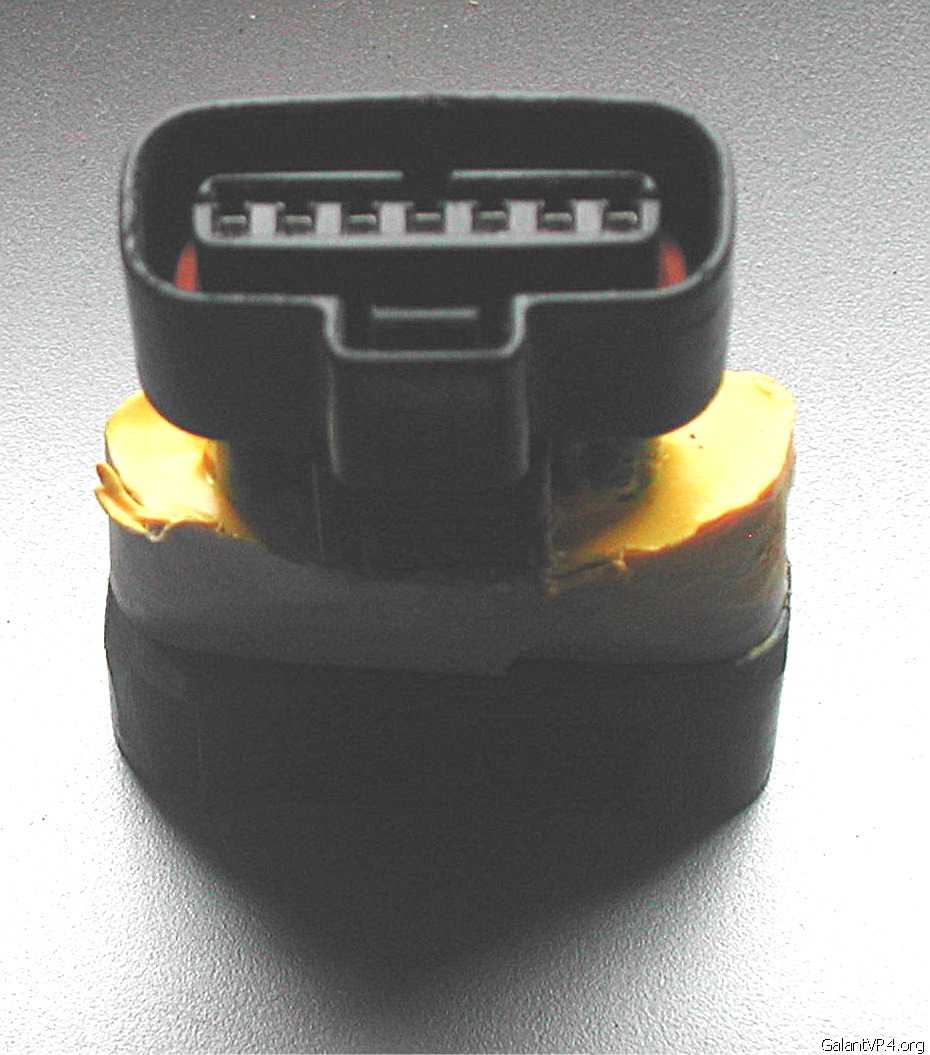

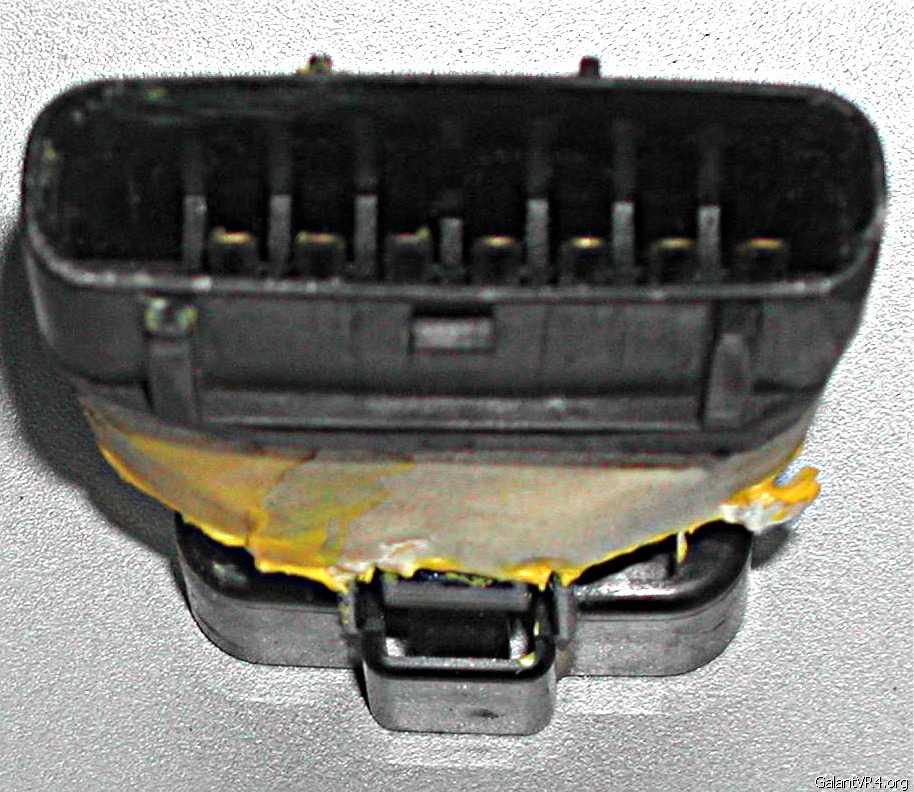

Thanks to Iceman and Keydiver, I am getting ready to install my 3G MAS. Since the wiring is so easy, I just potted up an adapter, 2G to 3G today. Here are a couple of pictures. Once the potting has set up I will make a more permanent black cover.
Looks good. You should find the parts and build them for people.
I don't need one, but I almost did. I'm gonna go with the MAFT and GM MAF.
