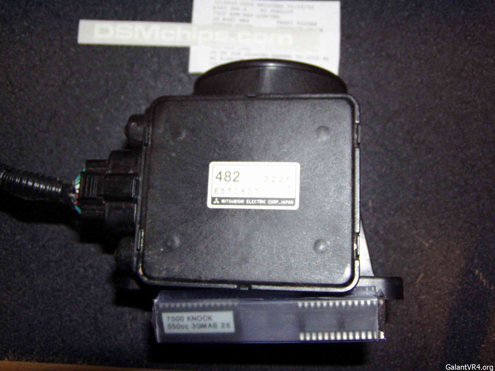

I just picked up the 482 MAS today and Keydiver came through also with flying colors (as usual). The chip came today also.
I will order the 550 injectors Monday and I hope to have the whole setup installed on next Saturday.
I am looking forward to having this tested setup in my car.

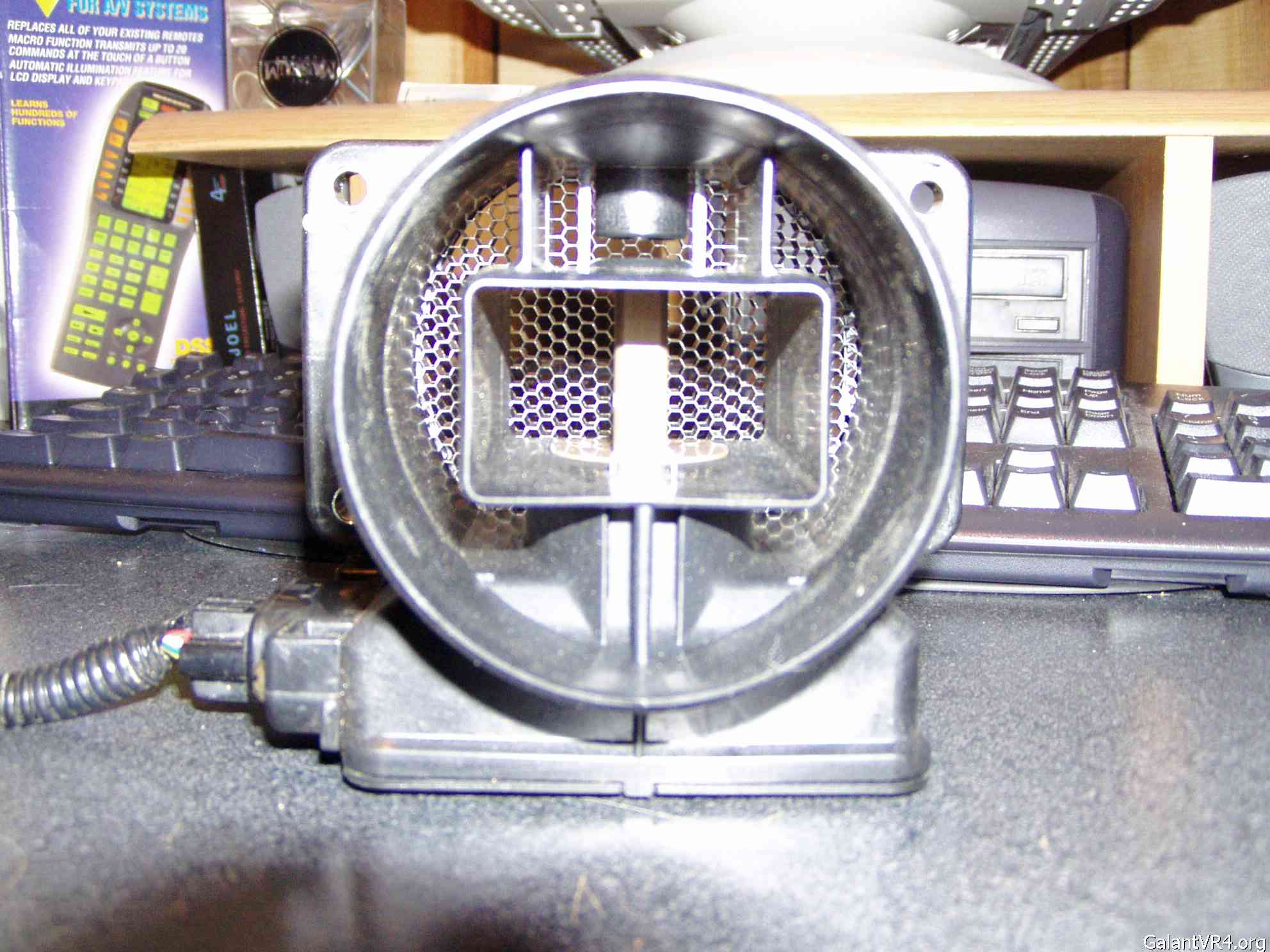

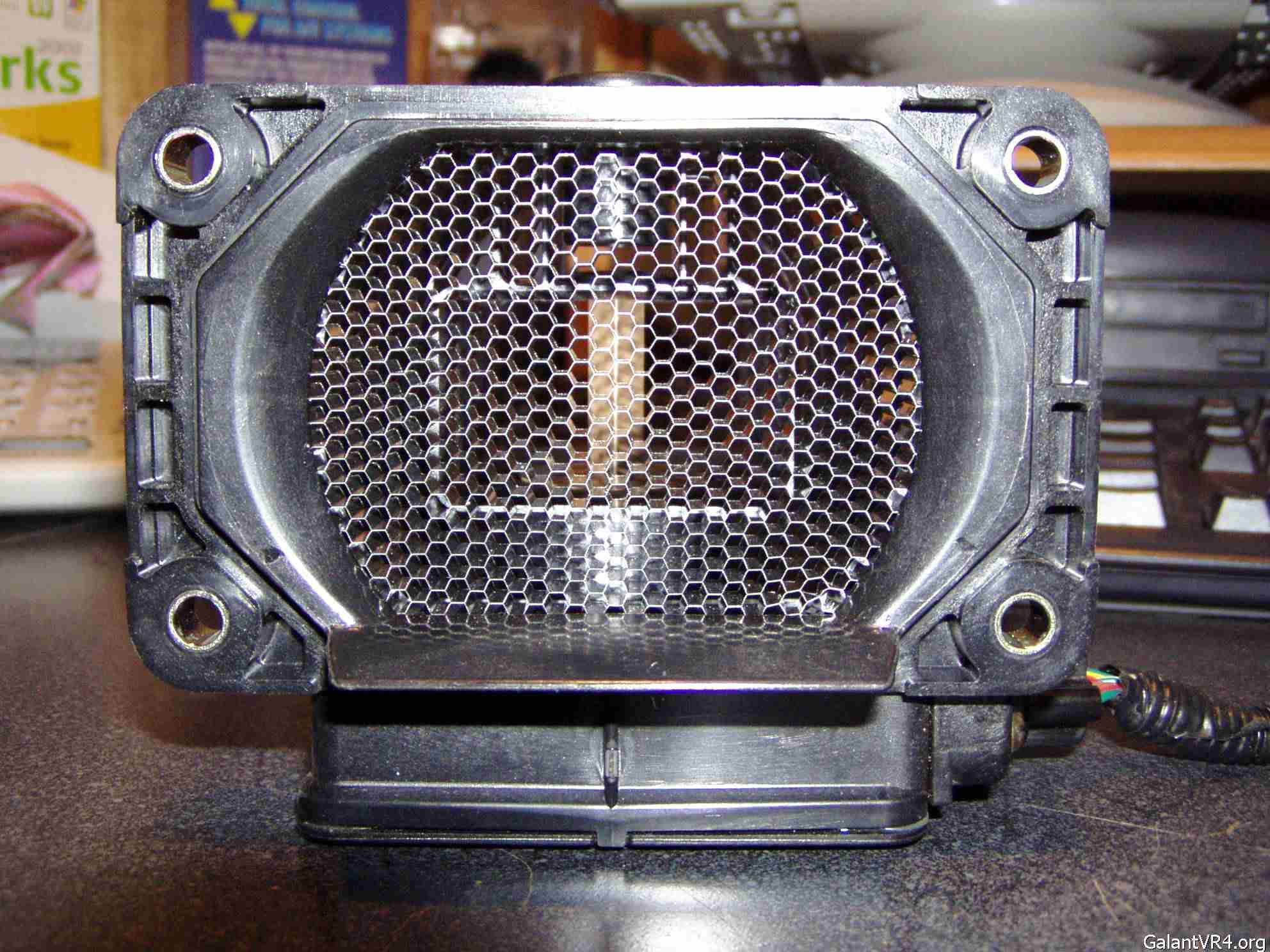

Here are a few pics. I will try and take a complete, before, during, and after set of pics. I have been looking to do this for a year now. I just did not want to use a 2g setup or go through the headache of a GM setup.
Here are a few starting pics.

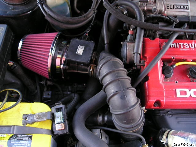

Installed on my stock one that I am trying very hard to not modify (and not succeeding /ubbthreads/images/graemlins/smirk.gif)
Tom

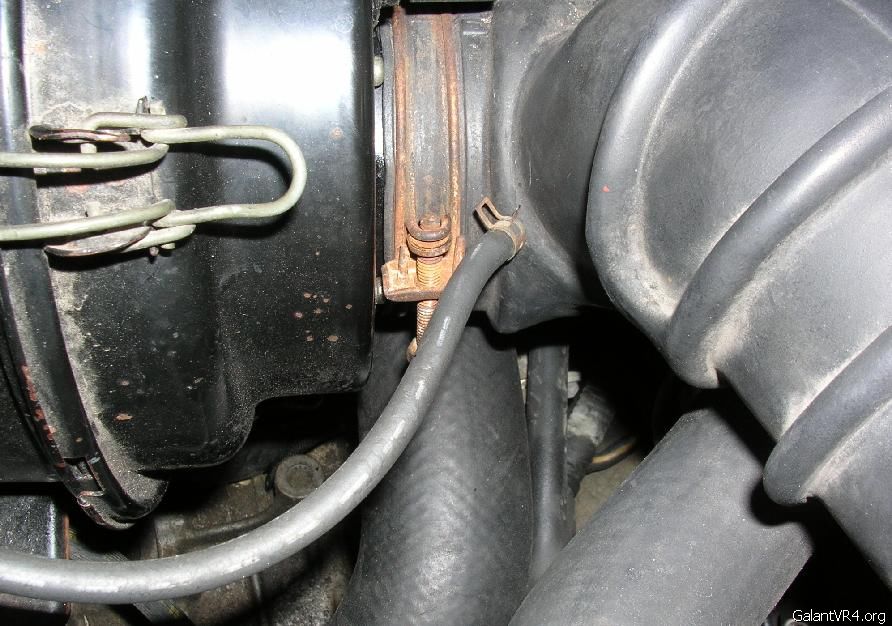

Oh, by the way, here is how I resolved my "leak" becuse I didn't have a place for the BCS to connect to:
I drilled a 1/8" hole on the intake hose, and JB Welded a LONG pop-rivet into the hole. Works perfect!
ok i have a couple questions. if i just wanted this maf, and to use stock injctors, your chip will correct for this right jeff? as in i wont need an afc? also, tom, whered you get the filter adaptor for this mas?
autobahntom
Feb 8, 2003
1,250
Delaware
The adapters are the same for a 2g and a 3g, so it is available at almost any of the vendors that cator to us.
To answer your to Jeff question, my car is stock (as in even has stock exhaust); and the www.dsmchips.com eprom eliminates the need for an SAFC.
Tom
I believe that air filter was from eBay, but I don't remember exactly. Like Tom said, any 2G air filter will fit the 3G MAS.
The Hz output of the 3G is almost 40% lower for the same airflow as a 1G MAS, so what I do to the chip to correct for the 3G MAS is threefold:
1) I change the MAS compensation map so that the injectors use the proper pw for the airflow coming in
2) I change the multiplier used to determine which timing and A/F map to use
3) I change the Hz at which the ECU decides which fueltrim to update
These three things together should make the 3G MAS function perfectly, I know it sure feels good in #880. /ubbthreads/images/graemlins/grin.gif

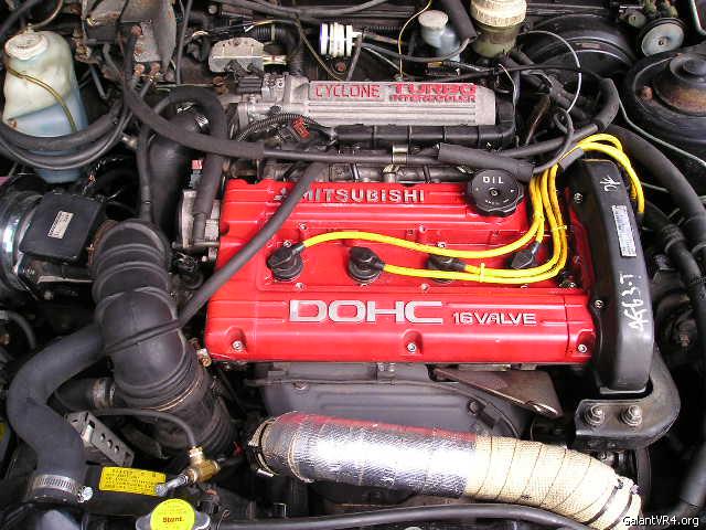

Installed the cyclone intake manifold to compliment the 3g MAS yesterday. First impression after driving is the smooth power delivery. Very had to tell it has a turbo (except by sound).
Car is almost stock:
Keydiver Eprom
510cc inj
2 1/2 turbo back exhaust (with cat)
Cyclone intake manifold
