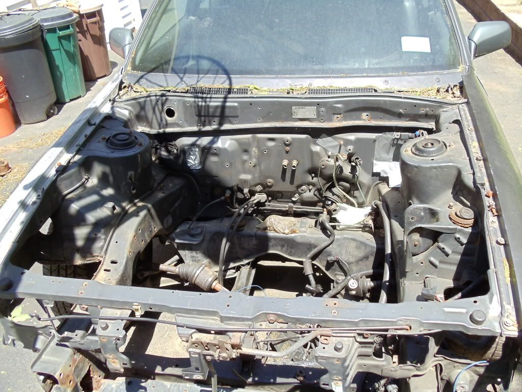

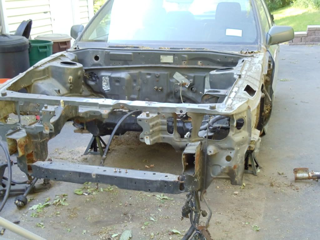

Ok, so I have a master bushing kit here to install. I also stripped down the engine bay, Friday I plan to drop my front subframe and get it prepped for paint. I need to decide what I want to POR15. I'm thinking it might be easier if I just POR15 the entire bay, and under the fenders then spray it with Kensington Grey. Immediately after that, hopefully by the end of June the body will be getting painted and then I can start my final assembly. I'm trying to decide about what I want to do with the wiring harness, because this one is a little hacked. I really might just get some wire and some loom and make my own harness because I think it will look much nicer and be cleaner. I also painted my calipers and brackets using a POR15 caliper painting kit.
How it sits now.

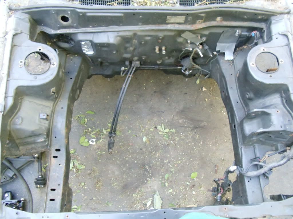

Now it's really empty. I'm going to start cleaning up my subframe to get it ready for POR15, and when I actually get the POR15 back from my brother I will start on the bay.

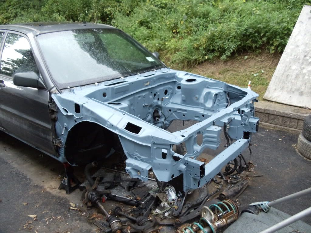

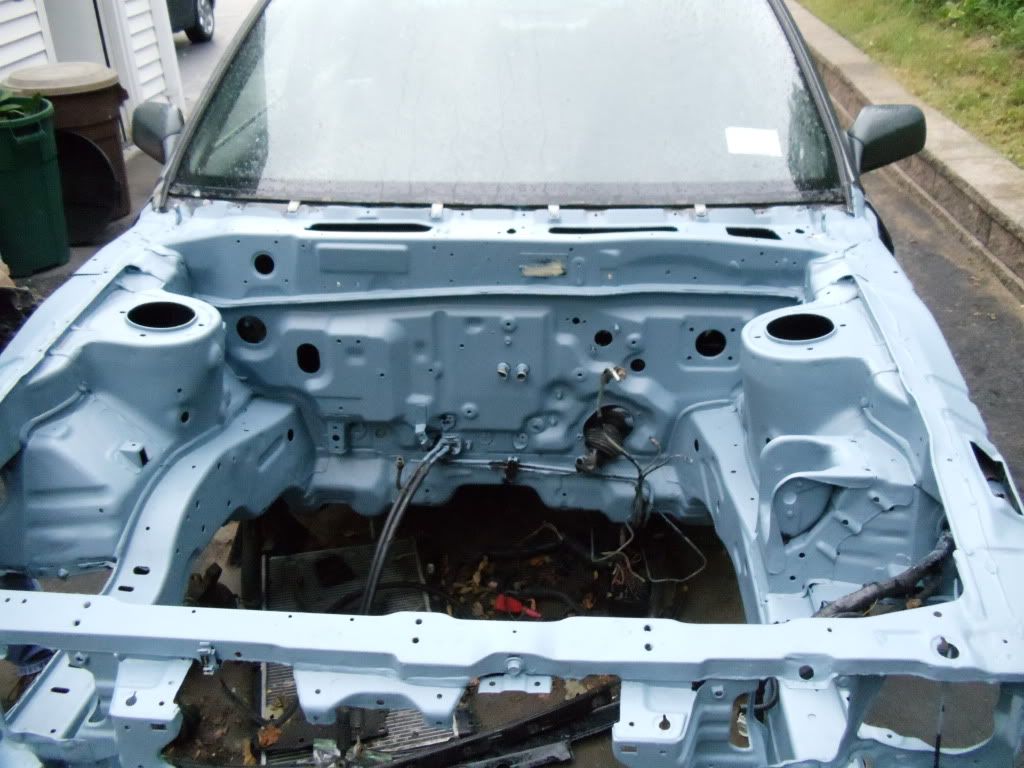

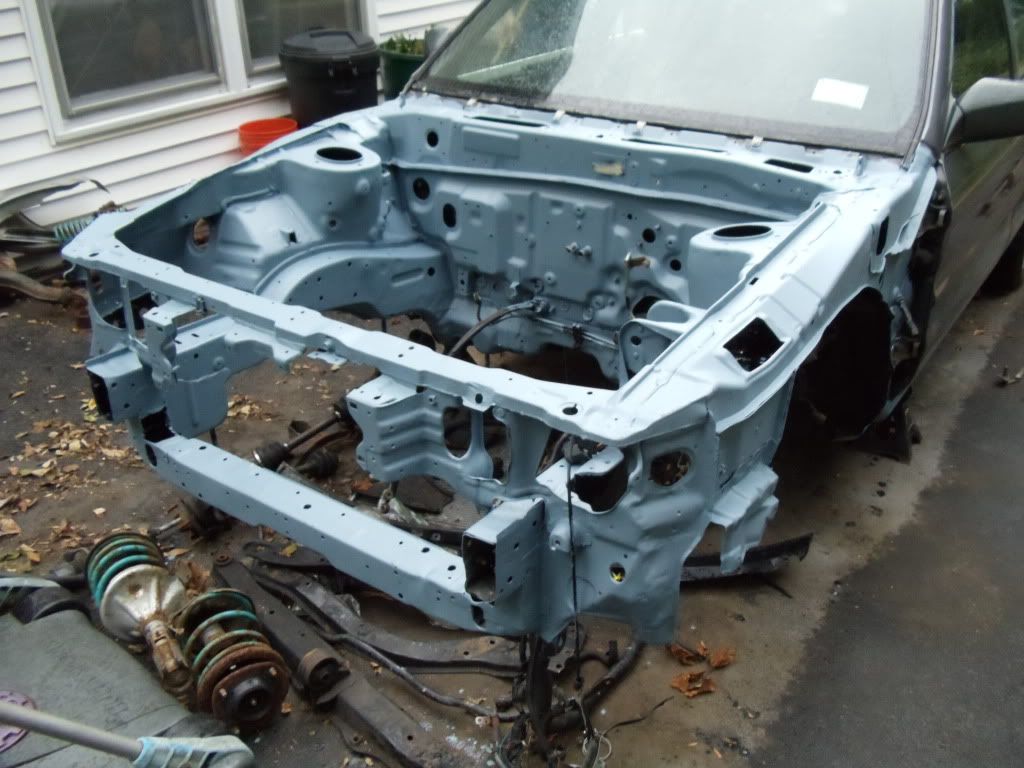

So I haven't been working on this too much, but I sanded it down to bare metal most places in the bay, and under the fenders, and on the rockers. I POR-15'd the whole thing with 3 coats, and then threw some tie coat primer on there. I'm quite pleased with how it turned out, but unfortunately in my haste I didn't get any pictures of the prep or of the progress. One more coat of primer, and then it should be painted some time this month. I also POR-15'd and used chassis coat black on the front subframe after taking it to bare metal once again, and it looks great, but no pictures.

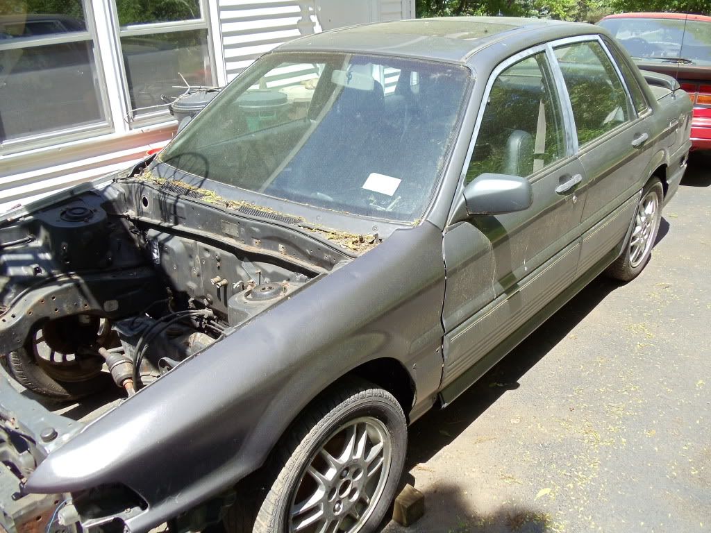

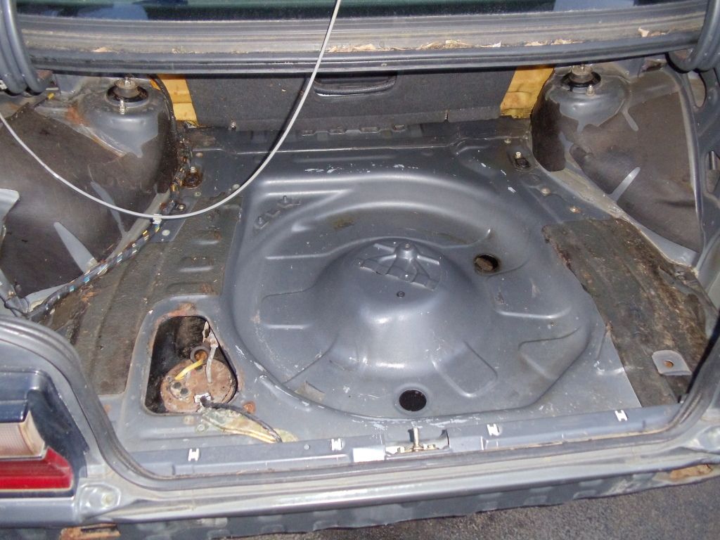

It has been a while. With spring coming around, I decided to start in on this again. The past two winters, mice have been using this thing like a toilet. Hopefully I can save the seats and dash. The trim is all fine luckily. The carpet was toast to begin with so that's no big loss. I'm actually considering buying factory carpet if it's still available. It's about $300 which is a lot, but it actually seems very reasonable for brand new factory carpet. I also found cheap indoor storage for next winter right down the street. I ended up just hosing out the trunk, and it was insanely disgusting. The water pooled a little bit and it was so disgustingly brown. I've never seen anything like it. Here is how it sits now:

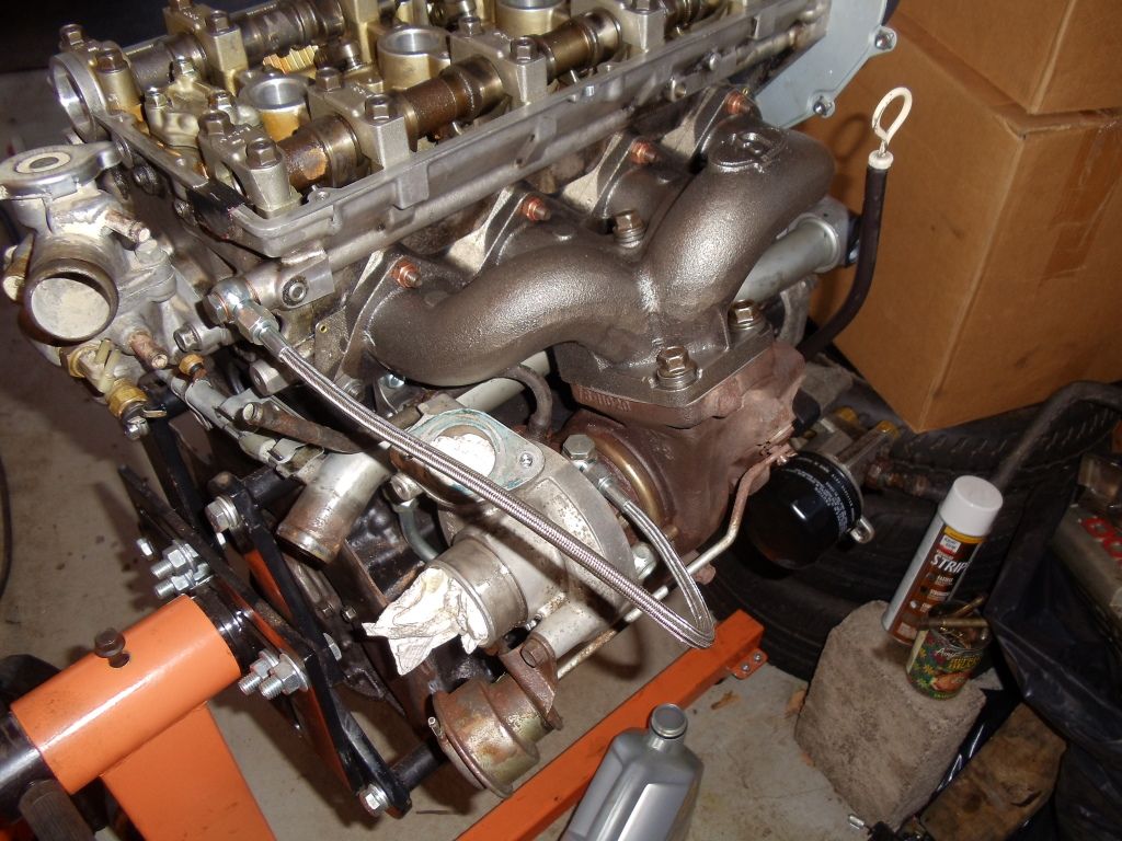

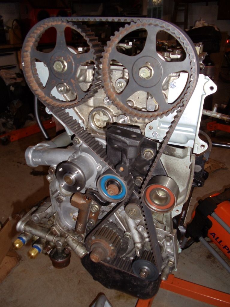

I also started in on the motor again. I installed the timing belt, exhaust manifold and turbo. There's nothing stopping me from putting the intake manifold on but I actually don't have enough room in the garage to do it. I just got my tax return so pretty soon I will get the last stuff I need to finish the motor, along with the alternator relocation bracket.
