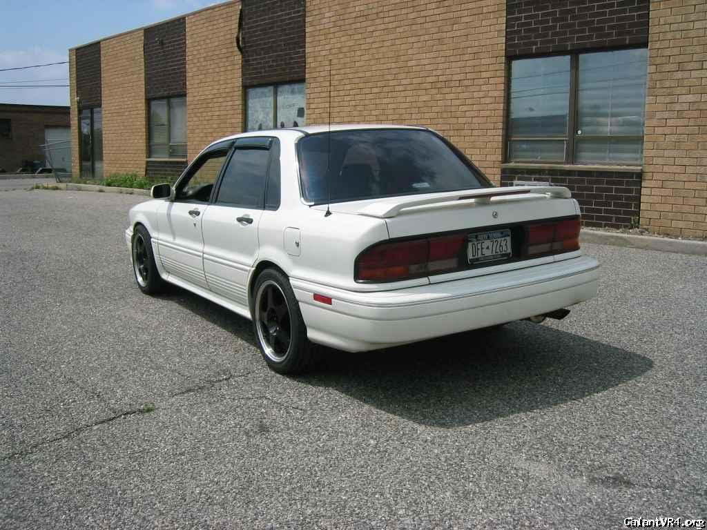

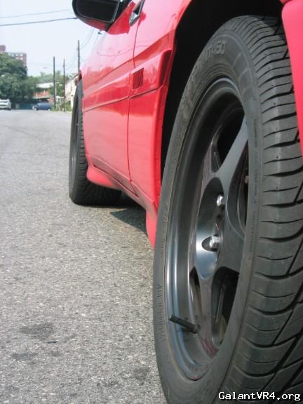

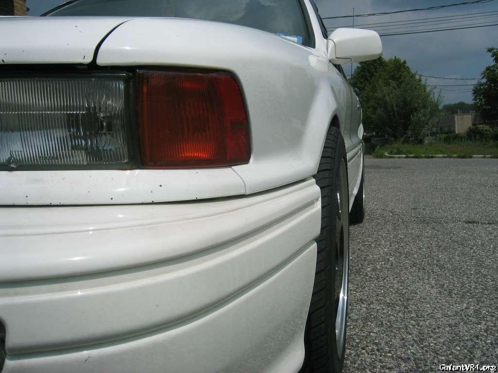

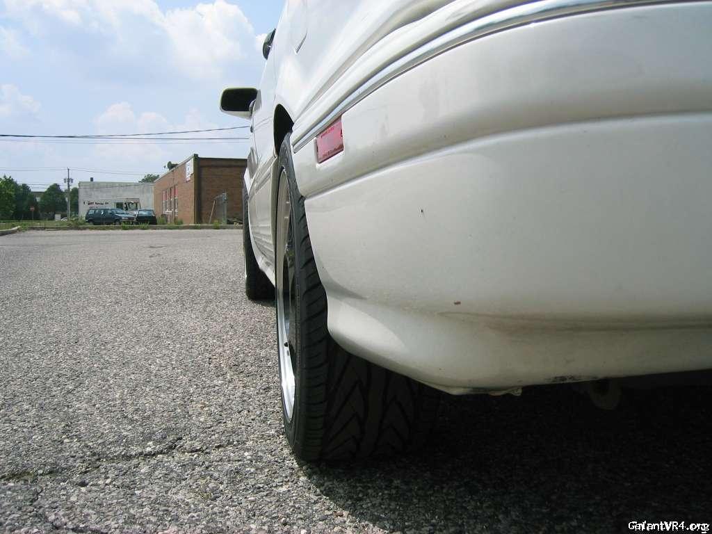

Here are some pics of my car when I had 17x8 35mm offset rims with 245/40-17 tires:
You want 38 to 45 mm with an 8-inch rim width. The 35 mm is fine for clearance on the back side but it will stick out slightly.

yea ive notice how it is sticking out a bit in the front.... but not too bad though.... it looks clean.... anyways does it rub on the front when you go thru big bumps or not????

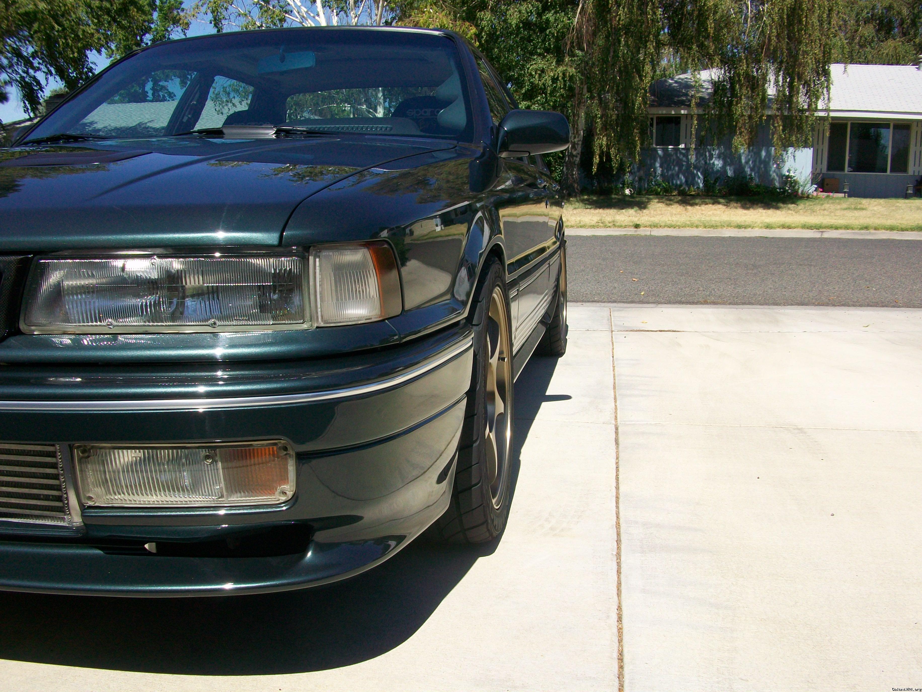

If you camber in the front they won't stick out at all. Click the link in my sig to see what my 17x8's look like. I run negative 2.3 degrees camber p front.
I'd post pics directly, but I'm on my phone which makes that a pain in the ass.

My setup never rubbed however I was running HotBits coilovers which are considerably stiffer than the stock vr4 suspension. But even driving through the pot hole infested NYC it never rubbed.
At the time I was running about -.5* of camber. I'm sure with -2* or more it would of tucked in nicely just like Turbowop's car.
11,981
Some of the pics in my member's ride section are with less camber and dont' tuck completely. I added more camber a few weeks ago.
Here is a better shot of the current front camber:
