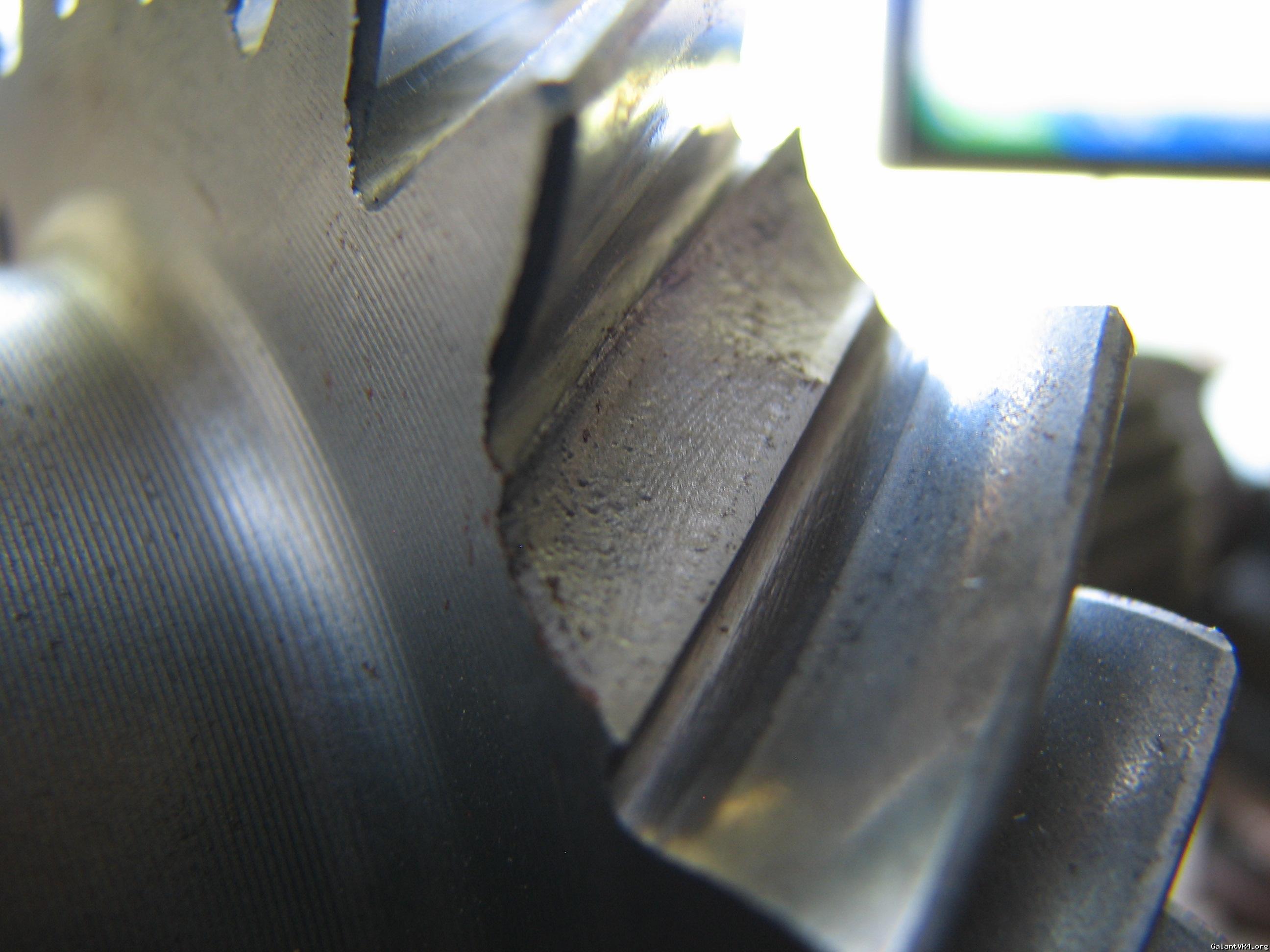

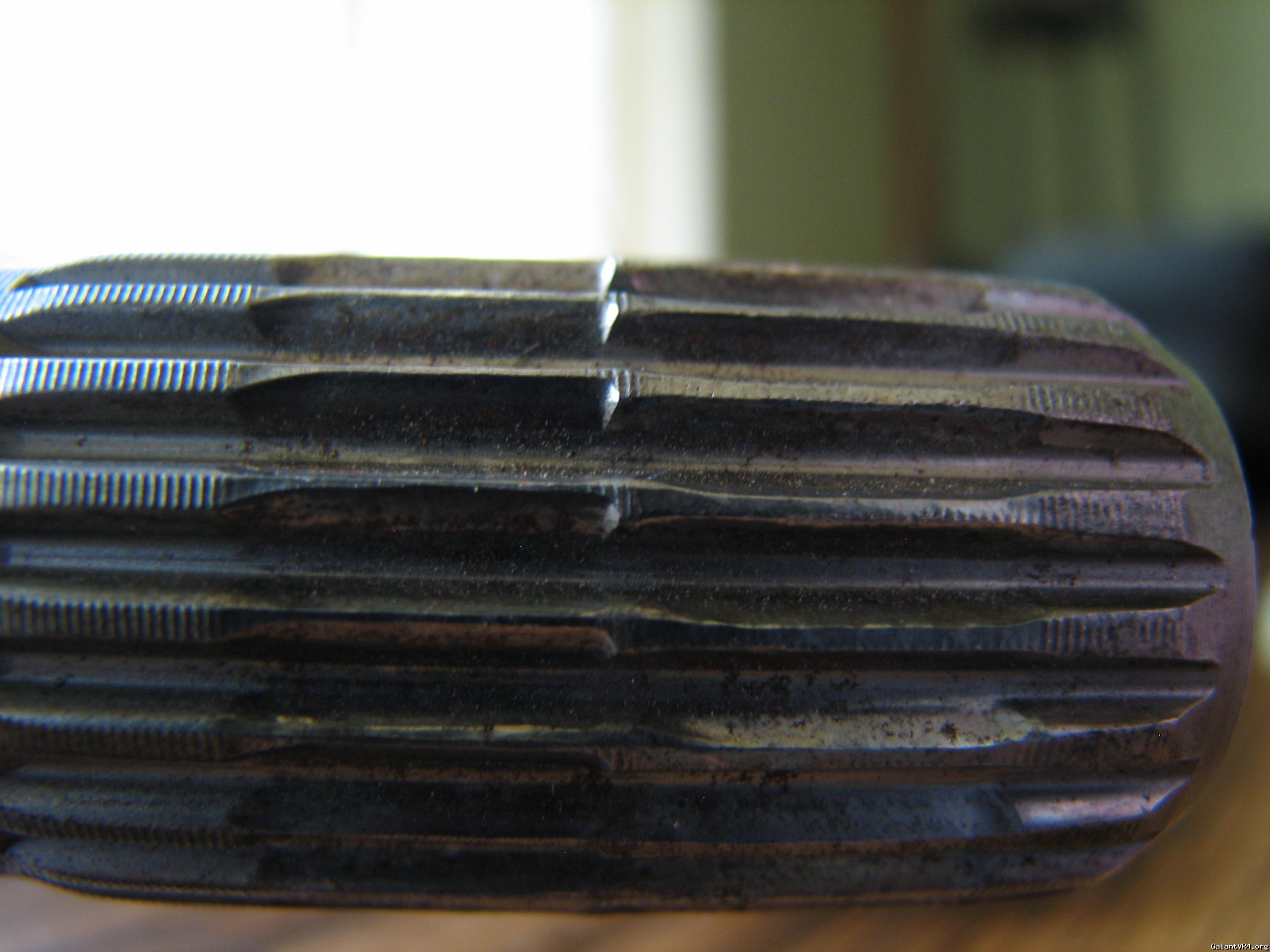

By the time you bought the trans had it built and custom fabbed up all the parts to fit it in, you could buy a dog box. good idea though. The only gear we ever really have had troubles with is 4th
My input shaft.
My intermediate shaft.
I also pushed my front diff out of the case, and a couple other serious things.
Im making good power but this is a full evo III gear box so it has all of the highest upgraded parts in it already. There are allot more parts than the fouth gear thats the weak point. Its the whole box.

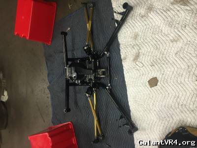

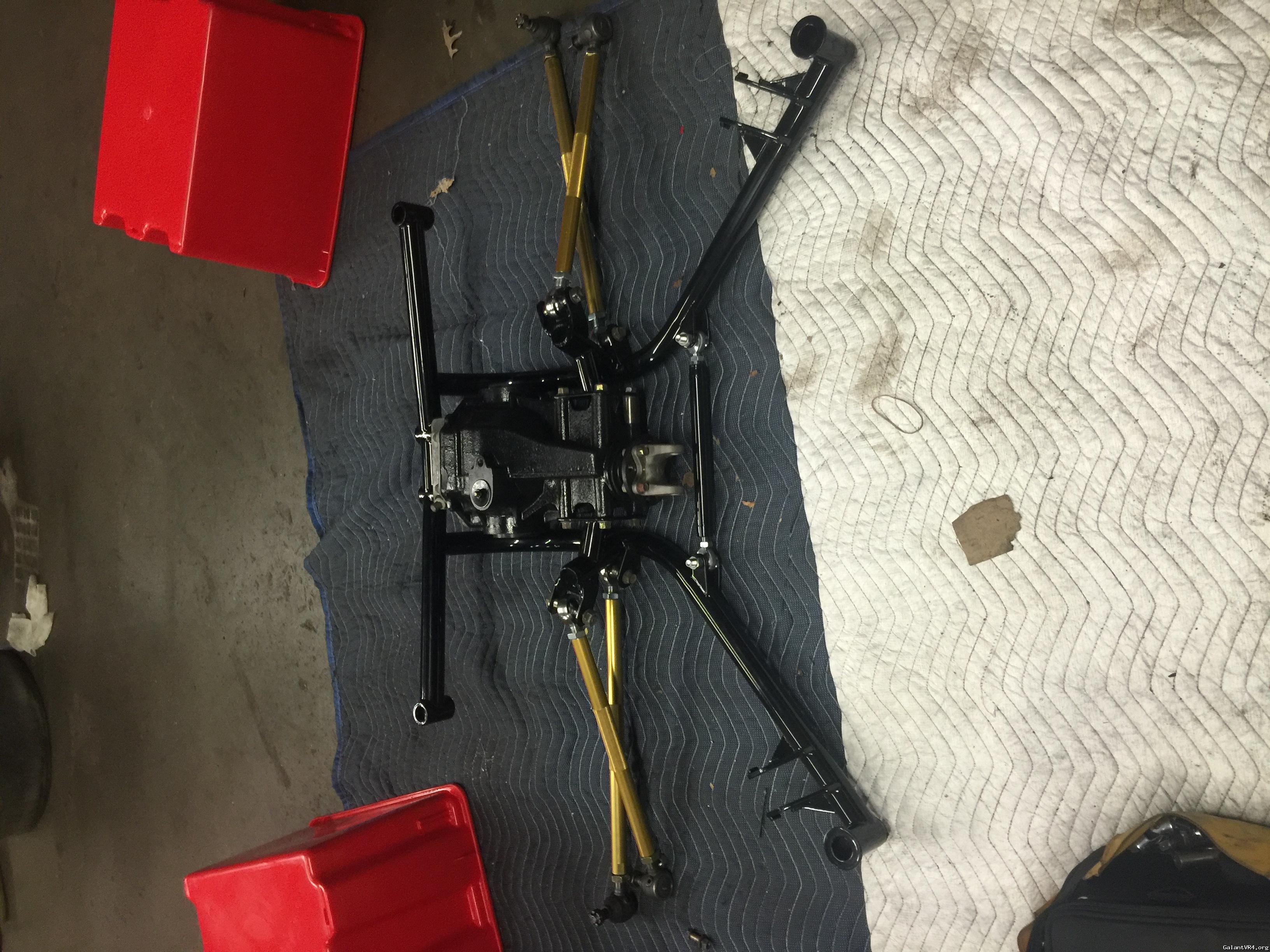

Just to update this we do have a subframe with a 3000gt rear ready to install into 431 . I received the upgraded axles from DSS today ! Picture is without the axles. Hopefully I will get on this swap in the next few weeks ... Need to get back to the track after a long layoff due to priorities revolving around family !
