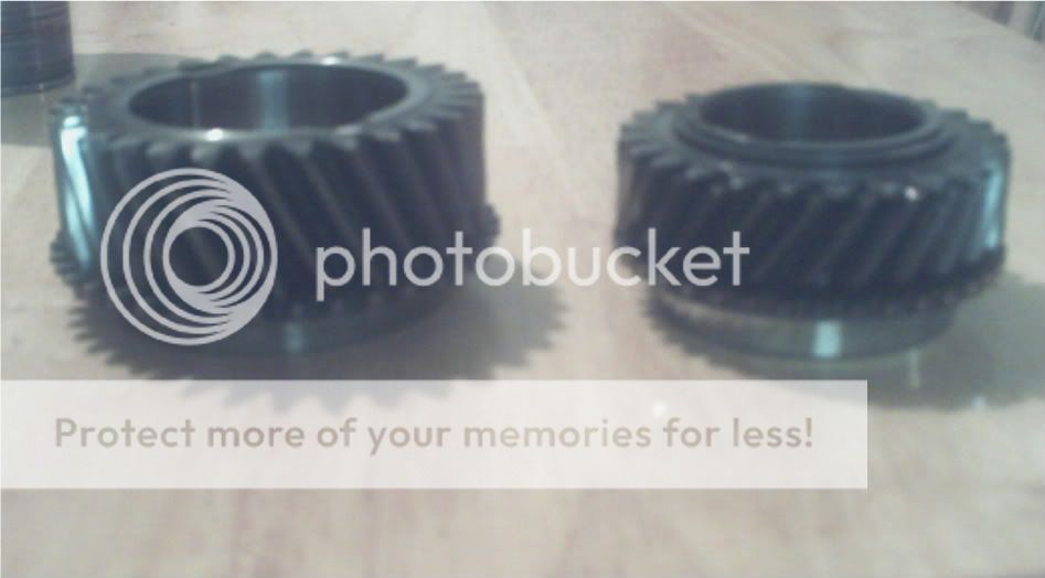

What would really solve some more pressing issues would be getting the 3000gt getrag trans into a gvr4/dsm. I'm really thinking about having a bellhousing fabbed to bolt the w5mg1 to a 4g63. Here is a comparison of a 3000gt 3rd gear to a gvr4/dsm 3rd.

^ /ubbthreads/images/graemlins/worthy.gif I want that 3rd gear

2 good things about that 3rd gear. 1, i have never seen one break, even with 1,300 wtq. 2, the ratio of it allows 120+ mph. My stealth tt ran 45 in first, 80 in second, 125 in third, 165 in fourth, and buried a 180 mph speedo way before redline in fifth. With a 7300 rpm limiter.
