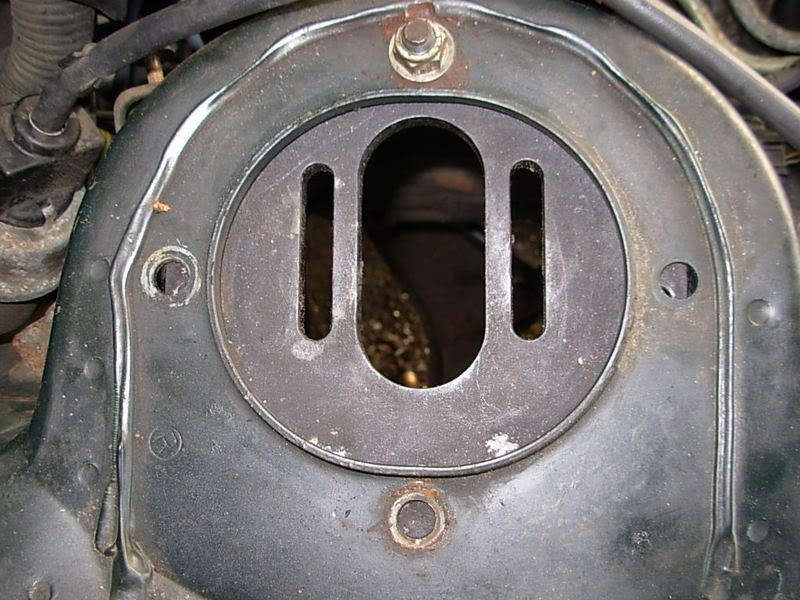

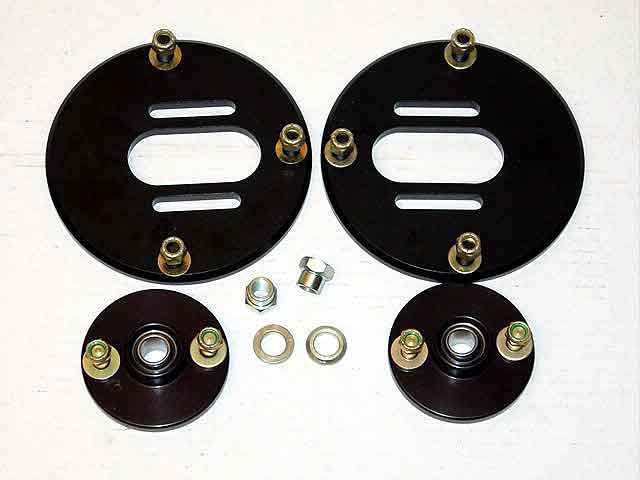

That's strange. I remember I wasn't able to use my RRE 1G camber plates because the bolt pattern is different from a 1G to a Gaylant. 1G = 3 bolts at 12,4,8 O'clock and Galant = 4 bolts at 12,3,6,9 o'clock.
Pics!
This is with one of the holes lined up, you can see the other 2 are off a bit.
From RRE's website.
I guess the 1G bolts aren't 12,4,8 o'clock per se but they are definitely offset a little from being a straight 12,3,9 (in reference to my picture)

The bolt pattern between DSM and vr4 is ALMOST identical, except the vr4 bolt pattern is about an elongated hole (you can see this in your first picture above, notice the flat sections on the top and bottom of the pic) and the DSM is simply a circle.

CutlassJim is right. I wasn't able to use my full bracketed 1g strut tower brace for the same reason.

Hmm, I'm really confused then. I remember the front and rear bolts on a vr4 being like 1/4" further apart...
11,003
I thought about this some more after my post. I think the rotation orientation may be different. I will have to look at it when I get home.
I agree the camber plates are not interchangeable, at least to retain adjustment. /ubbthreads/images/graemlins/wink.gif
