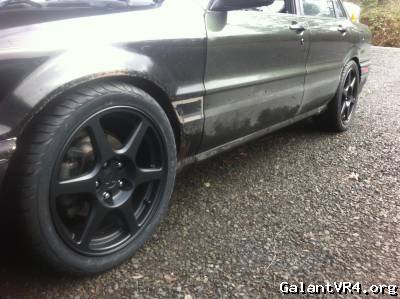

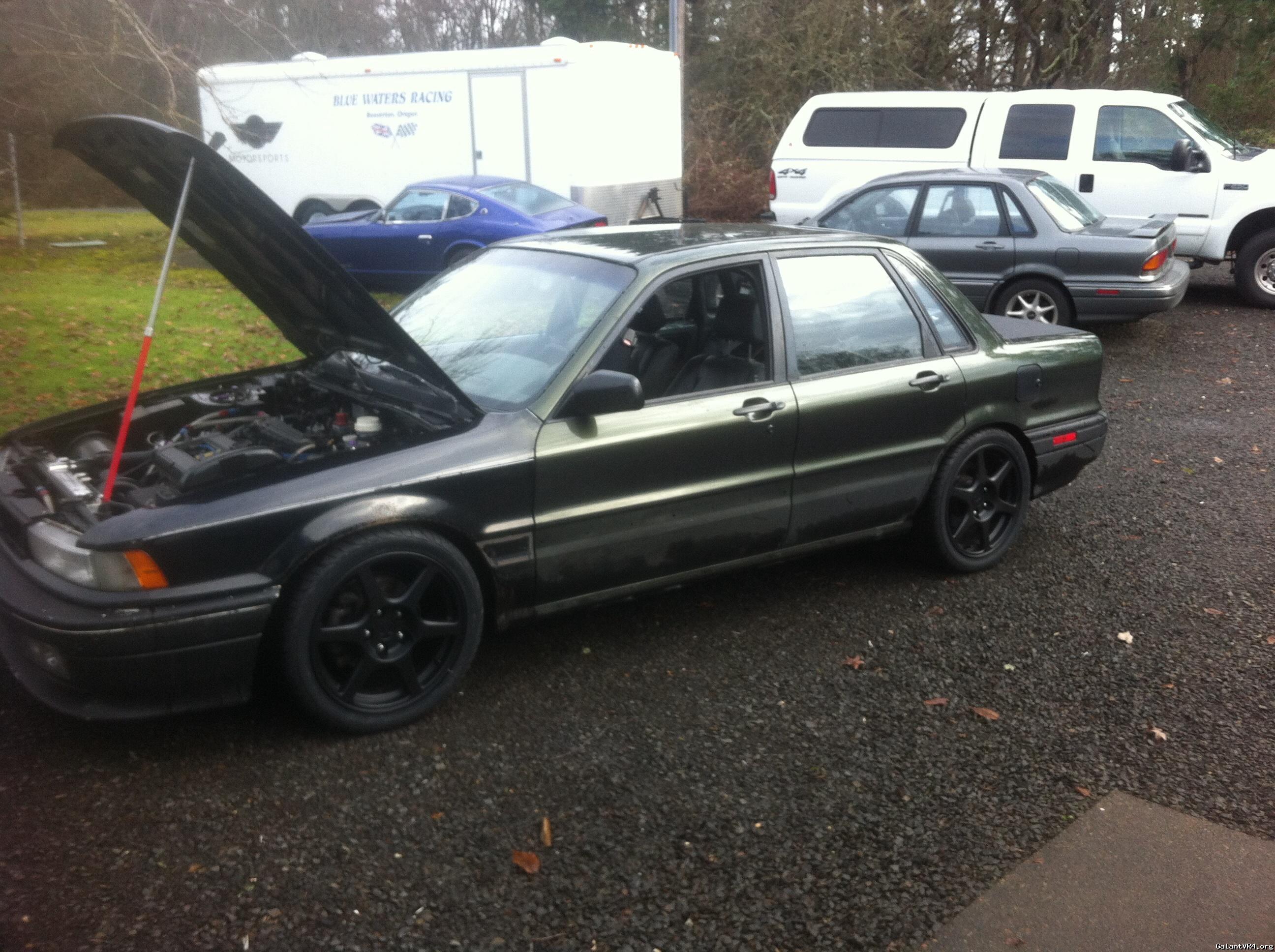

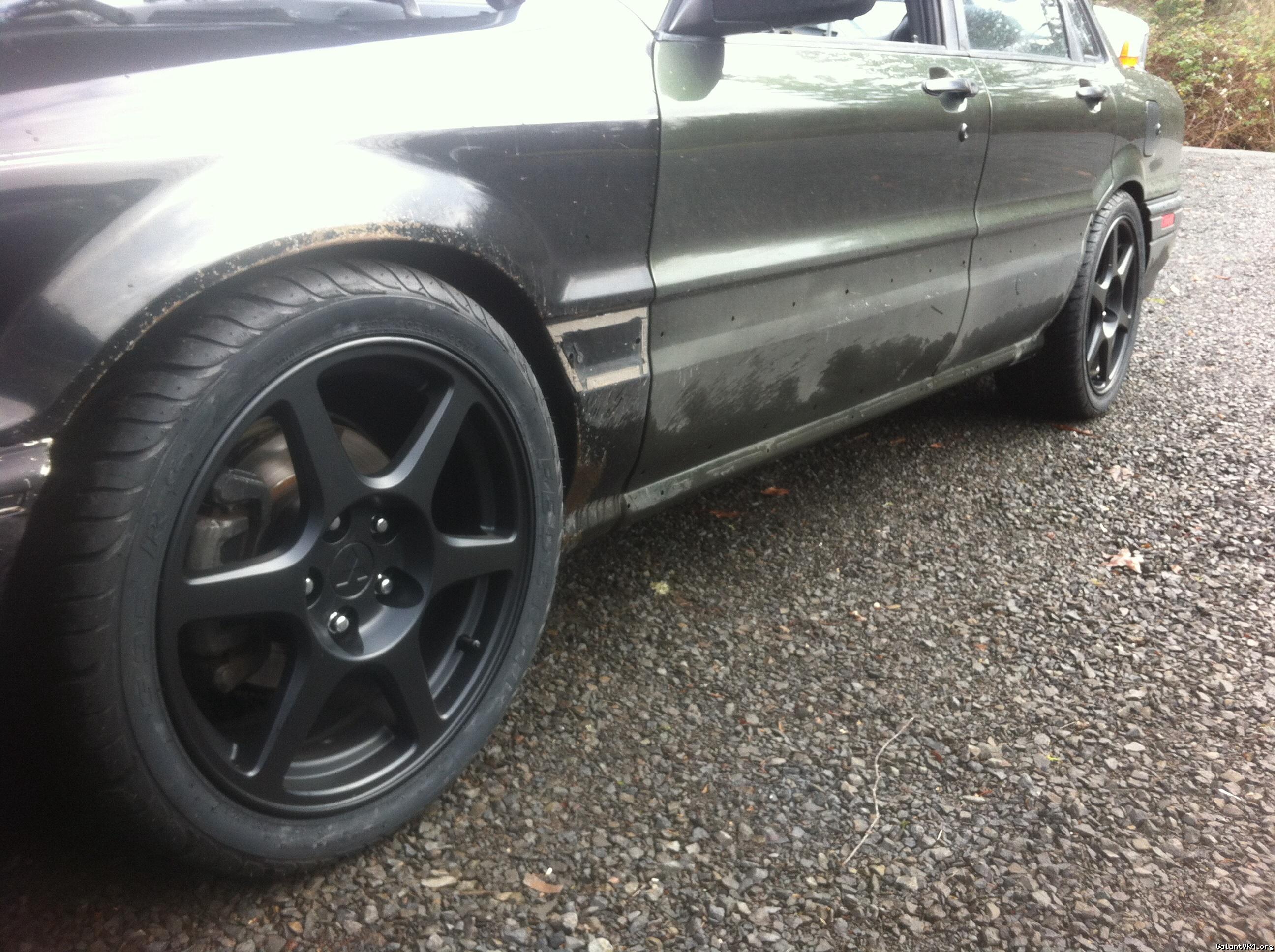

Is it just the angle of the photo or are your sidewalls bowed in slightly because of the wider width of those tires to fit on those wheels? Would you recommend getting those 235s or go smaller to a 225? I think 245s are out of the question for those tires on an Evo 8 wheel.
It seems like the 225s only come in a 45 series sidewall. /ubbthreads/images/graemlins/dunno.gif

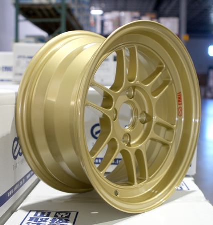

Wheels look great Evan! I was always a big fan of the Evo 8 wheels on the GVR4. I gotta agree with Wop though, a set of gold wheels would really compliment that dark green. I know shitting out money for whatever wheels you want is something we all wish for, but gold RPF1s on that thing or bust!

I wonder what Evo 8 wheels would look like in bronze or gold.

I've had gold wheels on most of my old cars and wanted to change it up a bit. I had gold rota grids on my white 89 civic SI HB, gold wheels on my Levin converted AE86. As far as the tire. The sidewall does slightly come in but not that bad. I wouldn't put 245's on as that is overkill. The 225 45 will roughly be the same thickness as a 235/40 so it wouldn't be to bad.

Looks really good, Evan!
I will likely 235s since the 225s are only 4 dollars cheaper per tire if you don't mind me totally copying your setup. /ubbthreads/images/graemlins/grin.gif Might as well pick up that extra footprint for the minimal extra cost. That really is a super deal, the best I've seen in a long time. My car is hardly driven so it wouldn't see much tire wear over time.
Your car would look great with black hood, trunk, roof perhaps? The rest that green. You almost already have that theme going, ever considered it?

I have thought about the black hood and trunk but since I just spent 20 plus hrs trying to straighten the roof and painting it. I will probably keep it green.

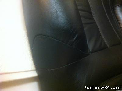

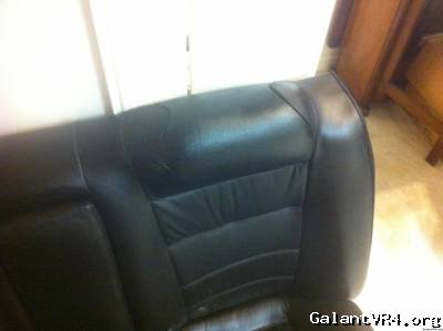

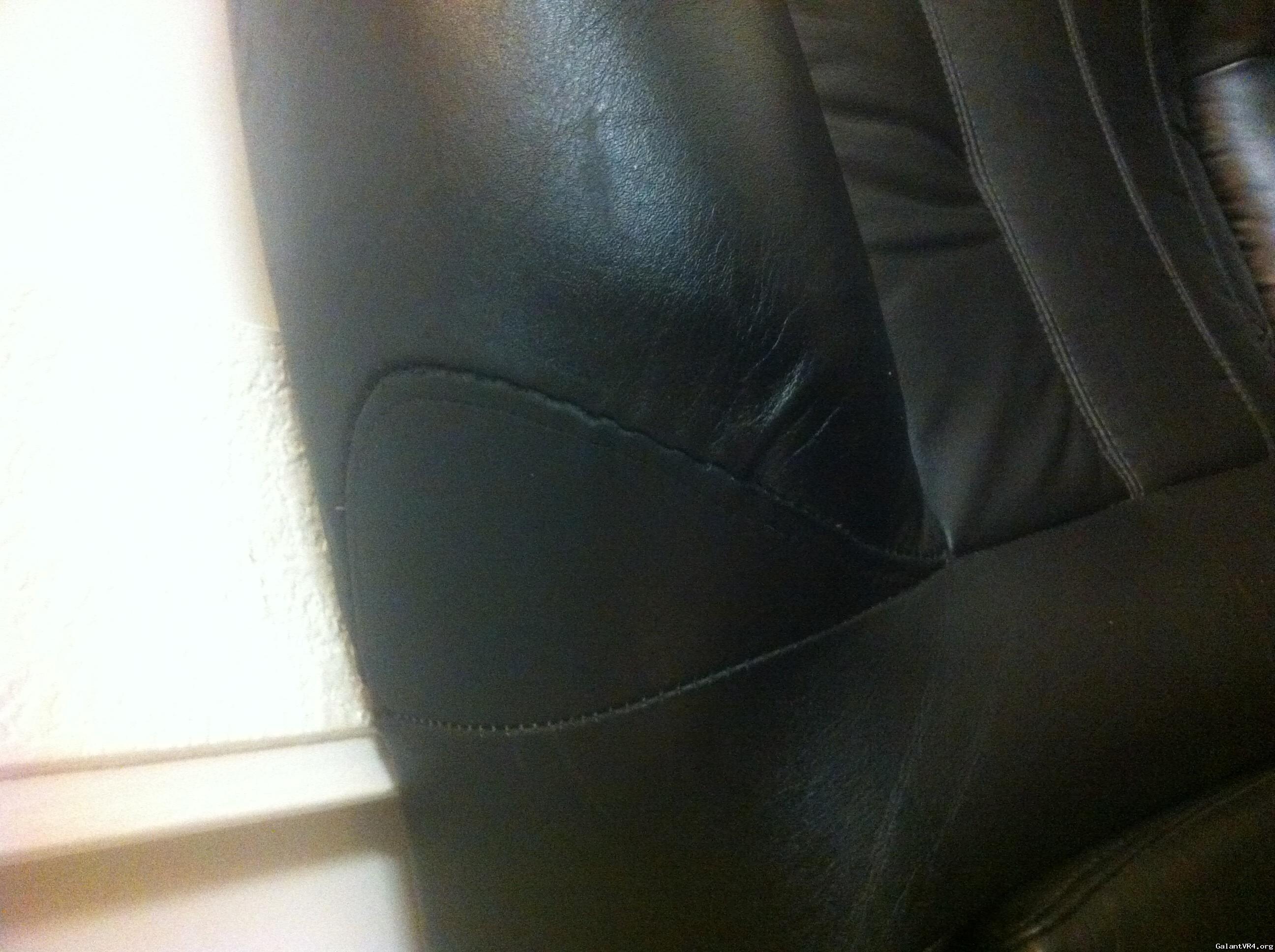

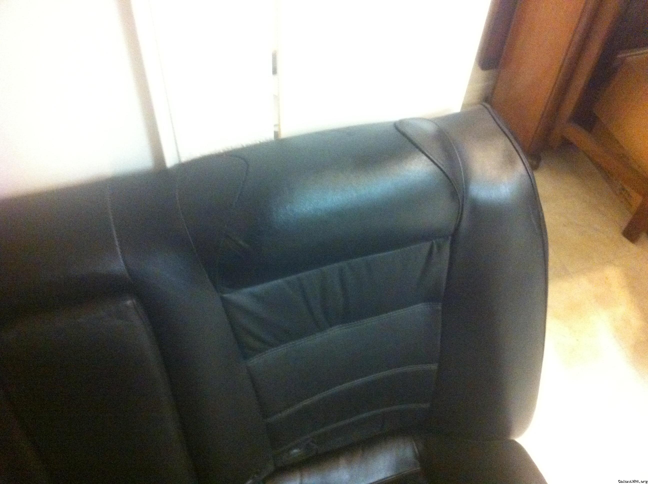

Had a night of sewing the back seat back together. Sadly I forgot to take before pics. Figured I can't buy the EVO seats I want just yet but I can at least make the back seat look less trash.

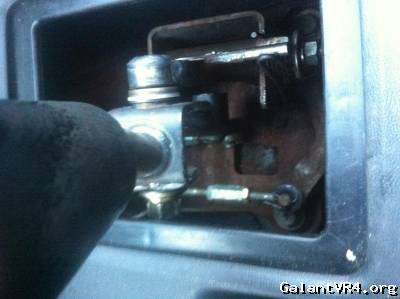

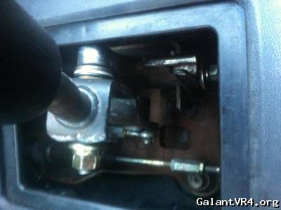

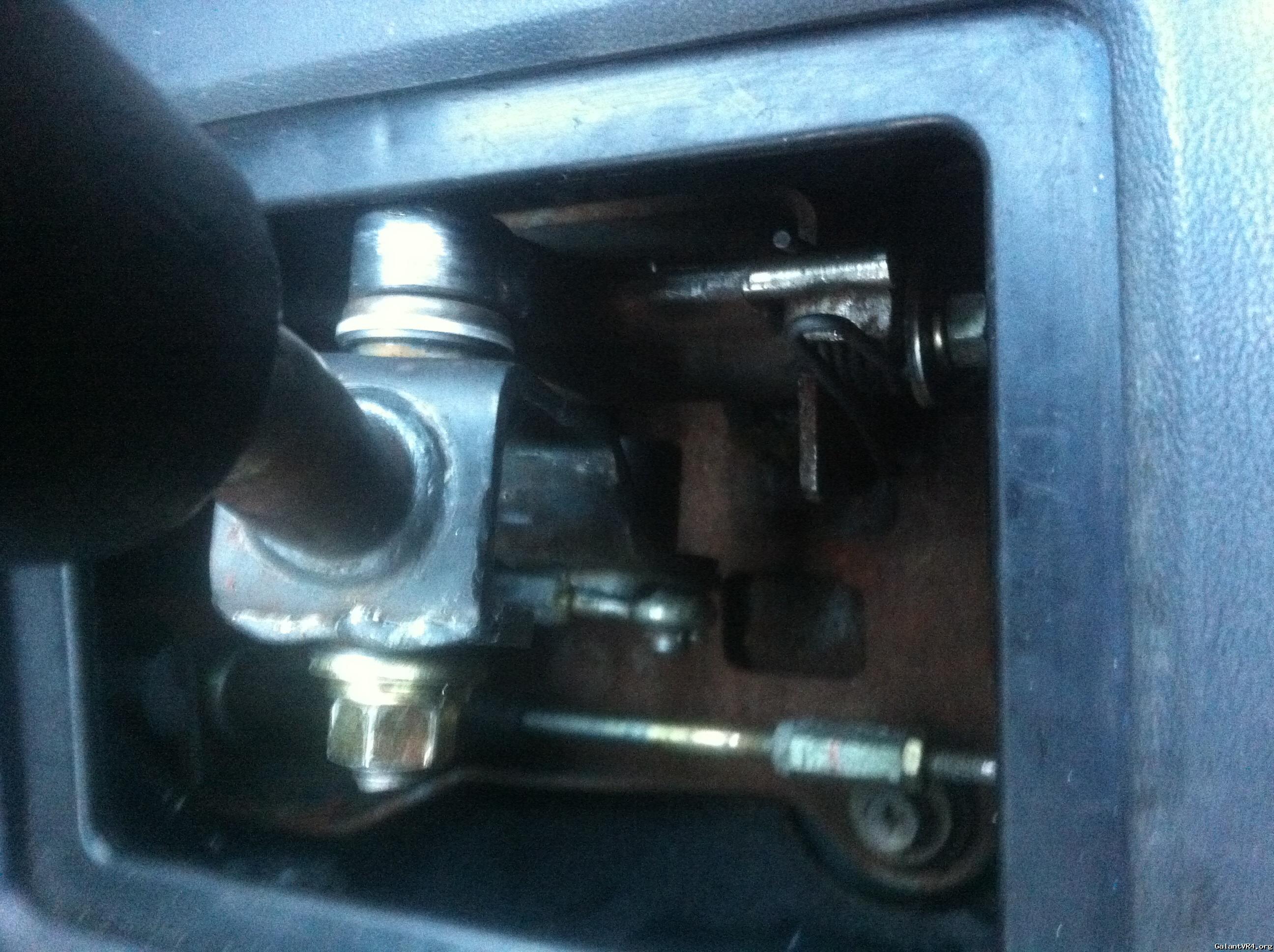

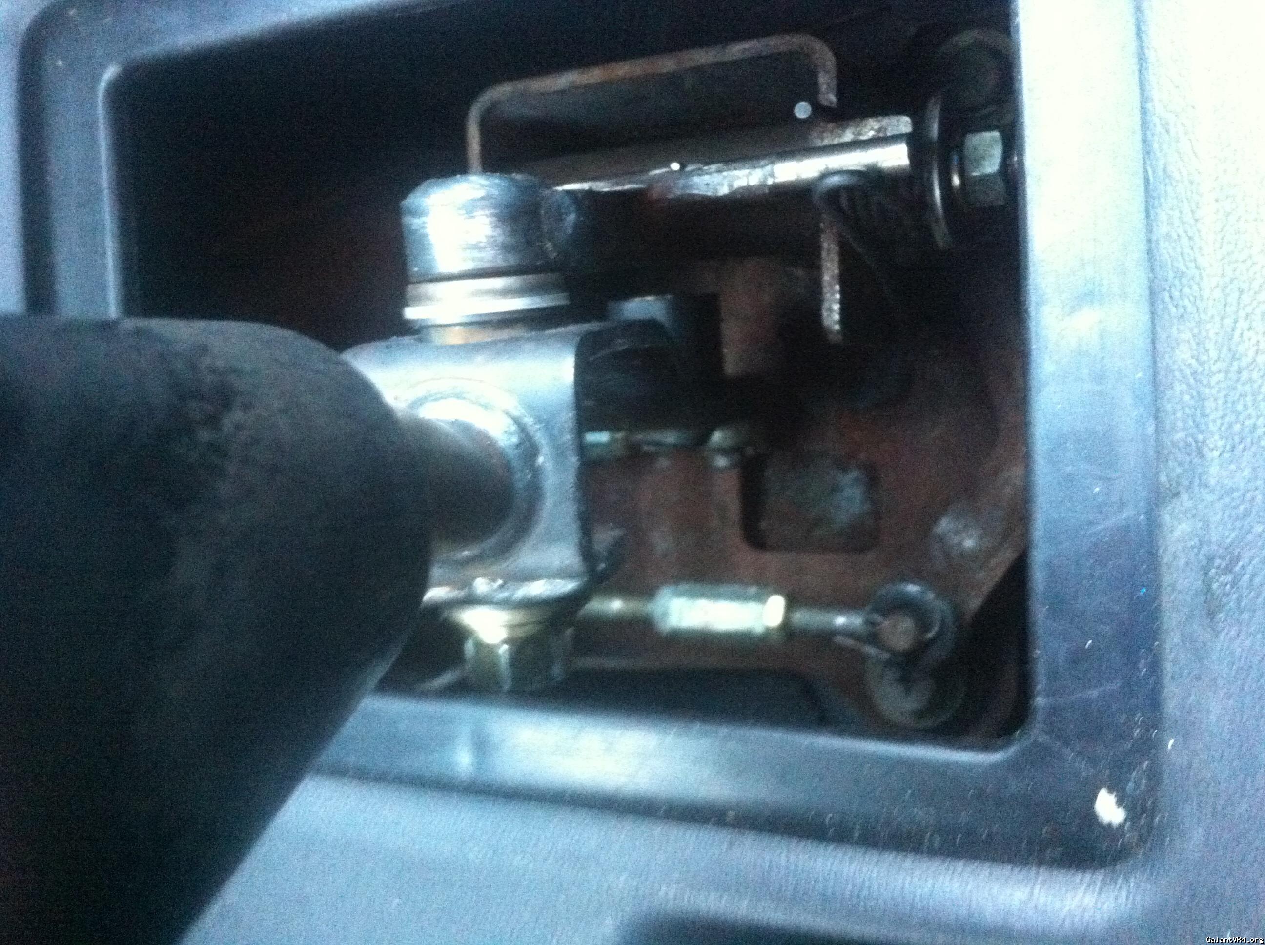

Decided to make my own short shifter. It clears the console by about 1/16-1/8" so no trimming required. Feels very close to as short as the 3kg shifter.

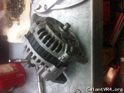

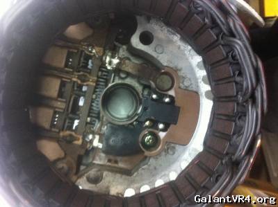

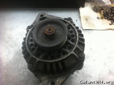

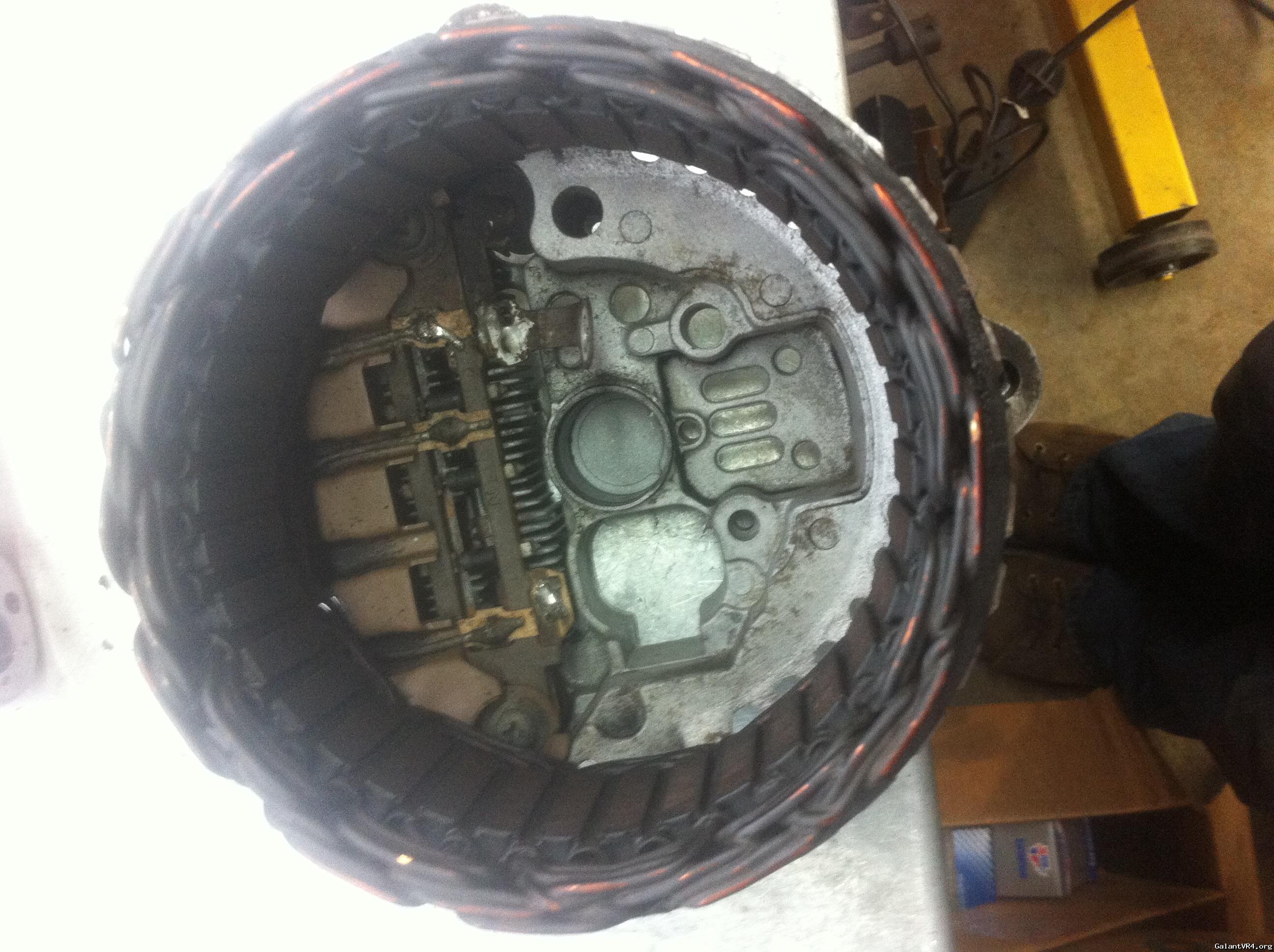

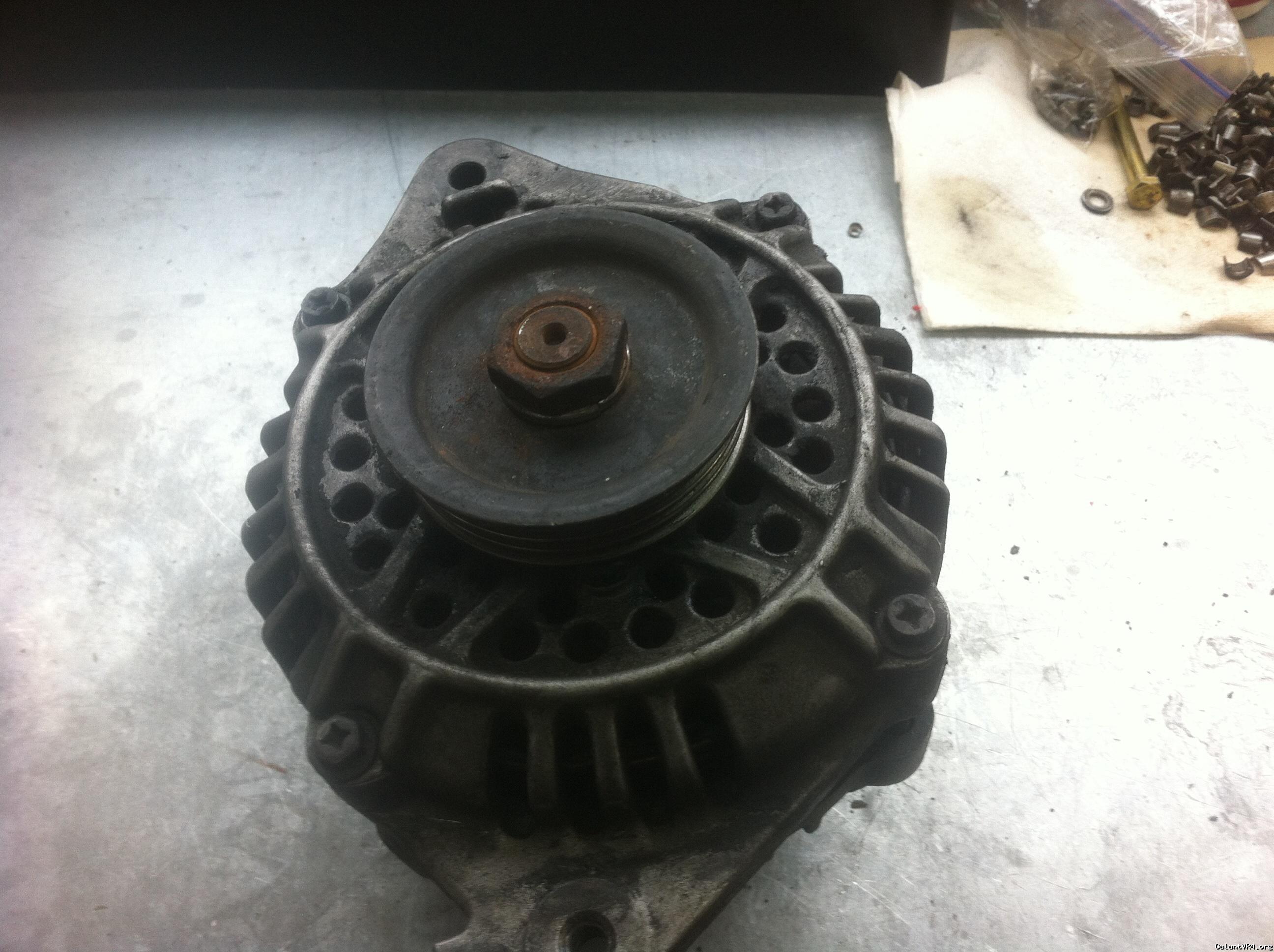

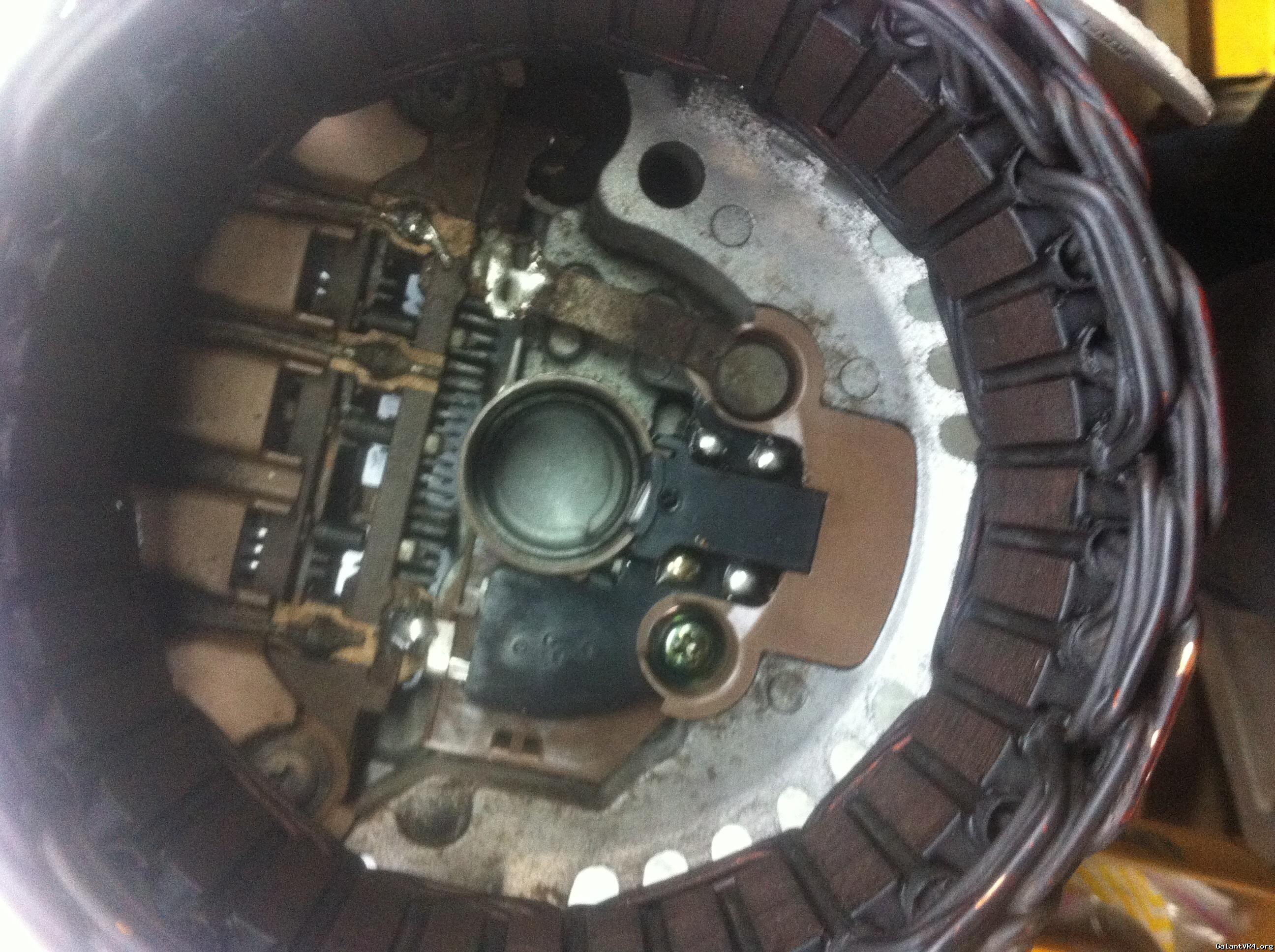

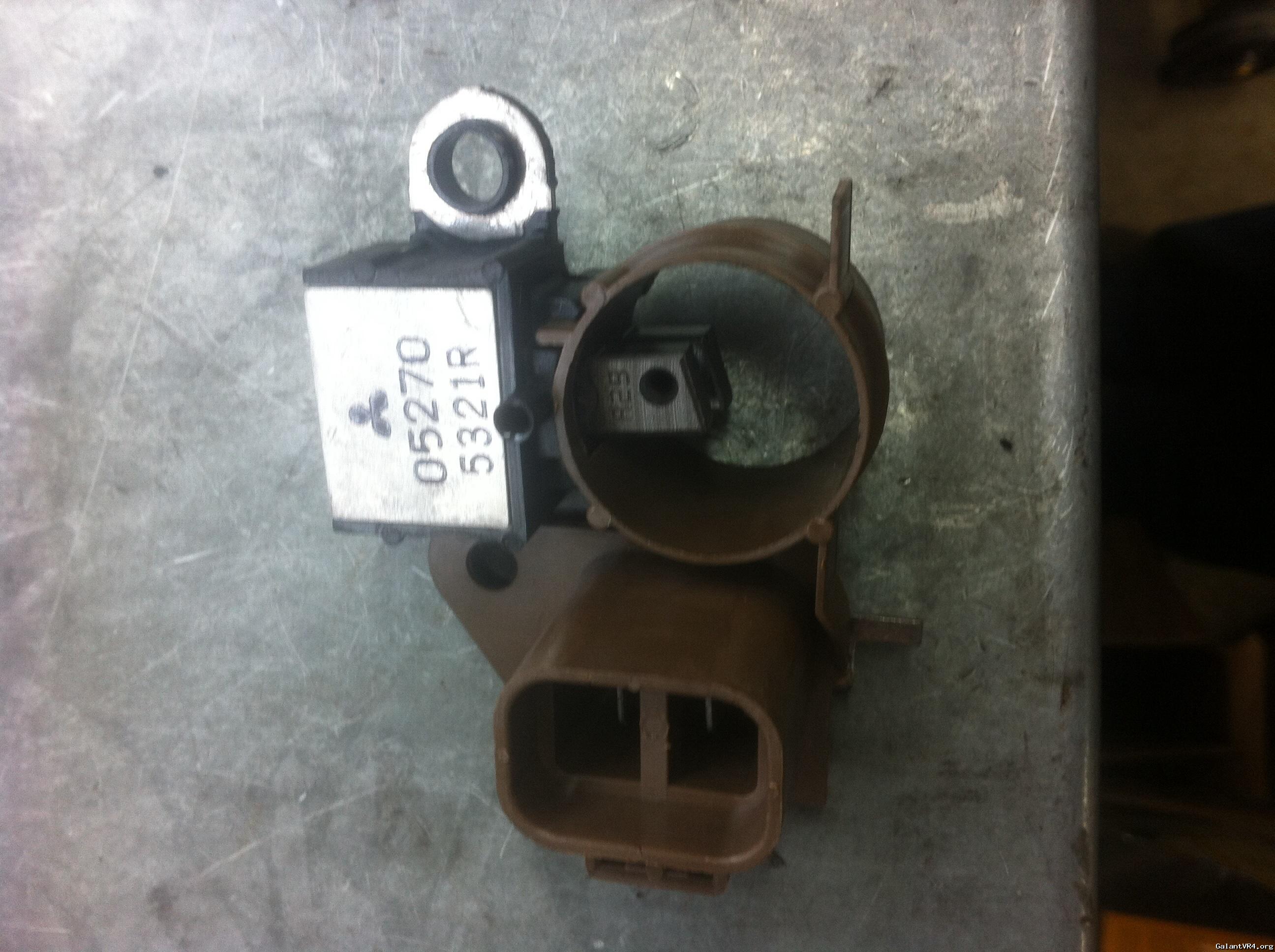

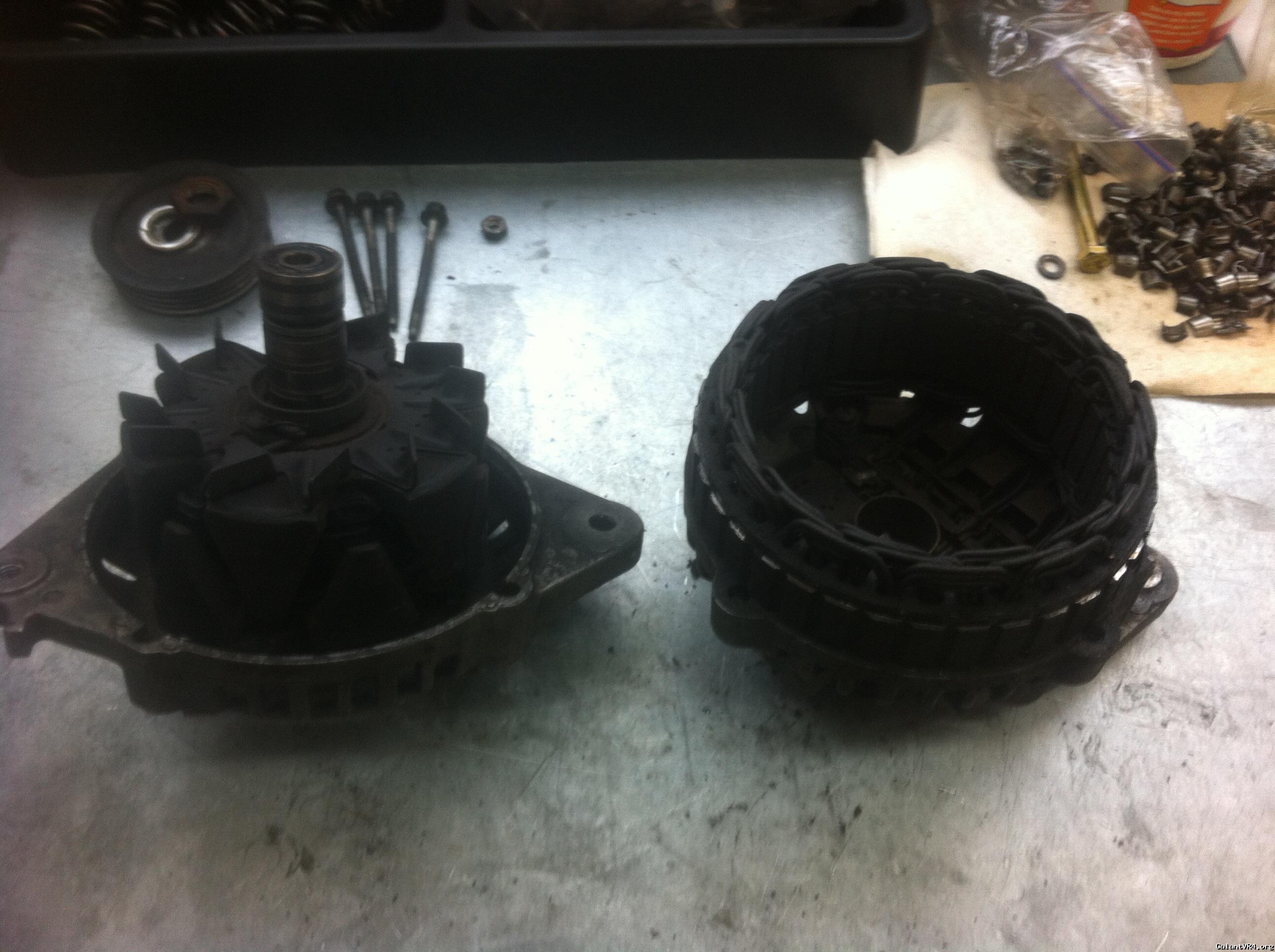

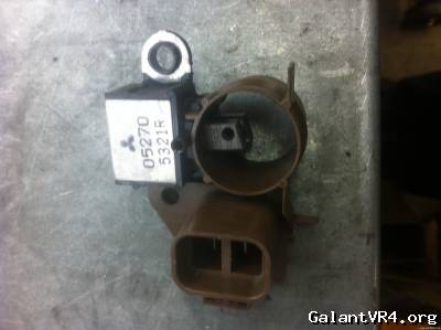

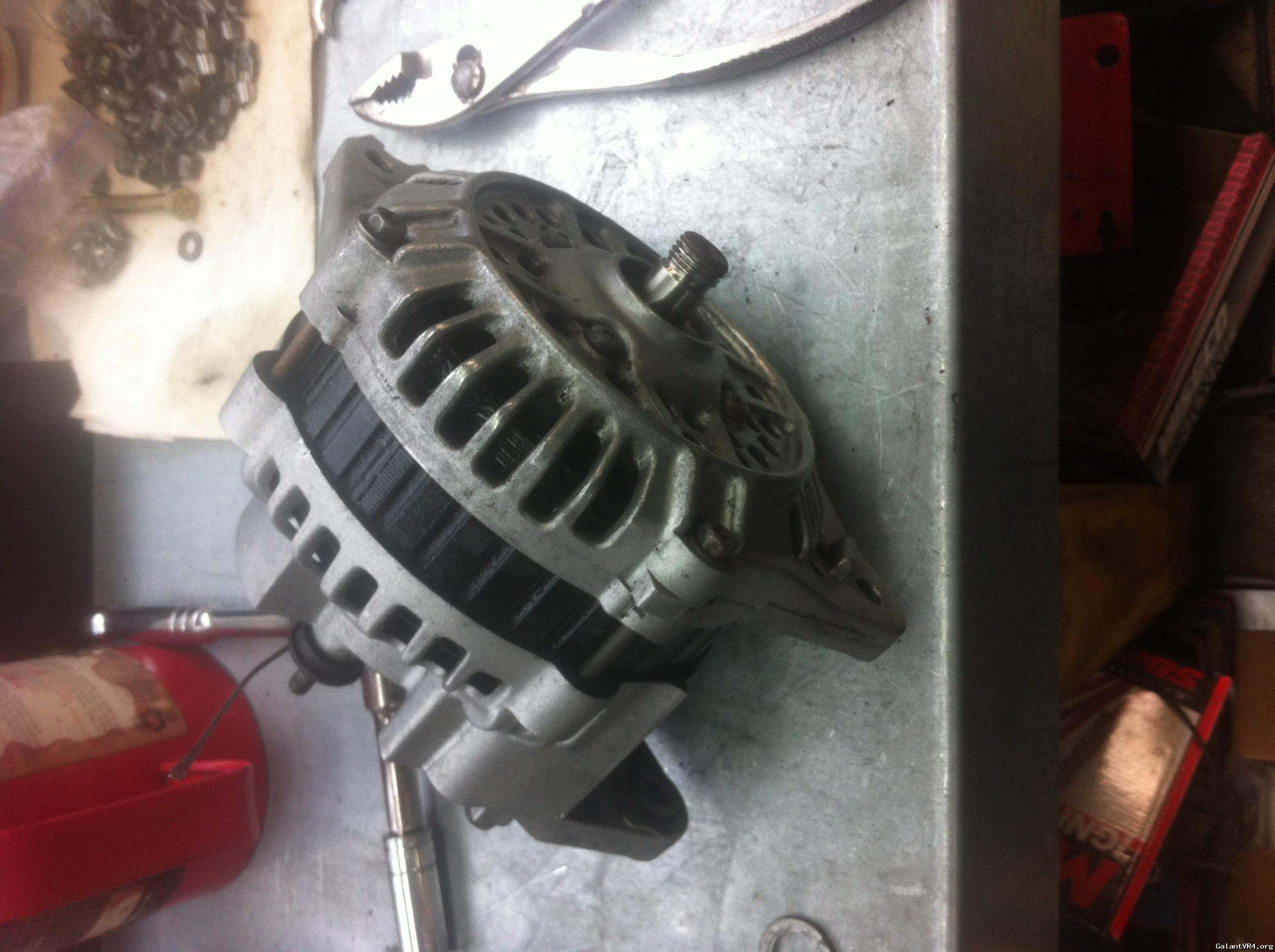

Had some time to tinker with the galant this week and found that my alternator isn't quite putting out the voltage needed. Tested at 13.6v at idle and 12.89v under load. I will eventually Order up a new Bosch unit. But I opted to have fun and replace the voltage regulator. Found out rock auto had a clearance sale for one at $21.50.
EHmotorsports
Sep 25, 2012
1,283
Beaverton
Testing after installing I found the voltage at idle is 14.6v and under load is 14.30v
Runs much smoother and the headlights don't dim. I will update if/when it fails.

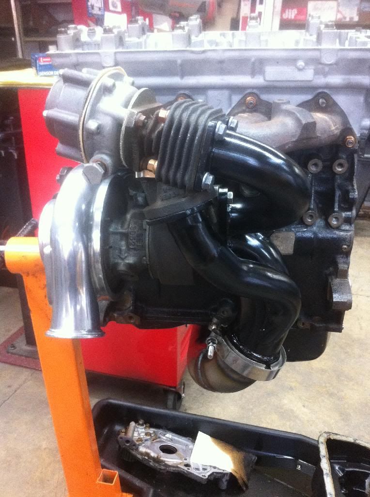

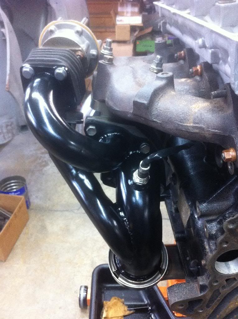

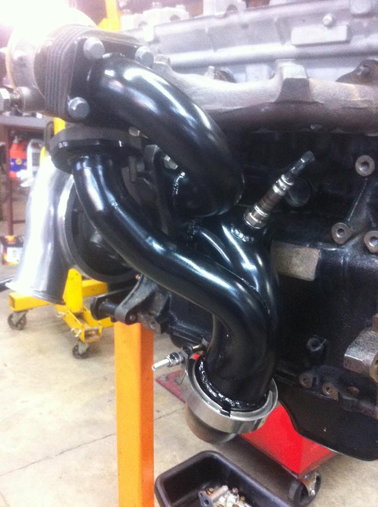

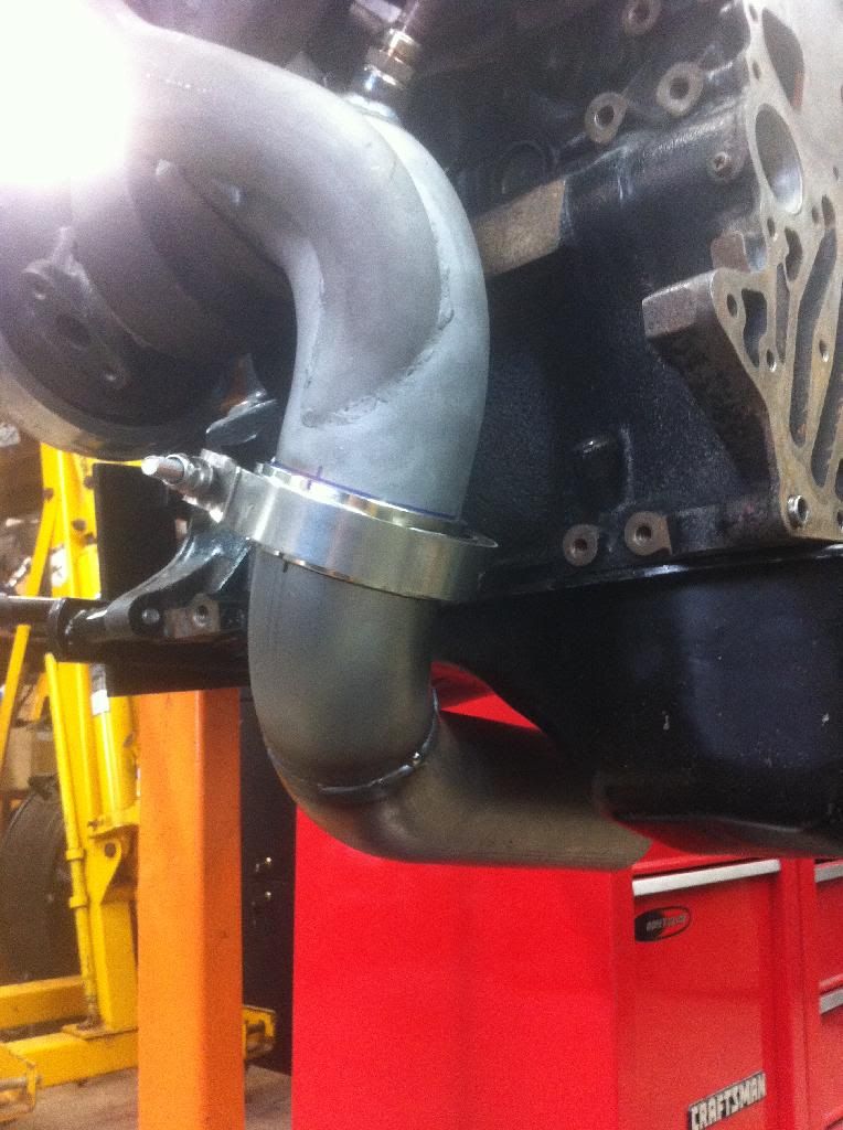

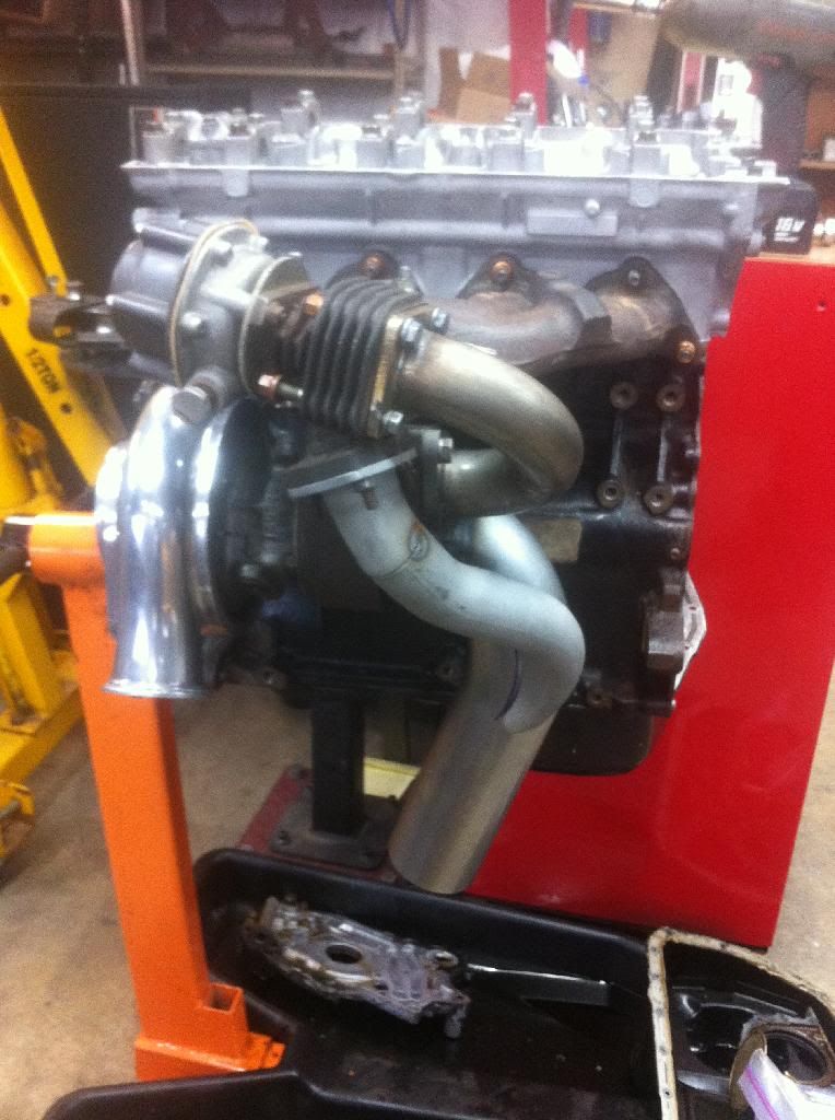

Started making the O2 housing and finding a location for the Audi wastegate. Not the easyest when the PS and alternator are in the stock location.
