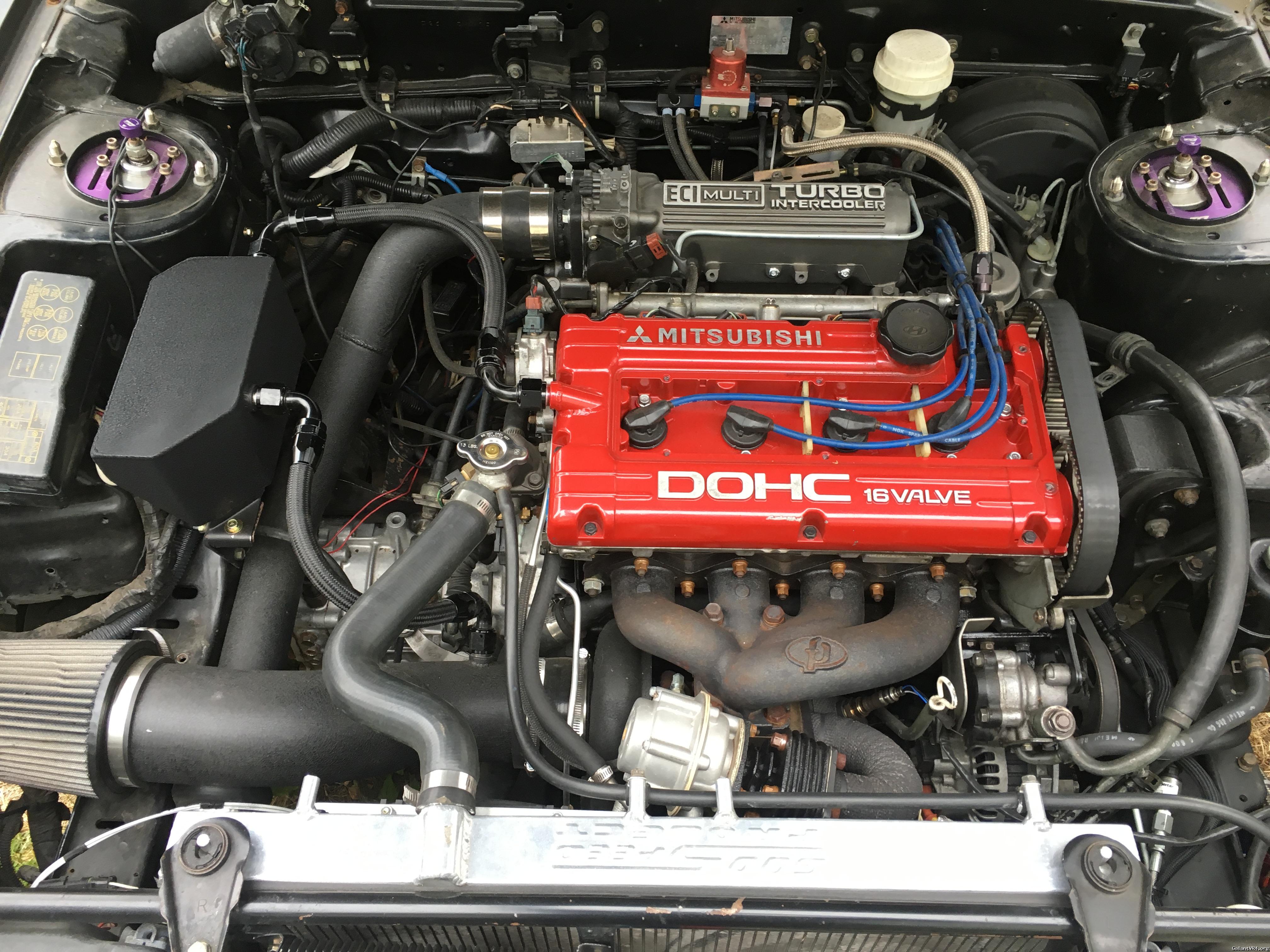

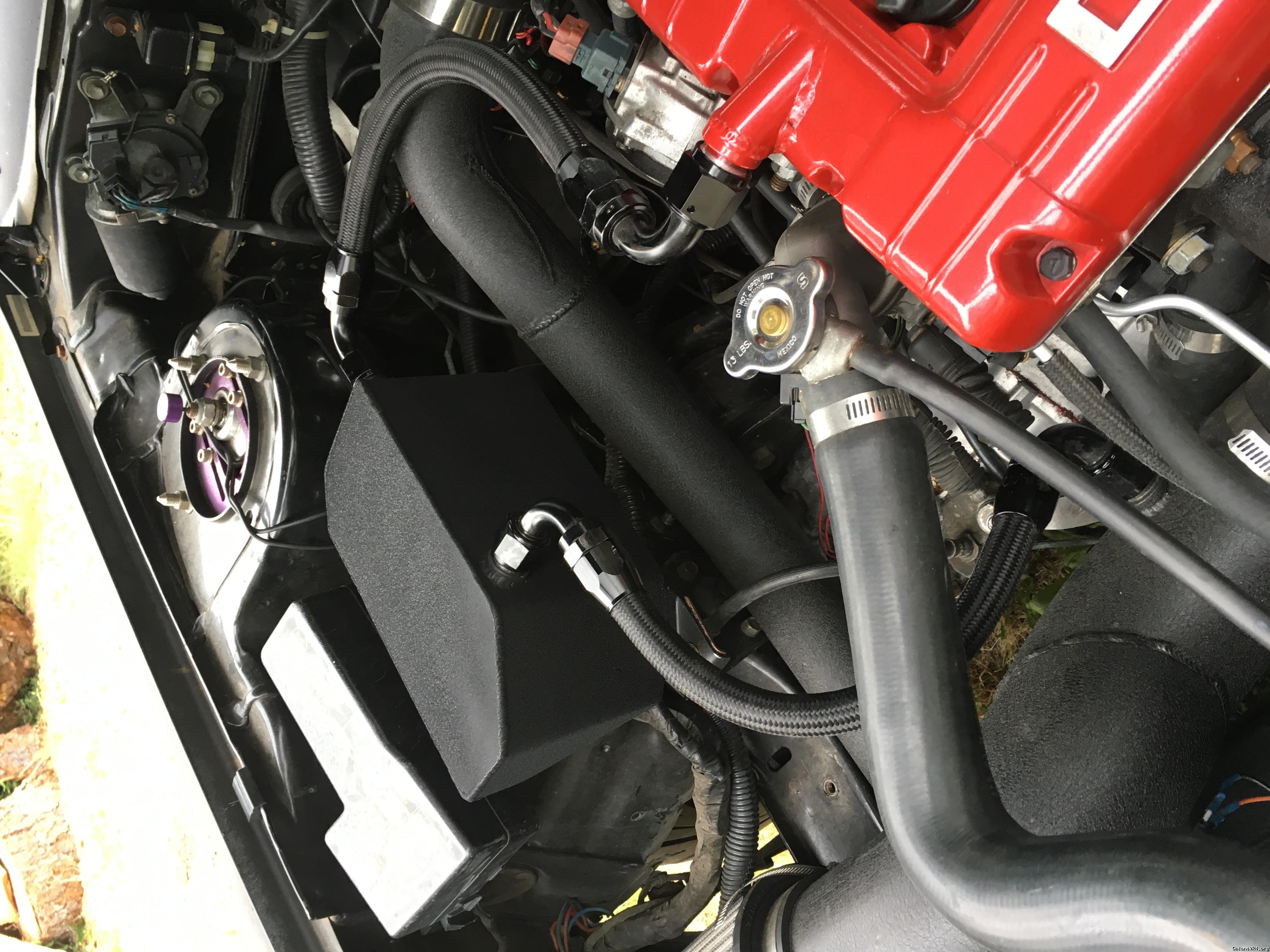

It's been a while since I have updated this build. HX35 is installed and i just finished making the catch can. Wiring and a proper air box will be the next goal.
3,479
Looks great, Evan. That catch can is legit.
Which size BEP housing are you running?
ApexHunter
Apr 25, 2007
2,010
Marysville, WA
The way the fitting on the valve cover for the vent was grafted on there looks real nice. I was wondering how this car was doing.
EHmotorsports
Sep 25, 2012
1,283
Beaverton
Quoting GSTwithPSI:
It's just the basic housing for the HX35. Nothing special but in the long run I will ether upgrade the turbo to something a lot nicer or I will use the 12cm twin scroll housing and make a proper manifold.
EHmotorsports
Sep 25, 2012
1,283
Beaverton
Quoting ApexHunter:
Thanks guys! If I had to do it all over again I might change things slightly. But I am happy with how it is for now:) the build never ends haha.
