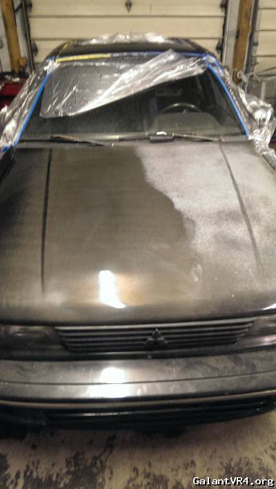

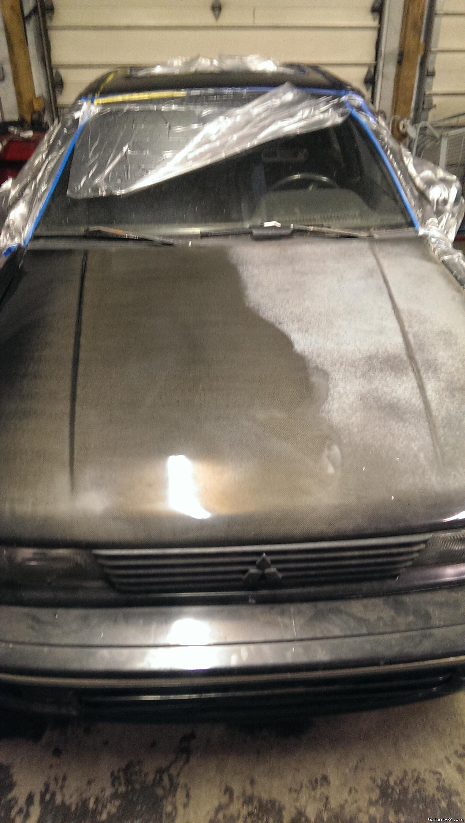

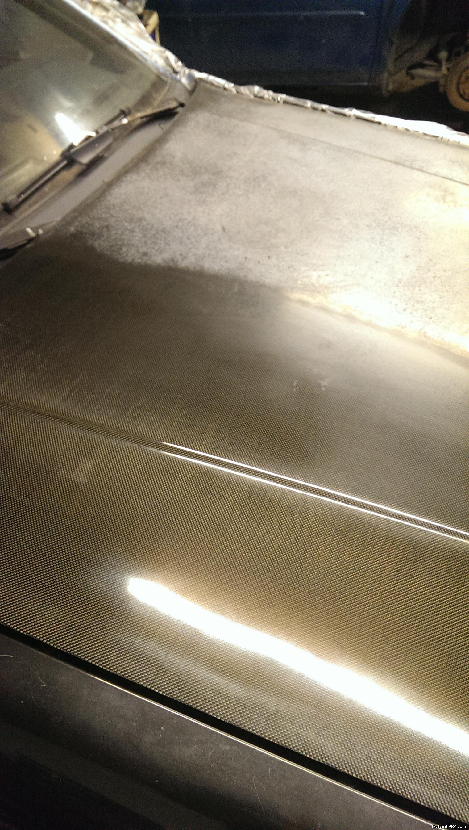

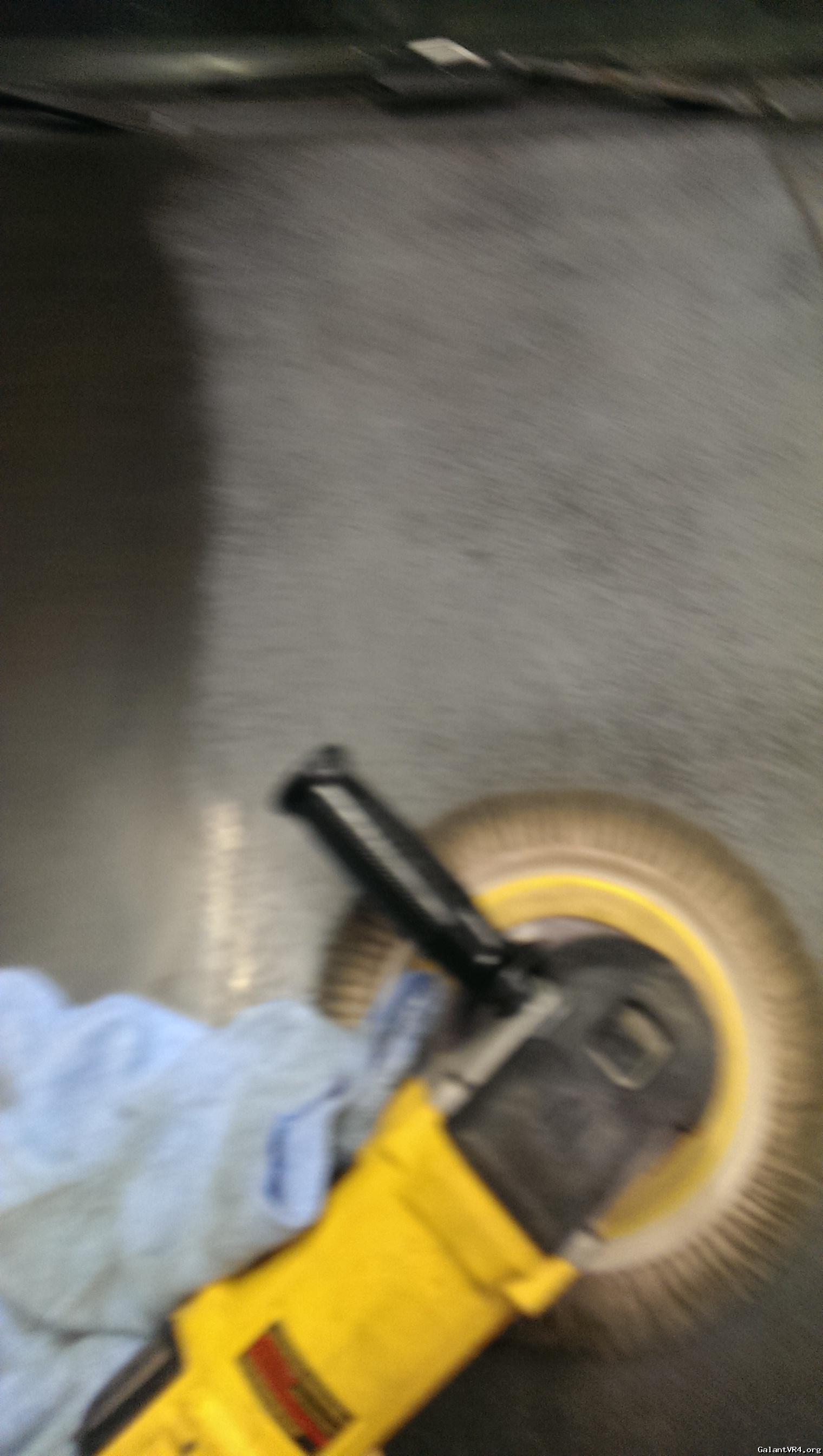

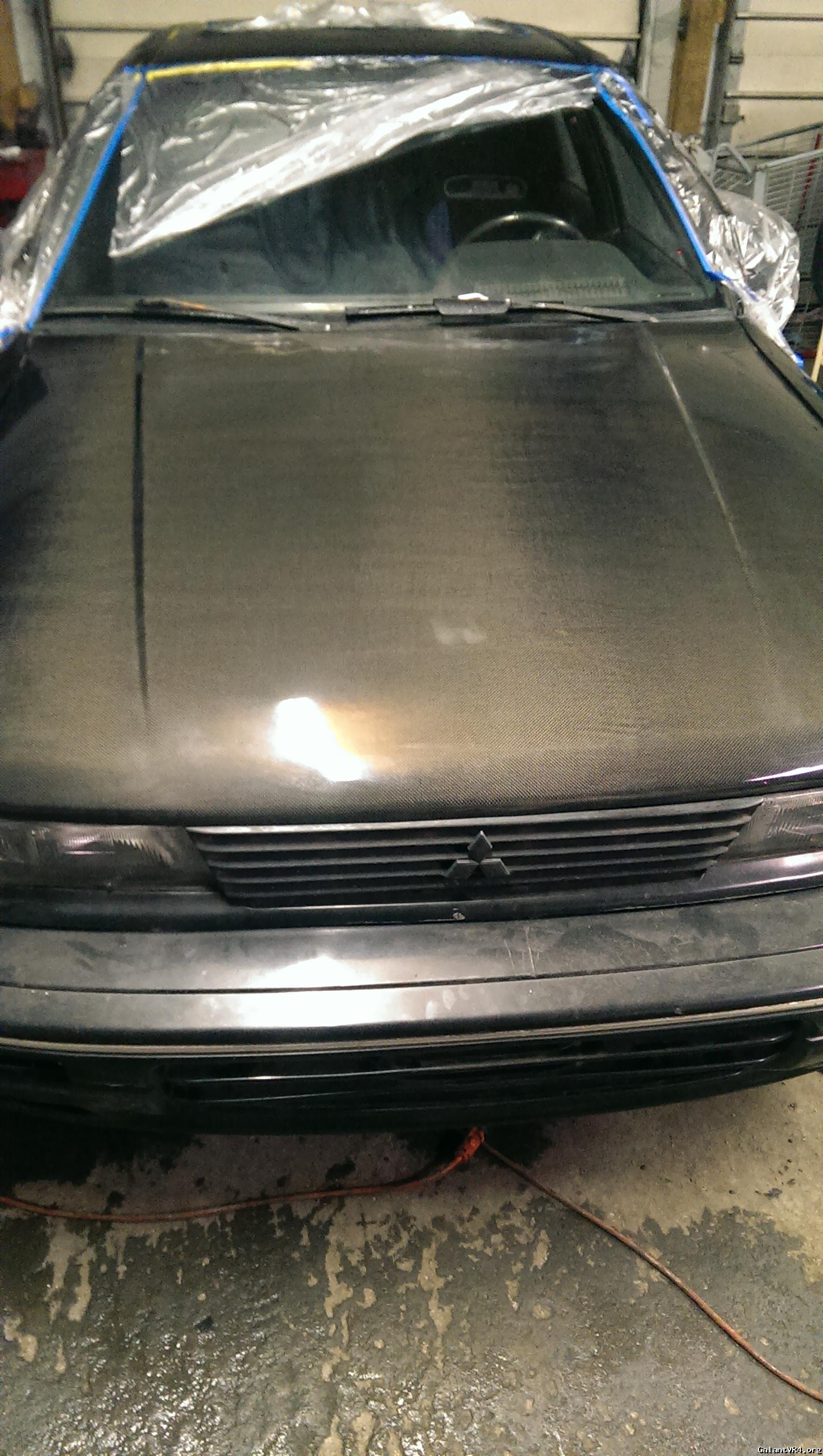

started refreshing my carbon hood. got to wait until monday to get supplies, but ill get it done, then as soon as I find a CF trunk Ill be repainting the roof. there was clear coat peel on the roof/hood/trunk. so after the cf hood and trunk ill just color match the roof and I should be good to go. I would LOVE to do a carbon roof, but in reality its not going to happen to 181. (1630 might get something special though) It would be nice to get a carbon sunroof replacement though.
tomorrow I plan on fixing some more rust, and possibly making an intake pipe. it will most likely be temporary but i need to get my BOV recirc. I might go ahead and do a temp fix on the clear coat as well. but after thats done Ill be back at work finishing up my evo8 ecu adapter. need to remember where my evo MAF wiring has hidden itself.

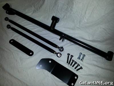

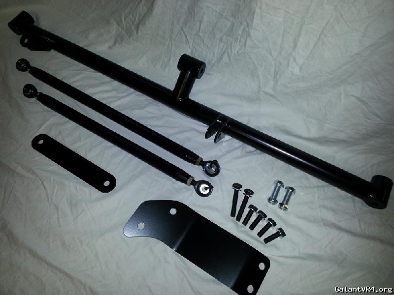

Got a chance to take her for a little spin after chasing down a vac leak. Afterward I went ahead and threw the new subframe in. It's pretty awesome.about 10lbs lighter and way beefier. Should really help the handling. Got to take a look at my front caliper which seems to be sticking, but also waiting on my new wheels and lug nuts.
mountaineerjeff
Oct 21, 2008
1,155
west virginia
Almost done with her temp attendance of team JSB. Just gonna take a look at a sticky caliper and take it out to see if the new subframe is noticeable. The main reasons were for space and weight so any handling will be a sweet bonus.

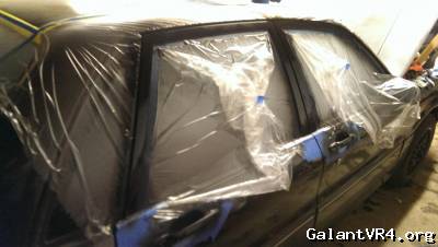

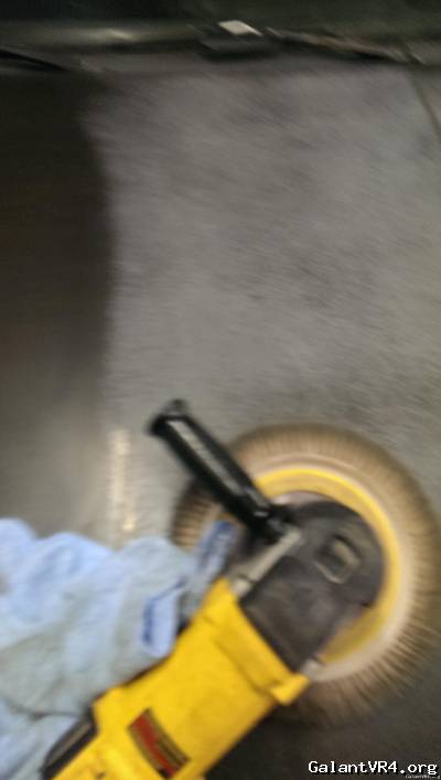

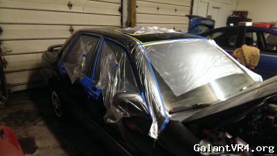

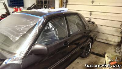

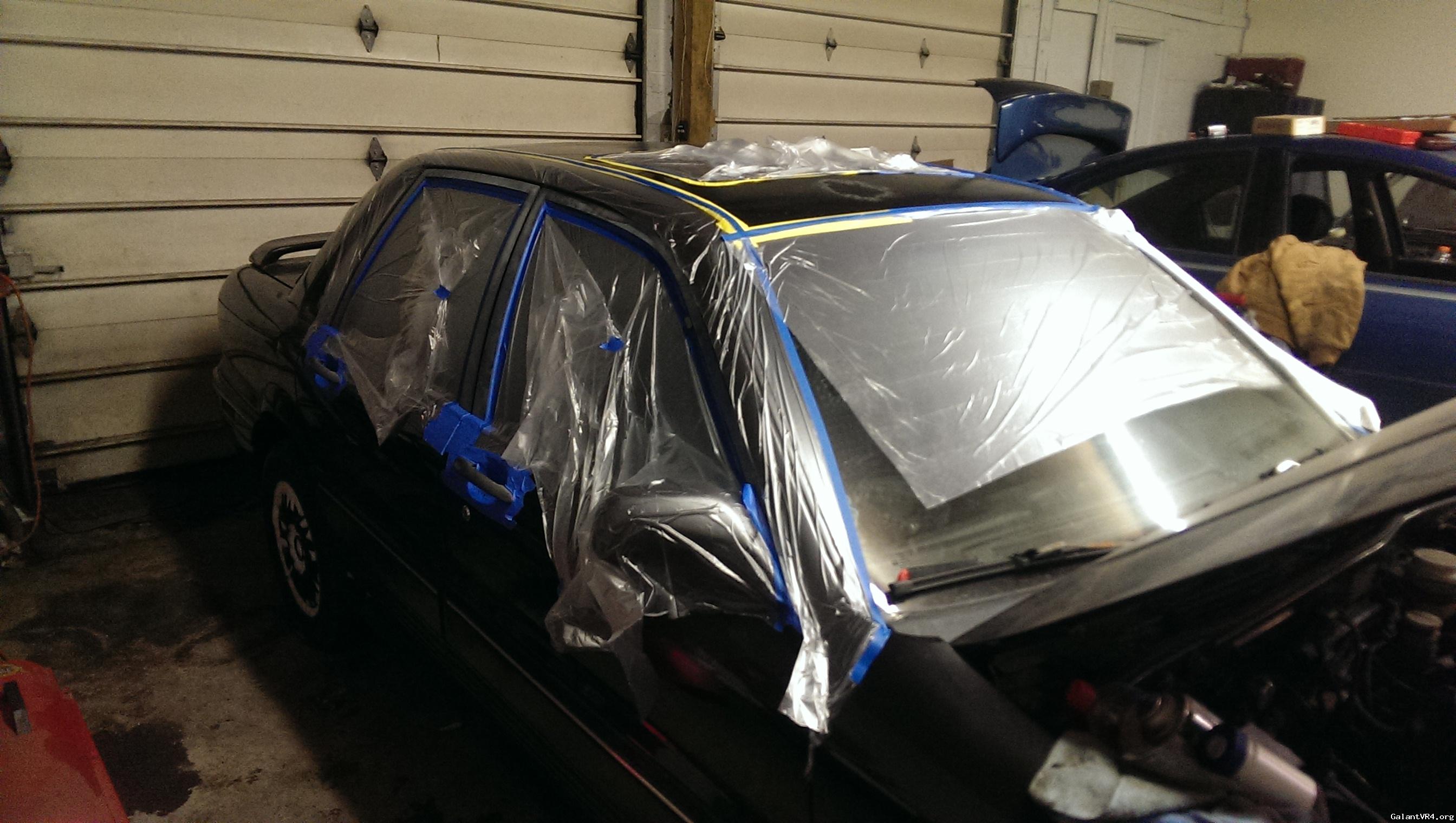

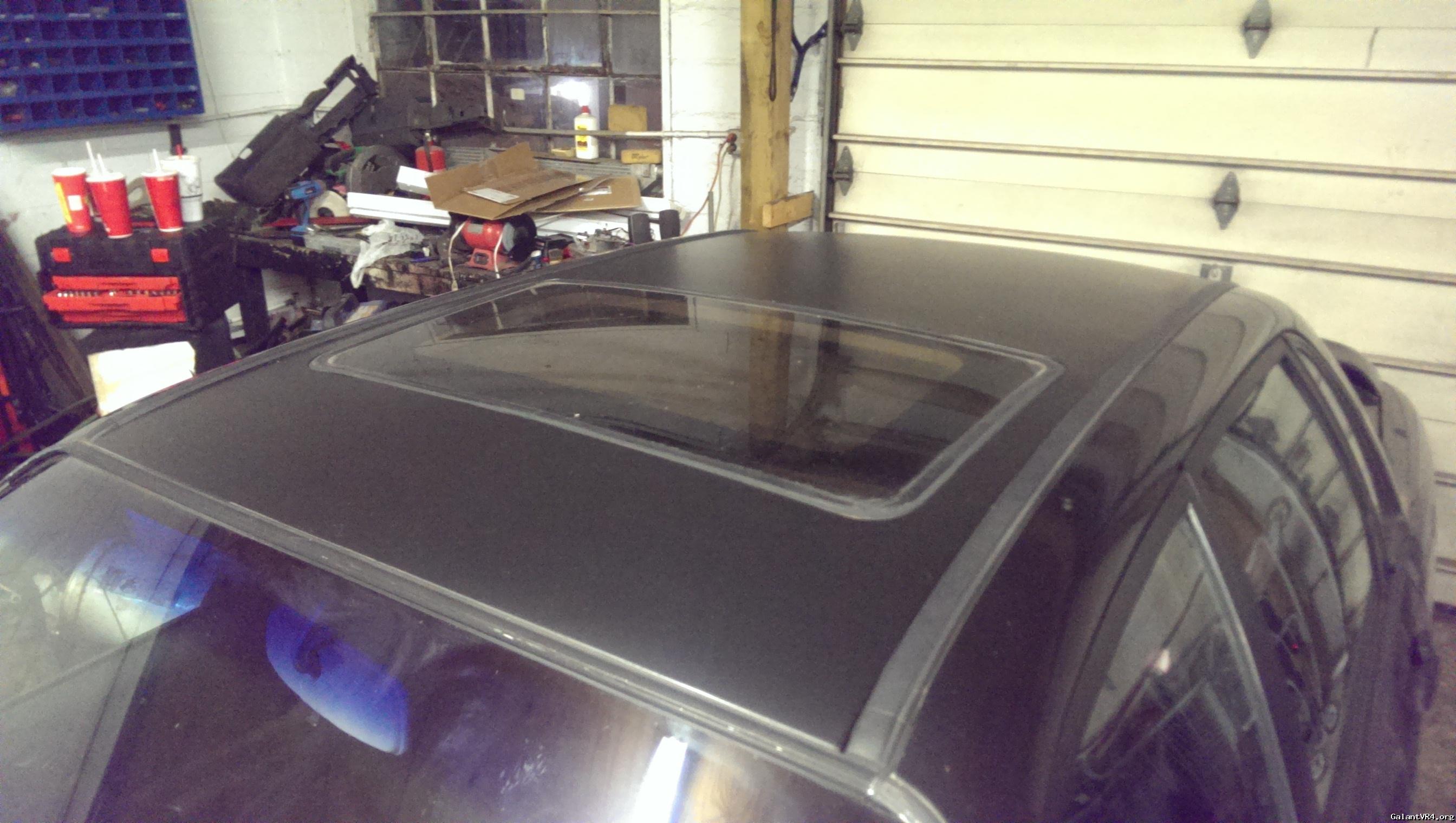

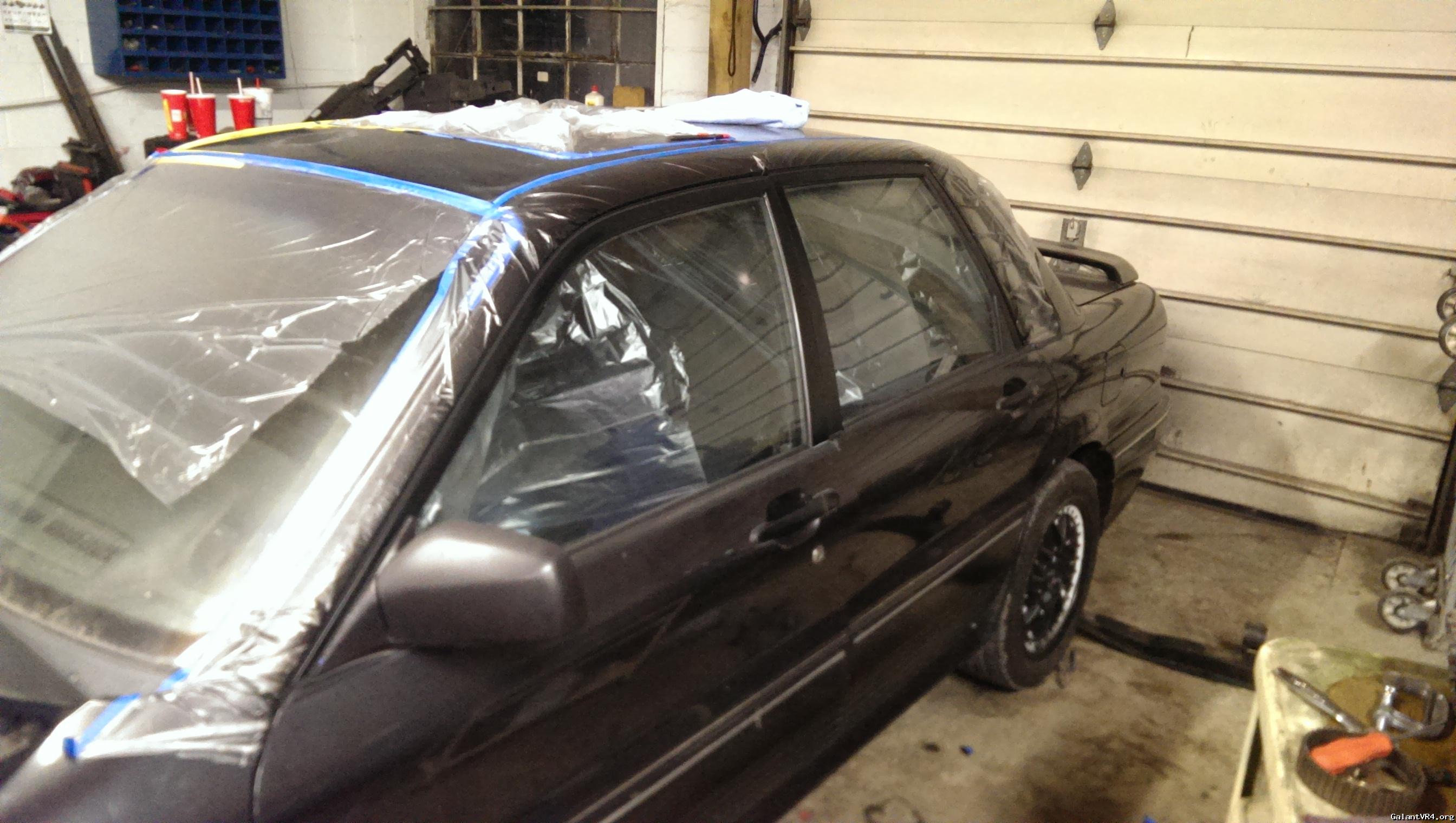

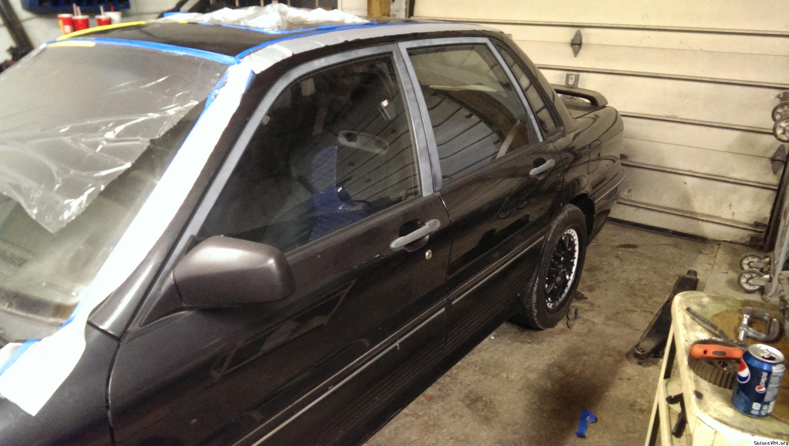

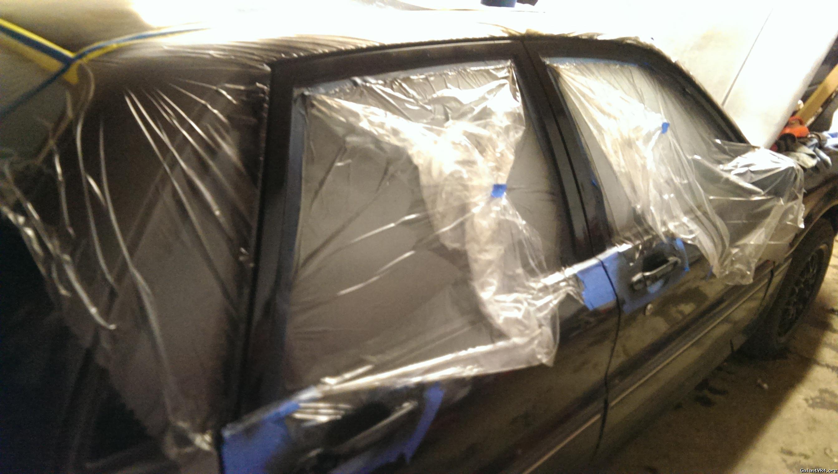

what are your plans to fix the roof clear coat? I have some peeling clear coat on my car also... not sure how to fix.
mountaineerjeff
Oct 21, 2008
1,155
west virginia
Quoting coyotes:

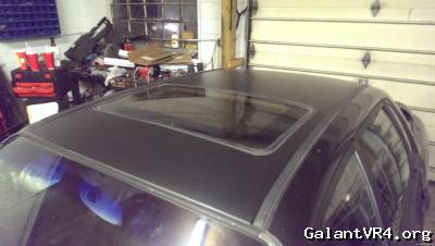

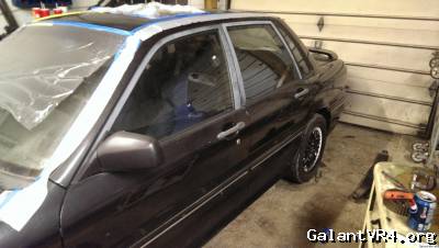

Sorry, was on a roll and missed you question. I just went the easy route and used Plastidip. If it was a better chasis I'd take the time to take it Down and repaint it. But for this car, and any daily driver on a budget, Plastidip works fine and looks a hundred times better
coyotes
Nov 15, 2013
1,544
Seattle, WA
I would just do that too if it was my roof, but my clear coat is peeling on the passenger side rear panel, so plastidip wouldn't match it very well. /ubbthreads/images/graemlins/frown.gif
mountaineerjeff
Oct 21, 2008
1,155
west virginia
2 tone it at the body line. Just run a tape line from the corner light back to the taillights and call it done. Or you could commit and do the whole car.
