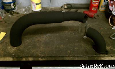

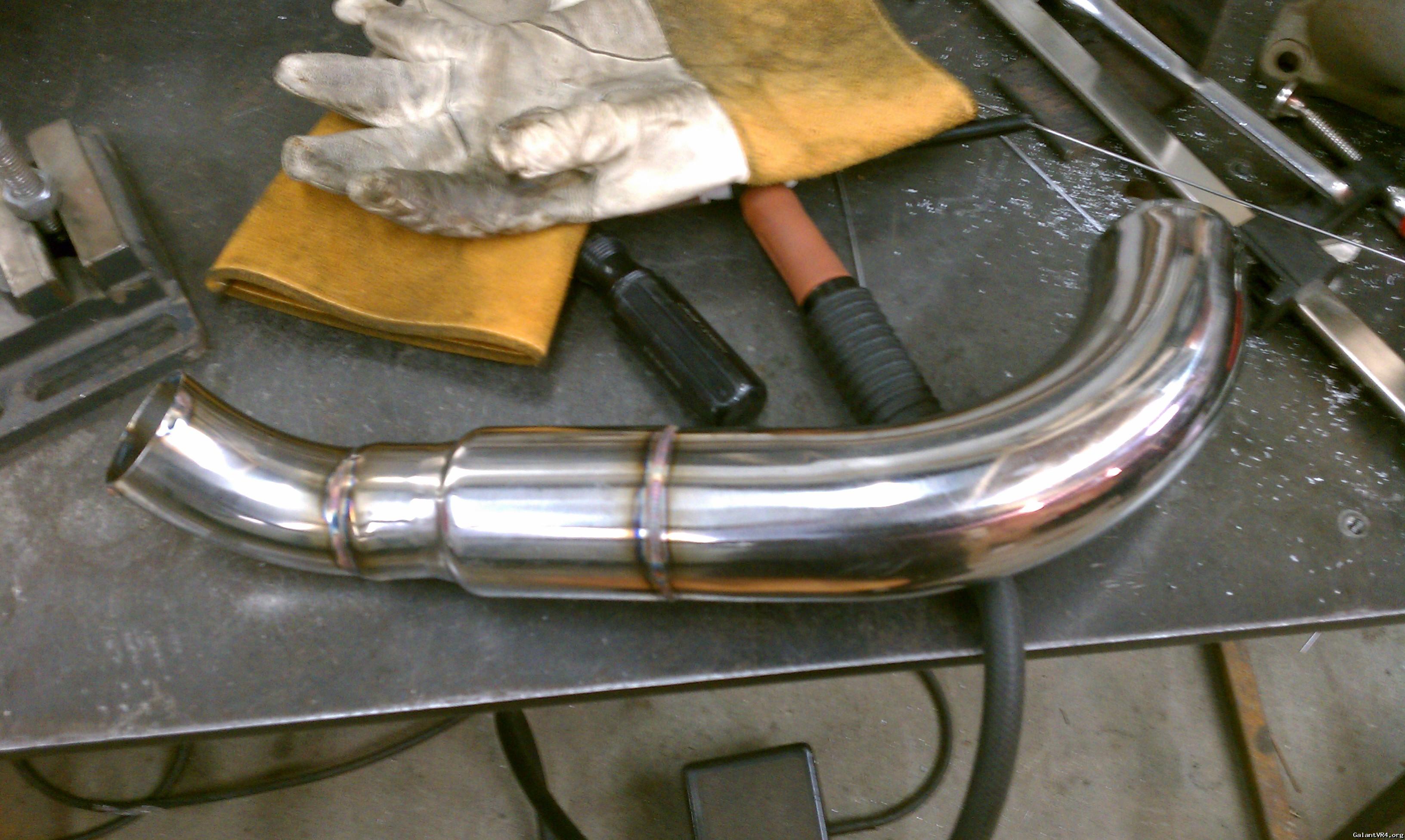

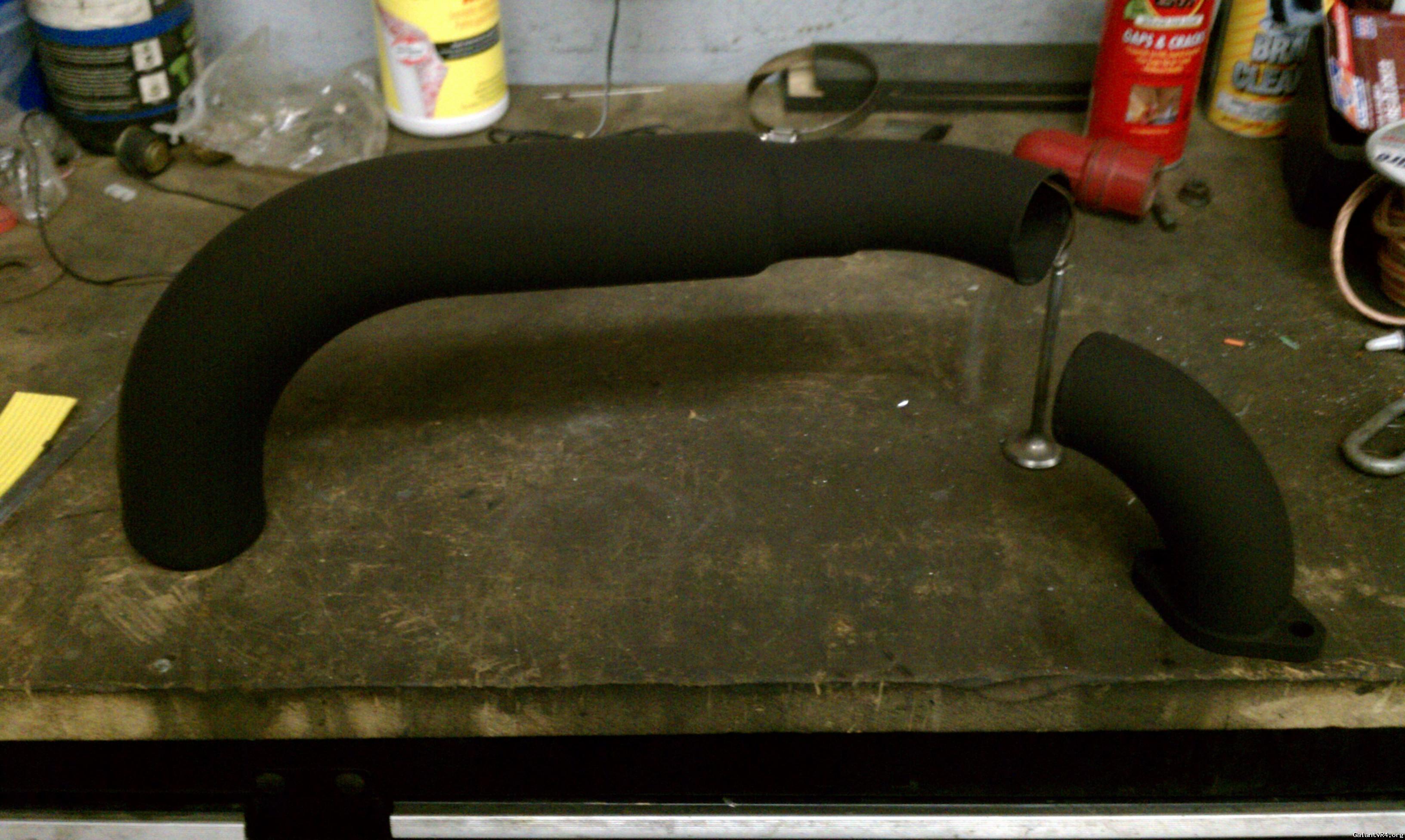

no prob. I still have to wait on the pipes to be done so I can coat them s well. Im also thinkin about a spark plug cover, but IDK.

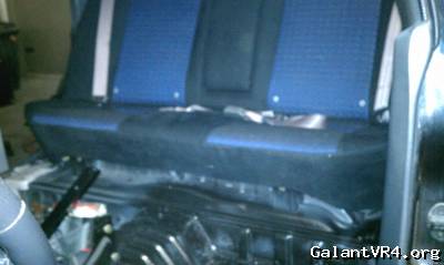

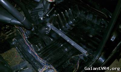

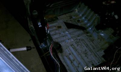

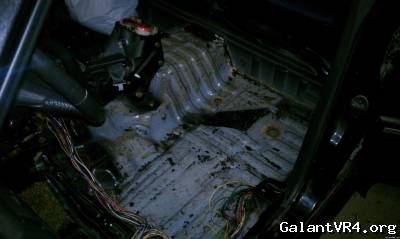

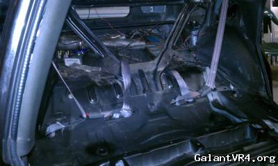

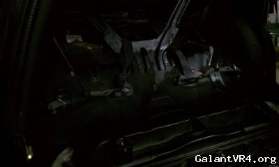

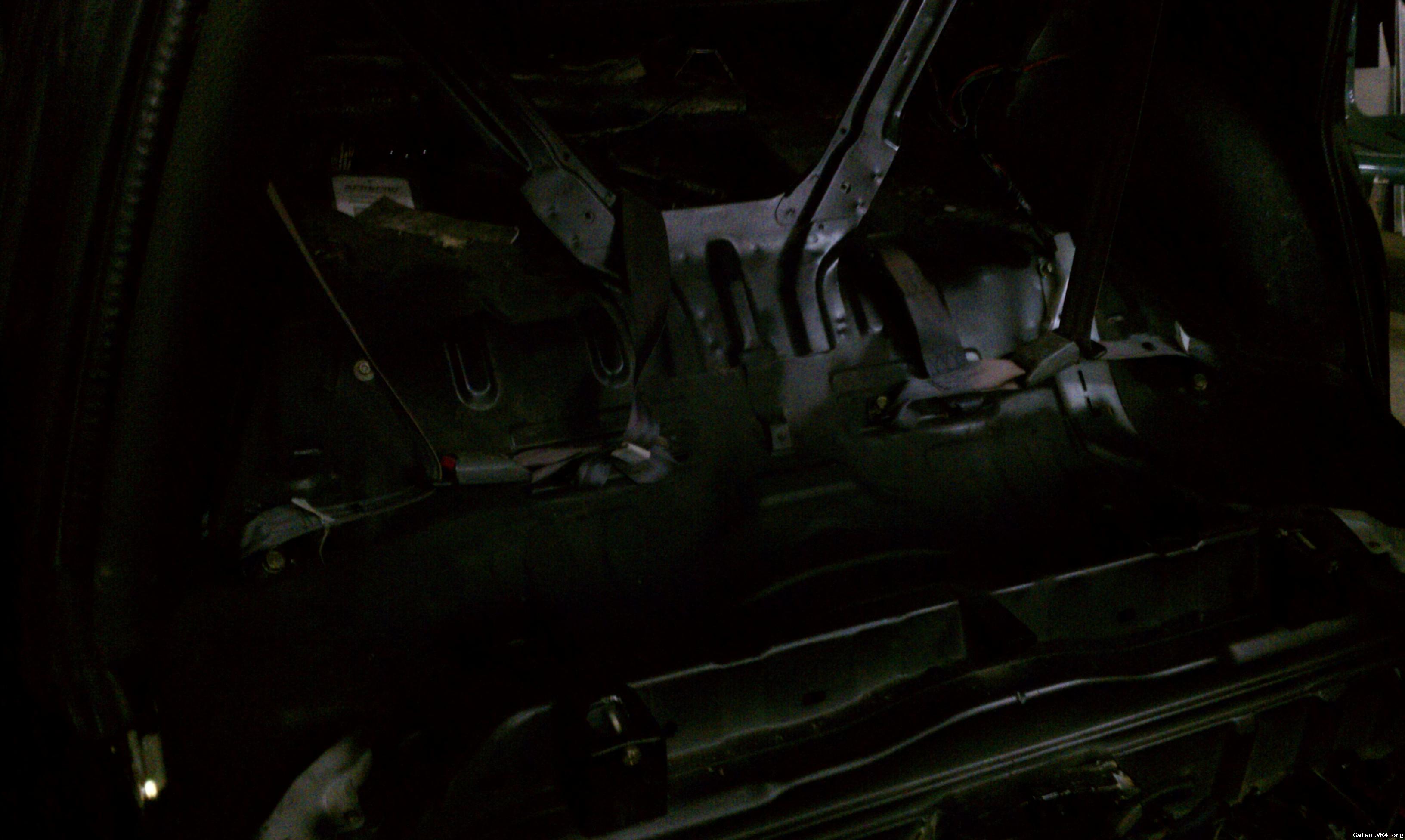

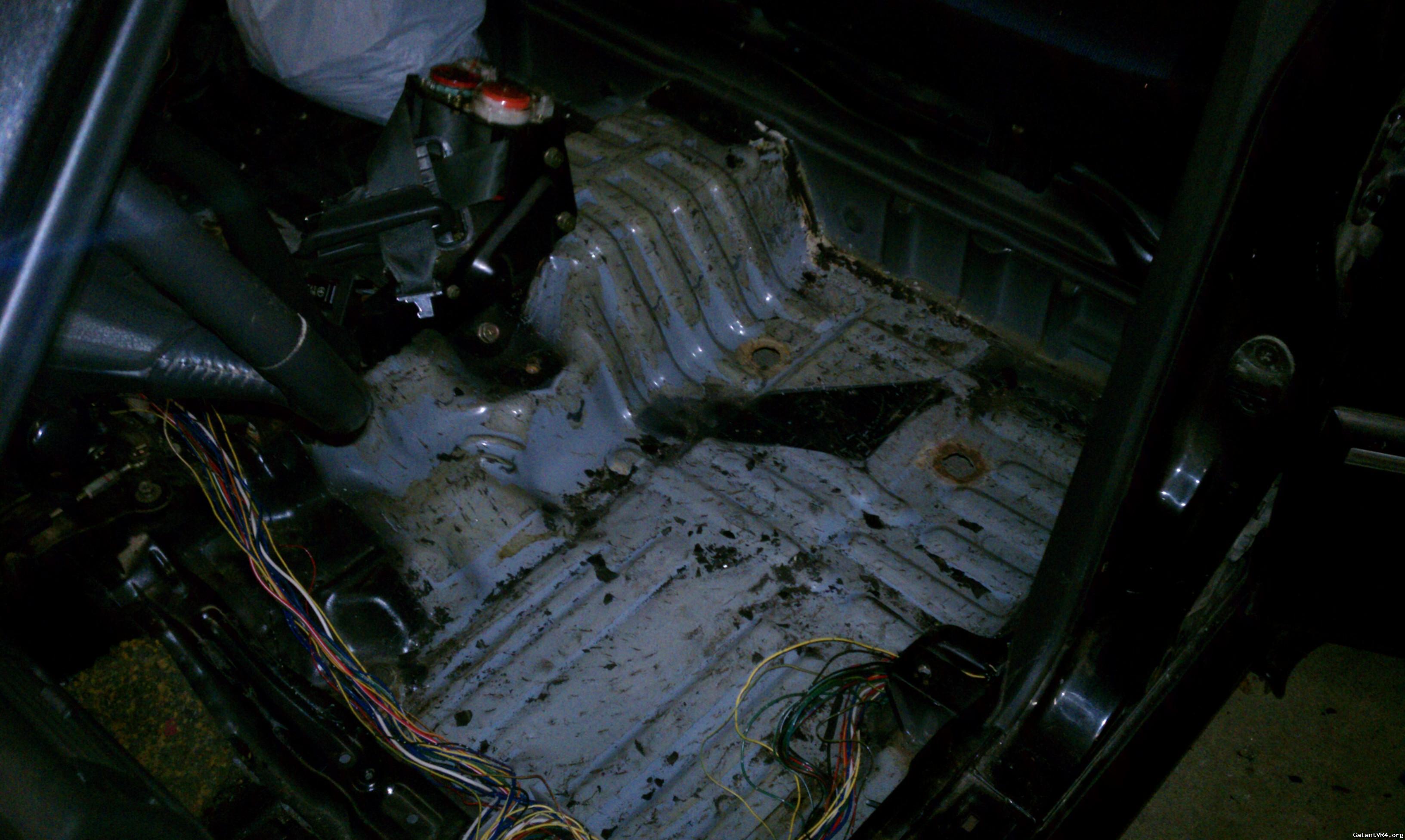

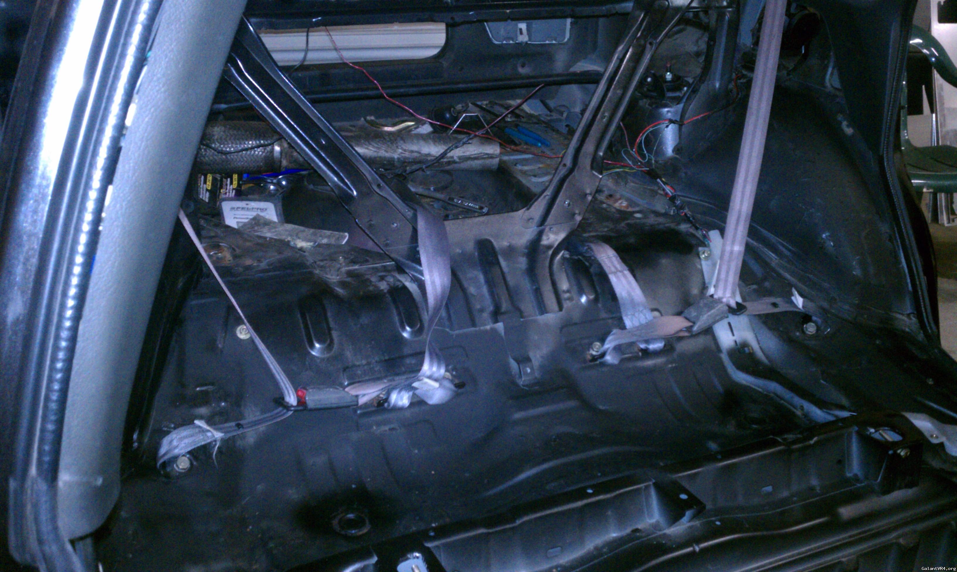

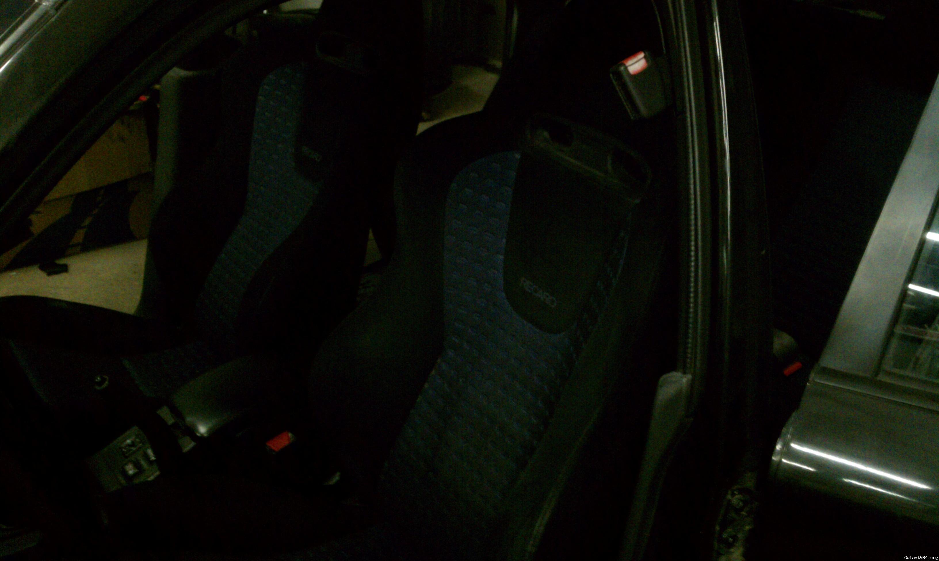

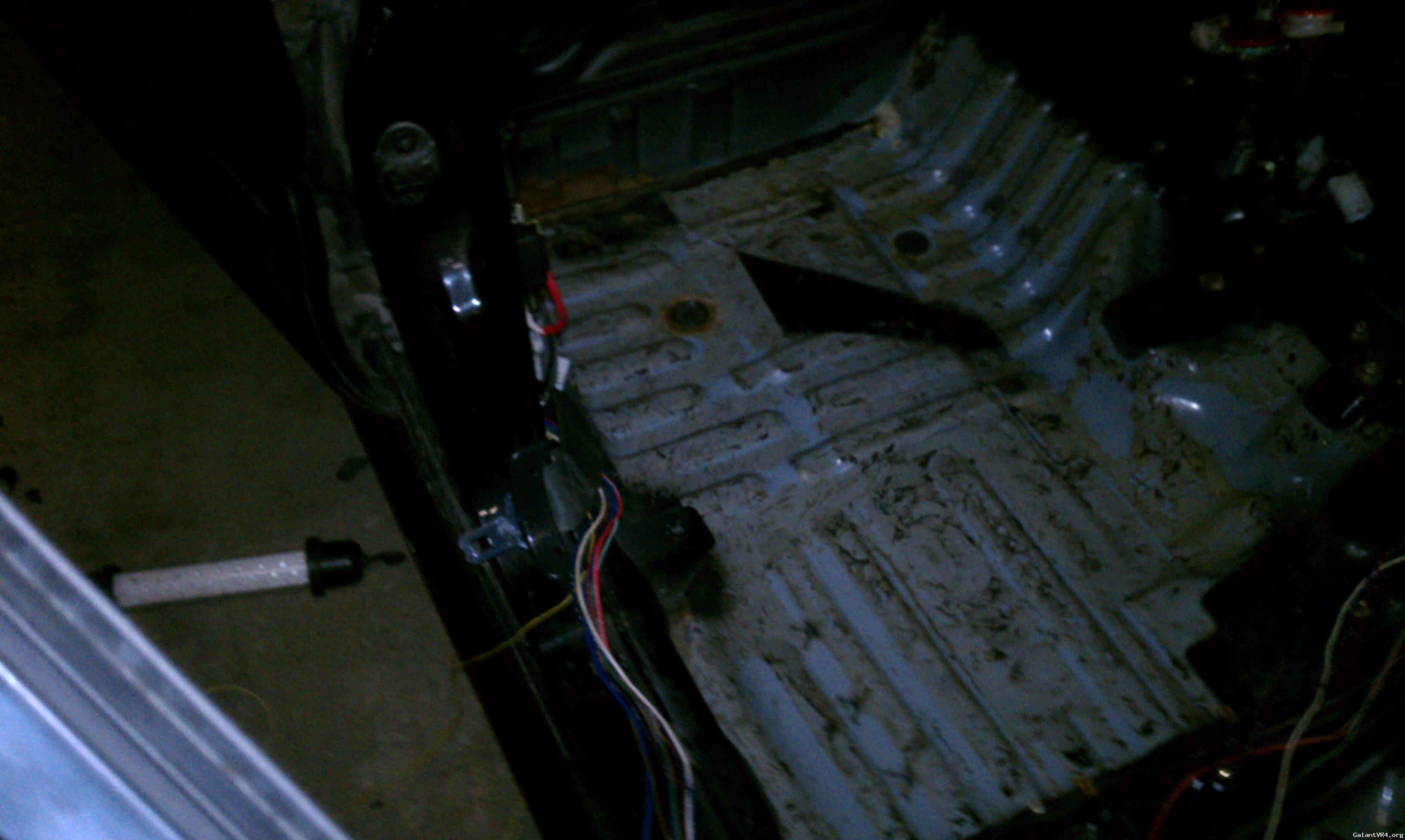

well the ricers here are out of control, so I decides that stuff needed to get a little more serious and chose to go ahead and gut the interior. I pulled the seats again. then started beating all the sound deadening out
mountaineerjeff
Oct 21, 2008
1,155
west virginia

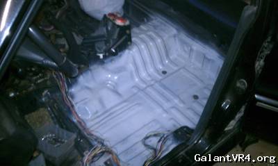

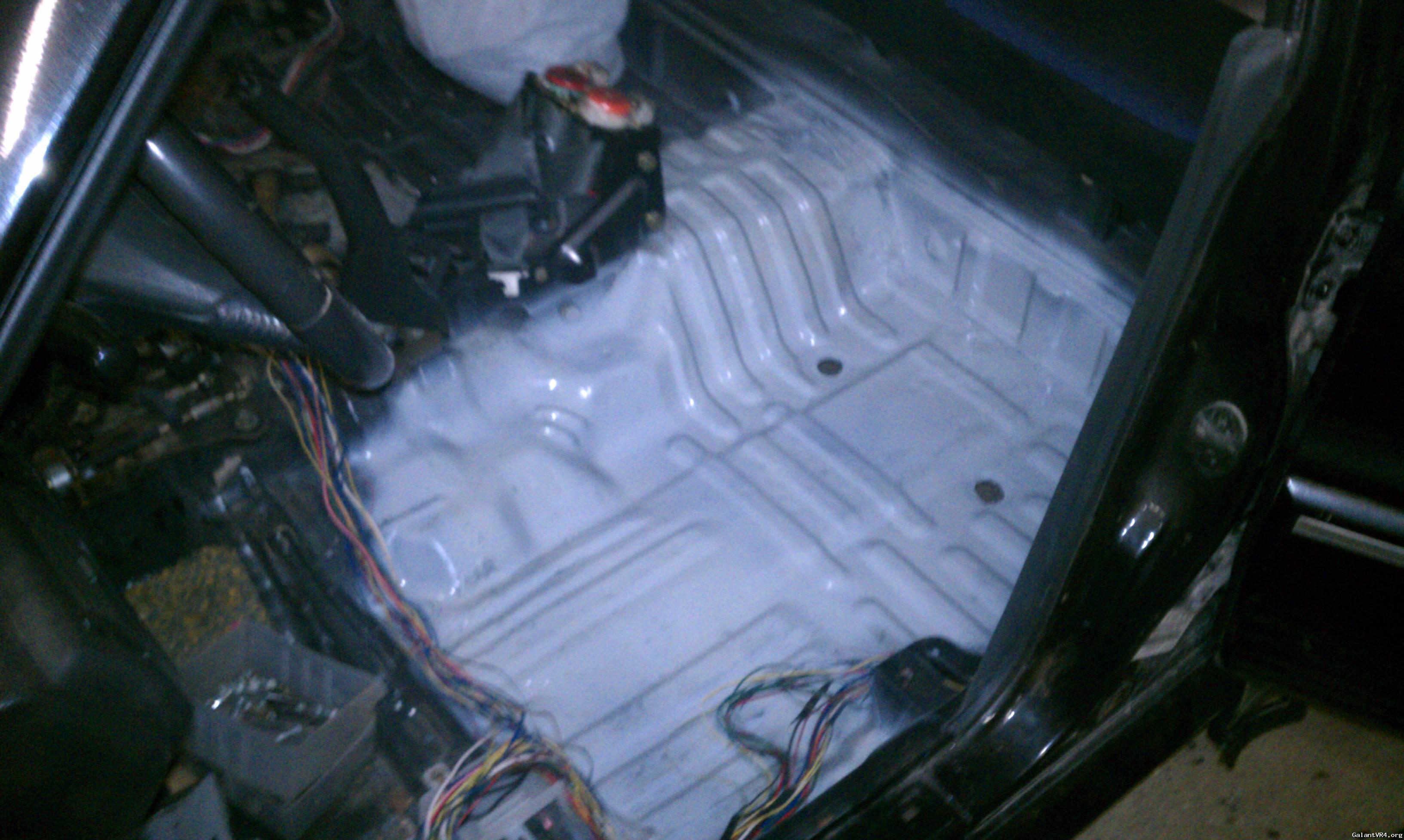

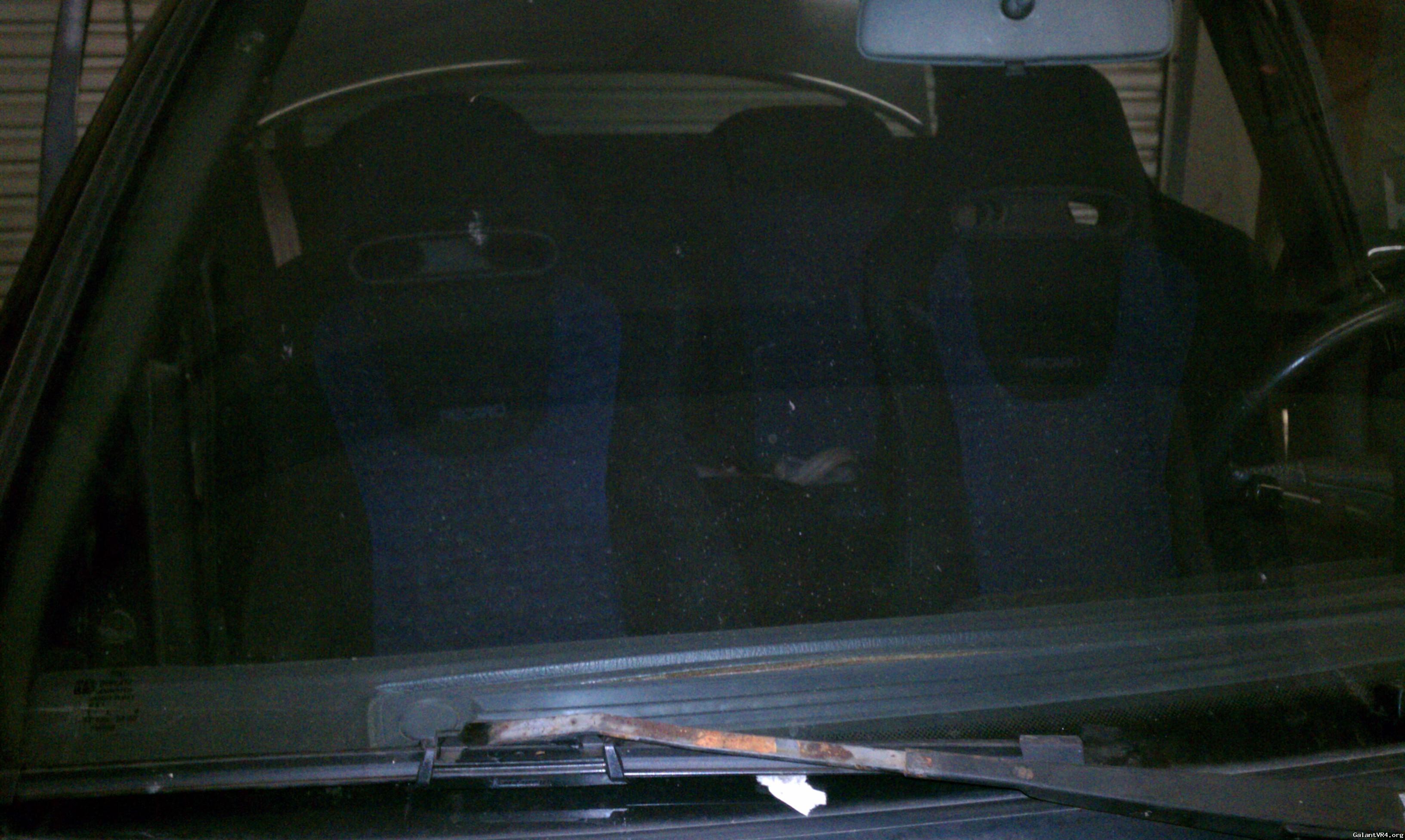

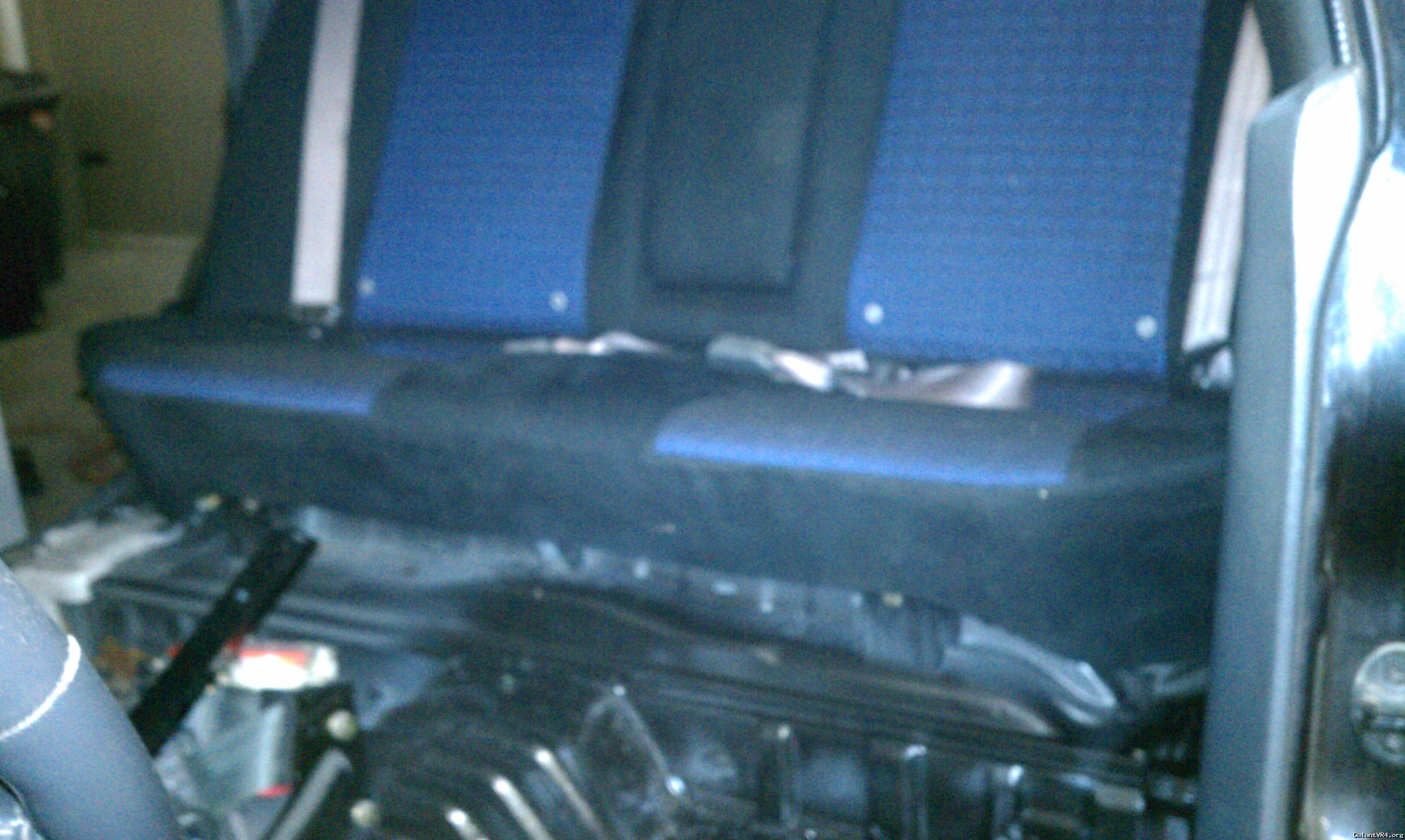

passenger side cleanup

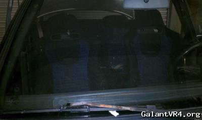

seats are in for good.
we pretty much got the interior finished for now.I still have some more advanced plans for it down the line, but being broke doesnt help. just need to make a gauge pod and ill be good.

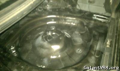

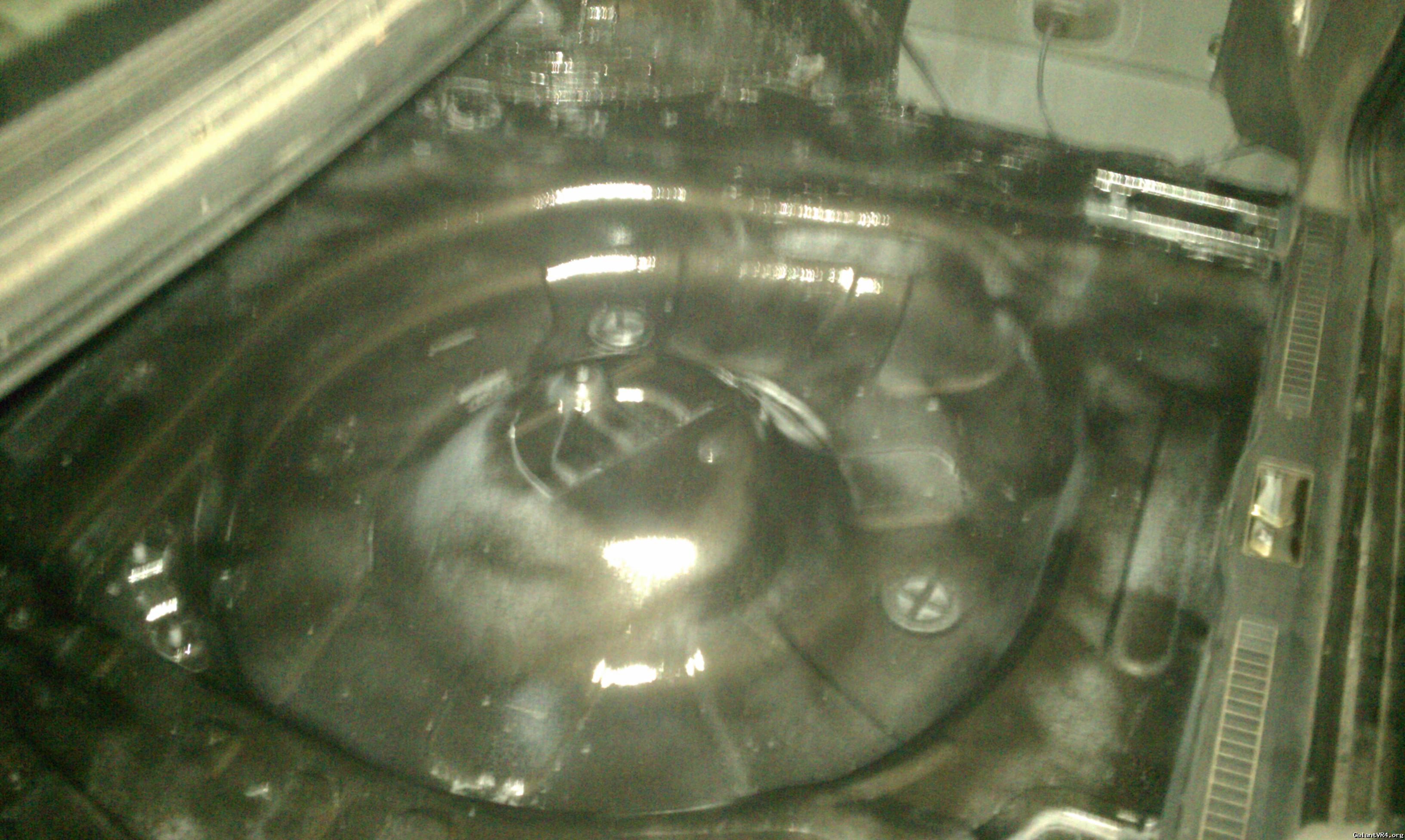

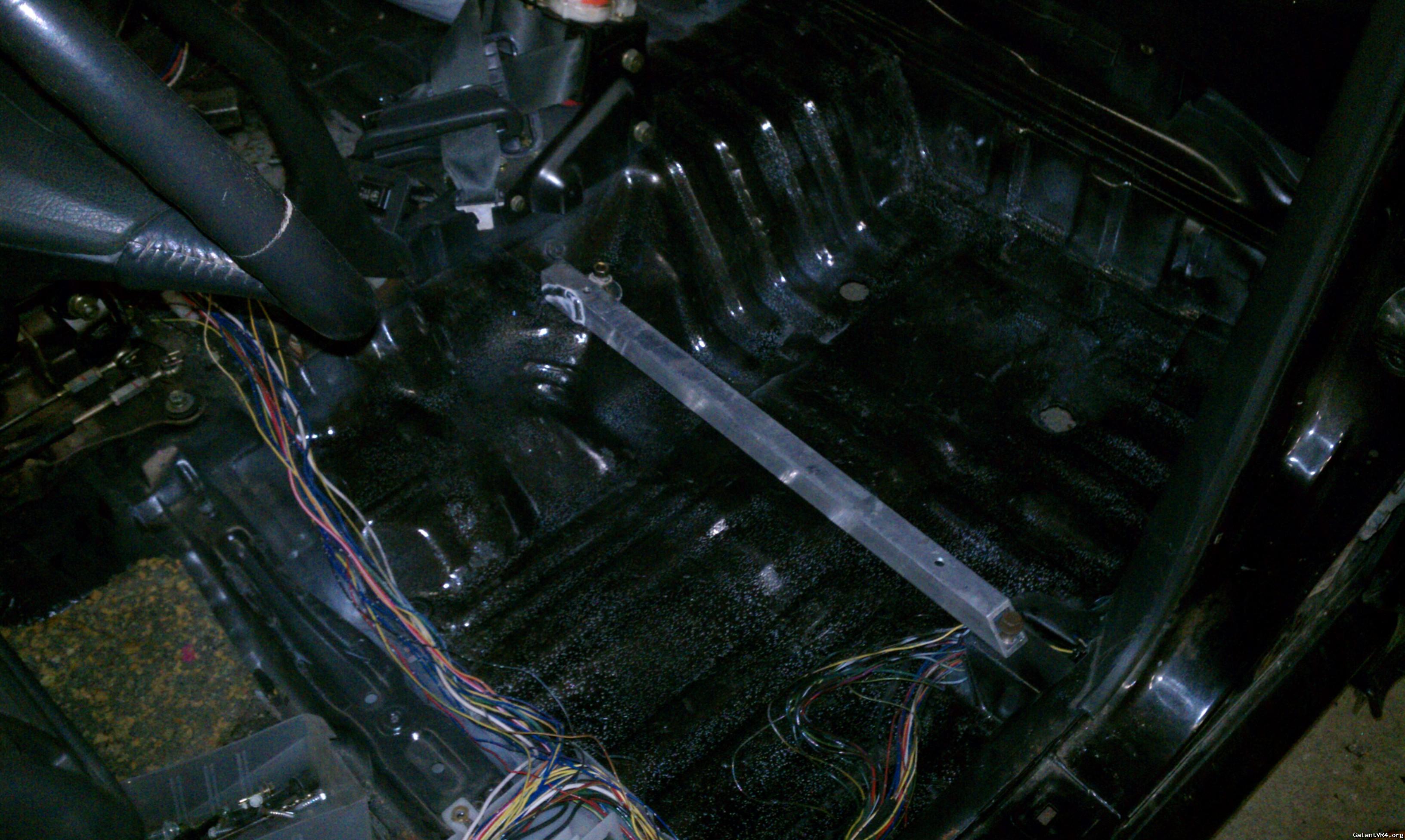

really hard to get some goo interior shots, but the interior is pretty much done. all weight removed. seats and brackets all done, everything repainted. speakers removed. All I have to do now is mount my gauges. I took out MASSIVE amounts of weight from this car.
the trunk is gutted as well. this is just the first coat after the primer, so it obviously gets better.

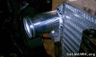

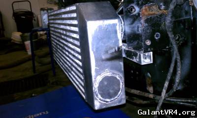

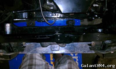

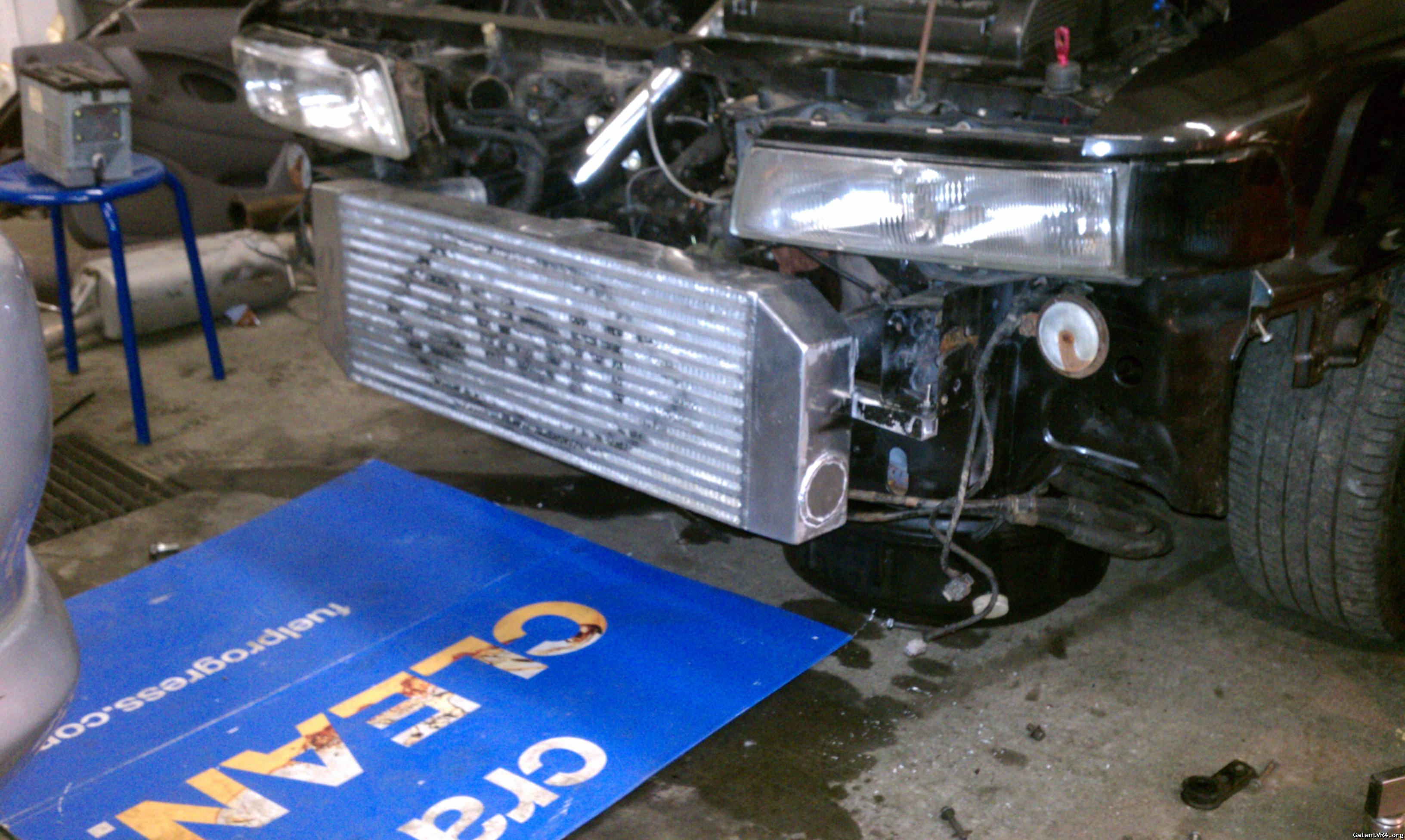

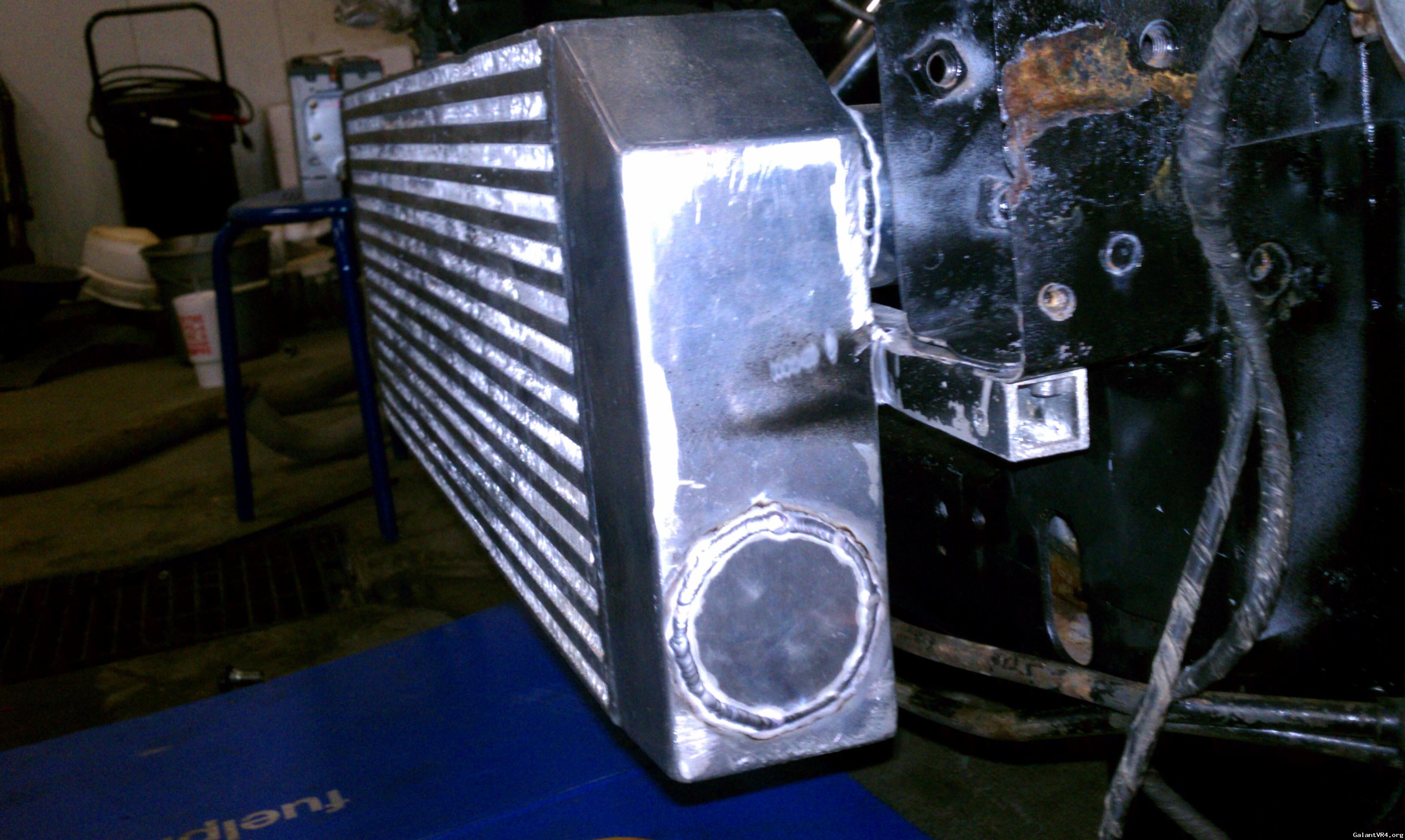

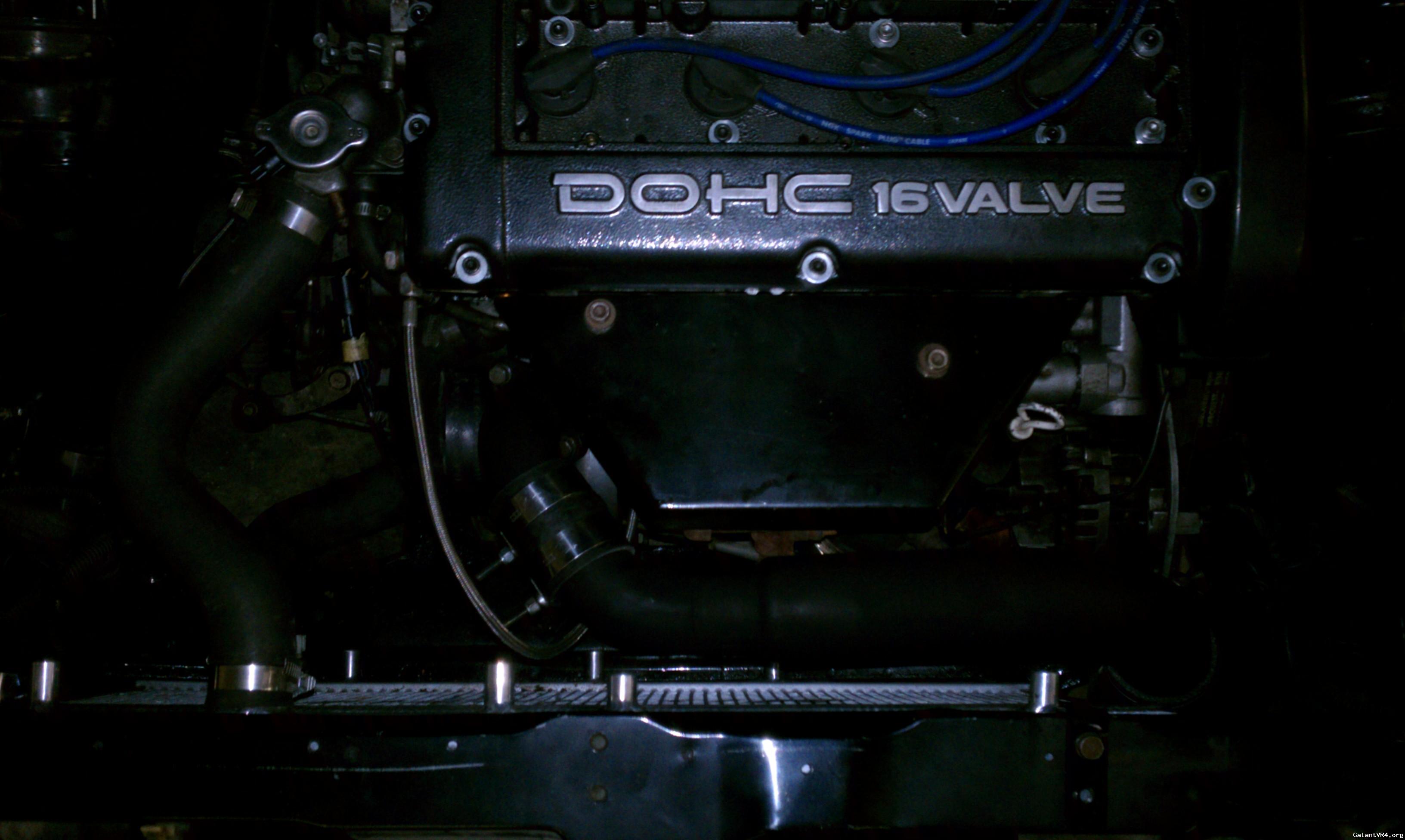

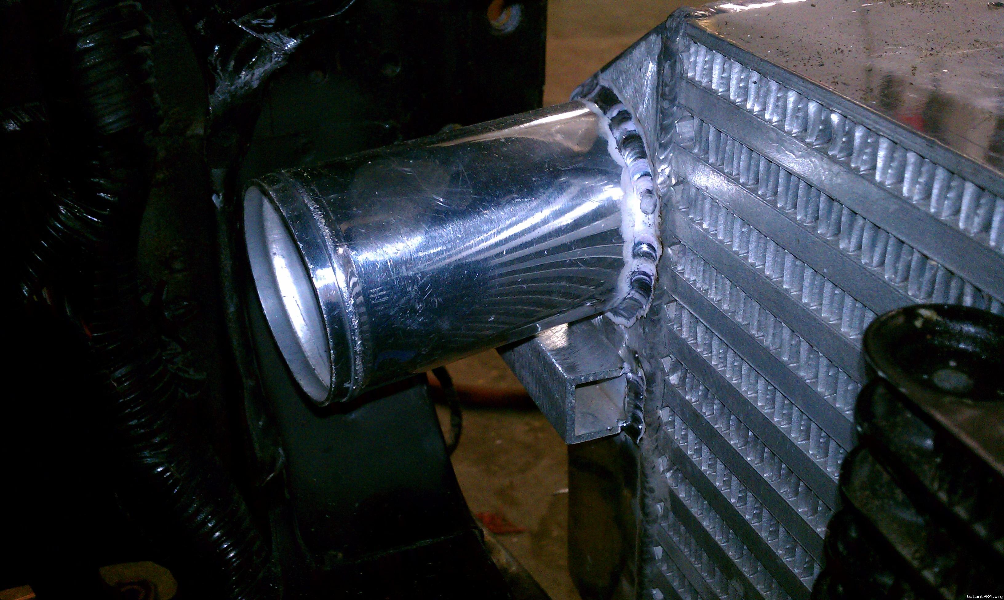

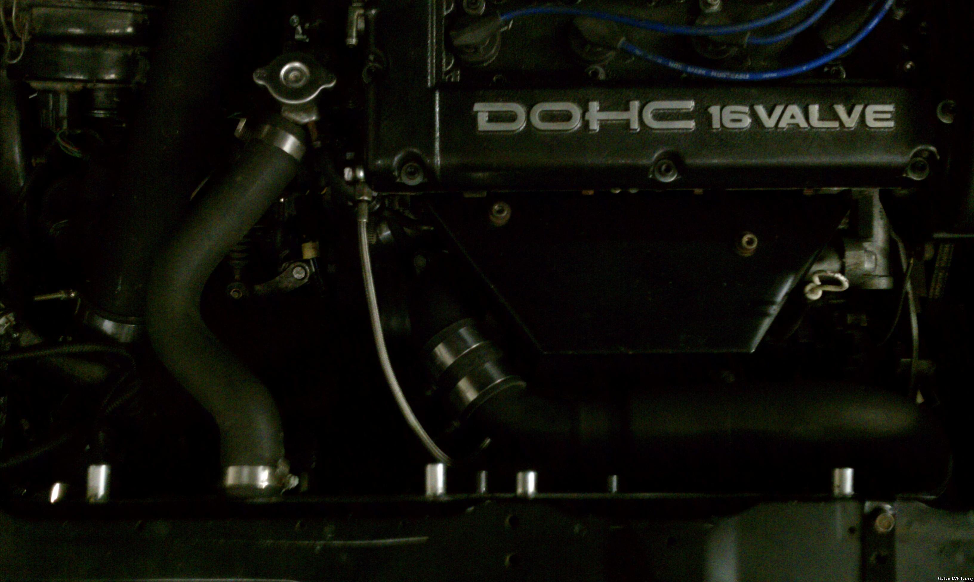

we also got the intercooler finished and mounted. also have the oil cooler cleaned and mounted. and the bumper is partially done. more pics tomorrow.

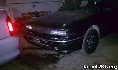

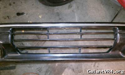

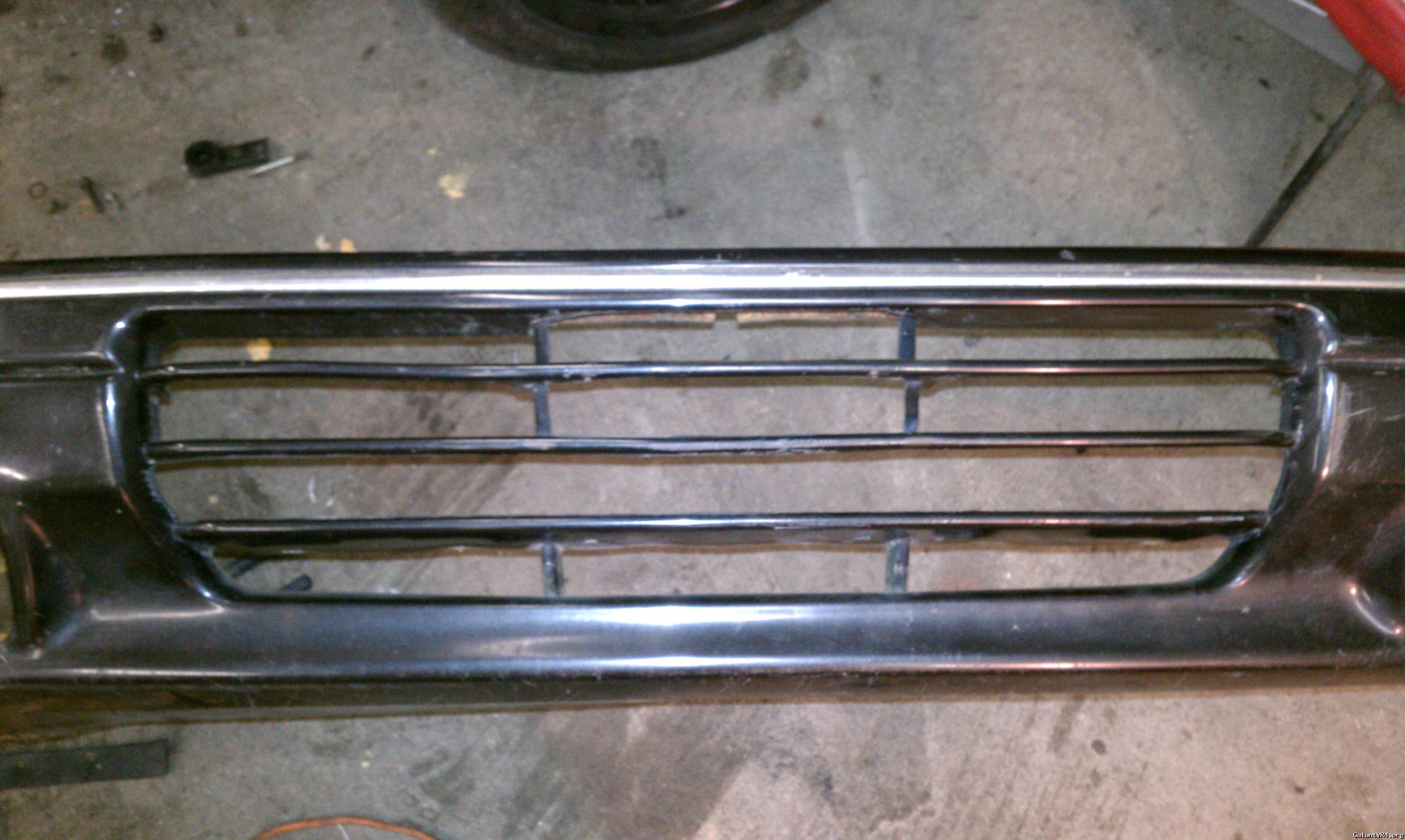

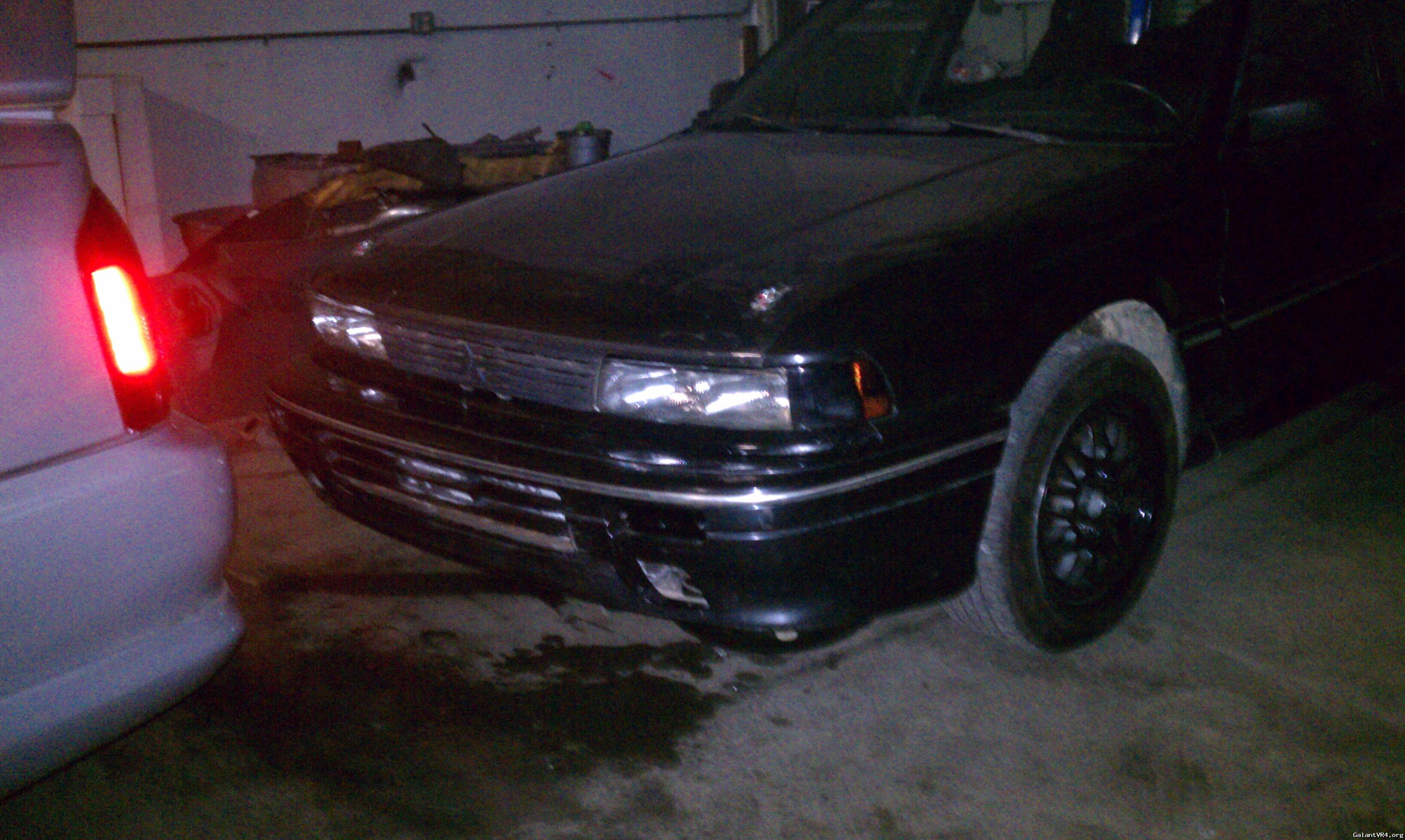

i got the front end all tidied up. the bumper is mounted, and the blinkers have been put in, and wired back up. I still have to get the foglights mounted, which fit perfectly even with the large inter-cooler. the grill is also mounted, along with my blacked out tri-diamond.

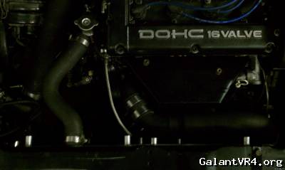

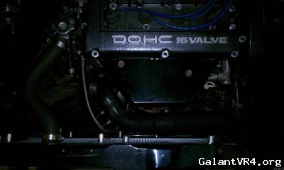

pretty much got her back to running condition. I need some more light under the hood to get some good pics. the only thing left is my exhaust. on top of just running, I still need to mount my gauges, and switch in my injectors. then I need to find a way to run some bigger 1000+ injectors.

After having the engine bay all back apart, rerouting the harness, doing the intercooler piping, and converting a lot of little things, 181 still started right up. I just hooked up the battery, stuck the key in, and turned it right over. started first try.
she is still sitting at the shop as there are a few things I need to be streetable. Need to get an intake the doesnt interfere with new piping layout, bleed the brakes and clutch, and get the exhaust together, and shell be good to go.
