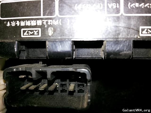

tintoy
Oct 28, 2007
140
philippines
yes i want to set first the idle correctly before adjusting the timing. my problem is that i can't identify which pin to ground in my diag plug, coz the picture provided by vfaq (1g BISS)is not the same with mine, if I'am right. here is a picture of my diag plug and pls tell me which pin to ground. so the i can correctly adjust first my BISS.

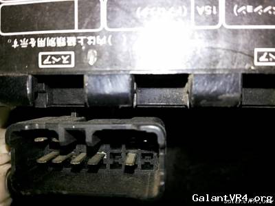

tintoy
Oct 28, 2007
140
philippines
sorry about the picture (left side down). the right position of the box is that the two pins form the left are on top. pls help... thanks
