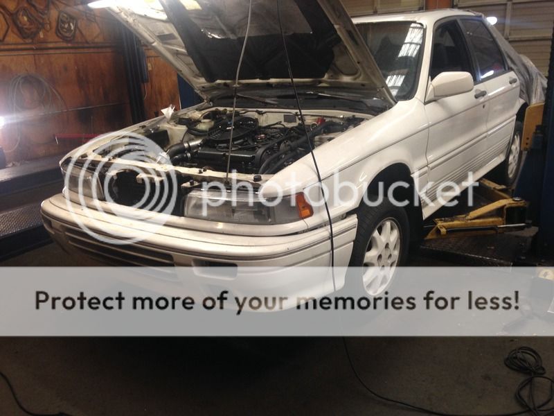

Happy valentines day! Starting to really get charged about this thing. I went to my first race of the year, got to meet farmtruck and azn from street outlaws, they were there for the tracks season opener. Super nice guys, stayed there all weekend, did the winners circle and a few arm drop races, as well as run the farmtruck for a quick blast down the track.
I got to spend some time with my valentines date /ubbthreads/images/graemlins/smile.gif
I did a little bit of wiring, got a pusher fan hooked up, waiting on the other, gonna have two 10"s. Then I filled the radiator up with water, saw my water pipe where it meets the pump is seeping water a bit, with a brand new O-ring...SMH... little stopleak will fix it.

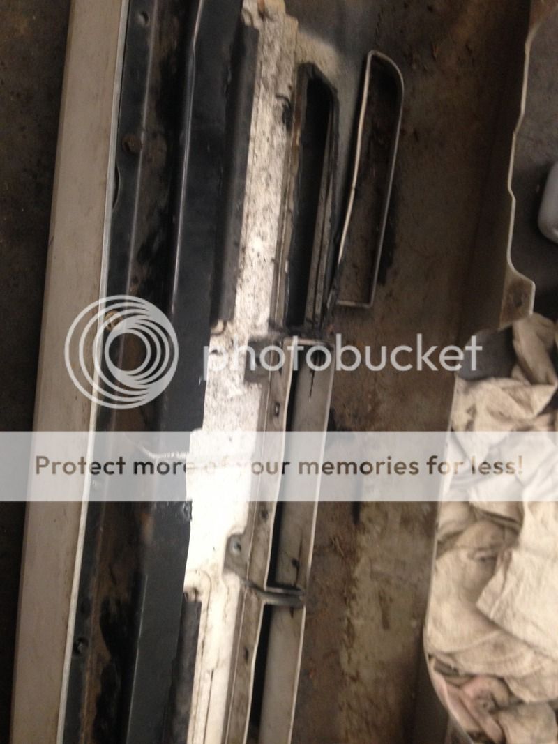

Then I worked on finishing up the bumper/intercooler install. The intercooler wasnt wanting to sit vertical for some reason with the bumper in, kept wanting to sit forward. Then I saw the bumper needed a small trim. I tried to be gentle.

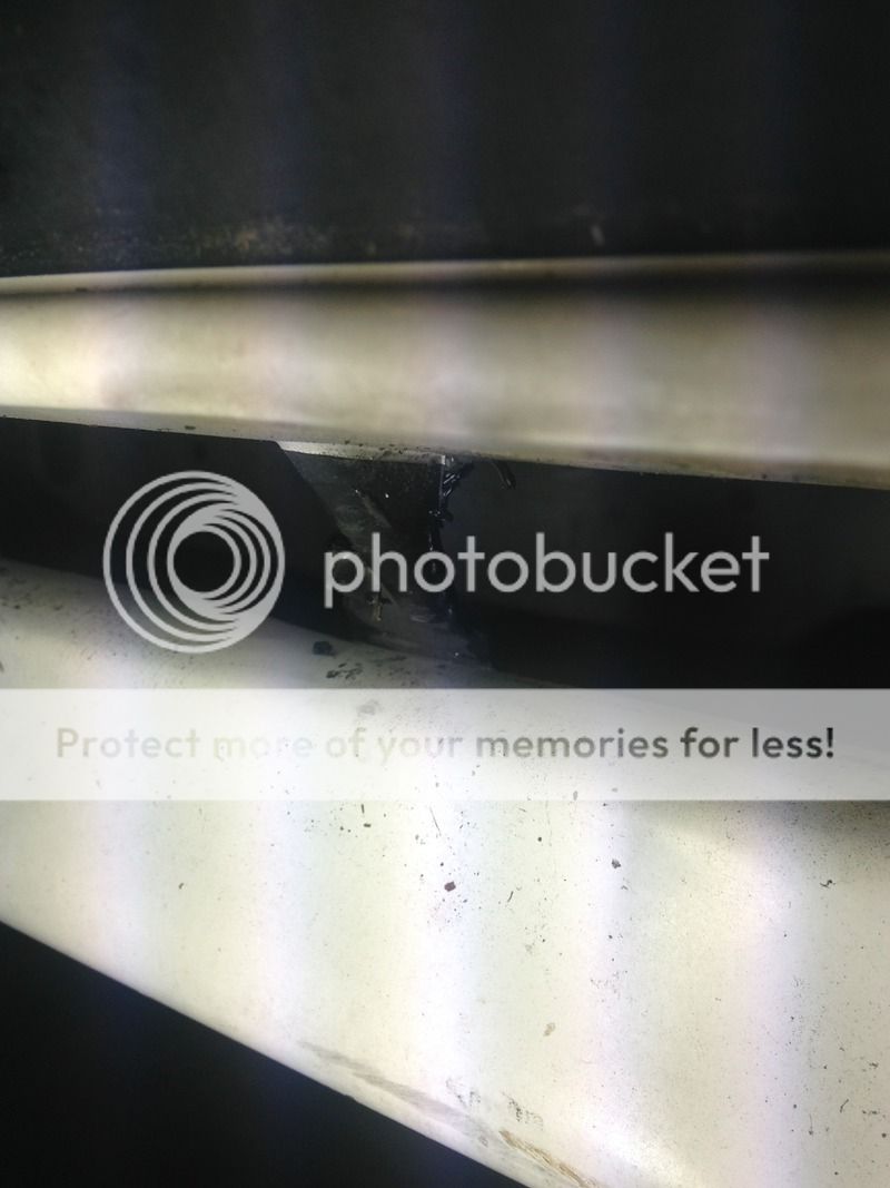

Then I went a little deep and trimmed the lower bumper from the supporting verticals, which I was trying to keep so I wouldnt have a saggy bumper /ubbthreads/images/graemlins/smile.gif

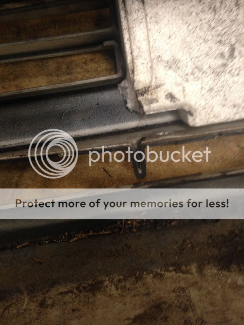

So I JB welded some plastic to hold these two back together, then plastic welded it a bit. I trimmed it after this and it looks pretty good. Best of all its flat and will clear my intercooler on the backside.
Thats all I trimmed for now, Im gonna take a look at what that junkyard had in the way of front bumpers for me, and thatll let me decide if I wanna open up this bumper a little more, or call this good and cut up a spare. Either way I plan on having as much of this intercooler exposed as I can in the summer time. Ive got the intercooler off so I can get the mounting threads welded on, so I can install this thing a final time. Thats all for now /ubbthreads/images/graemlins/smile.gif
