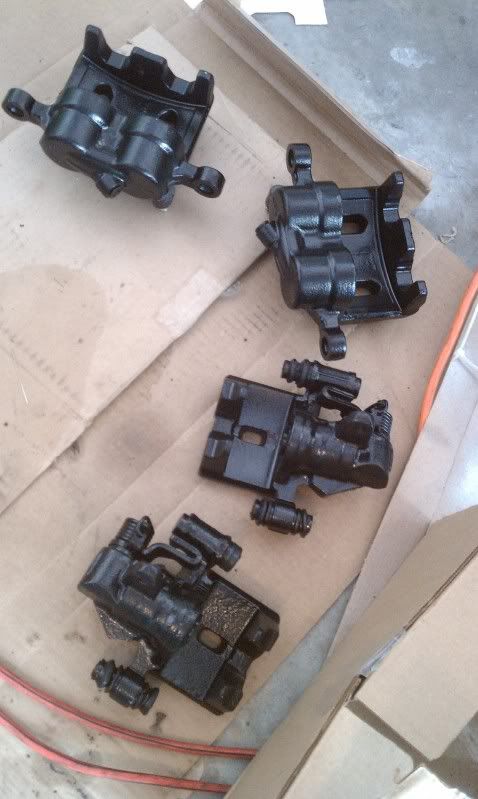

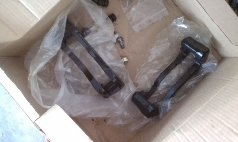

Finally got my calipers back from my friend. Unfortunately he hasn't finished my front hubs so I have to wait to install the front calipers. Got the rears bolted on and the only thing that concerns me is the lack of play for the SS line from the caliper to where it bolts on at the strut. I'll get some pics of that and the install this weekend. Also, I forgot to give him the rear caliper brackets to paint so they mismatch /ubbthreads/images/graemlins/frown.gif

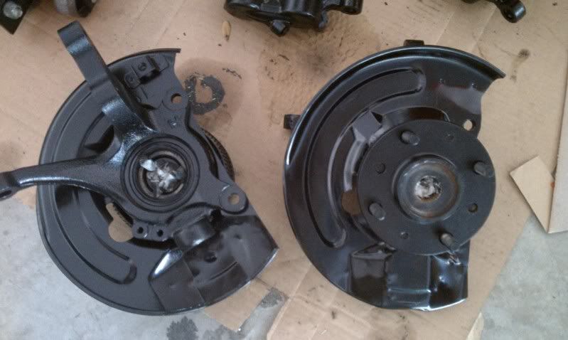

Thanks for the compliments guys. Got my knuckles back from my friend all painted, that was about the only good news.
Attempted to throw these bad boys on and ran into a few problems. First, the bolts that go thru the spindle and hold the caliper brackets on are gone and cannot be found. No biggie, trip to ACE solved that. Second, my f***ing tie rods don't fit /ubbthreads/images/graemlins/mad.gif . I could take a pic but basically the space after the thread will not go thru the knuckle. I keep all car receipts and ill have to look that over again. Third, when I try and tighten down my ball joint nut, the thread keeps spinning. Just did a search and saw that I need to jack up on the control arm then tighten. Two problems down one to go...

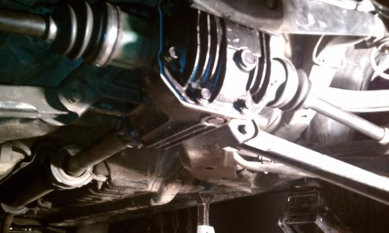

Didn't have a driver side axle so ordered an A1 Cardone axle from Rockauto, sweet! Got the driver side brakes all bolted up and installed the passenger side axle. Now just waiting on the bolts to finish the passenger side brakes, then the axle. Once that's all set I will source a grease gun, bleed the brakes, and I will finally get to start under the hood!

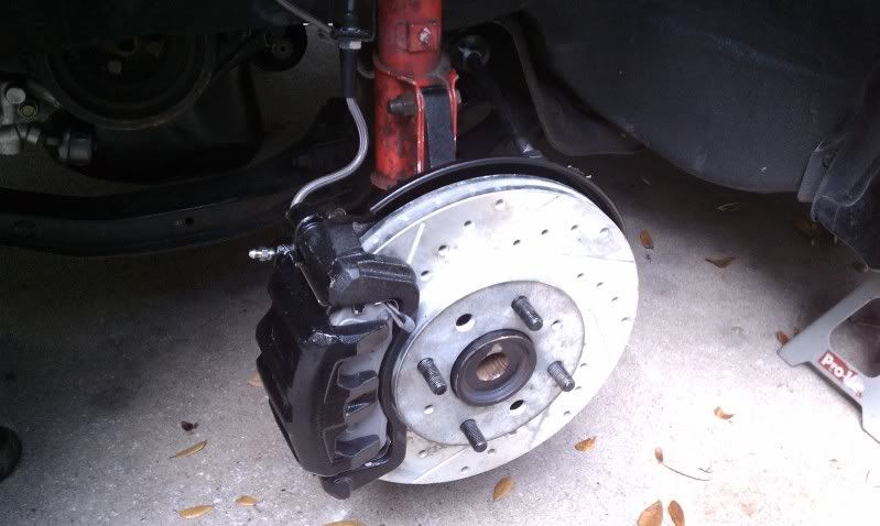

Got a few things done so far today, would like to get so more knocked out since its nice outside. Installed the driver side axle, fixed my loose ebrake cable (although the driver side seems to still not be working...), and bled the front brakes. Here she is after a much needed bath...
