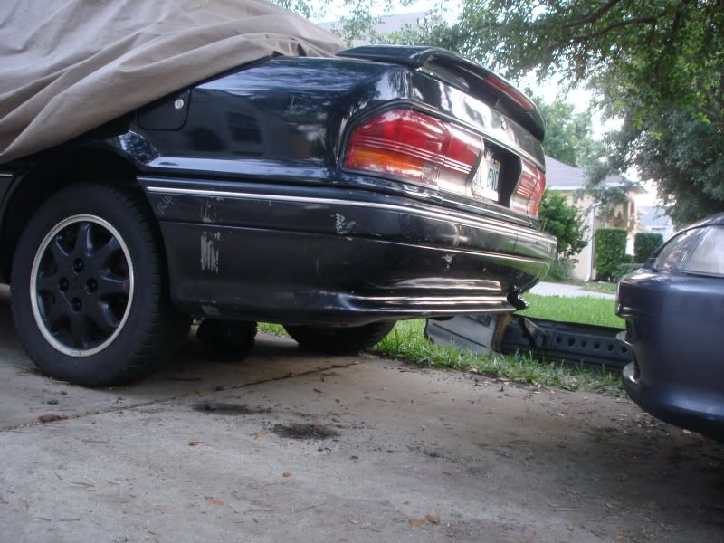

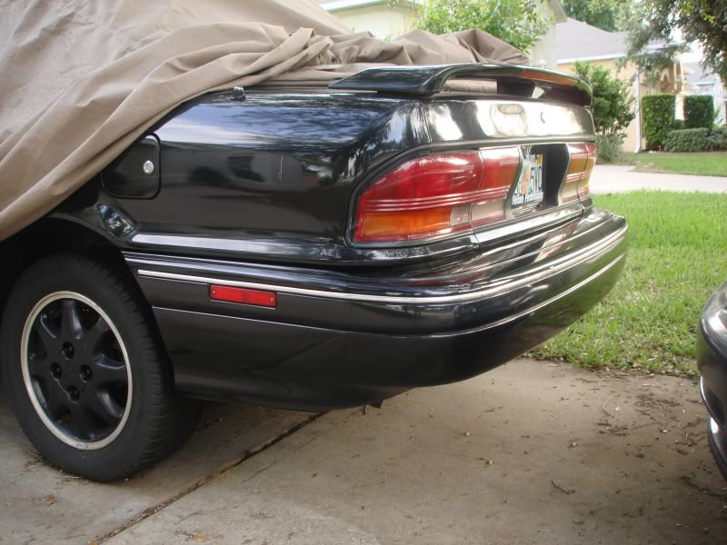

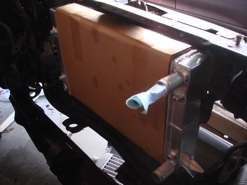

Its been a while since ive updated this, and ive done a few things since then... still need to get the stupid 4 bolt rear in, just being lazy /ubbthreads/images/graemlins/crazy.gif Ive ordered most of the parts, other than a flywheel and flywheel bolts. Evo 9 seats are bolted in as well...
My new afco radiator
Not bolted in yet

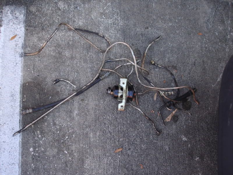

Most of the 4ws crap I removed

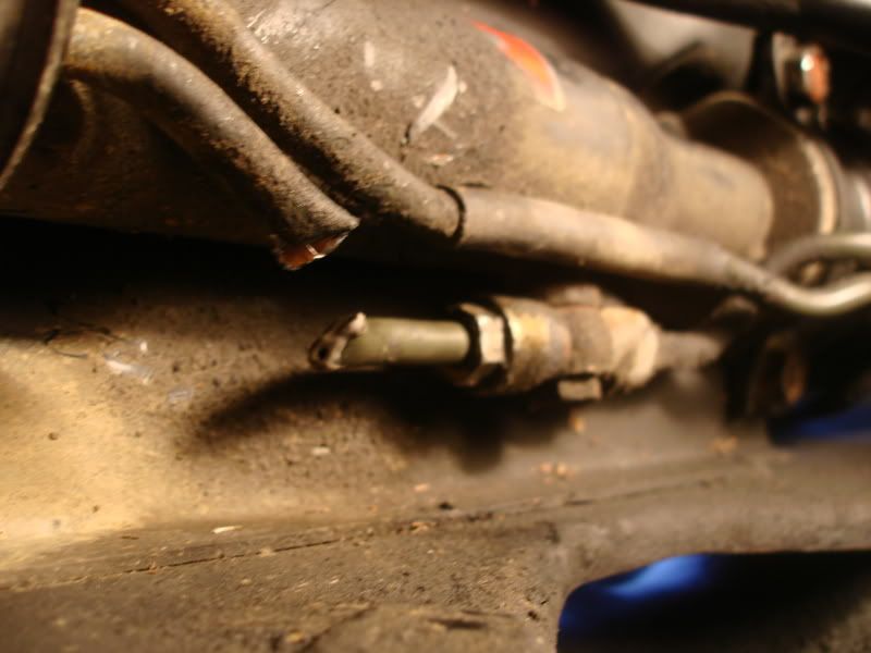

the rest of the 4ws crap and my fuel feed line to fuel filter
If anyone was listening to me talk about how to block off my 4ws, this is the method i came up with

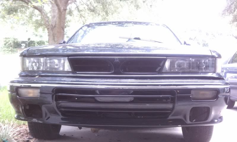

93 headlights i got from the junkyard (thanks james for sending me there!)

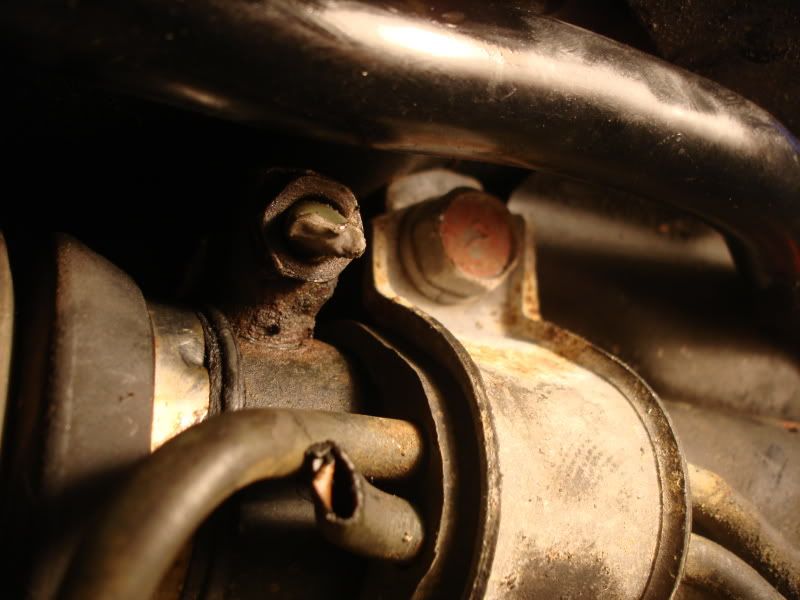

Holy rap your driveshaft yoke is rusted to hell. Please don't put that back in your transfer case. /ubbthreads/images/graemlins/frown.gif
Barnes
Feb 9, 2003
6,249
Richland, WA
I dunno man. It might be shot. Unless you get that sucker smooth the seal won't last long, or seal at all. A t-case recall kit is cheap and includes a brand new yoke and universal joint. You might wanna look into that first.

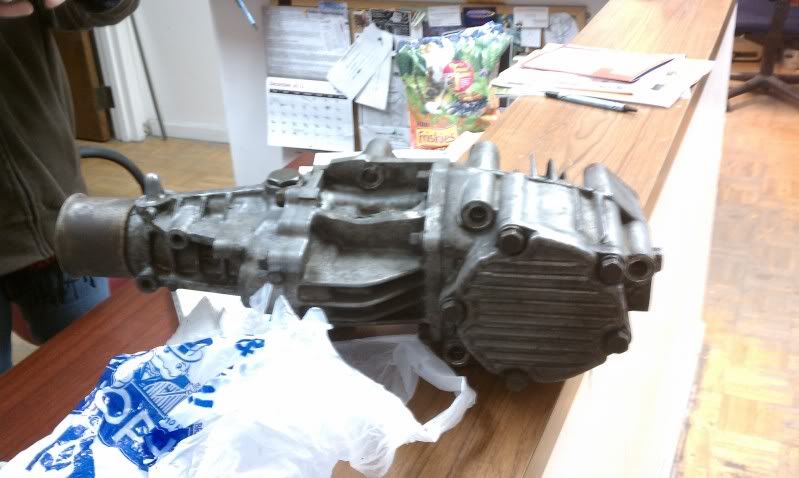

Got my transfer case blasted then found some caliper paint in my roommates garage space. Results?
