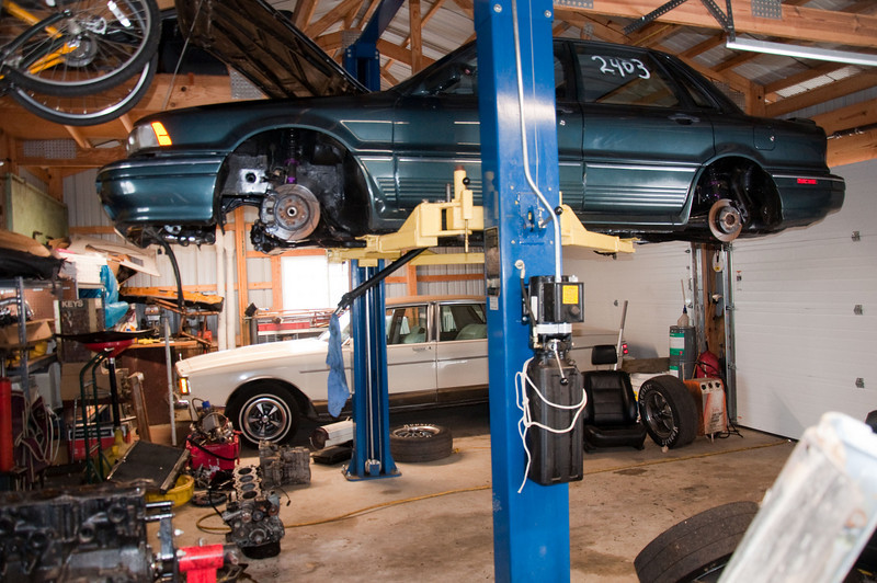

It seems I have effectively hit the reset button on 139, it back on the lift with the engine and trans completely apart. figured I'd start a new thread with progress pictures and keep updating it till the car is on the road again. So typical rebuild thread I guess for posterity.

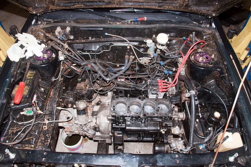

The mess I started with. Rust/coolant residue all over the engine bay from a ruptured radiator end cap on the last run at the dragstrip.

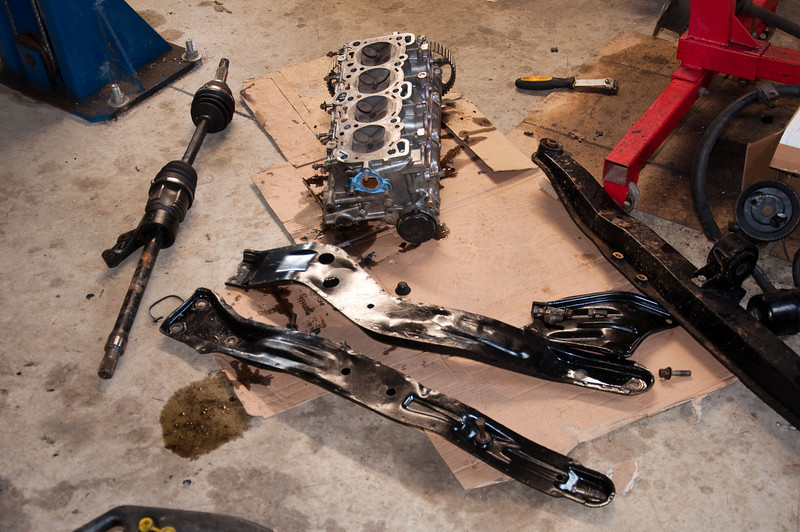

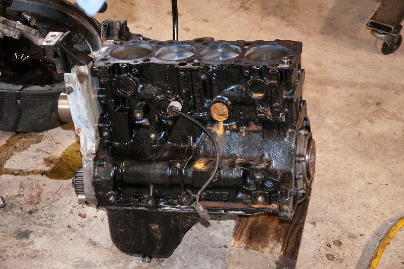

After pulling the head, intake, and turbo system out:

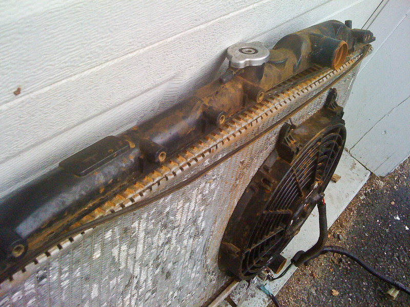

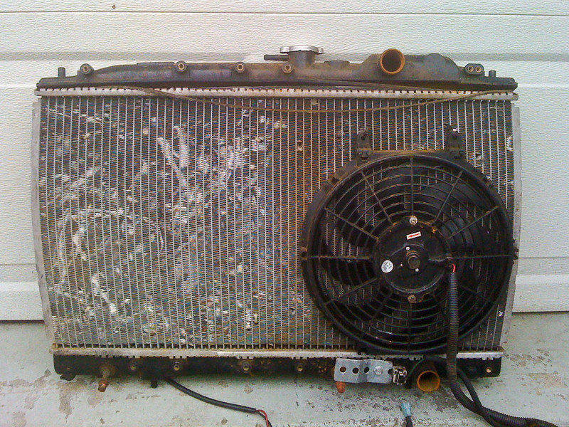

Radiator FAIL. Blown HG pressurized the cooling system enough to pop the end tank right off the radiator in 4th gear.

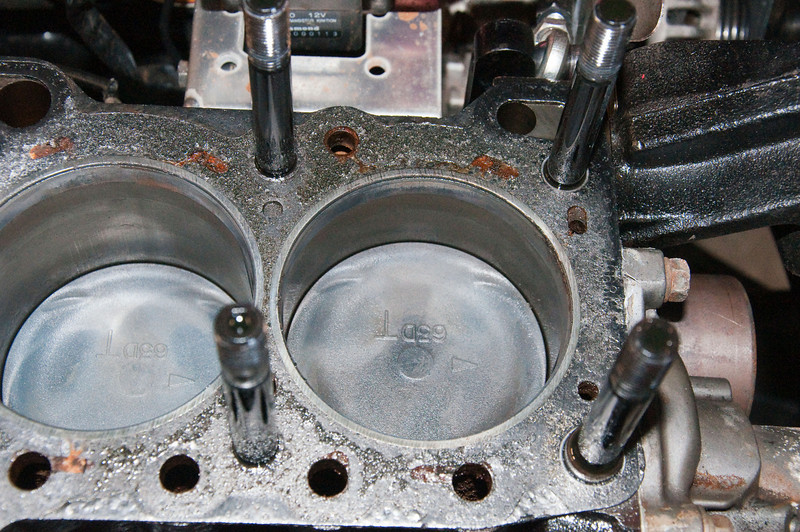

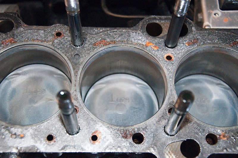

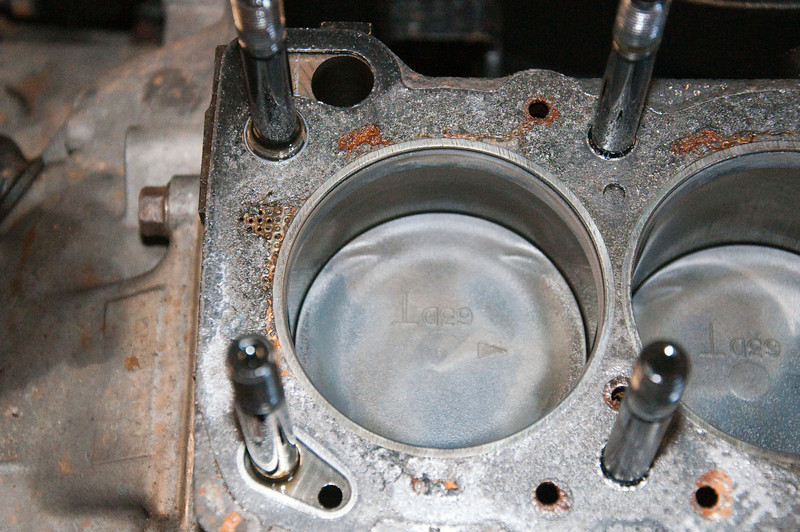

Kicked HG:
Stupid me left straight tap water in the cooling system after that track day while the car sat in the driveway untouched for about a month.
Notice the freeze plug. /ubbthreads/images/graemlins/banghead.gif

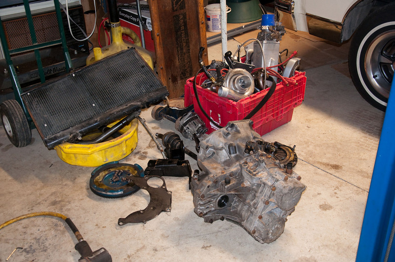

Pile of parts to be cleaned and organized:
#139's "Default Position" /ubbthreads/images/graemlins/rofl.gif

Hopefully early February the car should be back to drivable condition. Funny, seems like it was just yesterday that 139 was up on the lift and completely apart...actually it was only about 550miles ago in August. /ubbthreads/images/graemlins/bawling.gif /ubbthreads/images/graemlins/bawling.gif /ubbthreads/images/graemlins/bawling.gif

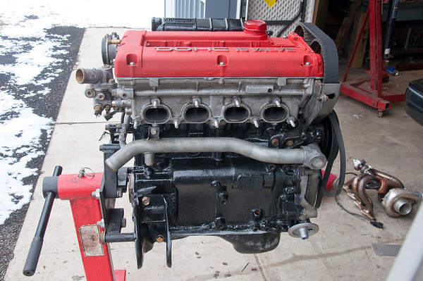

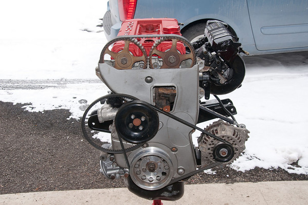

Looks like Im going to change my plan in order to get the car on the road quicker. Im picking up a complete JDM longblock that came out of #78/1000 on monday, Ill swap the oil filter housing and intake manifold and stick it into #139 this week. Hopefully if the temperature isn't too cold and I can work at nights this week, Ill be driving #139 next weekend.
Likely, Ill now have another stock shortblock, head, cams, cyclone intake for sale soon.
NateCrisman
Nov 22, 2008
2,054
Blairstown, NJ

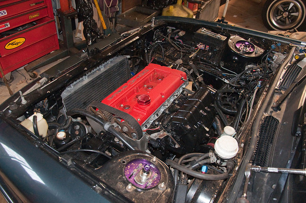

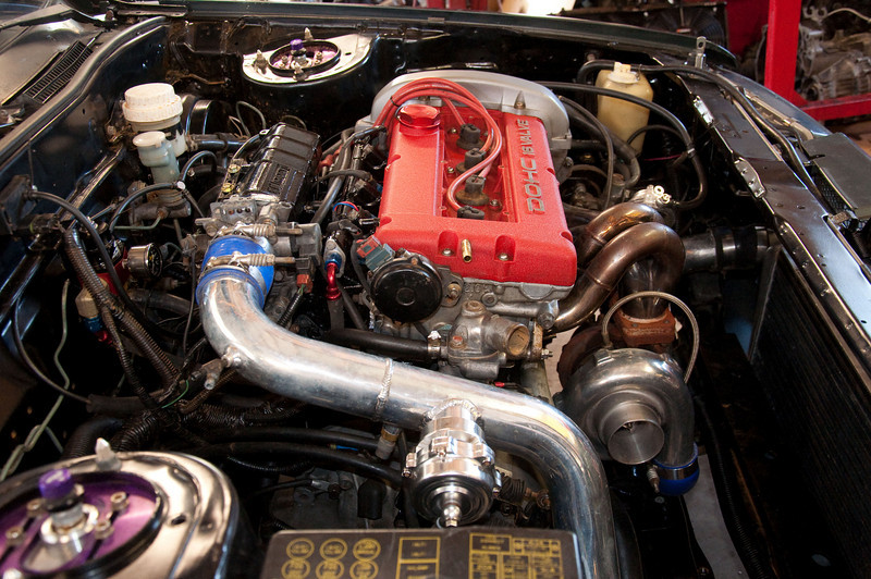

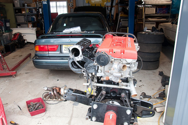

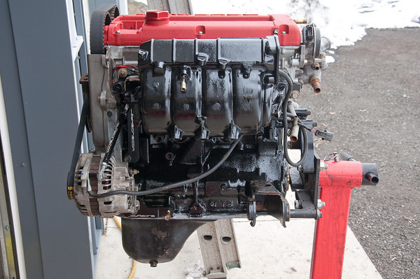

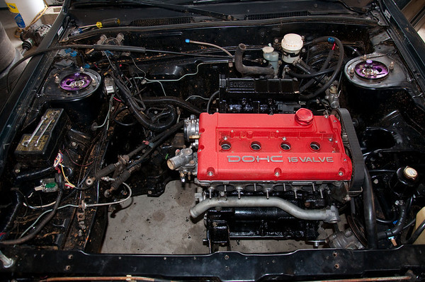

Finished assembly of the longblock today and got it bolted into the car. I ended up using the engine that came out of #255/2000 (the white rusted through VR4 I parted last fall) since the JDM engine mentioned in the above post ended up having a broken rear trans mount ear /ubbthreads/images/graemlins/mad.gif. The longblock is all stock other than a forward facing OFH, ARP head studs, and BSE kit. Went back to OEM cams, intake, and unported/built head compared to the 2009 setup. I used the prothane insert in the front and rear roll stops. The tbelt side and tranny side mounts are good conditon OEM rubber mounts. Hopefully this will knock down some vibration.
Tomorrow or friday I'll bolt in the 50trim T3T4 turbo setup, radiator, hoses, TB, flywheel, ACT clutch, and maybe bolt in the trans. Planning to really hammer on assembly this weekend with hopes of driving it next week.
Im missing fuel injectors as I traded the 750's from this car for a set of 1000's. The 1000's are going on the 1g for 14b/methonal use. Need to get something in the 650-850cc range for pumpgas use on this car now. Otherwise I have all the parts to put the car together as soon as time permits.
Would have had the turbo setup in today, but I forgot that I wanted to drop the spring pressure in the external from 23psi psi springs down to 19-20psi range incase I need to lower boost for bad gas or I need to use a set of smaller injectors for a while. Didn't have the tial chart at the shop, so I'll look up the right spring combo tonight and swap it before bolting the stuff on.
One other thing "to do" that could hold things up, I haven't taken apart the two busted trans in the shop to see if one has a 4spider diff. (one trans has broke bell housing, other has worn syncos....I'd planned to make one good trans out of the pair and use it in my DSM.) I might not get to this for a while, and really it's not any more/less work to swap the center diff with the trans in the car vs the trans on the floor. Well other than it being messier.
The engine bay needs a good wash/wipe down to get all that rust/coolant mess off, but there's no running water in the shop yet with the ground frozen and I really don't want ice all over the engine bay when Im done.
Anyway: few pics

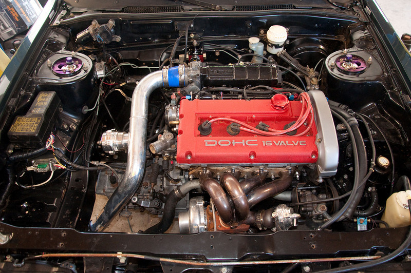

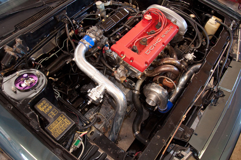

I got a ton of work done on my GVR4 today, I'd say im 2/3 of the way to a running car. PossibleVR4 came up today and gave me a hand getting the trans up and in...again on the first shot.
Ran into a few missing part issues:
[*]Stripped wheel stud..gotta pick one up at napa
[*]Leaking crush washer on 4WS block-off plug...pick some up at napa
[*]Need a 1/16" -27 NPT plug to remove the NOS Fogger from the ic pipe.
[*]Need a 2bolt 2.5" downpipe gasket...again napa
[*]Missing an EGR blockoff plate. Thought I had one, but seems I gave it away.
[*]Need to go to hardware store and hunt through pipe thread bins for oil drain line elbows...my current drain line is HACK and want to replace
[*]Forgot I need a new battery: the walmart lawnmower batt won't take a charge after sitting dead for so long.
[*]Also need to order a rebuild brake master cyl or the rebuild kit from NAPA. mine's leaking BAD between master and the brake booster.
[/list]
Left to do:
[*]Vac lines between external wg and boost control solenoid..I forgot which go where...need to lookup diagram online
[*]Radiator and hoses...I ran out of long zip ties to mount the aftermarket fans.
[*]Driver side axle, Xcase, driveshaft, front wheels.
[*]oil feed and drain lines to the turbo....(want to confirm that the single 1/8" NPT hole on the forward facing housing is post filter oil and not pre-filter before attaching the feed line)
[*]Exhaust system and subframe connectors go back on after fixing the steering rack leak
[*]battery, intake pipe, EGR blockoff plate, and valve cover vent hoses on top
[*]Add fluids
[*]Set base timing & put a pumpgas map back into the ostrich
[/list]
Pics after todays wrenching:
