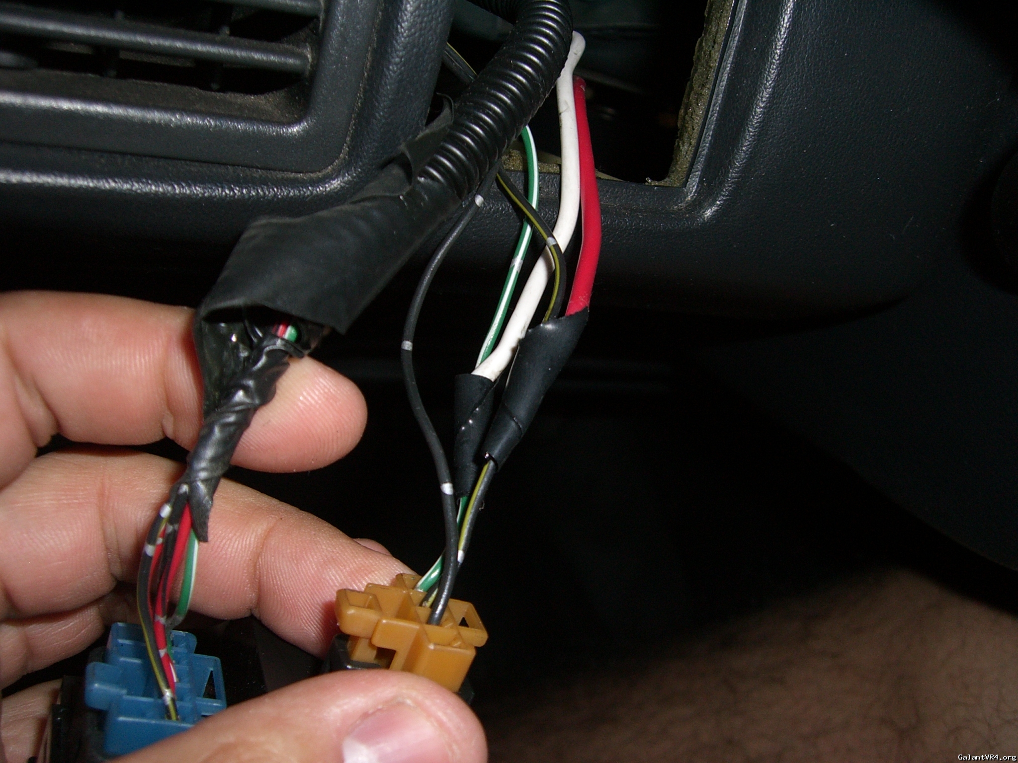

thats it right there if you want it to dim with you cluster
boostedinaz sent me this
