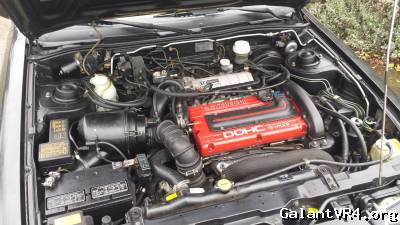

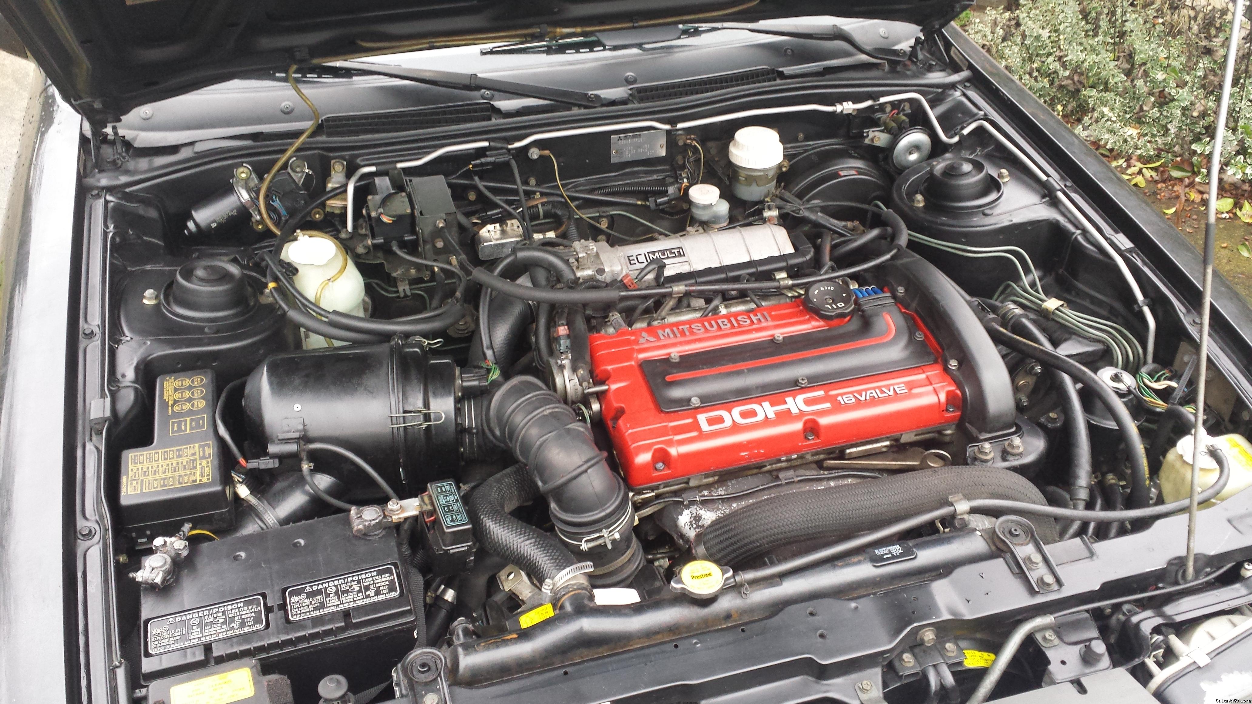

First off, gave it some fresh NGK plugs and wires, then cleaned the engine bay. I forgot to do a before, but here it is now. I plan on doing some more passes to really get the details.

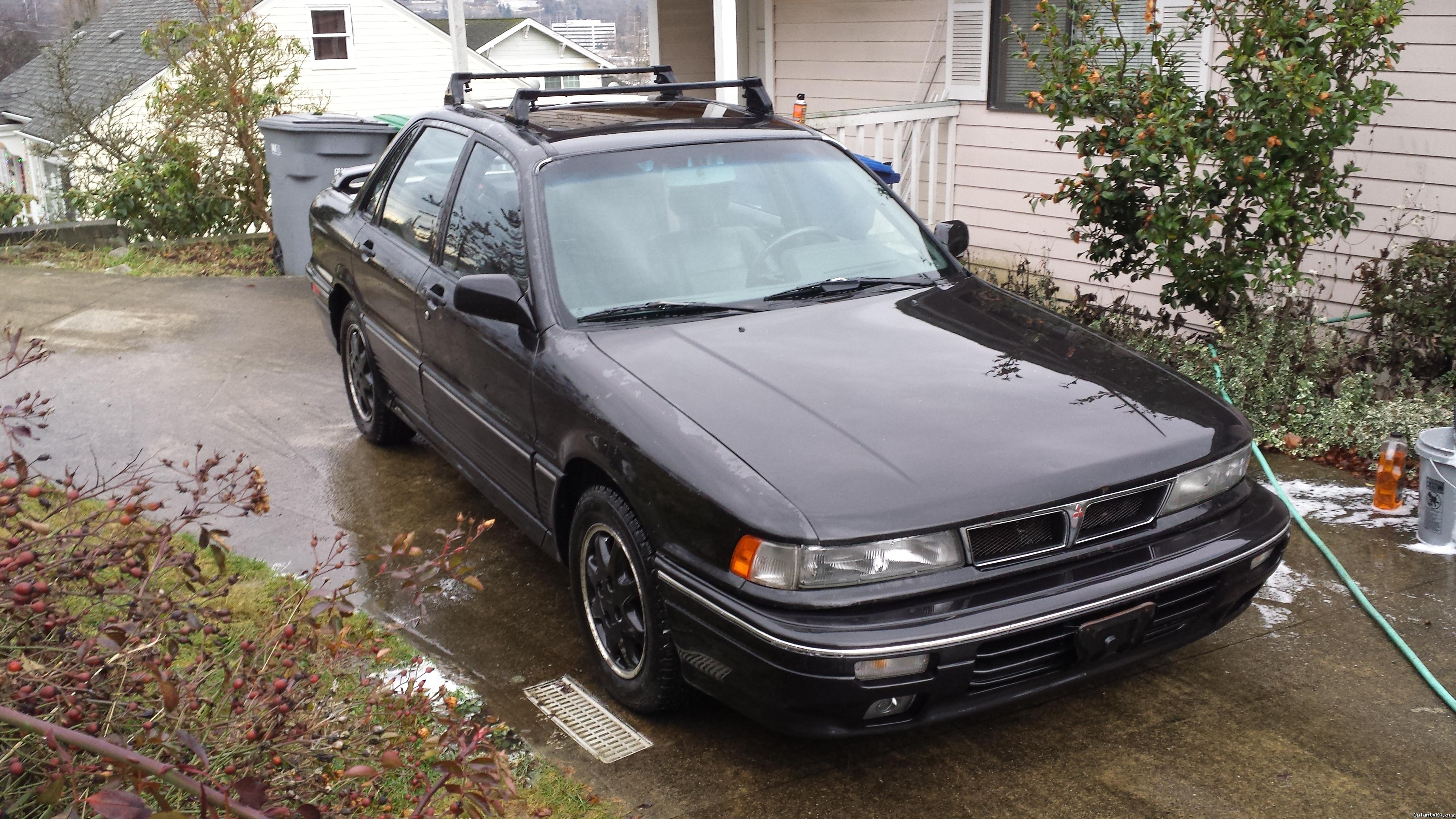

and I gave it a wash. The car really needs a detail, but weather/temperature has prevented that for the meantime. You can see the only flaw in the paint, some clear coat peeling further back on the passenger side + faded trim. The car will be very slick once I get it detailed. /ubbthreads/images/graemlins/cool.gif

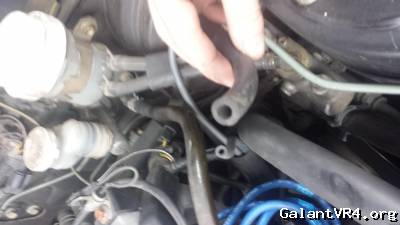

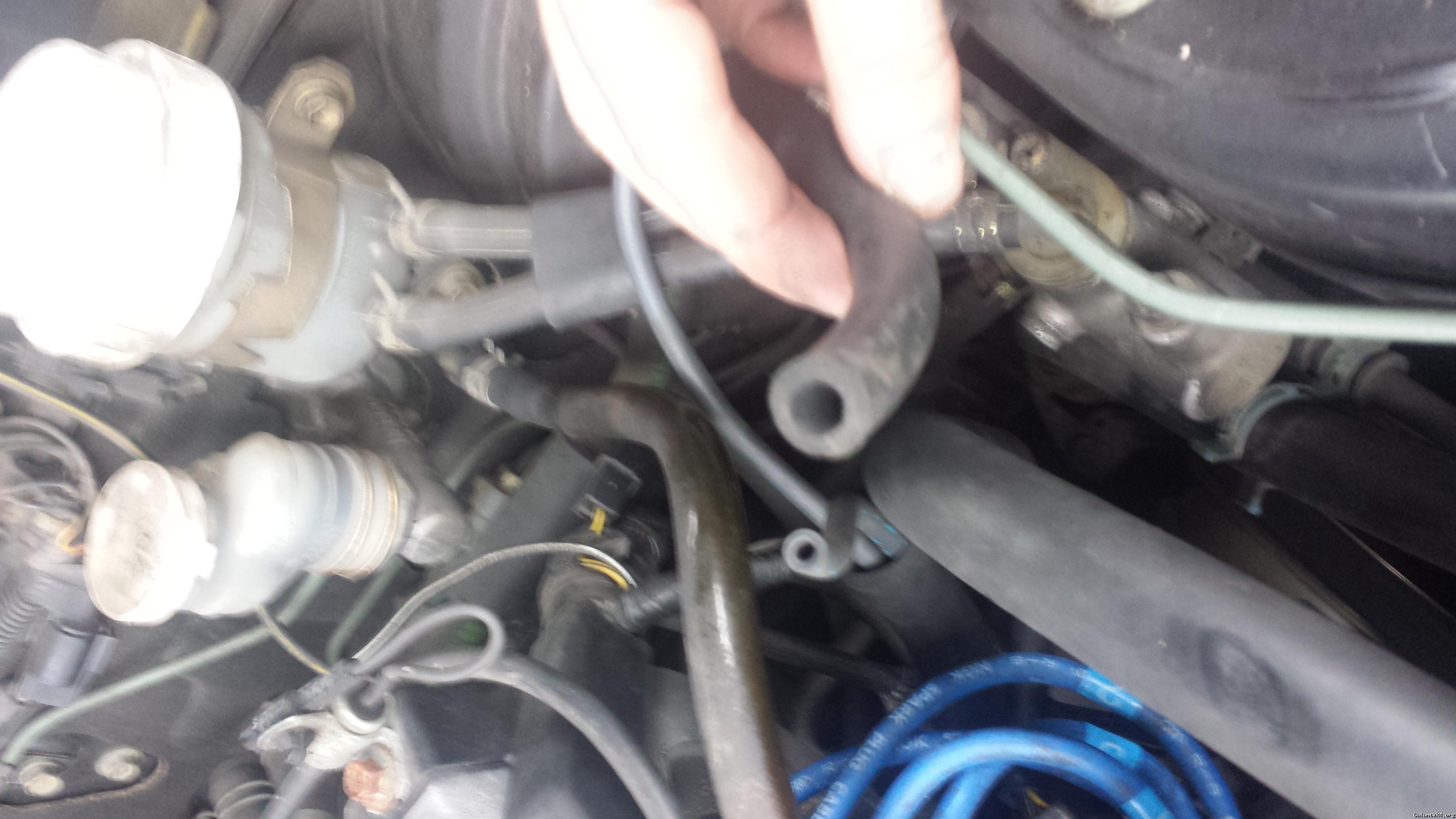

Can anyone tell me what these lines go to? They are not hooked up, I couldn't see where they go. They are coming out from under the coil pack. For now, I just stuck them together. /ubbthreads/images/graemlins/dunno.gif

The hoses go to the fuel pressure and Waste gate control. Also the canister lines. The bracket under the intake will have some hard lines attached to it.

OK, seems the engine has had some vac lines switched around:
-waste gate is running off the nipple on the hard pipe coming off the turbo to the intercooler. Sounds very wrong.
-FPR is running off a nipple towards middle front of the intake manifold
-Boost control solenoid is not fully hooked up, there is a funky loop that doesn't do anything and one line isn't hooked up
EHmotorsports
Sep 25, 2012
1,283
Beaverton
the FPR is ok bypassed but if you were worried about hot starting then you can install it again.
wastgate is ok for now as its just running off of the wastegate spring.
and I looped the boost control solenoid as it was a MAJOR vac leak before so you could get home. and make a deal with that "guy".

Ok thanks for the information! I feel like the car is running a lot better with the new plugs/wires and capping those other two extra vacuum lines. Car seems to still idle a bit high, but I can deal with that for now.
Also I don't think the car has a charcoal cannister anymore, looked around for it but didn't see one.
