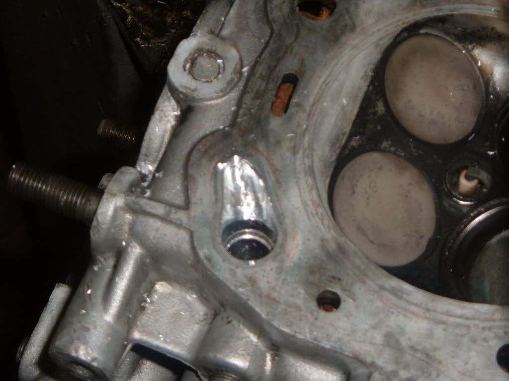

You guys need to port the oil feed for the lifters. revised lifters are just a band aid. I'm running 1g lifters in my wagon without a single tick, my room mate has 1g lifters in his 1g laser, no tick, ever. both ported oil feeds.

Why do you need to replace yours? If it's because of lifter tick on your stock ones, alpha is right. A little porting and your all good with the stock ones. I didn't even get tick on cold start ups.

Wrong.
The stock feed is very minimal in terms of flow, if the head has EVER been resurfaced, that feed has become even smaller. if the engine is high in miles and never had any engine work done, that feed is likely full of oil residue, coked up, baked in, ancient oil.
This isnt some 'trick' this is a legitimate fix. But, it's also free, thus you're subject to vendors rejecting the method.
