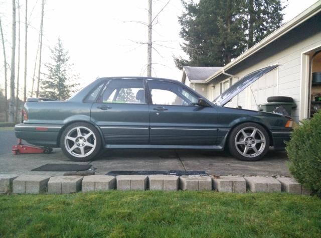

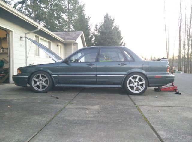

Galant VR-4 org Post #: 1202247 posted 02/21/15 08:19 PM     Remind Me!  Send Private Message   Edit Post
ok, front went ok. did get in a little fight with the steering rack coupler. and a HUGE fight with some wheel studs. threads must have been fubar'ed from when the hubs where pulled?? or just to begin with (couple have M's stamped in them). so i antisiezed them and ran some spare random lug nuts (look like steel honda hub cap style) down all them to make sure the threads where good and that they where fully seated in the hubs. ran to the junkyard (yup, it was closer) and snagged up a few and a power steering tank that i now need a cap for.
didnt take any pics of my working, i was too busy working. lol. maybe ill remember to take a couple pics tomorrow when i pull the wheel off one more time.
so i need to:
put shockproof in t-case
drain diff? fill with shockproof
need 1 axle cotter pin
2 tie rod cotter pins
gear oil pump
power steering cap
tighten axle nuts
bed in brakes
go get alignment
oh and thanks again to 'bobdole' for hooking me up with the BC coilovers and brakes! hope to get some brake lines and hood struts soon...

Galant VR-4 org Post #: 1202366 posted 02/22/15 08:53 PM     Remind Me!  Send Private Message   Edit Post
i spent a lot of money and time....and i dont care, car drives awesome all the issues i have had seem to be gone. got the car aligned. front has -1.8 camber rear was like -2.6. i have a little bit of bounce in the front suspension, think im going to give a couple clicks firmer into the coilovers, but other than that they are awesome. brakes feel good. car looks good if i dont say so myself, and others seem to dig it.
im happy right now
once that wears off i do have a big turbo to put on.
