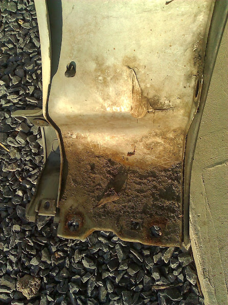

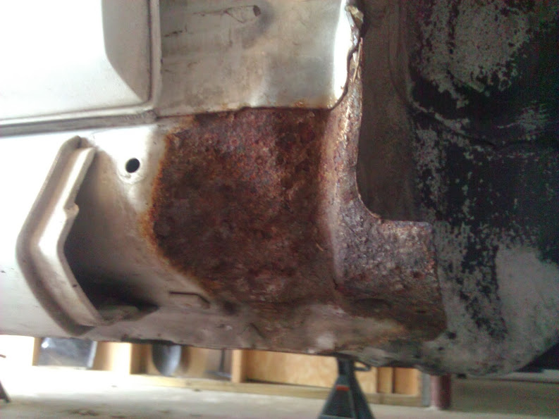

^Agreed. It's more likely your mechanic tensioned the belt wrong, not that you have a tensioner failing. I've never seen a new tensioner fail right out of the box, even off brand parts store units. In addition, I just don't see how it's possible for the cam to only slip 3 teeth and the oil pump/balance shaft to be out 180. The facts suggest he screwed up the install, and there's no way I'd be paying for another tensioner if I were you.
Quoting G:
Looks nice, clean behind the quarter panel and front door jambs.
Just to clarify, I believe G is referring to clean where the front fender meets the body behind the wheel well. You need to actually remove the front fenders to clean this area. sh*t builds up in there over time, and causes unseen rust issues. You have to remove the fender liners as well, so I'd clean behind them too while they are off.
