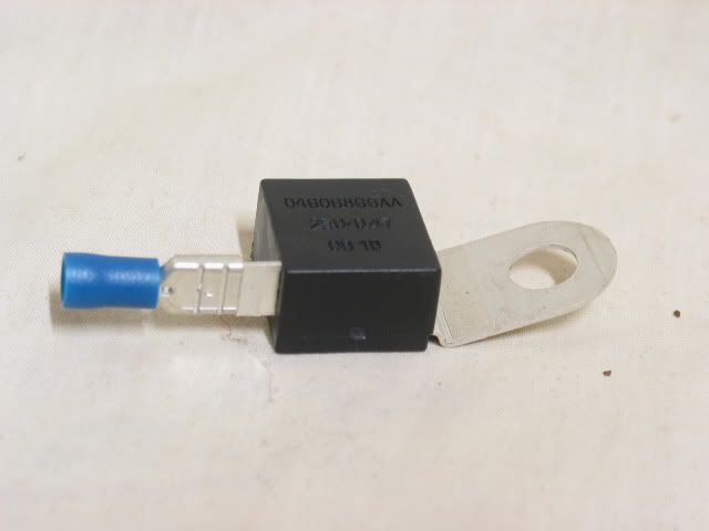

In case anyone's interested, here's the OE Intrepid and 300M 2.7L and 3.5L ignition capacitor, one of which mounts adjacent a COP module on each of the two cylinder heads.
The printed rating is identical to the one in the OE coil-pack assembly (.47uF/250V), but the package is different. The ignition capacitor was $15 from the local Dodge establishment ($20 online), but no doubt cheaper at a junkyard !

Quoting TrevorS:
I case anyone's interested, here's the OE Intrepid and 300M 2.7L and 3.5L ignition capacitor, one of which mounts adjacent a COP module on each of the two cylinder heads.
Nice find!
I like what you're doing here, Trevor.
Sourcing matching components is one of the "secrets" to making one off stuff work.
... please be sure to insulate that female terminal/connector where it plugs onto the condensor body well!
A little heat shrink over the whole terminal will do the trick.
Please keep the thread updated with your progress!
