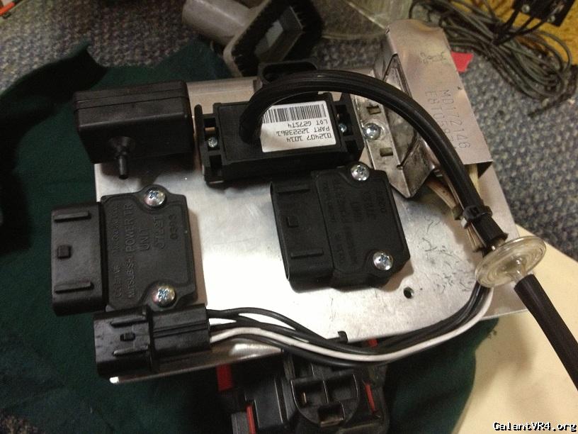

This is a great thread. So much info. I am interested in this as I have just started a upgrade on my car.
I am fitting an AMS VSR intake manifold and have decided to go COP to keep the engine looking neat.
I was worried about the ignition system and hopefully this will be the solution.
I have built a plate to mount my igniter , injector resistor, map sensor and boost guage sensor. I played with it today and it will also fit my spare igniter.
I am going to wire second igniter in as I am also rewiring the engine harness. I have all the parts I need just sitting in the shed.
Thanks to the guys testing this for real answers .
