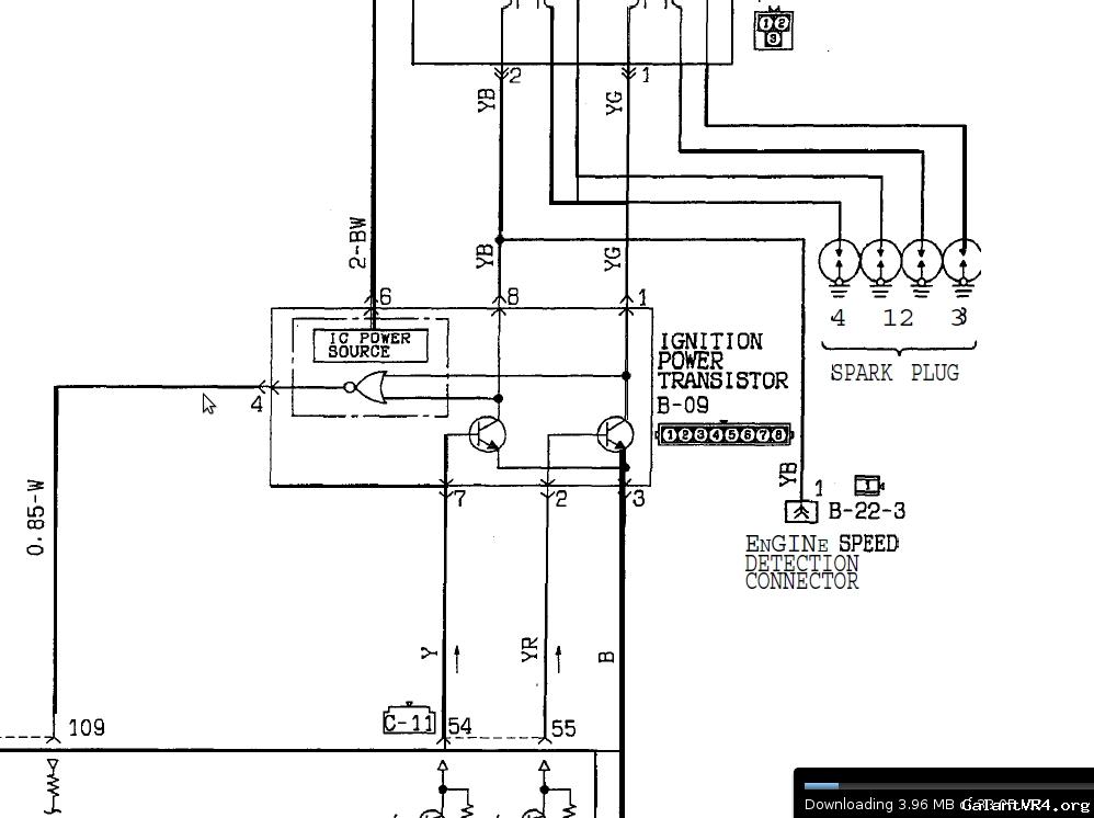

My current plan is to attempt to run a '90 Power TR (J122) in parallel with the '91+ Power TR (J722T) that I already have. My reasoning for this is that both units should satisfy the same energy demands but the '90 unit doesn't have the integrated tacho module which will (hopefully) avoid some confusion in terms of which unit is talking back to the ECU. Also, I have an extra '90 in my hand from the Talon that I parted and I figure the harness for it should be easier to find since people cut them out when switching to '91+ ignition setups. My only concern is getting the wiring to work out so I'm on to trying to understand the circuit diagrams...
According to the '90 FSM, the 5-pin power transistor operates as a variable ground for the primary coils which are always powered. The ecu sends a signal to pins 2 and 5 which close the pathways from pins 1 and 6 (respectively) to pin 3 which is a common ground.
By contrast, the '91+ power transistor appears to have two more pins which work in conjunction as the tacho module...
It looks like 7 and 2 open pathways from 8 and 1 (respectively) to 3 which is common ground. Then, there seams to be an on-board IC which buffers the signals from 8 and 1 to create an output signal. 6 would seem to be the VCC for this IC.
So, as far as I can tell wiring the '90 in parallel with the '91+ is as simple pin-mapping (2,5,1,6,3) from the '90 onto (7,2,8,1,3) on the '91+. This should essentially double the current rating of the "effective" system while leaving it's down-stream functionality untouched.
Anybody have a '90 plug/harness that they want to donate to this project?

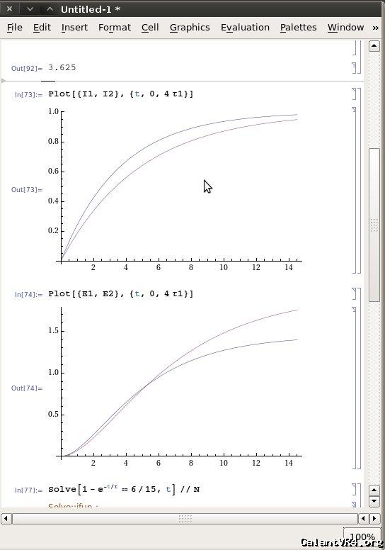

I just got back from the lab where I bench tested my current COP setup (intrepid coils wired in series) as well as my spare OEM coil-pack.
Intrepid coils in series:
Primary Resistance: 0.8 Ohm
Primary Inductance: 2.9 mH
OEM coils:
Primary Inductance: 3.9 mH
As you can see, the intrepid coils actually match the intended resistance of the OEM coils when wired in series. That means that, given sufficient charge time, both configurations would come to the same final current value of 15 Amps (I = V/R = 12v/0.8Ohm). Now, somebody quoted that the spec'd current is only 6 amps. This corresponds to a charge time of roughly (1/2) the characteristic time. So, if 6 Amps is in fact the typical current then the dwell time of the ECU is t=(1/2)L/R or ~1.75ms.
Now for the interesting bit...
I plotted the current as a function of time for both configurations (found by I=Io * (1-e^(t/tao))) and then plotted the stored energy for this current for each configuration (found by E = (1/2) L I^2). The results clearly show that for charge times shorter than the characteristic time of the OEM coils (just under 4 ms), the intrepid coils (with lower inductance) actual have a HIGHER stored energy... as the charge time decreases the effect is increased... as the charge time increases both currents move toward their asymptote of 15A and the OEM coils ultimately store ~33% more energy... but it takes a while. So, what this really tells us is that we need to know the ACTUAL dwell time that the ECU uses in order to state definitively whether the intrepid coils have a weaker spark when wired in series. But, for anything shorter than about 6 ms it's at least a wash and at best the intrepid coils have more energy than the OEM coil pack. One thing is for CERTAIN though! Wired in parallel, the intrepid coils would KILL the OEM coils in stored energy.
But, of course, there's more to the story. I wasn't able to measure the secondary inductance so I don't know the winding ratio. That means that we can't say for sure at this point how the energy is delivered. It may be that the intrepid coils have a longer duration spark that's not as hot...
EDIT: According to stealth316 the charge time of 3si motors is about 4ms and the current is regulated to cap at 6 amps. If that's true for our system as well then the intrepid coils would reach 6 amps faster but would be capped there just the same as the OEM coils. At that point, the stored energy of the intrepid coils would be roughly 75% of what's in the OEM coils. So, just plugging in a COP setup with coils in series and no other modifications you can expect to get about 75% of the stored energy as you do in an OEM setup. Running two igniters in parallel would raise the cap to 12 amps. Over 4ms the current through the intrepid coils would reach almost that value (11 amps). That means that the Intrepid coils would win again (even in series) for times less than 6 ms and would be a significant improvement over the OEM configuration (with a single igniter). Running the coils in parallel has no significant advantage at this point ( so long as the charge time never goes below 4ms) since the charge time is already enough to reach the capped current when run in series. If the dwell time allotted were to drop to below 4ms then the coils would no longer be reaching their capped current value and you'd start to lose energy. Run in parallel they reach the capped current in 1/4 the time so the dwell time becomes MORE than enough. This could itself be an issue as excessive dwell times create more heat in the coils and may lead to failure. One very useful thing to know at this point would be the rated current through the Intrepid ignition system. It may be that 11 amps is just way too much for these coils...

The 91+ ignitor actually only has 7 wires if I recall. One is absent so the only extra wire would be the white tach wire.
My concern is wiring the ignitors in parallel is going to put a strain on whatever part of the ECU is powering it or will the extra power be isolated past the ignitor essentially using the ignitors as transformers of sort?
I am going to take my COP ignition off tonight and have a look see at how it is wired. I believe it is wired power to 1, out 1 to 4, and 4 to ground so a series configuration. 2 and 3 are set the same way. I have an extra ignitor in the garage and a harness for it. If you have a diagram wiring them in parallel I'll be happy to pull out the gun and solder it up to test it.
I am trying to visualize how to do that but I can't imagine it in my head. Are you taking output from one ignitor and feeding it to the input of the other?
What is the lim fac for wiring the coils in parallel? Possible overheat of the ignitor?
/brox
For running the igniters in parallel I'm talking about take the ECU signal for 1/4 and 2/3 and splicing it to both igniters and then splicing the igniter outputs for those cylinders back together again. If you think of the igniters as relays, then I'm just talking about having both relays run off of the same signal and then having their outputs tied together to drive the same load. It is possible that two igniters could put extra load on the ECU but I highly doubt it. Normally a transistor switch draws effectively no current (on the order of micro-amps) so that shouldn't be an issue.

It's not so much dropping the resistance as it is sharing the duty. The coils will see the same voltage and provide the same resistance regardless of the igniter configuration. Having two igniters just means that each only has to supply half the current.
Now, the effects of that are a little unclear because I still can't find out for certain whether the igniters are current-regulated. As I mentioned, the stock coils reach 6 amps after only 2(ish) ms. If the dwell time is more like 4 or 5 ms (as suggested) then the current would rise to more like 15 amps. Now, if it's also true that the stock system is designed to have 6 amps through the coils... then the igniter itself must have some kind of internal regulation that keeps the current at or below 6 amps.
So, the result of running two igniters depends on whether they are individually current controlled. If the ARE, then doubling them up effectively doubles the max current that the coils are allowed to pull. This would raise the stored energy without having the run the coils in parallel. If the aren't, then the coils pull as much as they want already and doubling them up just lets us run the coils in a different configuration (to draw more power) without burning the igniters out (since they presumably have a max current rating).
But, as I showed above, if the igniters aren't current capped at 6 amps, then for charge times of less than 6 ms the intrepid coils already store more energy then OEM so there's no point in messing with anything... we're already winning. On the other hand, if the igniters ARE capped, then doubling them up raises the max current to 12 amps (which the intrepid coils will pull after 4 ms even without putting them in parallel) and triples the stored energy.
This leads me to conclude that there is no reason to rewire the coils themselves for parallel duty. The only improvement would instead come from doubling the igniters (in parallel) which will increase the energy of the spark by a factor of 3 if they're already current limited to 6 amps. If they're not, then it won't do anything.
