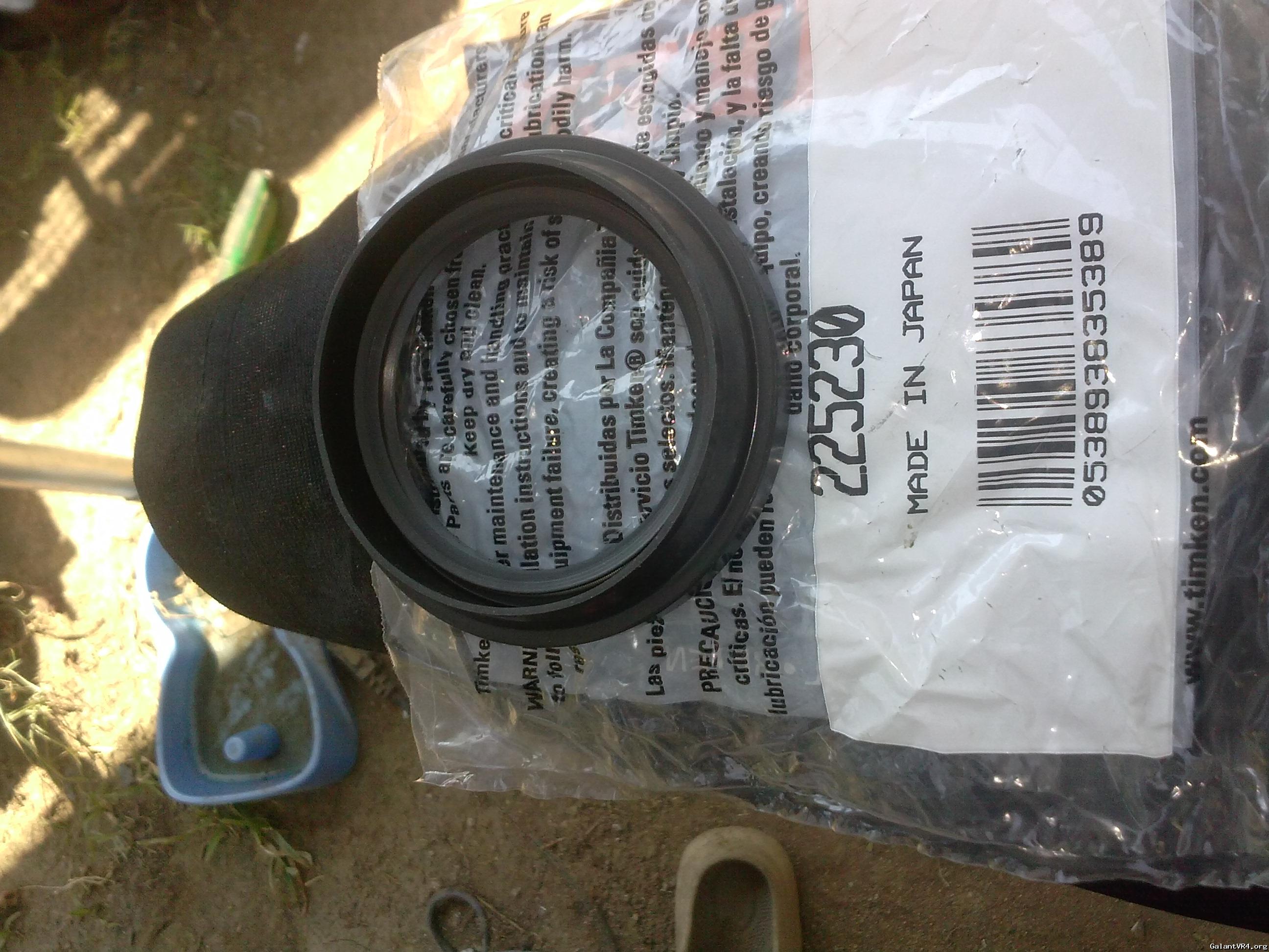

I have a new OEM front wheel bearing and Timken inner seal made in Japan if you wanna buy them or trade for parts .

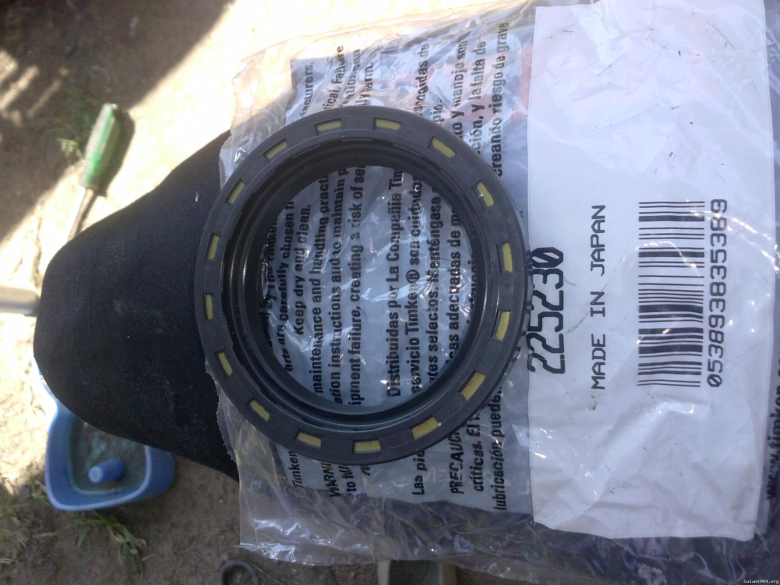

I bought the seals of rockauto and personally like the Timken seals alot better than the SKF seals they look like an upgraded version of the OEM seals ill see if can post a pic.

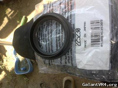

Here the Timken seal I was talking bout cheaper than an OEM seal and looks and feels allot better and designed better IMHO nothing wrong with the SKF seals only reason i changed mine is because I damaged mine while moving stuff around.

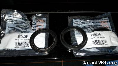

I just got these exact seals a few days ago from rockauto. I got the bearings pressed in, got the inner seal installed, then went to put one of these in, and noticed that the extended lip on the inside was going to be touching the ball bearings and possibly fold under and touch the bearing race as well. It's been a long while since the photos above were posted. Are you still on here? Did you install those seals? Did you notice they would interfere with the bearing?
I don't think i'll be using these, as they do not appear to be the correct seal for this application. Maybe they're for a REAR wheel bearing?

Timken 225230 is listed in their catalog and on rockauto for outer front wheel seal, but this simply has too much rubber on the inner part. The oem seal i pulled out looks nothing like this. It looks just like any other standard double lip seal such as you'd find on a crankshaft front or rear main.

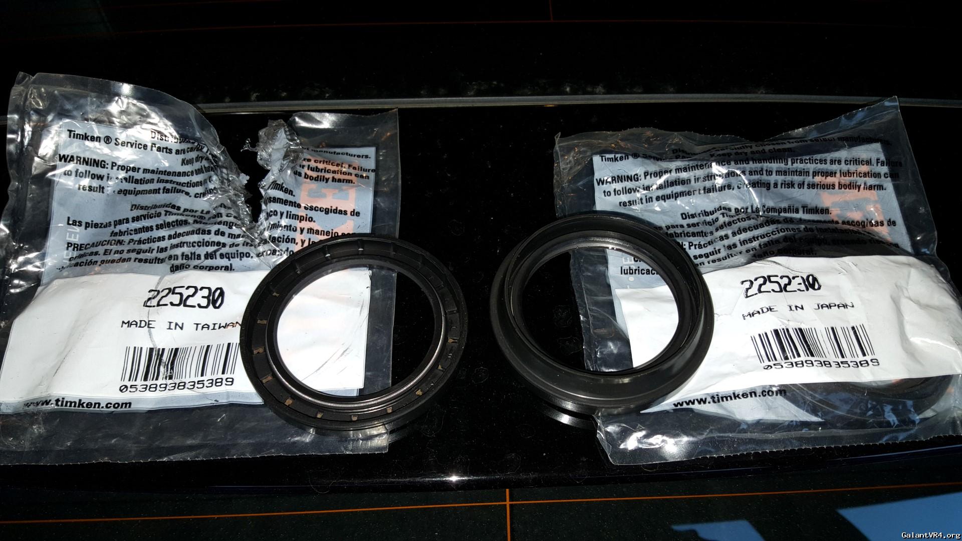

Well, i found out.. THOSE are the wrong seals. Those aren't even actually TIMKEN product. I looked closely at the ones i got first in the timken package, and they're NOK seals with a different P/N on them.
AutoZone had 2 in stock. They bring them out, and guy hands me a seal like i already have, and the RIGHT seal. Both with the same P/N. Only difference is the proper seal says "Made in Taiwan" on the wrapper, and the wrong one (NOK) says "Made in Japan" on the wrapper. So since they only had one "right" seal, i bought that, and then went over to O'reilly and got another one. It's a "National" seal, but it will work.
I got my wheel bearings all back together and my brakes mounted, finally. Now i have two NOK seals that are useless because Timken apparently fucked up. Considering they cost a total of about $7 from Rockauto, it's not really worth the time and effort to return them.
