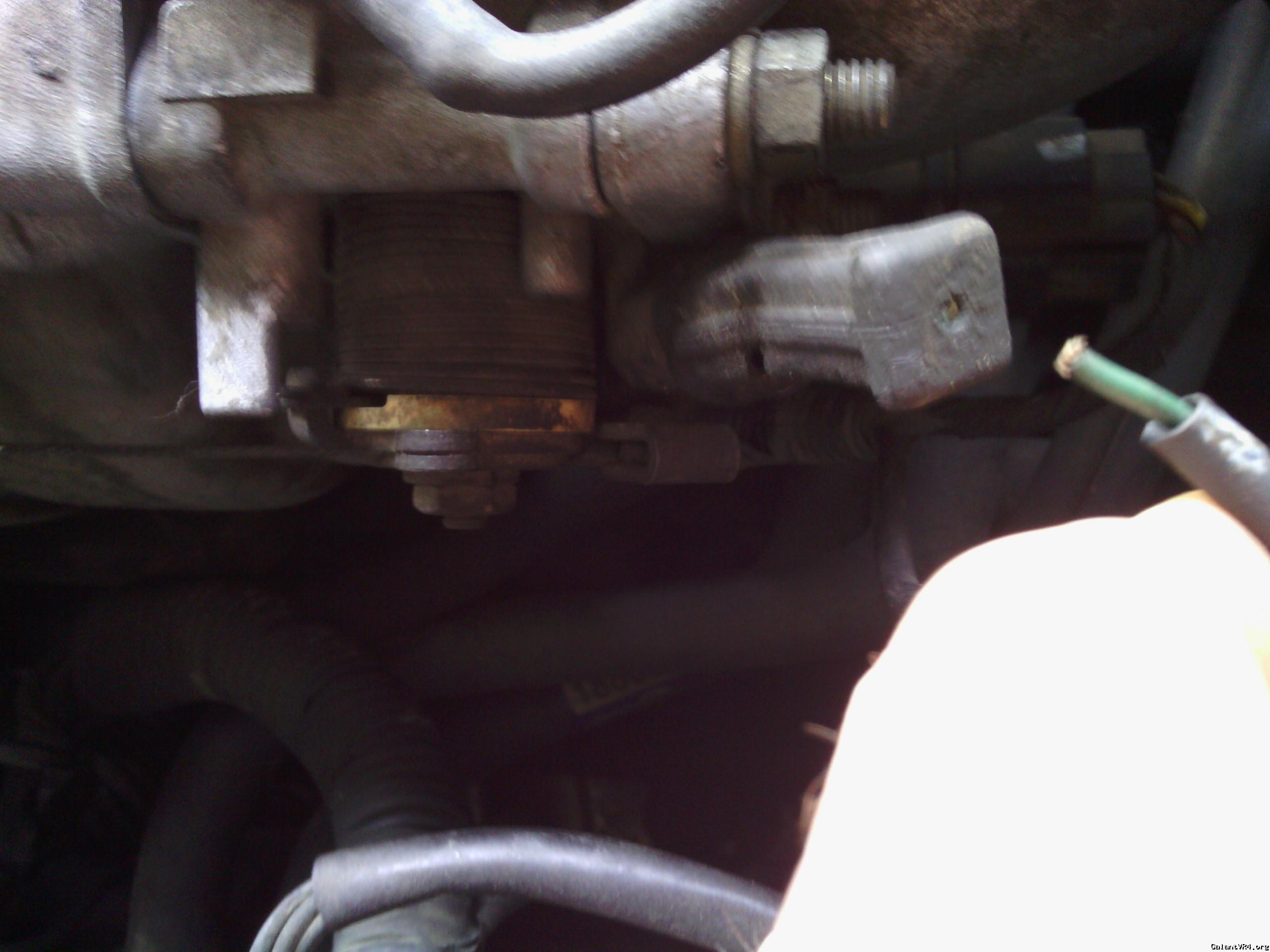

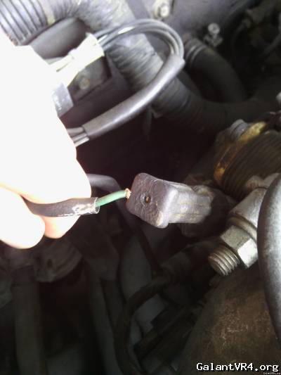

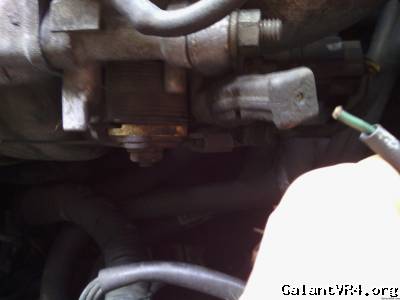

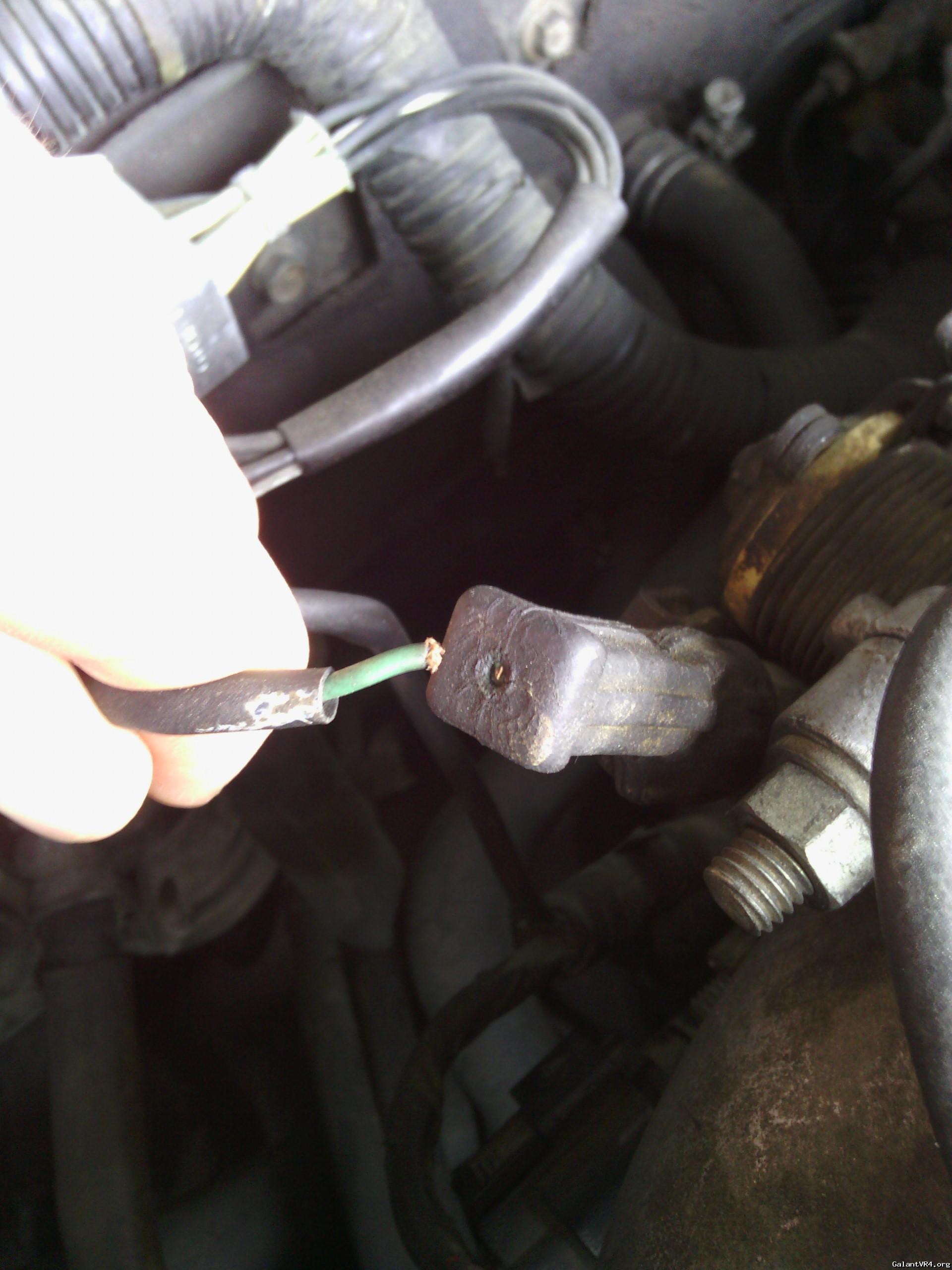

Also, if your idle isn't good, there are a number of things that could be wrong. Obviously you need to fix that wire to the throttle stop switch, but there could be other issues. The throttle stop switch dould be bad. You can test it with a voltmeter. You can also test or ISC (or IAC) motor, which is the thing in the PM I sent you, with a voltmetmer. If either is bad then those should be replaced.
