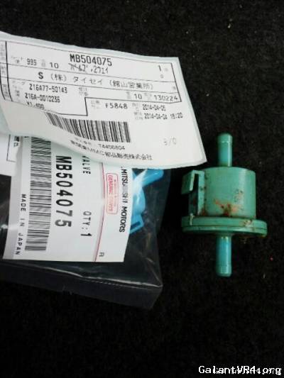

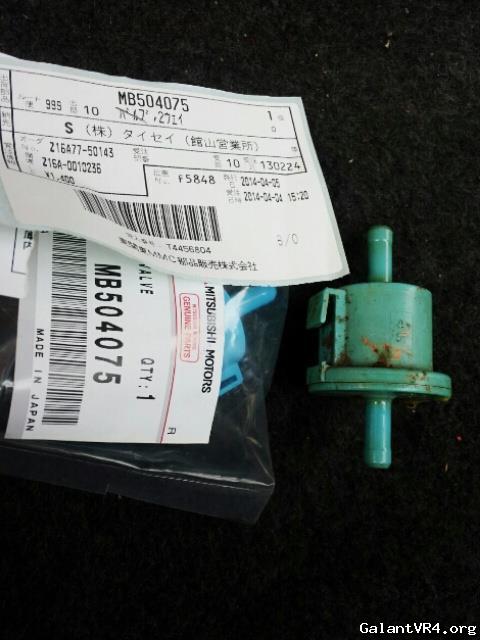

IRC, that isn't a filter but a check valve. Prevents fuel vapors from returning to the tank. Any check valve that has the correct hose size will also work fine if you can't find the OE part.
Thanks bud. Yeah, it looks like a check valve.
Would like to find the oem piece if possible. I'm sure someone has a spare sitting in a pile somewhere. I tossed most of my extra junk. /ubbthreads/images/graemlins/banghead.gif
