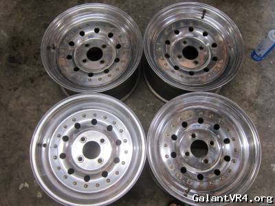

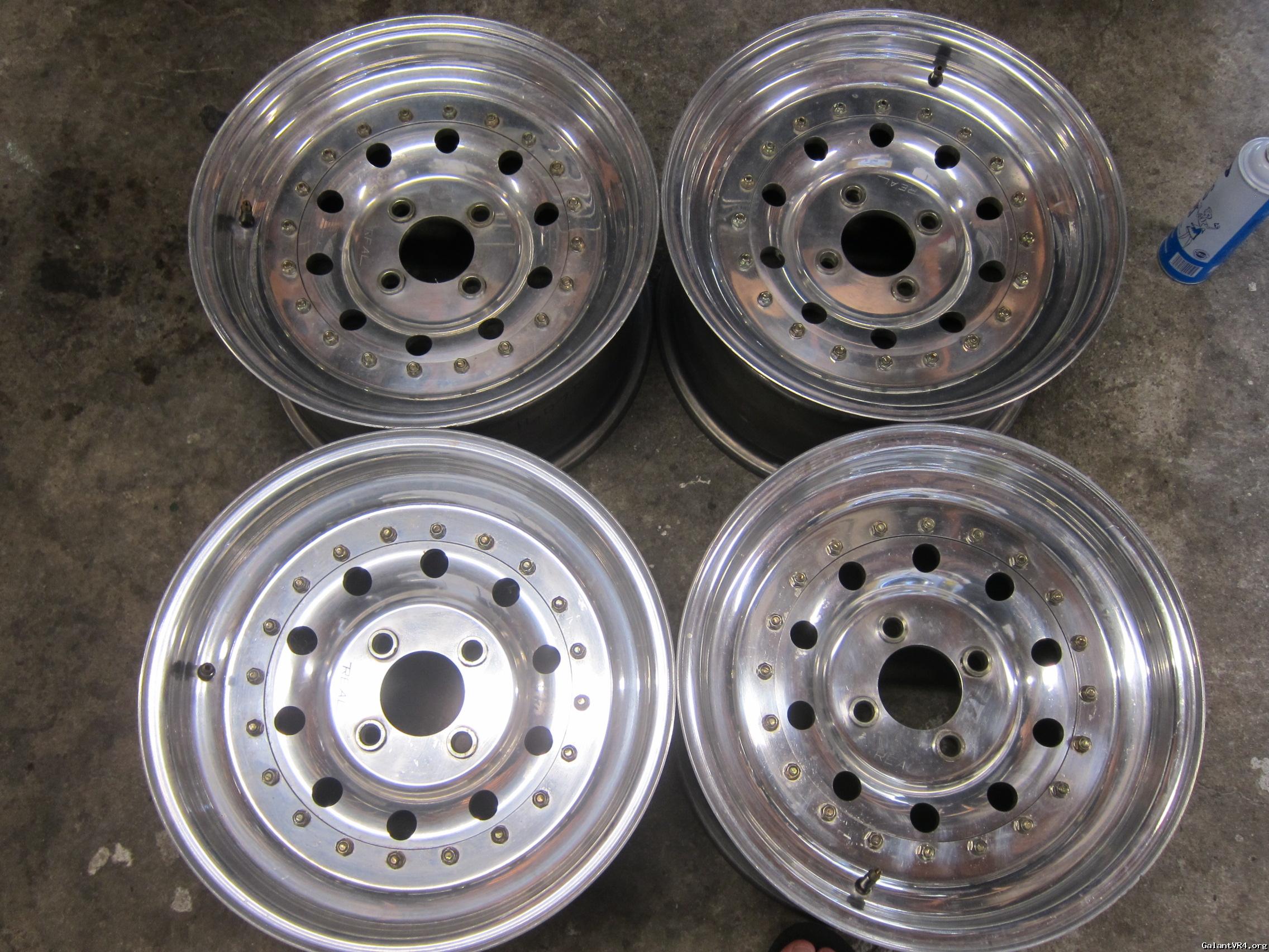

they look to be close to zero offset plus there doesn't look to be much room for brake calipers on those rims. RWD cars tend to have the disc and caliper a bit inboard and therefore the rims can get away with being flat-faced, yet wont clear brake setups on primarily FWD/AWD cars.
