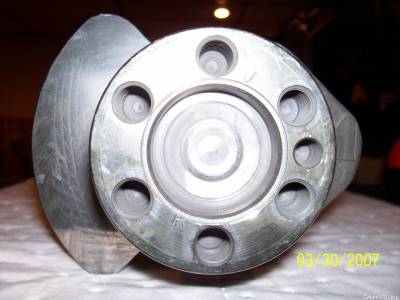

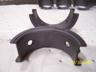

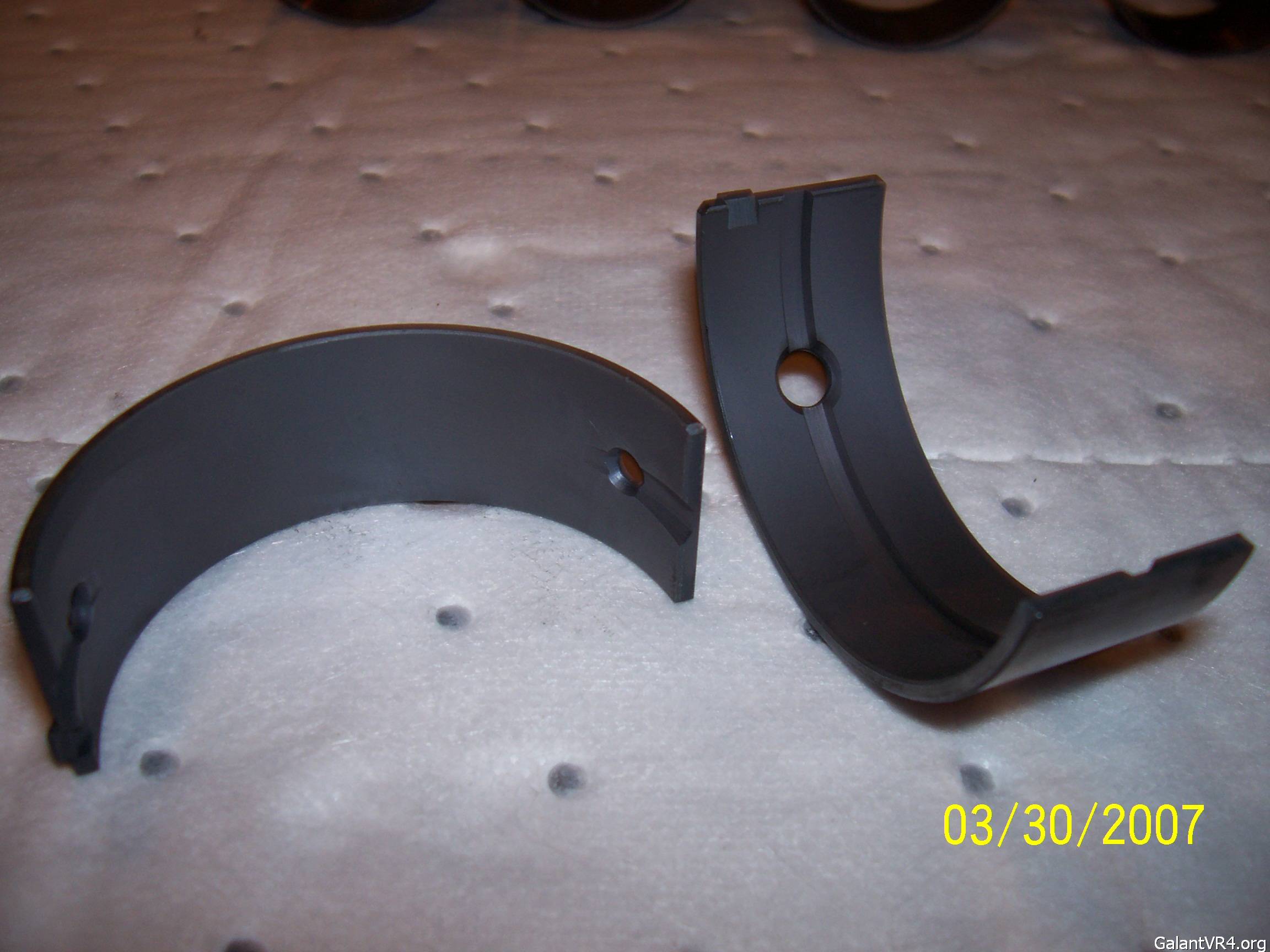

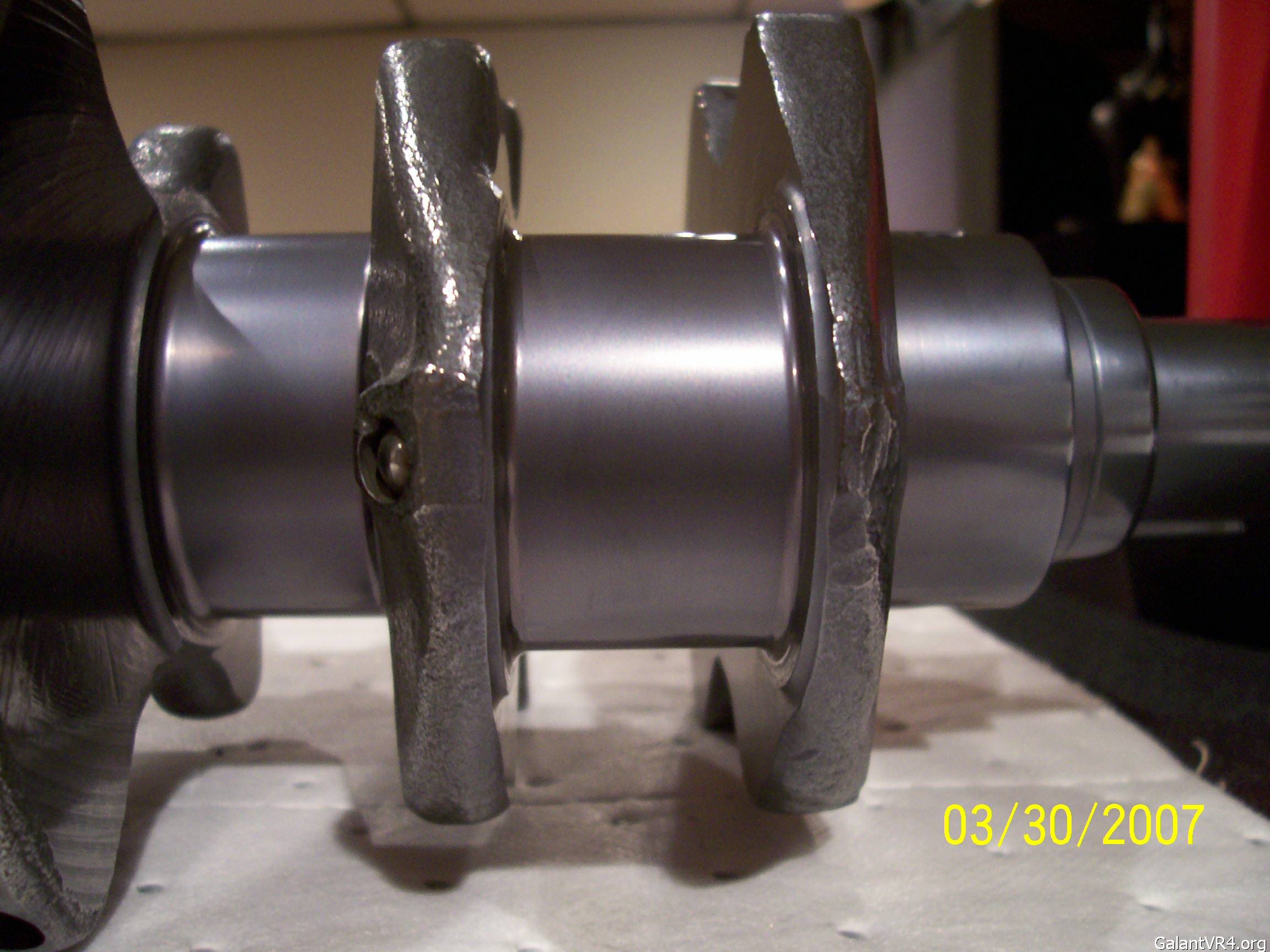

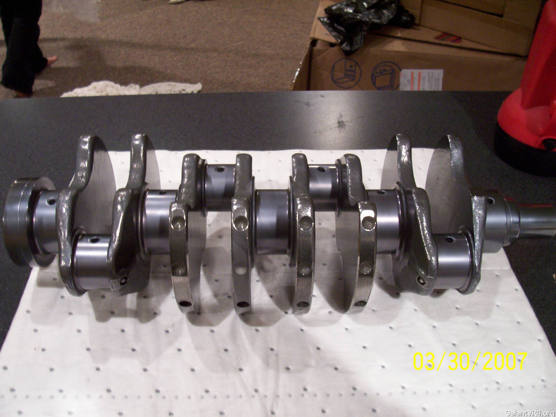

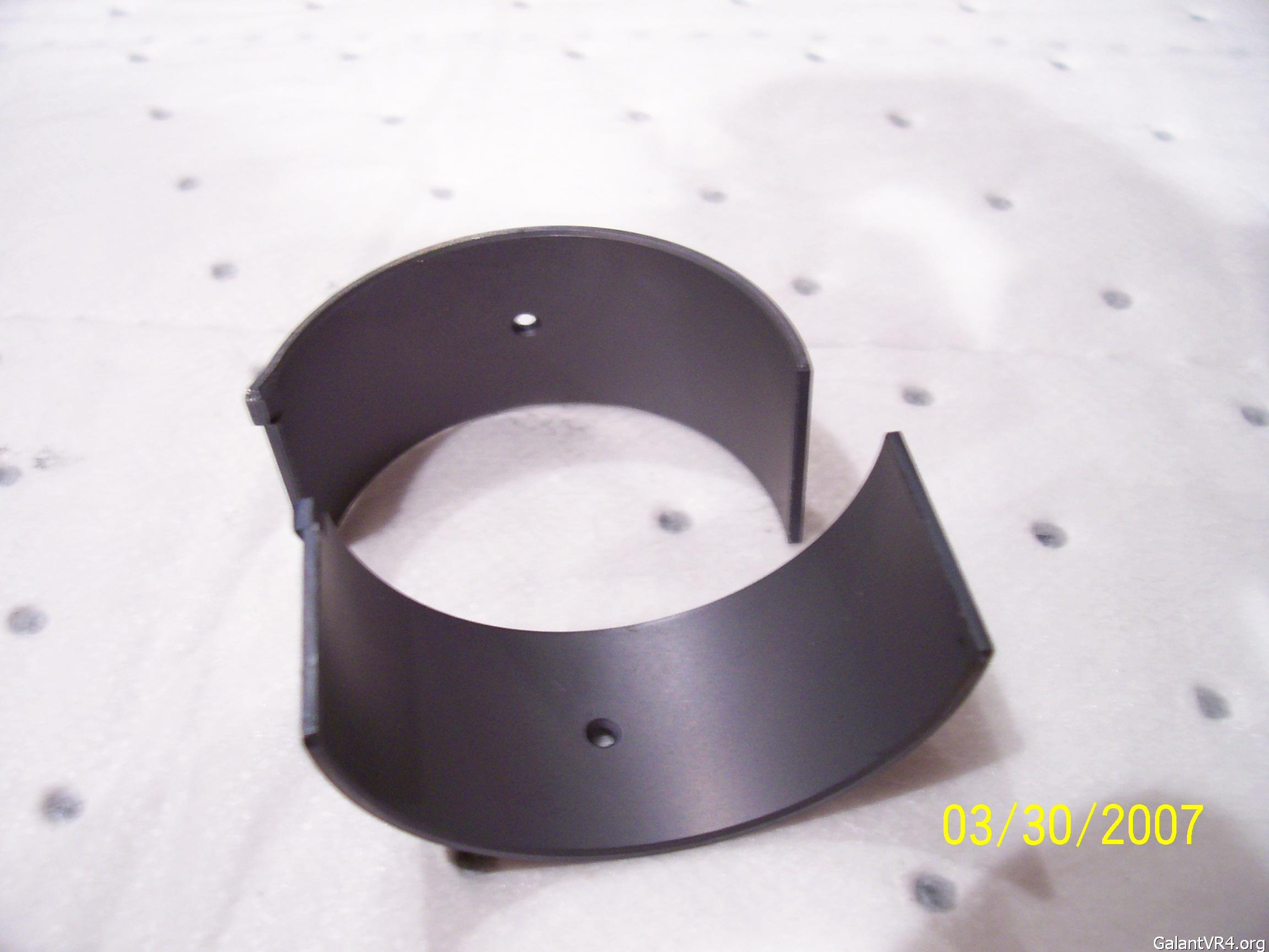

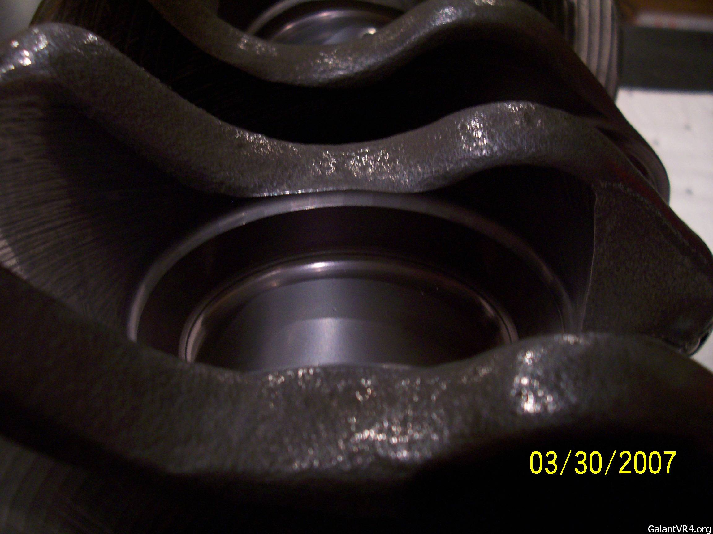

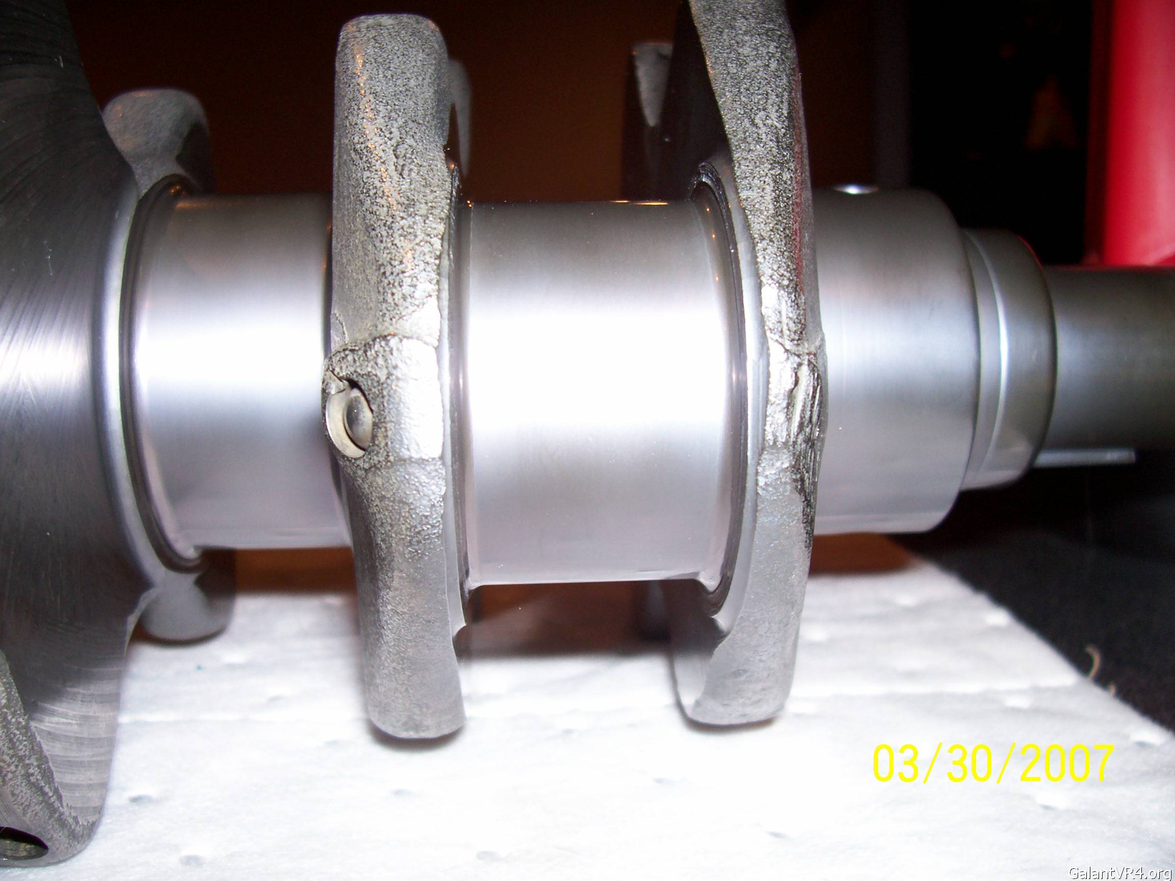

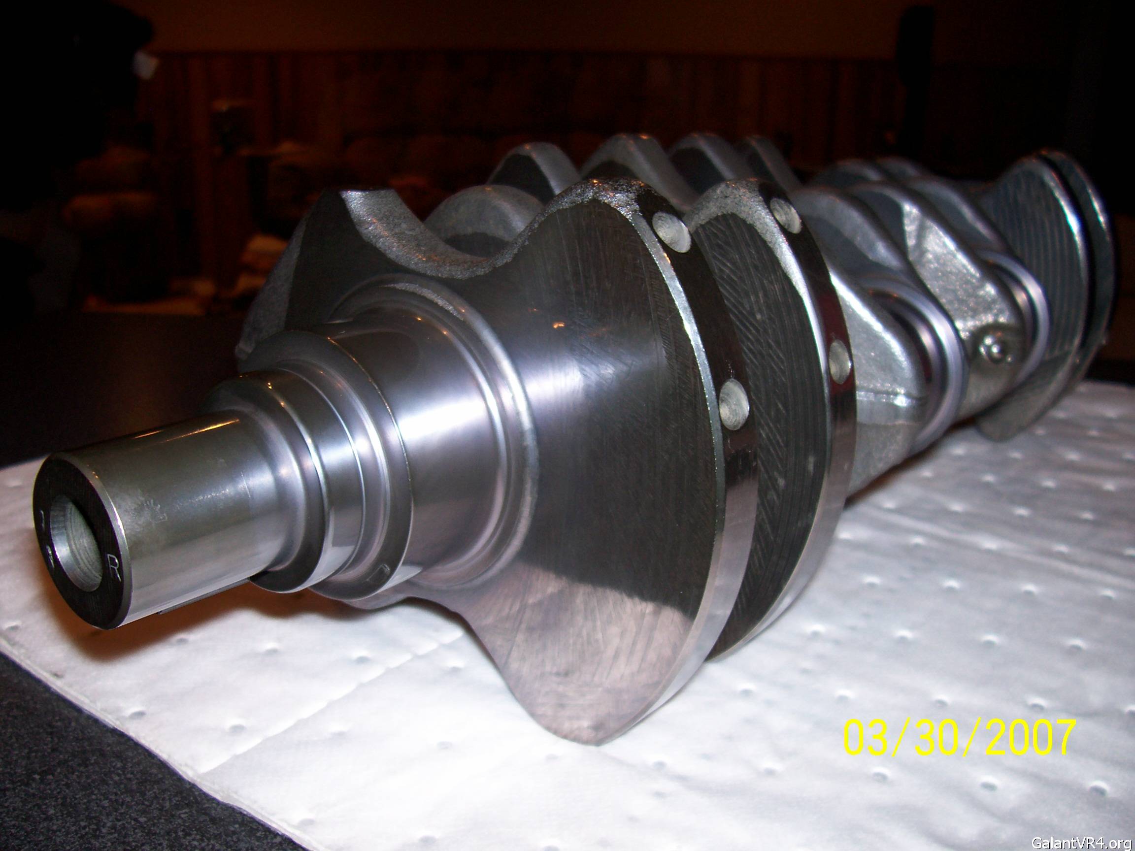

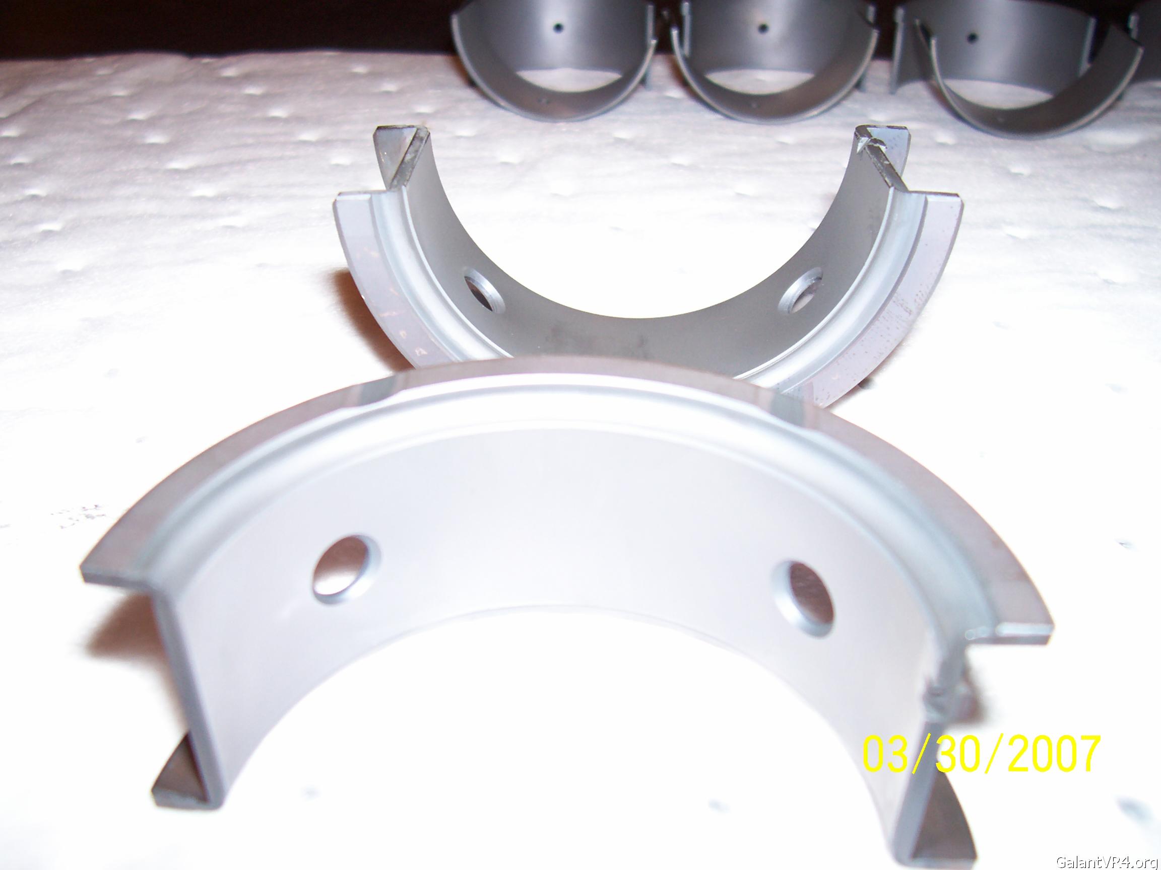

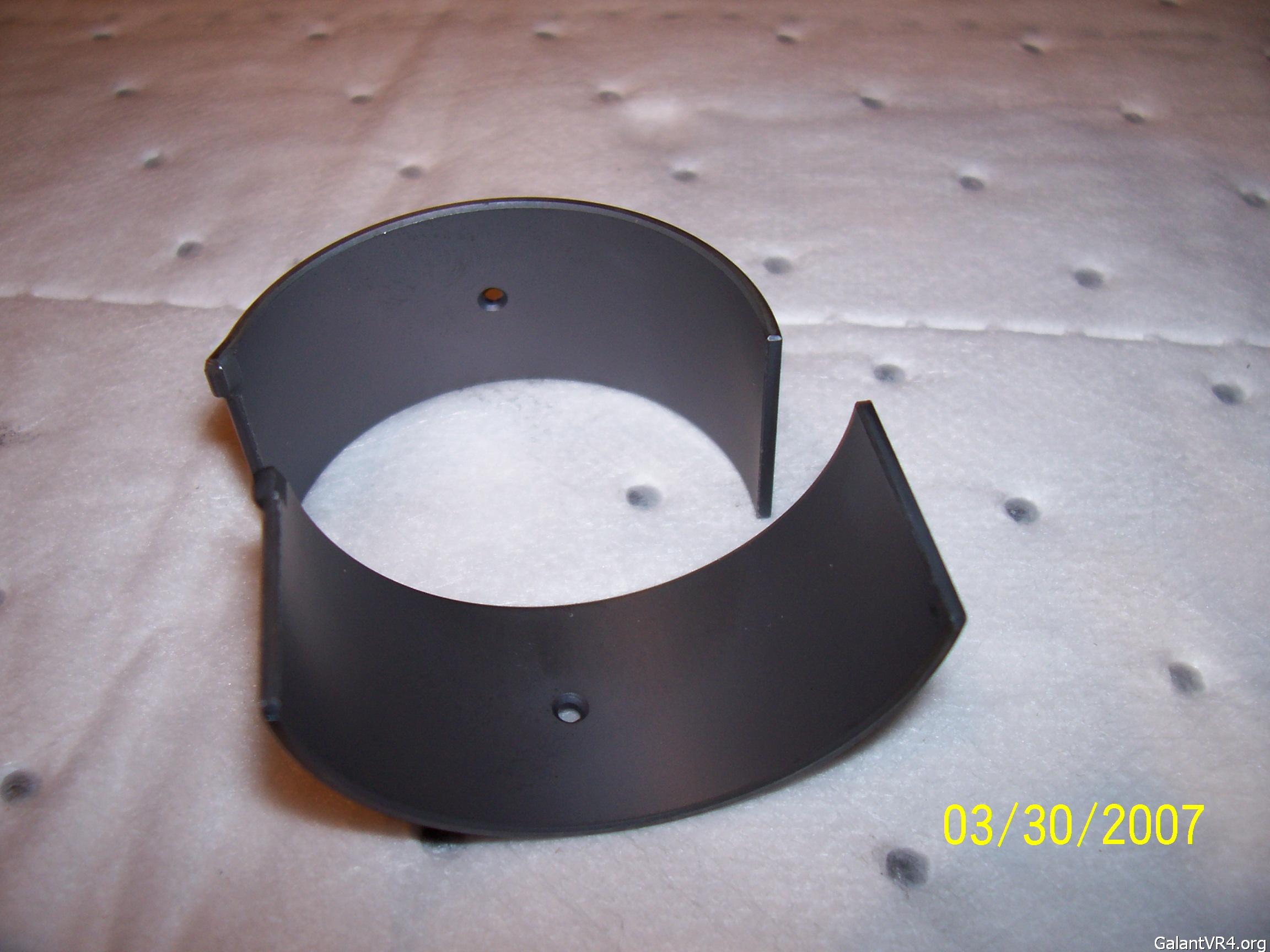

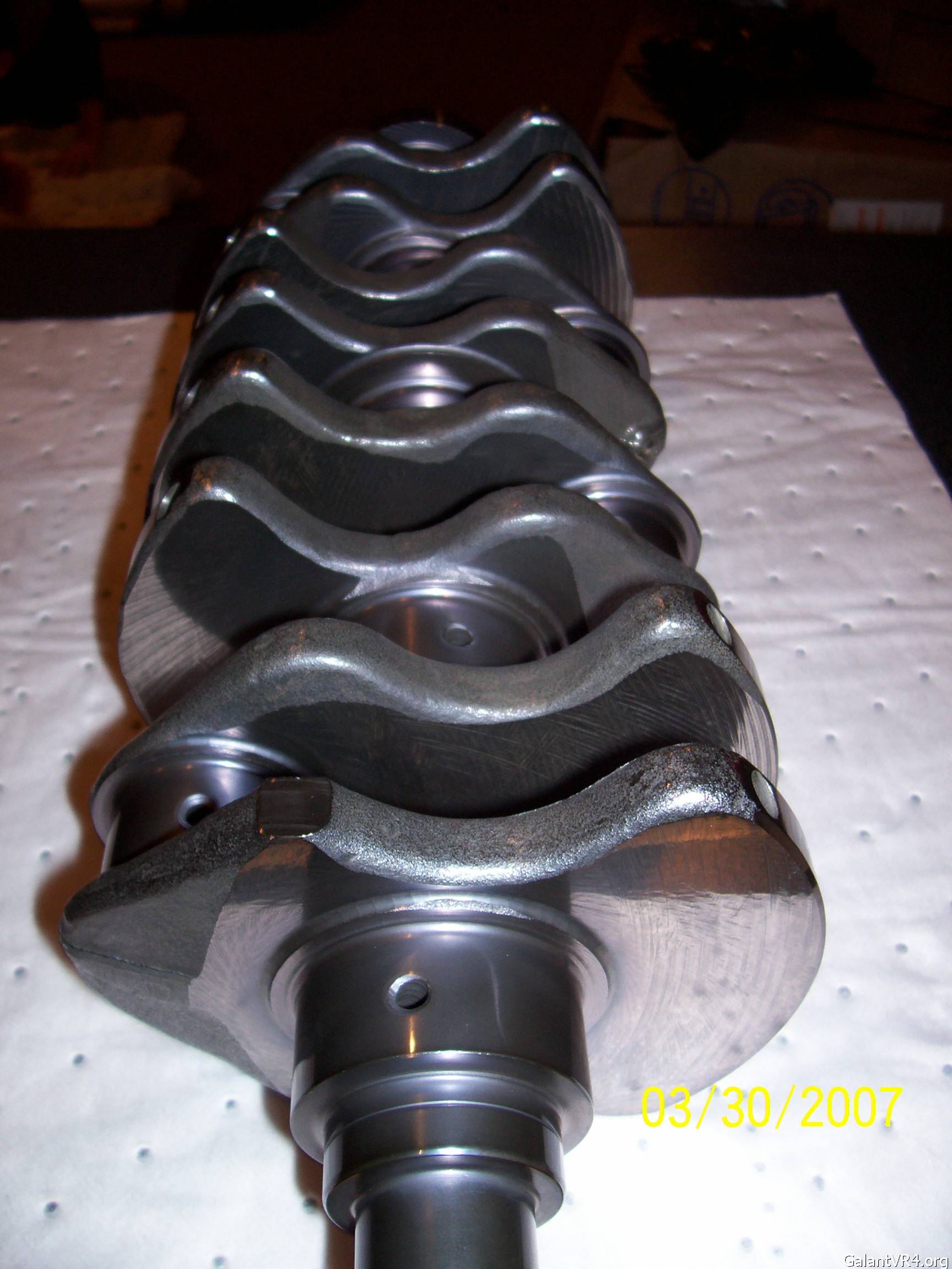

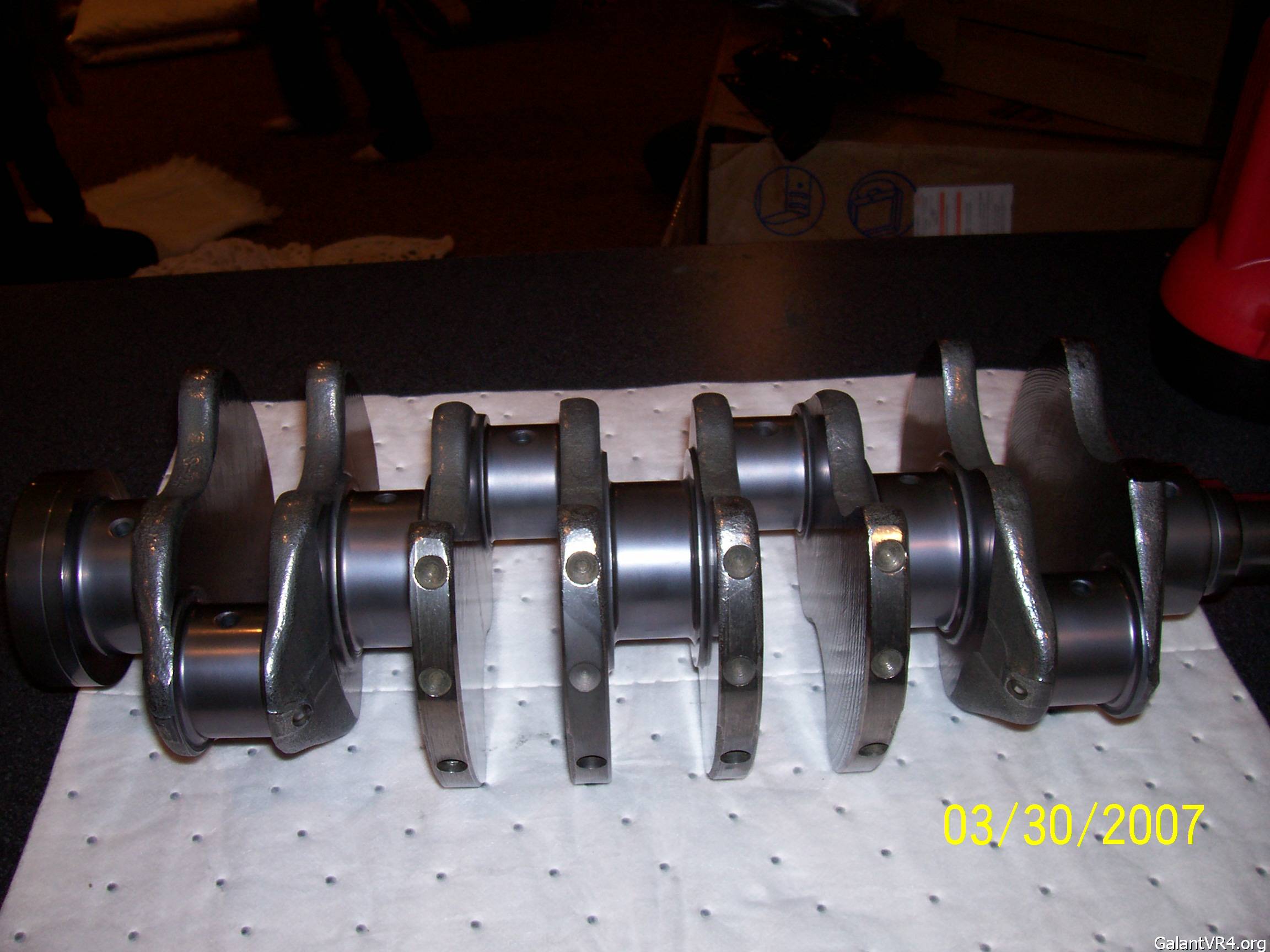

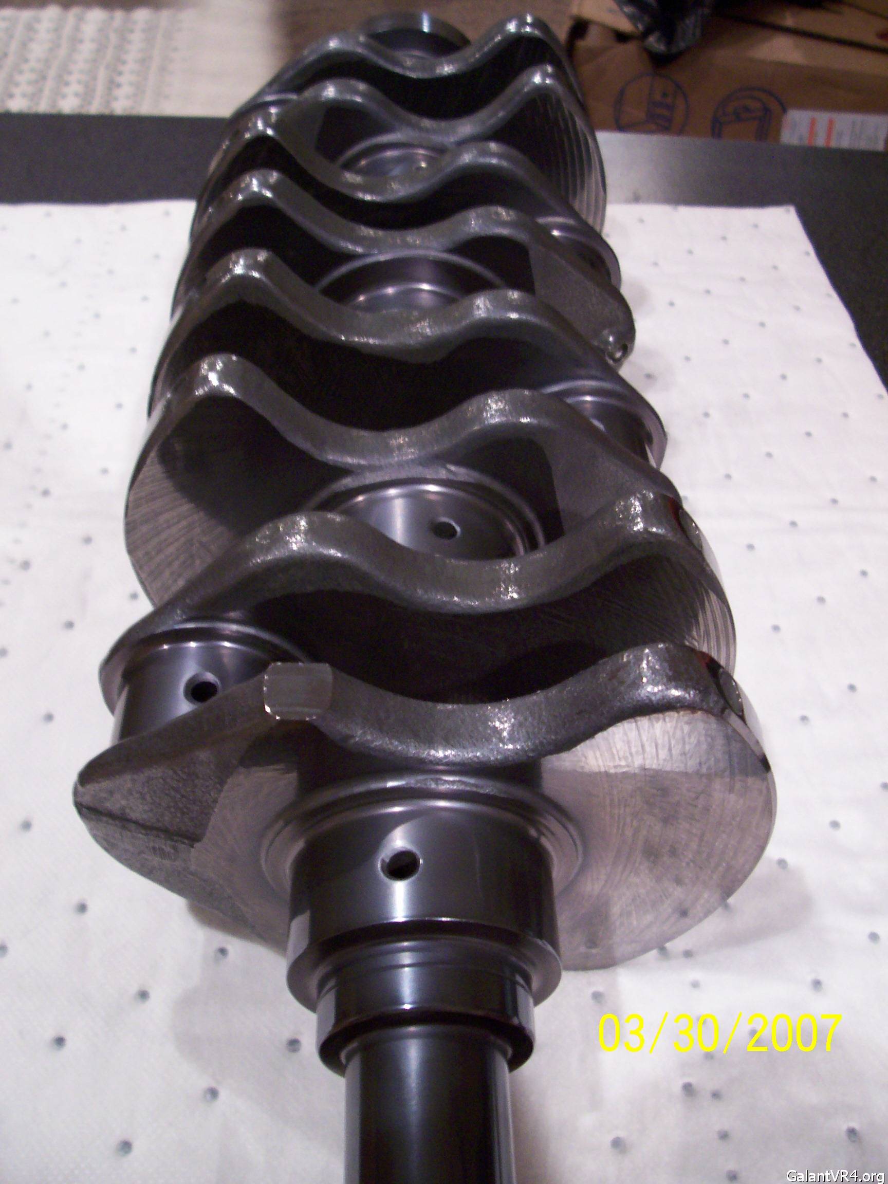

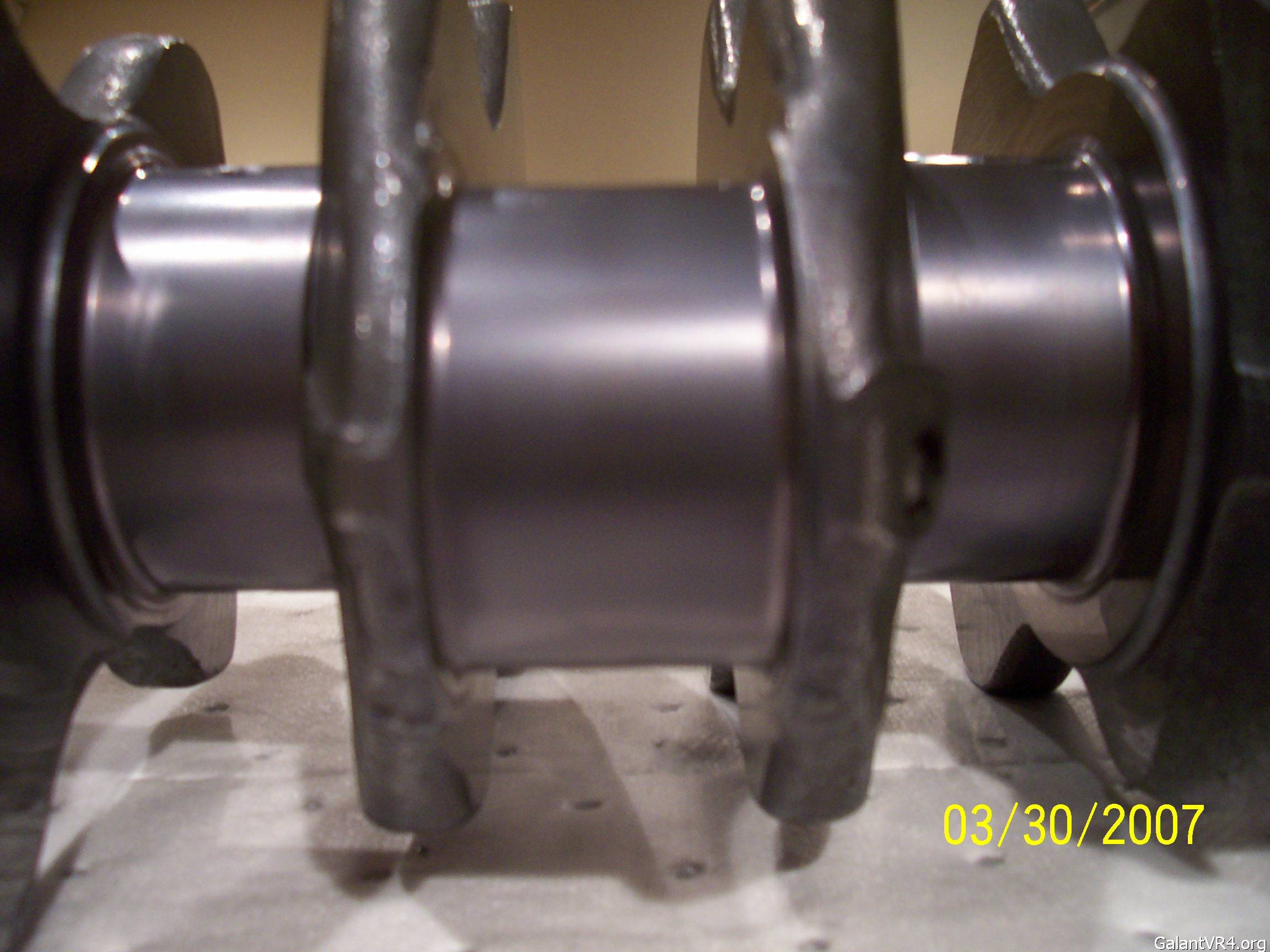

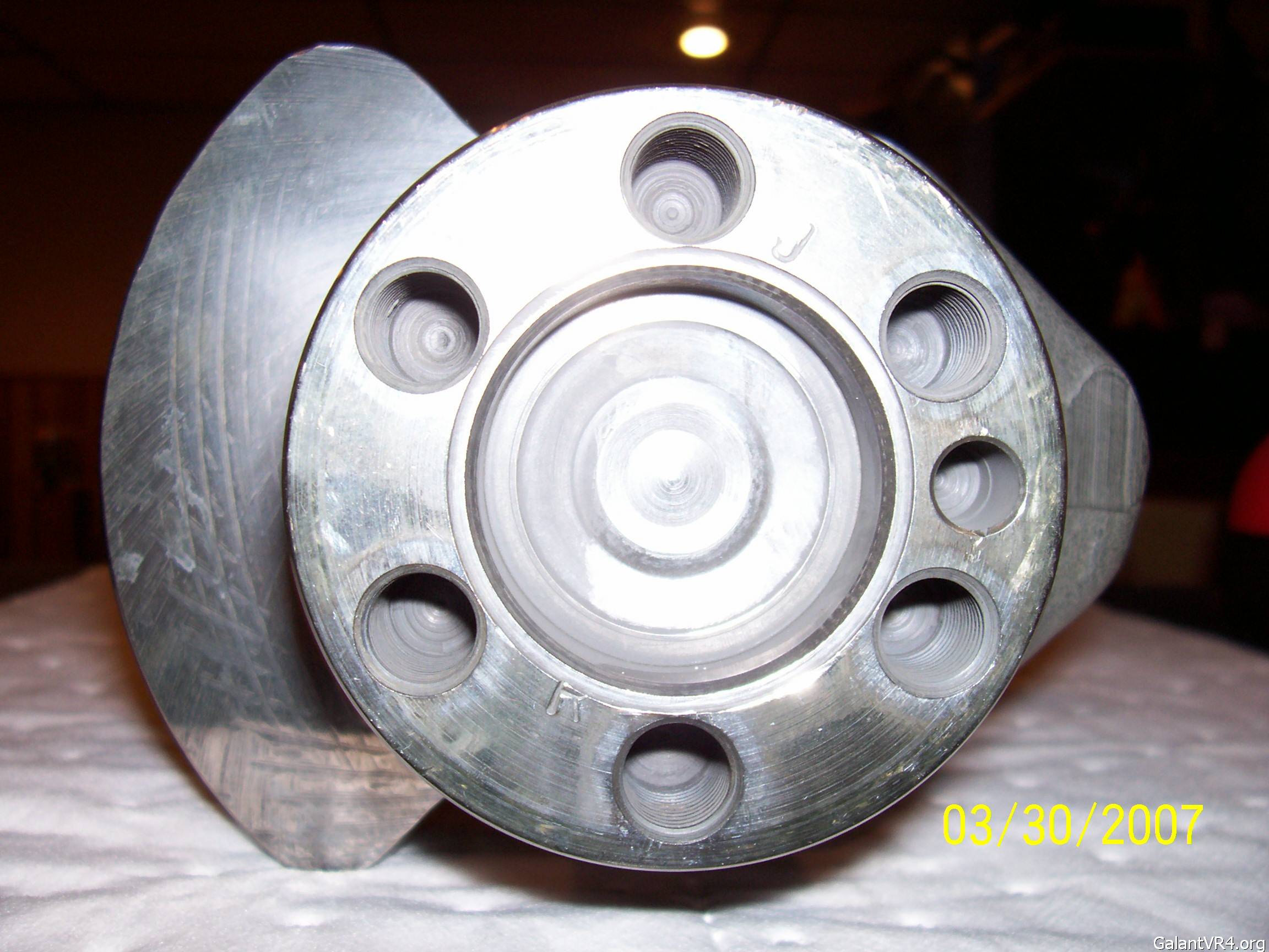

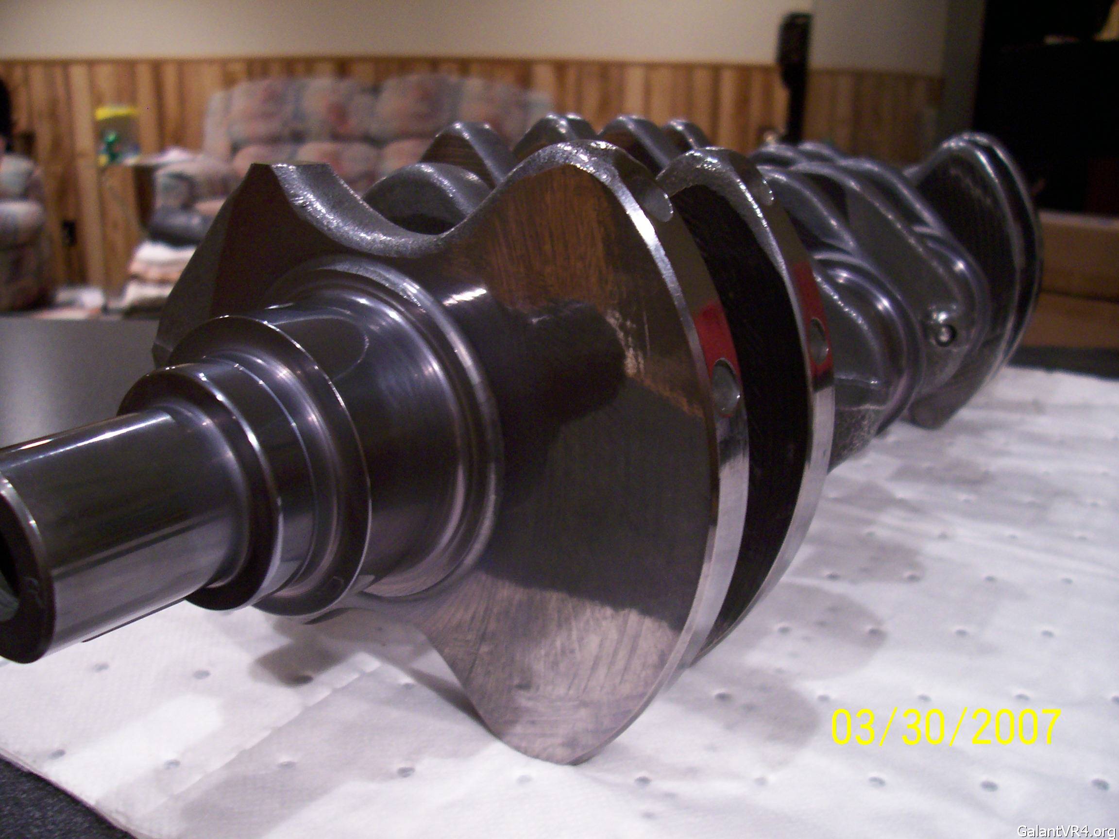

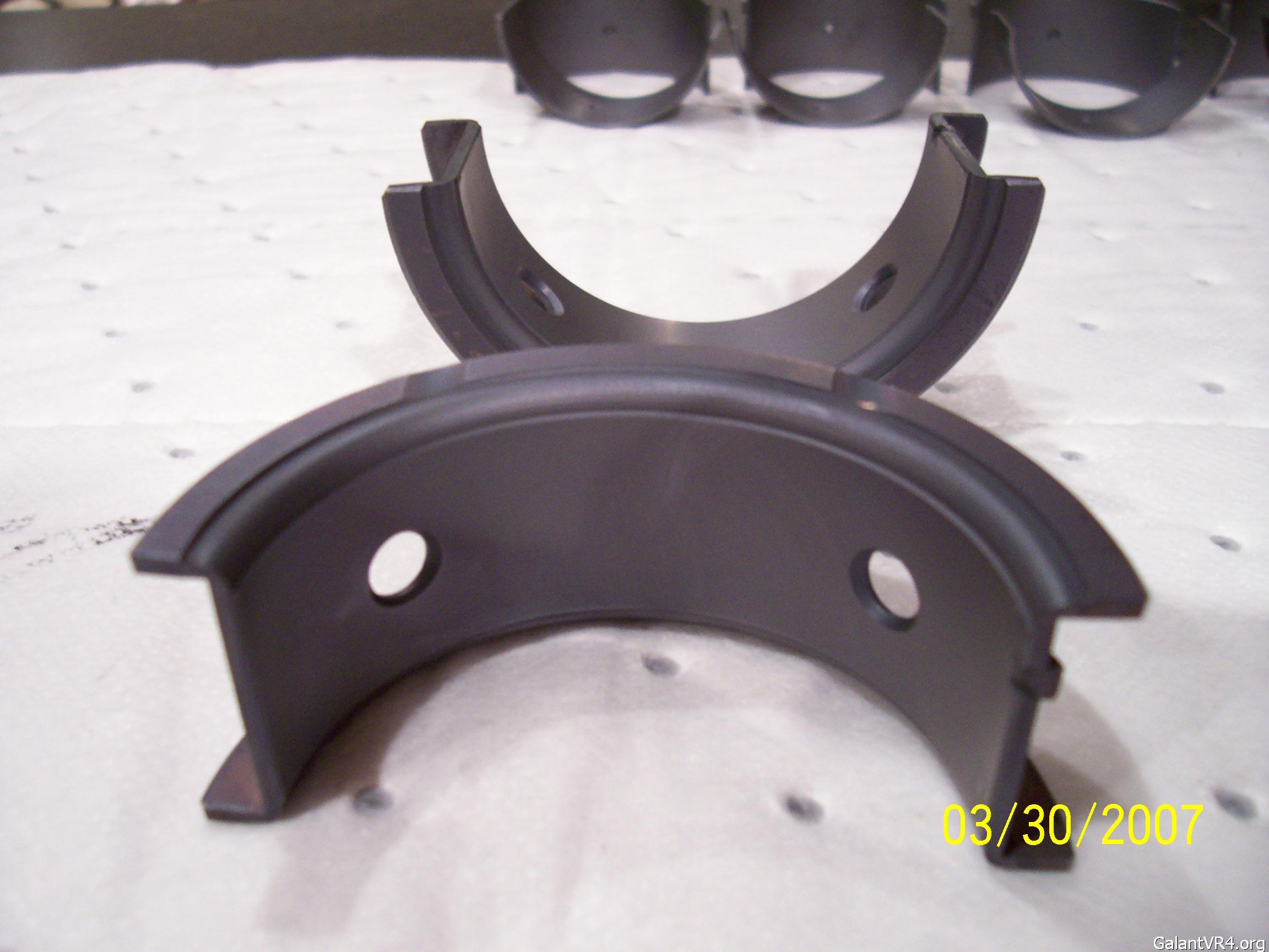

Just got my 4G64 crank back from MicroBlueRacing.com in Rockford, IL.
Most of you know the whole story behind why I had to do this so I wont go into that.
I had a local shop tank and magnaflux it to make sure all was good. Then I dropped it off at Material Technologies (a.k.a. - Micro Blue Racing) to be cyroed and coated with there patented "blue" process. Total cost of this work was $175. ($125 was for the cryo work)
This coating so some kind of process that is really slippery. It is really hard to hold on to. The coating is somehow bonded to the metal and is not effected by any chemical. It can only be removed with abrasives.
Here are some pics of the bearings and crank, all ready to drop in. Some pics are without flash and some are with flash. The camera is only 4mp and does not really do the crank and bearing justice. I just don't have good lighting and enough mp.
