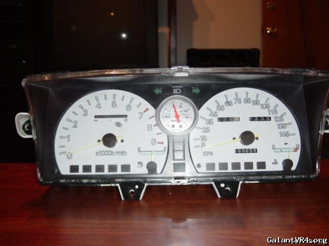

would like to talk to someone who has put a boost guage in the center/ cluster

ercp98
Aug 5, 2003
1,340
northlake in illinois
I have this. but it is just too time consuming to do again.
Also, just a heads up, the boost gauge face is not illuminated. you
have to set up something else to illuminate it at night.
You will not be able to see your boost gauge at night if you don't.
I hope you find some one to do it for you.

honestly I don't do alot of driving at night, and mainly just looking to do this so I have an accurate reading.
I have read through the how to and can probably do it myself, but if someone else has already done it. So I don't mess it all up.
I have a second cluster for practice. But don't want to wreck the damn thing.

I was tempted to do this but went against it after realizing how easy it is to mount the gauge right next to it in either the speaker or using an ECS pod.
