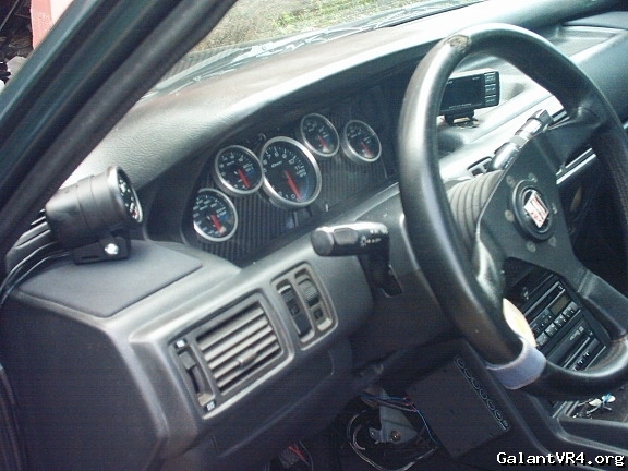

I don't have pictures available at the moment but on my 1g I installed my boost, oil pressure, and water temp gauges into the stock cluster. It took quite a bit of time to get them to fit right but the finished product was nice and a great alternative to the pillar/vent gauge pods.

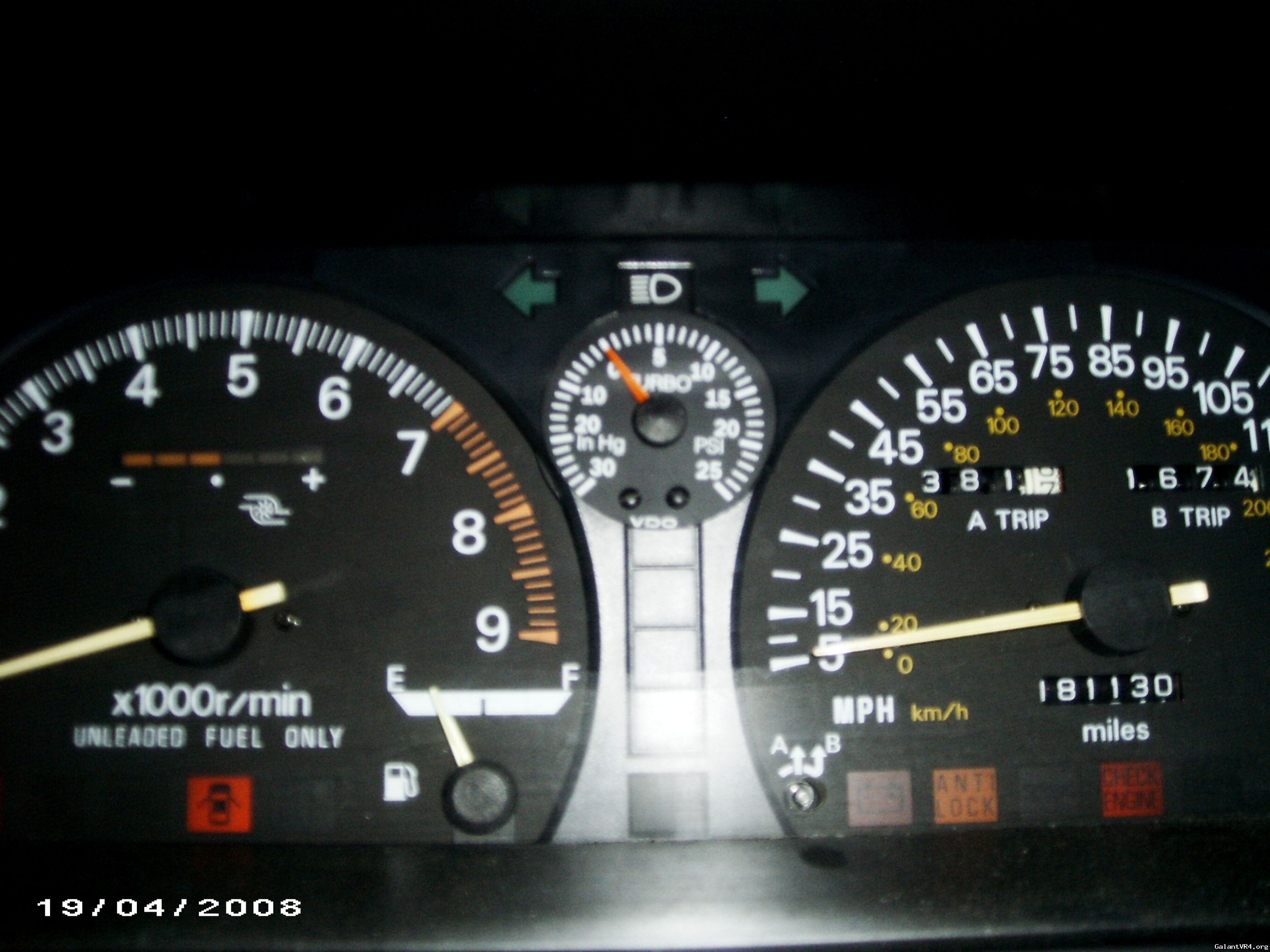

the chip upgrade turns the factory boost gauge into a knock gauge. Look at my pic and you can see it says knock instead of boost. /ubbthreads/images/graemlins/wink.gif
